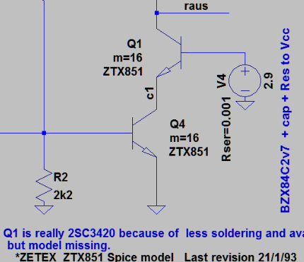

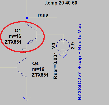

And BTW, using the same expensive ZTX851 for the cascode is a not needed luxury; the cascode device doesn't need to be low noise, it's contribution to the input referred noise is very small. Any medium power device in TO252 and a little bit of PCB copper for cooling will do in that position.
There is no second set of ZTX851, in the text and the photos it is made clear that there is a 2SC3420, for which I have no spice model. I have not seen a case where a cascode added significant noise ever.
The bias regulator is a ZTX851 because the box was on the table.
Sorry, I looked at the schematic and wondered...

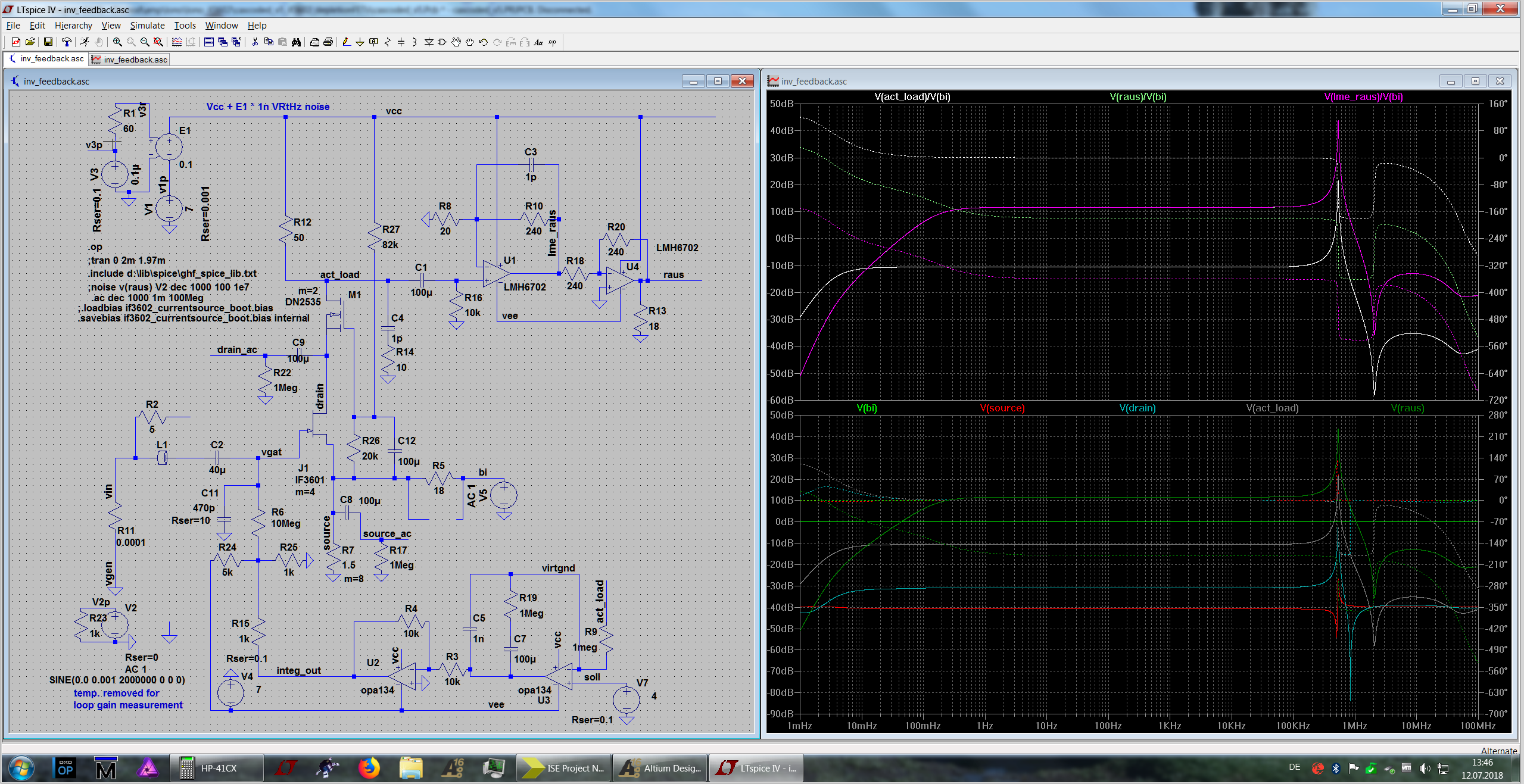

BTW who would think that adding a ferrite bead to an amplifier input
(Würth from LTspice lib) would f* up the loop gain of an amplifier so completely.
Damping it with the 5 Ohms makes everything nice again.
I had the hope that I could get rid of the gate voltage divider / coupling C for
the cascode/bootstrap, but the depletion MOSFET is not depleted enough. It leaves
only 1 V at the drain of the input JFETs.
The opened loop goes from V5 to the output of U4. R14 is a first order approximation
of the feedback divider.
