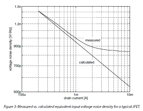

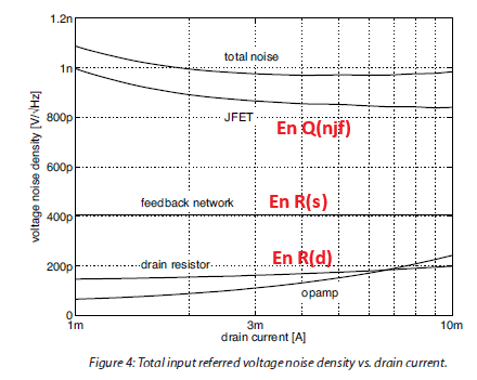

Noise is inversely related to drain current, until the JFET self-heats. This was shown by Sam in Figure 3 of his LA article. The source resistor plays two parts setting the current AND contributing Noise ER(s) = SQRT (4kTR).
In Sam's article, the current is set by a low noise current source with high impedance at what he determined to be "optimal" given the heating effect. He uses an array of resistors with a paralleled value of 0.989 Ohms (Rs) and the gain-setting resistor for the feedback network.
So the question is, do the noise components simply sum, or sum to the square root of the sum of the squares?
