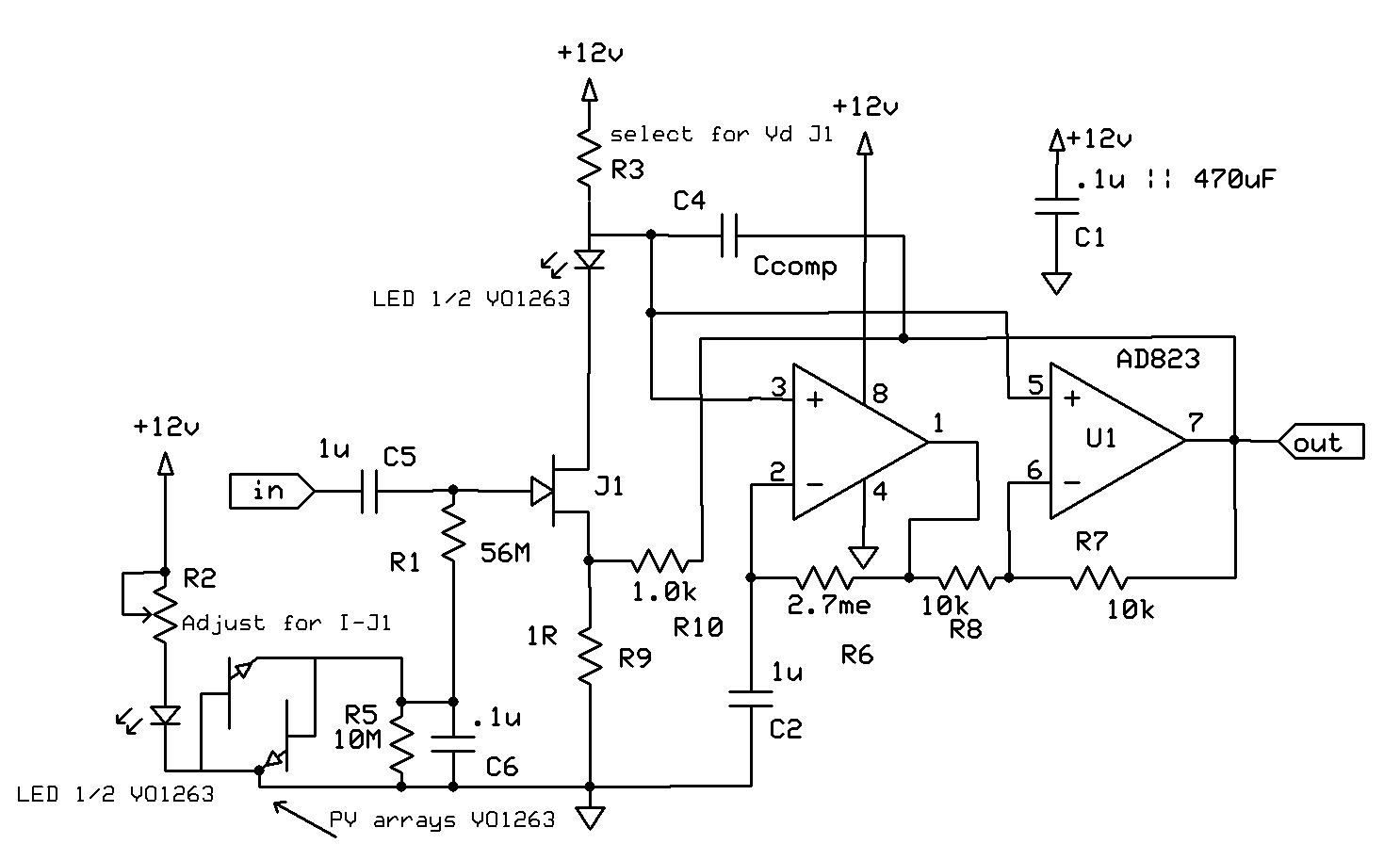

My version of the G = 1000 low noise measurement amp (for Ikoflexer)
This is my take on Ikoflexor's low noise measurement preamp.
I used a Vishay photovoltaic MOSFET driver (http://www.vishay.com/docs/81225/ssrvo126.pdf) in an unusual way to make a negative bias on the input JFET. This eliminates the huge capacitor in series with the 1 Ohm gain resistor. In fact there are no electrolytics in the signal path. The back to back PV arrays make a nice bipolar bias reference and you can simply flip the diodes to reverse polarity. On dual supplies this voltage can go outside both rails (when referenced to ground). R3 is selected for ~1/2 the supply at the drain off J1 at the desired drain current. Then when R2 is ~2XR3 the drain voltage will track roughly ½ the supply voltage over a wide range with no further adjustment. The MOSFET driver can be looked at as an isolated current in current out device (gain = .001). This times the 10Meg resistor gives a gain in this loop (FET drain current to gate voltage) of 10,000, or 10,000*gm if looked at as a voltage gain. For these FETs it's around 100 which gives decent enough operating point stability from FET to FET without trim.
The nominal gain is 60dB and BW from .1Hz to >200kHz. the dual op-amp arrangement has DC gain of one and acts at AC like a differential out amplifier. So the input stage finds Vcc/2 at the drain of the FET with optical feedback and the output stage sits at the same voltage.
This op-amp can be an ordinary bi-FET. An additional requirement was that the circuit could be used with 48V phantom power and make for a very simple one box set up. Of course the multi-paralleled FETs at the input would work but phantom power is limited to 10mA.
As built with one 2SK170 it came right out at 1.1nV as simulated and with these values and AD823, .1Hz to 400kHz. No comp-cap is needed at G = 1000, but it will be necessary at lower gains. Even a TL072 will work with Fmax becoming 200kHz or so. If C6 gets too large one can induce motor-boating, I’m sure there is a optimum set of low frequency time constants.
At 6mA current draw this whole circuit could be put under a 48V phantom supply with differential outputs on the two op-amps (gain will be +6dB more). This would require a larger resistance level in the feedback network.
Big advantage, 1Hz BW with no caps in the feedback network and no electrolytics needed anywhere (except bypassing).

Stupid question :
What is the value for R6 ?
What does 2.7me means ?
Patrick
2.7 Meg Ohm (me is our simulators shorthand). R6 was 3K and had about 3.8V across it. I was a little imprecise the first time just seeing if the idea worked out. Every DUT I tried biased at about the same point. I used a 9V battery with the circuit in a box and them put a grounded box all around this.
So if I were to duplicate the circuit, I should use 2.7M for R6, correct ?
What about R3 & R2 (just some typical values) ?
You mentioned a reference resistor of 20k in post #5, which one is that ?
Any particular requirements for the resistors (low tempco, 1%) ?
0.1uF decoupling cao close to U1, I suppose ?

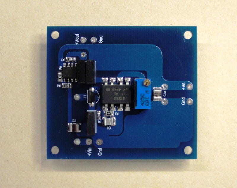

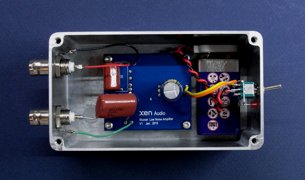

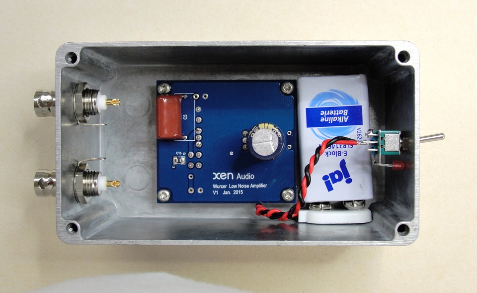

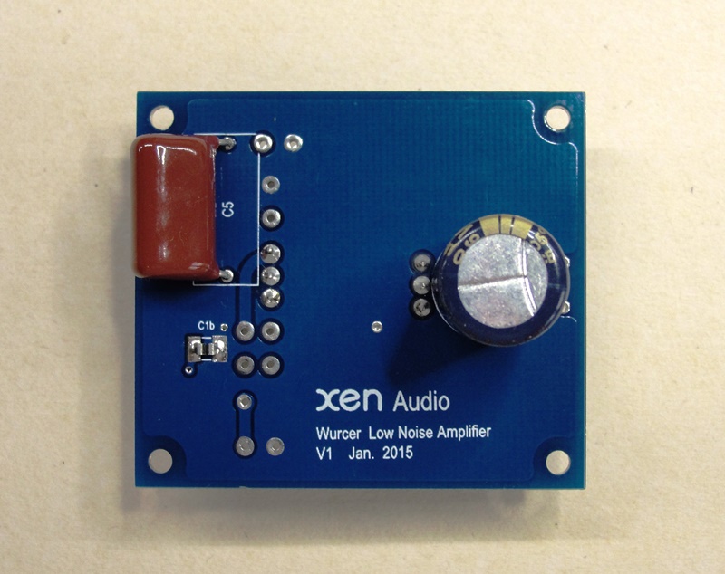

4 years on, I finally got round to building something.
Only half way through, not yet tested, but simulated on Space beforehand.
Supply voltage is changed to 9V, as I want to use a single battery.
Patrick

I only started doing the PCB in January after building my own LNA.
It has a bit too high gain of 10000x, and use complex power supplies.
And then I revisited Scott's circuit, and thought a small battery powered version would be handy.
But yes, still takes too long than I would like.
Patrick

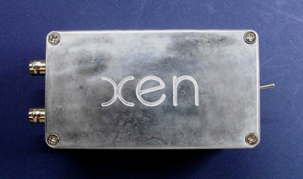

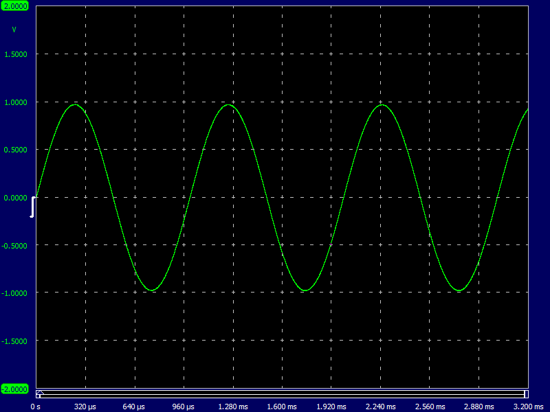

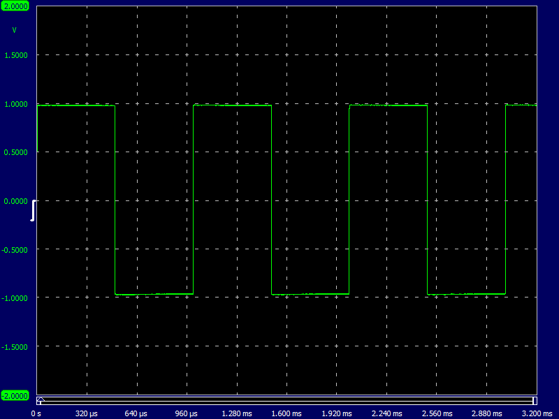

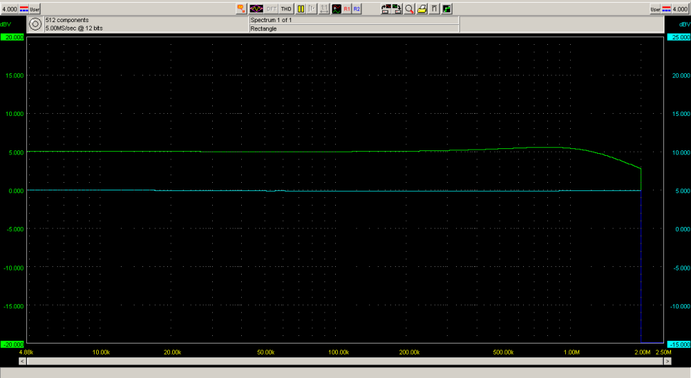

Finally all finished.
Most sincere thanks to Scott for the circuit.
Patrick
