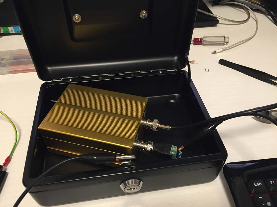

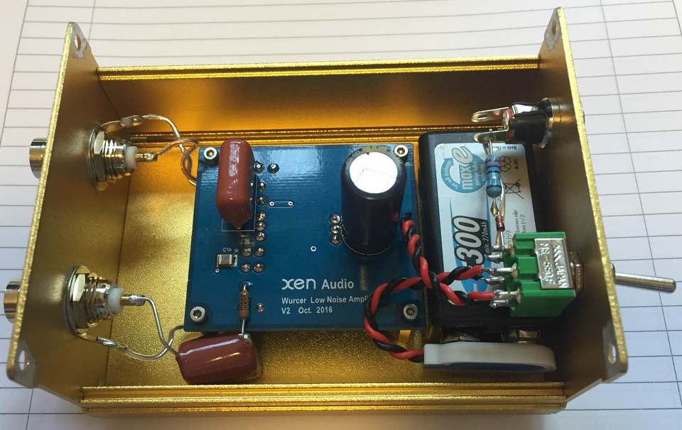

My version of the G = 1000 low noise measurement amp (for Ikoflexer)
Another one is made, thanks Scott for the circuit and Patrick for the PCB design 🙂

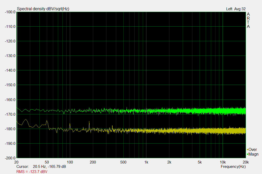

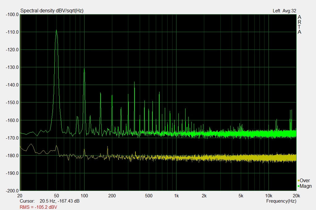

Attached (second picture) the ARTA measurement of the noise level (gain is set to 1000 in ARTA). Yellow one is when input was shorted at the BNC, green one is when input was connected to a 1k resistor. The 1k resistor should have a noise of 4nV/rtHz, with the yellow line being 14dB lower, this amp should have a noise of 0.8nV/rtHz if my computation is right.
To get a clean graph, I had to hide it within another grounded metal box, last graph is measurement of the 1k resistor (green) without the extra metal box, where the aluminum case is already grounded.
the 2 box screening makes a big difference.
I have seen others suggesting the 2 box method and they used different materials for the two boxes, one included Fe for better magnetic coupling screening.
Is your black box aluminium, or steel?

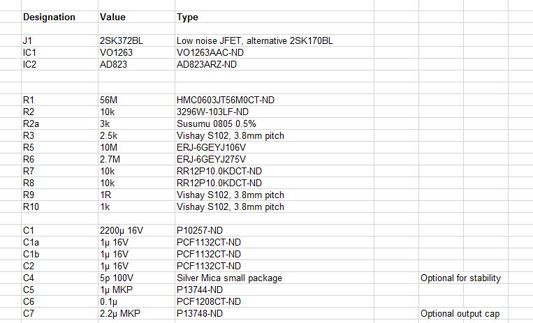

Please note that this is Scott's circuit.
We built it as is, and have proven that it works.
So we shall only publish a BoM that corresponds to the PCB (and Scott's schematics).
If you have detailed technical questions, there is no better person to ask than the inventor himself.
