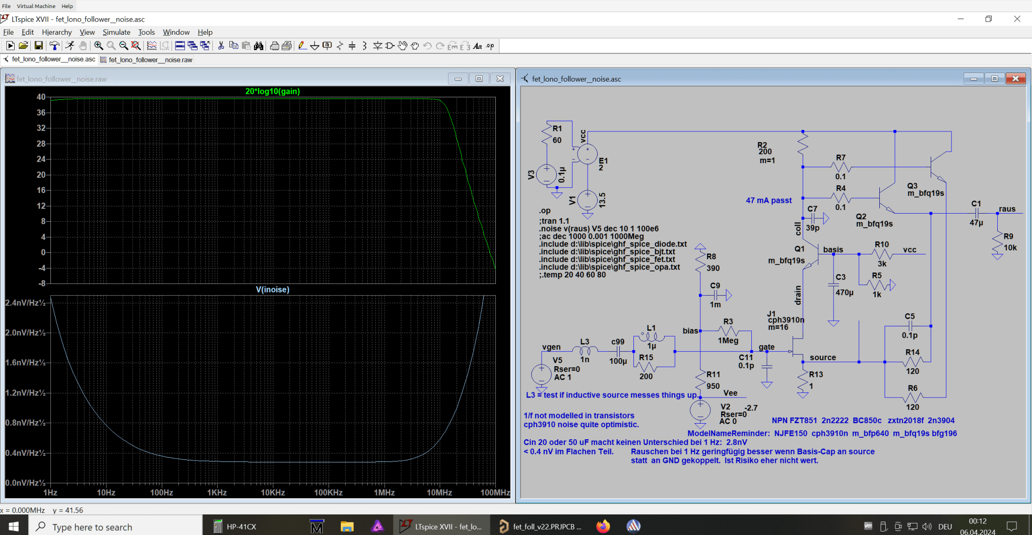

I had this horror with the negative Input impedance with virtually all
feedback amplifiers of the form CS - Cascode - OpAmp - feedback to source, even
designs of the gods, like Horowitz&Hill etc. Propagation through the OpAmp
is simply to slow (costs phase margin). Add an inductive signal source and you've
got an oscillator. In Spice, you can simply plot V(signal generator) / I (signal generator),
TI 3.5 GHz CFBs after the cascode seemed to
work, but they drowned the signal in 1/f noise, even after 30+ dB of preamplification.
I then decided to go without feedback. To get somewhat stable gain, I temp-stabilized
the FETs at +40°C with a regulated oven. That was no real advantage.
FETs have both a positive and a negative TK, and they cancel at a certain drain
current. In simulation at 45 mA for 16 CPH3910. gm of the FETs changes with sqrt(Id)
so the aberrations are not too severe.
Avoiding feedback felt like a personal defeat, so I recently did a redesign with emitter
follower & RF transistors. boards are somewhere between JLCPCB/China & here.
It took 2 sot-89 transistors because of power dissipation.
I had a bias regulation loop patterned after the 70pV/rtHz amplifier from AOE3,
but at sub-Hz you cannot really say if it is noise or servo oscillations. Measuring
it takes eons. Yes, I'm more into measurements than Golden Ear audio.
Funny values like 0.1pF are the remains of what/if checks.
Ideas welcome.
Gerhard

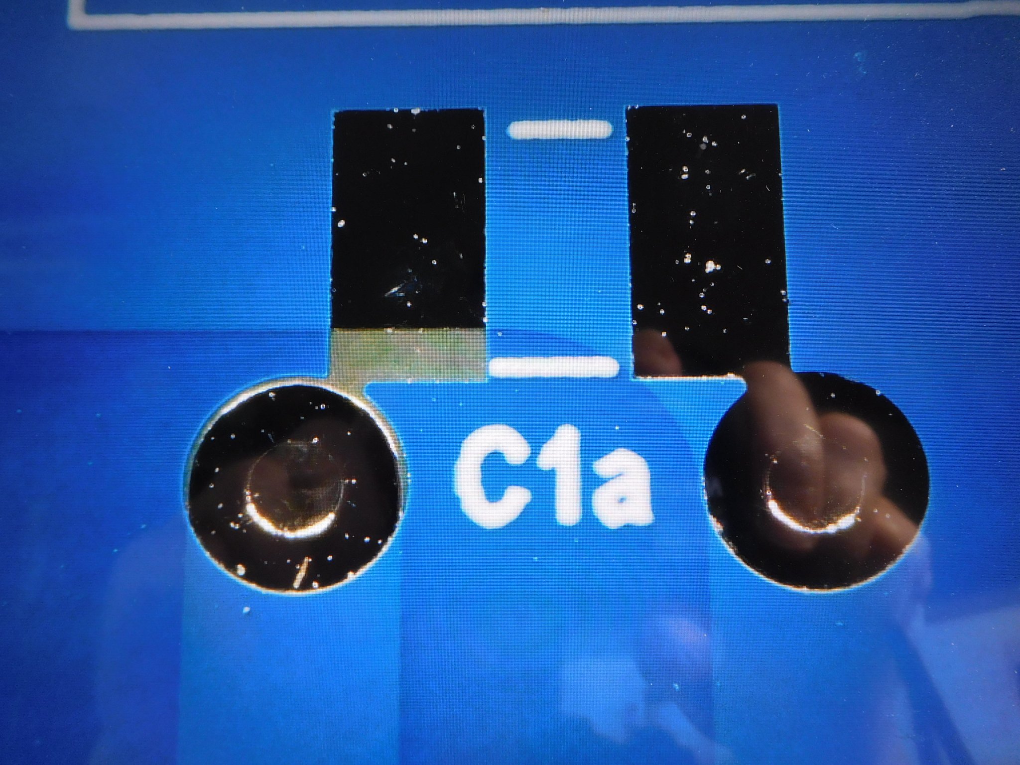

Hi @EUVL
Thank you for making the gerbers available. I've had both N and P channel boards made and noticed that C1a is shorted on the ground trace on the PJFET board, rather than connecting across C1 as you did with the N channel board. Also noticed that the R2a label is missing. Just mentioning these in case you hadn't noticed before.
Thanks again.
