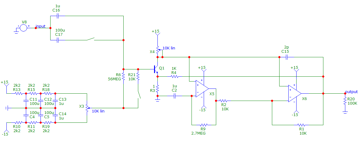

Interesting to note...perhaps Scott (world-famous Scott!) was in contact with, or observed by the folks at the Dipartimento di Ingegnaria Electronica at University of Messina who authored an article in "Review of Scientific Instruments" in 2014 describing a very low noise programmable current source using the Vishay gate driver described by Scott!This is my take on Ikoflexor's low noise measurement preamp.
I used a Vishay photovoltaic MOSFET driver (http://www.vishay.com/docs/81225/ssrvo126.pdf) in an unusual way to make a negative bias on the input JFET. This eliminates the huge capacitor in series with the 1 Ohm gain resistor. In fact there are no electrolytics in the signal path. The back to back PV arrays make a nice bipolar bias reference and you can simply flip the diodes to reverse polarity.

Vishay put a model on their website, but it is "double-spaced", requiring some editing to be useable. The part is now "long lead time" but can still be found.Here is the model, symbol and the LNA schematic. IIRC the model is actually for VOM1271 but I found that it works reasonably well also for VO1263.

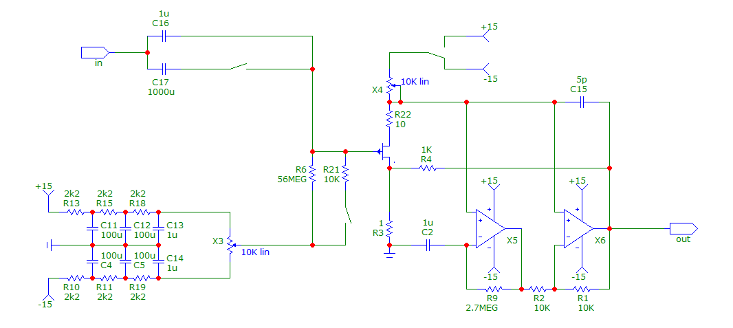

Scott's design is very good, and should be considered by everyone who needs a measurement preamp with a gain of 1000, including those who cannot easily source the optocoupler.
Therefore I propose the modification below, as a starting point. Unlike the original, it's not smoothly adjustable (the pot adjustment will be quite sensitive). But it's more general (accepts BJTs and also MOS in place of the JFET, in case one is interested in looking at the noise of those devices).
It is stable in the simulator with BJTs and a compensation cap of 2p (which is also adequate for JFETs). The switches have to be closed when using a BJT. I have not yet built it.
Just to make it clear to anyone interested: a low noise JFET such as 2SK170 will normally be used in the circuit above, to make it a useful high input impedance measurement preamp.
The possibility of using BJTs and MOS is for the purpose of looking at noise plots of these devices, with the input grounded.
One useful addition to the schematic above is a 10 ohm resistor in series with the collector/drain of the device, which serves as a test point to measure bias current.
