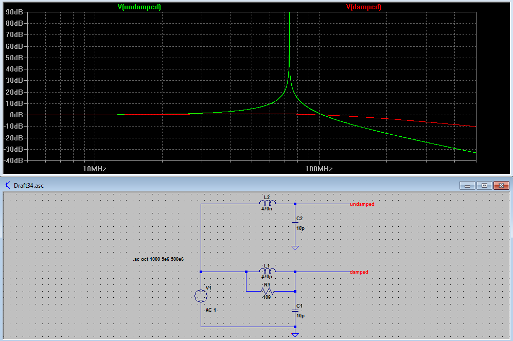

BTW who would think that adding a ferrite bead to an amplifier input
(Würth from LTspice lib) would f* up the loop gain of an amplifier so completely.
Damping it with the 5 Ohms makes everything nice again.

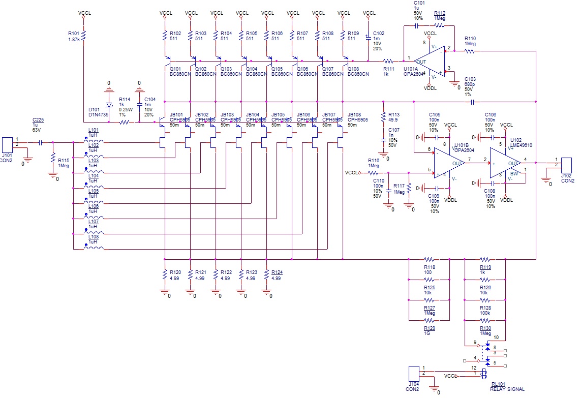

I had the hope that I could get rid of the gate voltage divider / coupling C for
the cascode/bootstrap, but the depletion MOSFET is not depleted enough. It leaves
only 1 V at the drain of the input JFETs.
The opened loop goes from V5 to the output of U4. R14 is a first order approximation
of the feedback divider.

Please tell me R129 is not critical
Can be obviously omitted for a 0.01% total 99ohm.

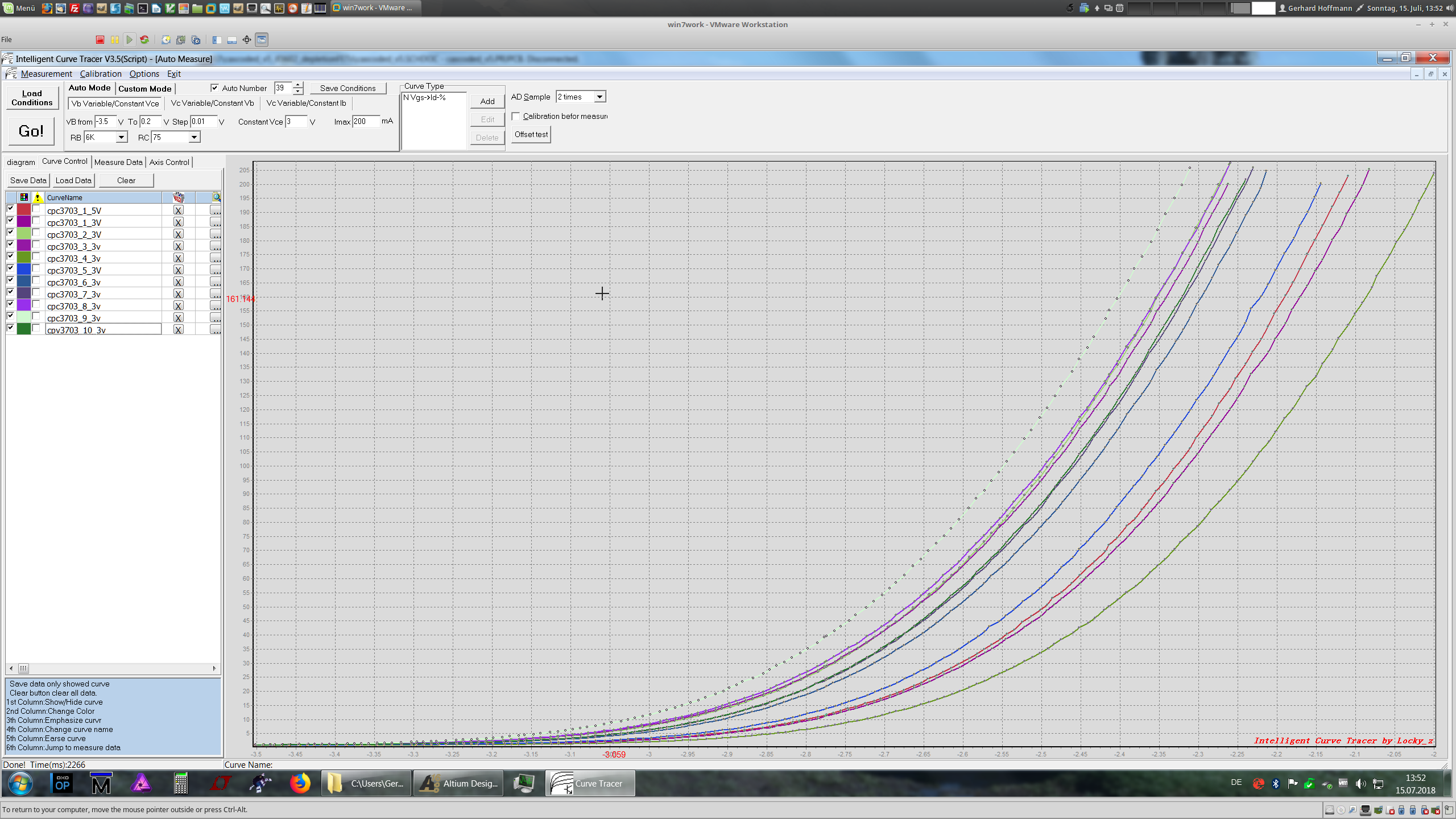

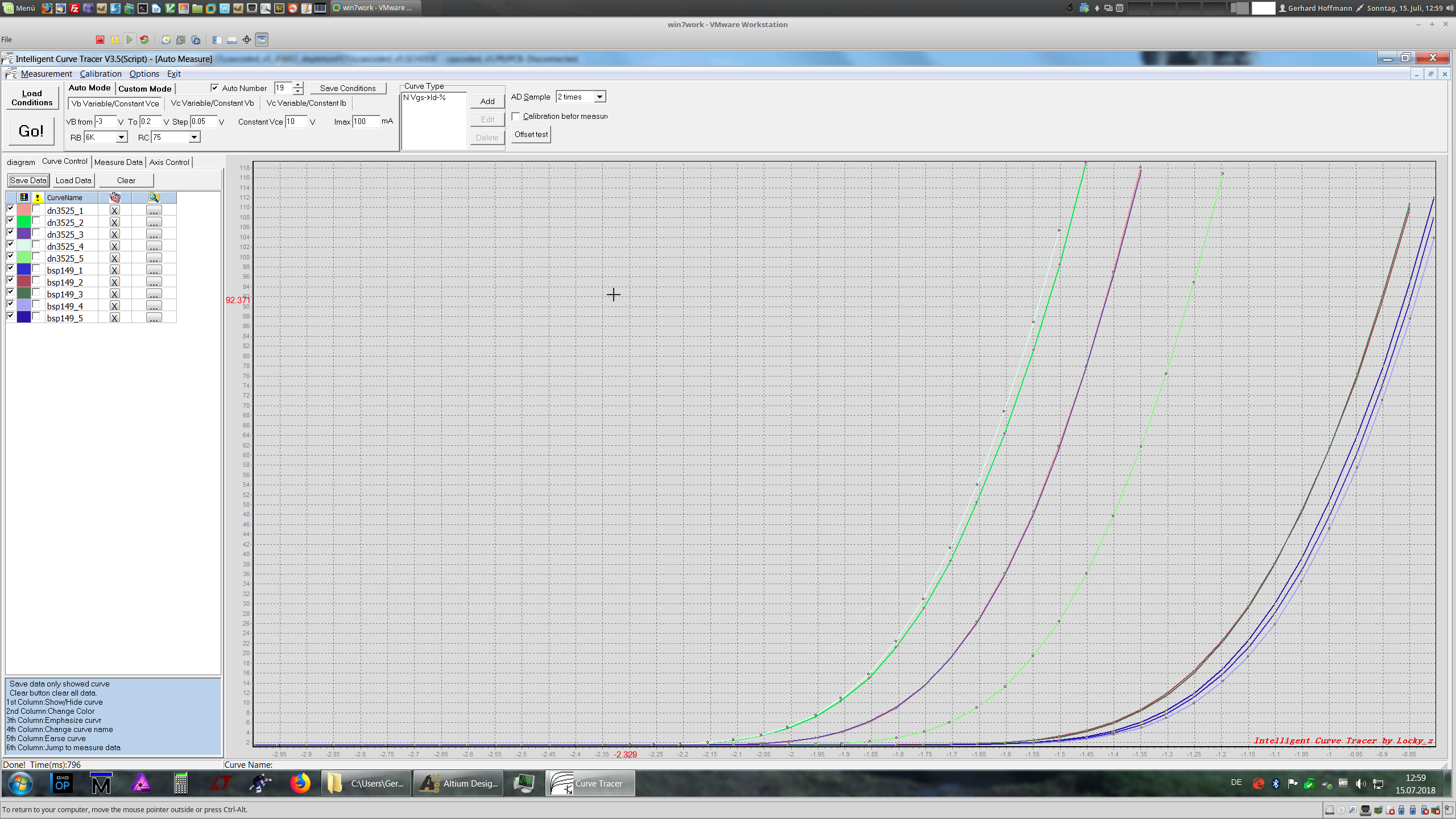

Some other depletion FETs from this week's DigiKey box of wonders seem
to fit better. The Infineon devices have much less spread, that would be
nice for a CCS, but the voltage is quite small for a cascode/bootstrap.
That Locky-Z curve tracer delivers questionable results from time to time,
esp. at low voltage / high current. Weird.

Yes, adding a few ohms in parallel with the input inductors is a good idea.
Yes, it limits the damage done by the on-board ferrite bead, but an external
undampened inductance still will make the amplifier oscillate. The negative
impedance, when looking into the gate, is still there.

The standard textbook technique for suppressing VHF/UHF oscillation dating back before semiconductors was to use a "grid (gate/base) stopper" resistor. In low noise applications an inductor was placed in parallel with this "stopper" resistor to effectively short it out at frequencies of interest, removing its noise contribution. The resultant series resonance is generally adequately damped by the stopper resistance in parallel with the inductor. The inductor itself isn't there to suppress parasitic oscillation, the resistor is.
The earliest commercial example that immediately springs to mind is the Tek 1A7 10uV/cm differential preamplifier. In that schematic with the inductors bunged in series with some JFET gates I see someone who only has it technically half right.
I checked and neither the 1A7A (the 1A7 used nuvistors) the 7A22 (almost the same) and the 7A13 have inductors or ferrites. The have series resistors, 51 Ohms, which should be enough AND not a noise issue. Things are different when the noise floor requirement is significantly lower.
Normally a ferrite is modeled as an inductor and a resistor since they are usually pretty lossy for these applications. Here is more that you may want to know about ferrites:

Those old Tek plug-ins often went through a lot of revisions, though I might not be correctly remembering the model number and I can't for the life of me find my 1A7A manual right now. If not the 1A7A I'm not sure what other model it might be, but I have studied and repaired a low-bandwidth, uV-level sensitivity unit with a parallel-tube input stage having a grid stopper of several hundred ohms connected in parallel with an inductor of several uH. IIRC for the inductance the grid stopper resistor was used as a former.
The ugly thing about the beads is that at low frequencies they are just a high-Q inductor and at high frequencies they do not short the damping resistor anymore. And their intended losses produce noise also, they can be modeled as a series resistance.

Have you built the circuit yet?

- Why do you need a servo if you have C1 DC block? The servo would only mess the input stage, the DC loop is broken.
