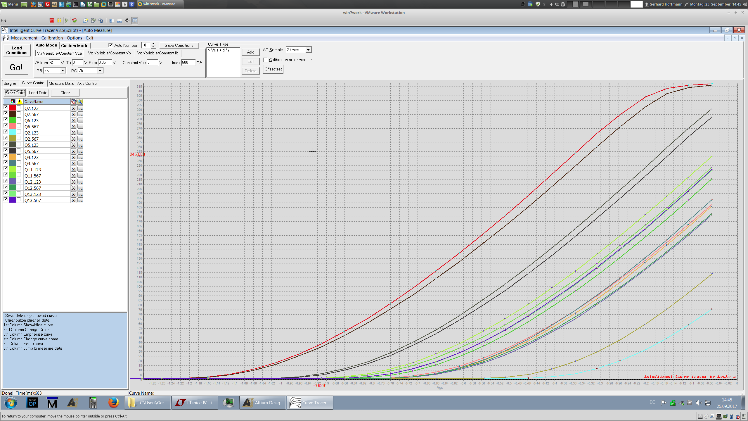

Art Of Electronics III has plots of Vbe for the Zetexes; I include the relevant
pages. They cannot replace the book, so I hope Winfield will forgive me
when I meet him on usenet sci.electronics.design.

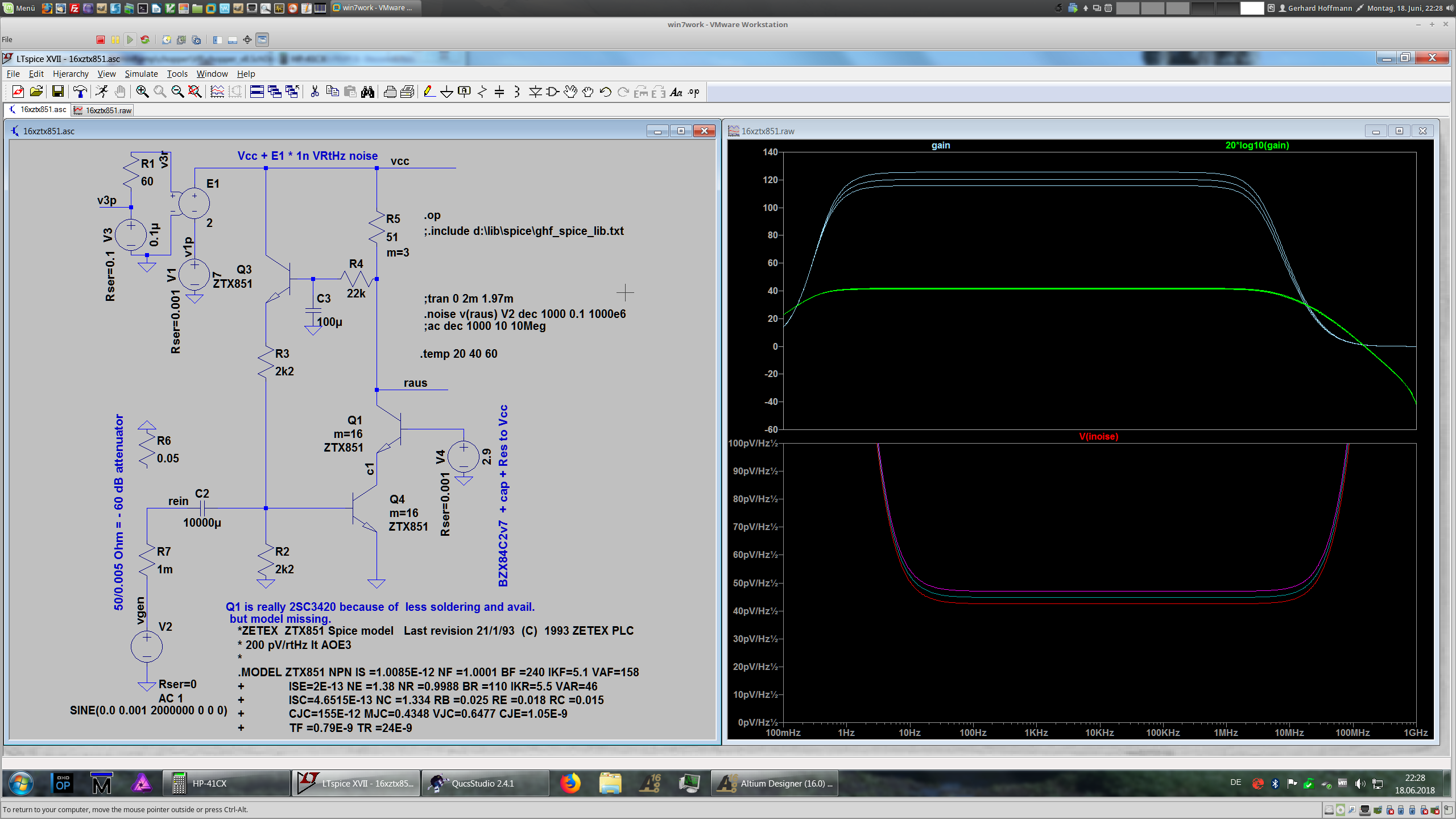

Oh, this explains battery feeding, PSRR is virtually zero. Otherwise you would need an 1000 quid AC mains filter.
And it has feedback, only that it's @ DC. So it can't sound good.
PSSR is not 0, but it is not much.

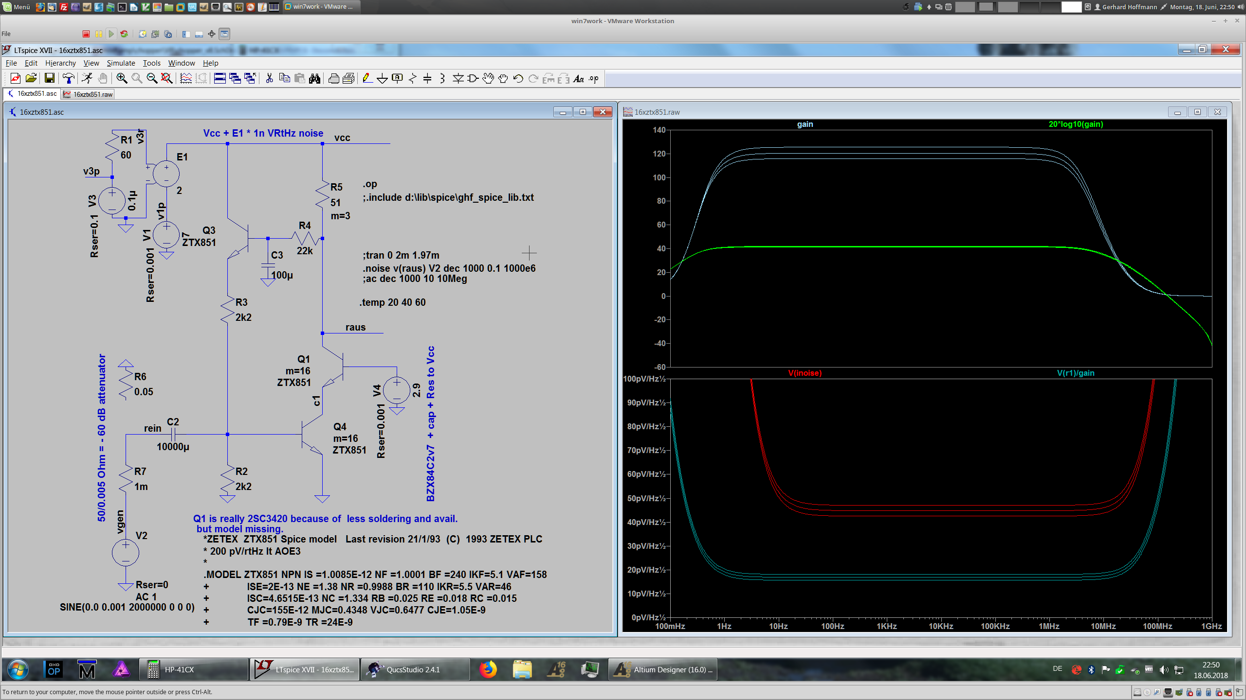

R1 delivers 1nV/rt Hz, it is amplified to 2 nV/rt Hz by the VcVS. (LT3042 performance)
The blue line is then the contribution of the 2nV/rt Hz on Vcc to the output.
Abt. 20 pV/rtHz referred to input.
That's kind of a "noise gain" not PSRR. For PSSR=dVo/dVcc use an AC source as power supply, set Vac=1V and Vdc=Vcc. Then frequency sweep the AC and see what you get heraus. That's the PSRR. My back of napkin calculation shows a PSRR of 1, that is, 0dB at the output. Of course, if you divide this by the stage gain, you get some "input referred" PSRR, but that would be a strange metric.

And BTW, using the same expensive ZTX851 for the cascode is a not needed luxury; the cascode device doesn't need to be low noise, it's contribution to the input referred noise is very small. Any medium power device in TO252 and a little bit of PCB copper for cooling will do in that position.
