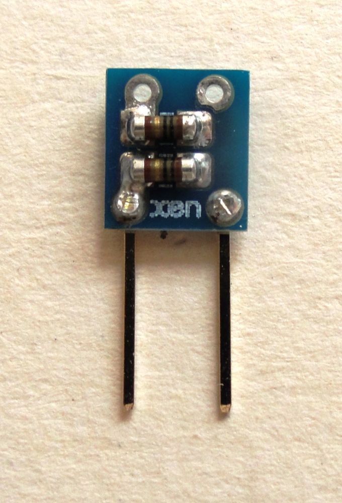

My version of the G = 1000 low noise measurement amp (for Ikoflexer)
A low distortion alternative to Vishay S102 or Caddock MK132 -- 4x Beyschlag in series-parallel.
Almost same dimensions, just a bit thicker.

If the S102 has an advantage because of their lowest tempco, then you would expect that advantage t be more at higher voltage level ?
Not that I am claiming that the MELFs are a better resistor.
But they seem quite good to say the least, especially for the price.
Patrick
The problems with the Vishay metal foil resistors happen where the thermal time constants of the foil and substrate diverge the most, low audio frequencies. The good tempco of the s102 is from the balance between the substrate and the foil but wherenthe substrate doesn't track the foil fast enough you get the nonlinearity.
My guess is that there are some through hole resistors (rn60?) that may be as good in distortion but poorer in tempco. And way cheaper than s102's.

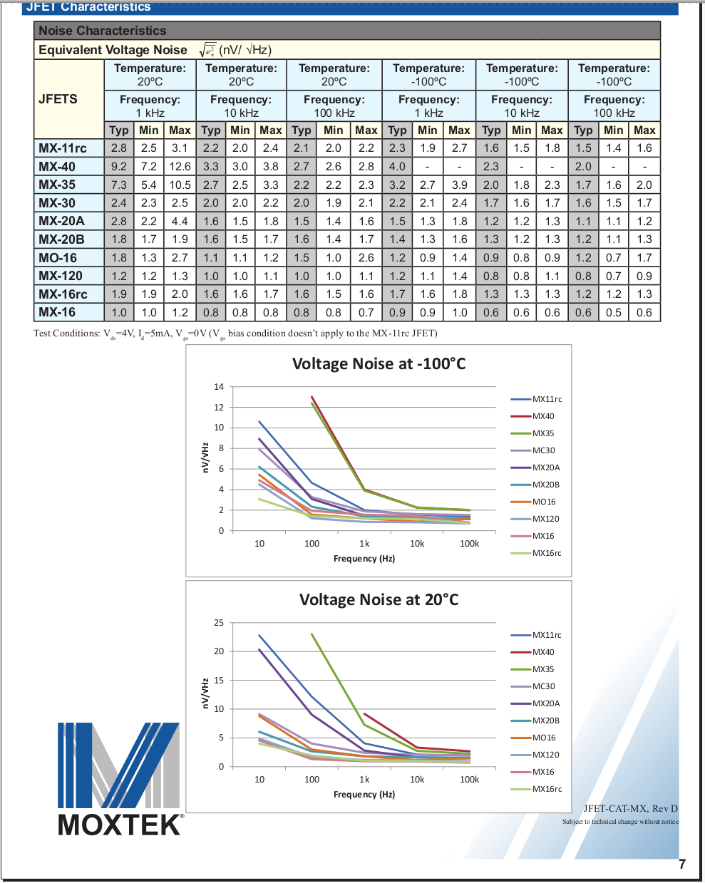

Has anybody here managed to buy or even to test these JFETs?
I have their catalog in .pdf, but on their website they must have
hidden them carefully.
We bought some die but the MEMS mic group was sold before we got to play with them, they were VERY expensive IIRC.
gerhard,
Just as a follow up, the context was that one of the MEMS guys wanted to mock up a naked mic element and JFET charge amplifier. Those FET's in die form had a feedback capacitor for this purpose included and their gm/C FOM was quite good.
it was simply a quick way to evaluate a topology. This would have been one way to increase dynamic range from the simple back to back diodes on a MOSFET gate. I honestly remember the samples were in the $200 each range.
OUCH!
Selecting somewhat similar IF3602s already hurts enough!
Do you think that the Microchip LND150N8G would make a good cascode
for the IF3602 ?
The MMBFJ310 seems to work nicely for BF862-class, but I'd like
to run the IF3602 at more current. They may sweat a little bit for their money. 😀
But when I see the improvement at -100°C on the picture above, it might
make more sense to use the current for a Peltier cooler. If it wasn't such
a mess with the condensing water!
