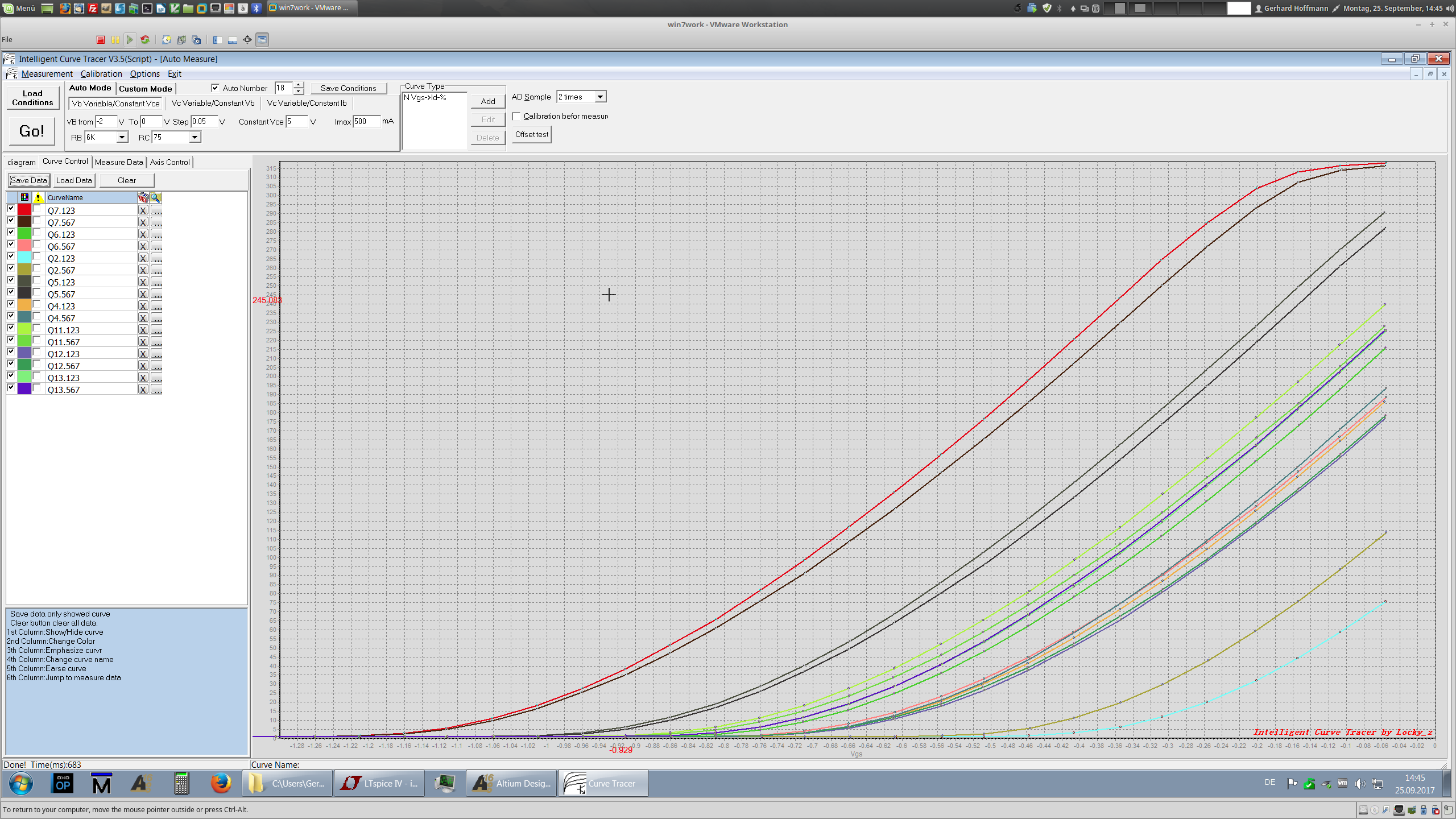

I finally have tried to use the curve tracer over this weekend.
You seem to be right.
Could it be that Locky_Z is really Vroomfondel from my .sig?
Not a single result that seems to make sense, never twice the same answer.

For curve tracing FETs, the simplest is to use a 2-channel storage scope, plus a functions generator to drive the gate.
I use 100Hz and adjust the amplitude DC offset to get the range of Id I want.
Current is measured across a sensing resistor (50R S102) at the source.
It is necessary though to have a scope with more than 8 bit resolution.
Mine has 14 bit, and I measure 2x complete cycle with 2000 points.
The data is then fitted by a 6th order polynomial, e.g. in Excel.
Once you have set it up, it is real quick and easy.
Patrick

Oh, my scopes all have only 8 bits, and none has less than 2.2 GHz bandwidth
But I'm working on a 14 bit digitizer with 1250 MSPS and 2 GHz BW.
But this morning, I continued playing with the Locky-z. With JFETs I had more luck than with the 2N2222.
Still should be taken with a grain of salt, results from 8 IF3602 JFET pairs:
