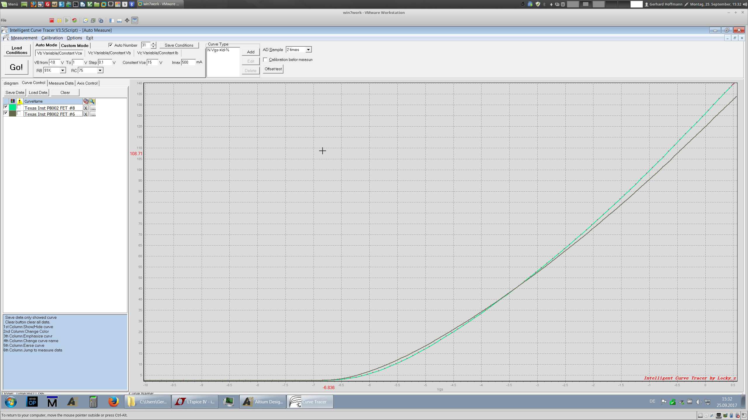

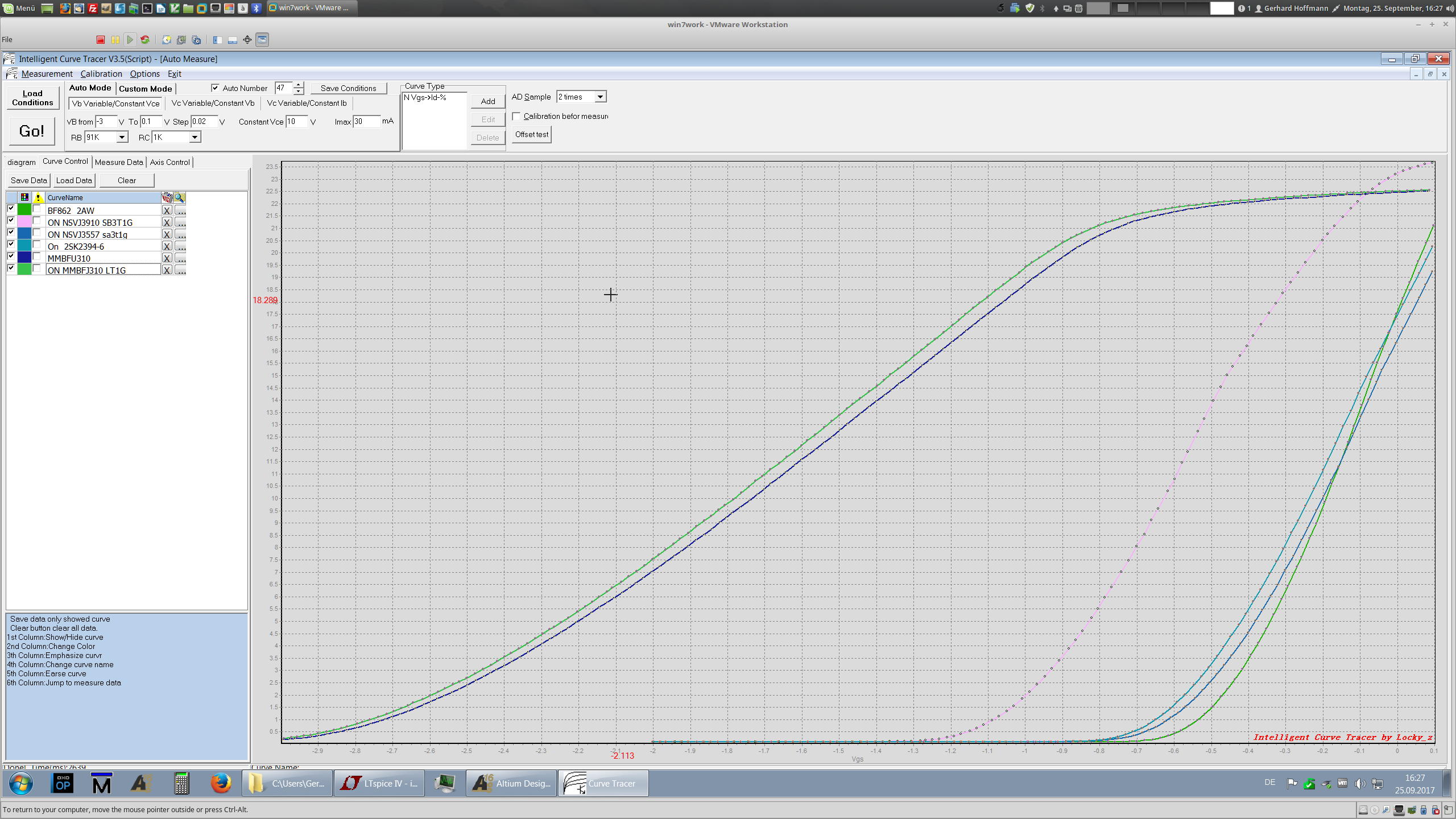

Occasionally I get unexpectedly screwy I-V curves from my Locky-Z, that can be made normal again by installing anti-oscillation capacitors across various pins. Since the display is not a real time oscilloscope, oscillatory "fuzz" is not visible. And averaging the results with "AD_Samples=N" attenuates this further.
Are you trying to derive models or just match pairs etc? When I had to set up to match pairs for Spectral production many years ago the simplest was to set up the operating conditions for the fets using an opamp to set them as current sources and then measure the gate voltage at the target current. Its very simple and works quite well.
If you are sorting for noise you could add the cascode to define the drain voltage and measure the noise across the load resistor at critical frequencies (Quan-tech style) or just look at the spectrum. I once used an LED spectrum analyzer ('80s style) I picked up from a thrift store for a readout. This doesn't necessary tell you the GM but adding a small tone at the input would on the fft or readout.
At least I can check if the models available behave similar
to the real thing. The IF3601/3602 cannot be represented by a single model,
it strays just too much.

Does anybody know if the Locky-Z makes pulse measurements or if it
just cranks up the current with 100% duty cycle? That would distort the curves
because of thermal effects.
@ Mark: yes, oscillations might be a problem.
Not pulsed. So thermal effects and the stability of the connectors account for most of the variations i came across. The unit needs to stabilise for about 3-4 mins after switch on. Measuring a fixed resistor across DS (CE) using the locky_z did a lot for my sanity...

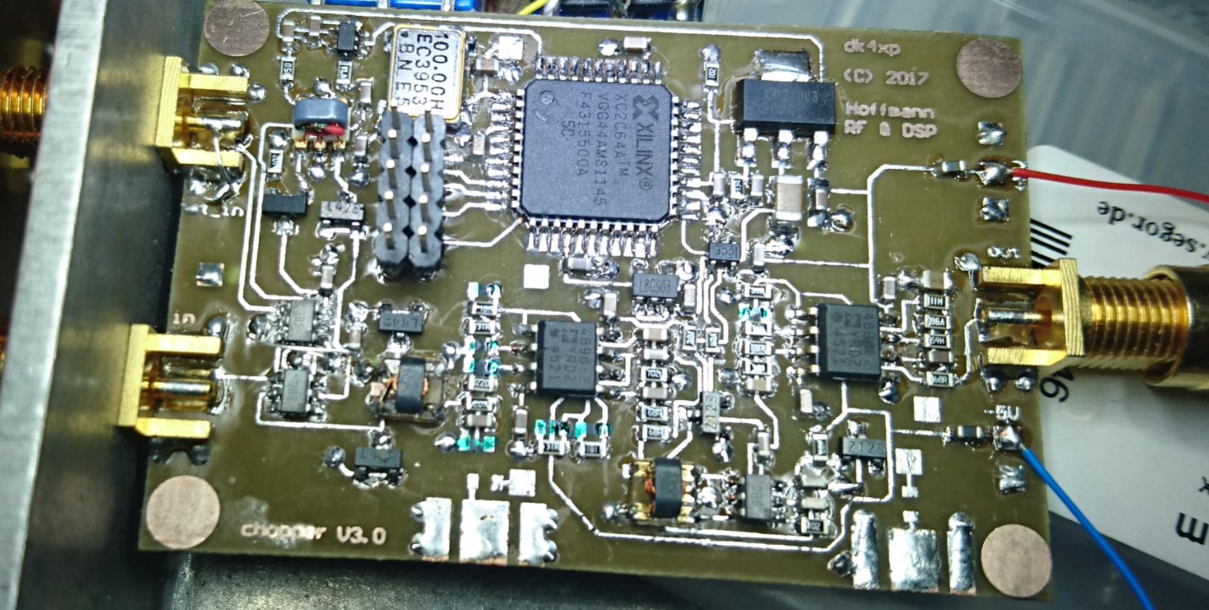

BTW my chopper does not work like most integrated choppers
via offset correction; I just chop the input, transform upwards
with 1:32 turns, amplify another 40 dB and unchop again
with the same clock, optionally shifted by n*5 nsec to make up
for the amplifier delay. That is done in a small CPLD, so I'm
flexible in the choice of frequencies.
There is no global feedback, must sound really good! 😉
I have played again with the chopper. Spent 3 hours last night on the
secondary of the input transformer. I gave up after 52 turns of 50 um CuL wire.
The wire would always turn into a knot or break with just a little bit too much force 😡
Unfortunately it turned out that my FFT analyzer is limiting me at these low frequencies.
I cannot turn up the preamp gain further without overdriving it. The noise of the
analyzer does not come from the input; it stays the same between short & open.
I think it comes from its synthesizer; it is made to check complicated modulations
at up to 2.7 GHz.
Any ideas of FFT analyzers that shine @ < 100 Hz???
Nevertheless, here are first results. The upper frequency corner is determined
by a MFB low pass at 15 KHz or so, that is arbitrary, I wanted to make sure that
nothing of the 500 KHz chopping clock comes through.
The blue line is just the Agilent 89441A analyzer with a short on its input. That
is currently my measurement limit.
The green line is the chopper amplifier with its input shorted, the red line is the
noise of a 15 Ohm resistor on the input. 15 Ohm is abt. 500pV/rtHz.
The amplifier is 10 dB quieter, that should be near 150 pV/rtHz. I think
this is not yet the limit. More turns on the secondary or paralleling the
first ADA4898 might help. Also the ADG819 FET switches have half
an Ohm, there are 2 of them in series on the input side. Replicating
them should help a little, but not on a home-etched board. 😀
The input is differential and floating; power, clock and signal
go through transformers. Power is the rectified clock, just 2 Schottkies
and caps for +/- 2.4V. The ADG819 needs only symbolic Vdd/Vss.
The absolute values given in the title of the plot do not apply,
only relative dB.
