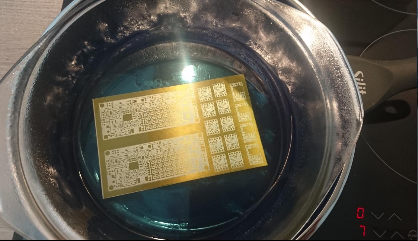

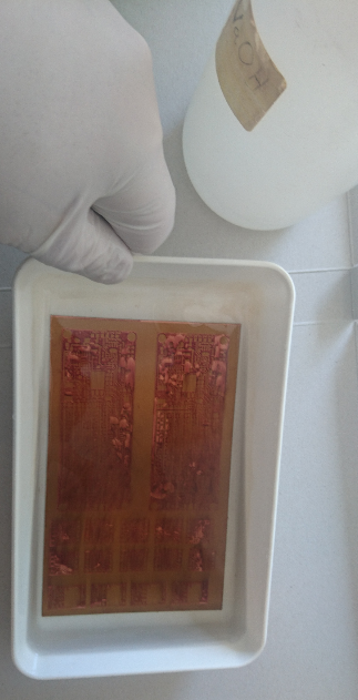

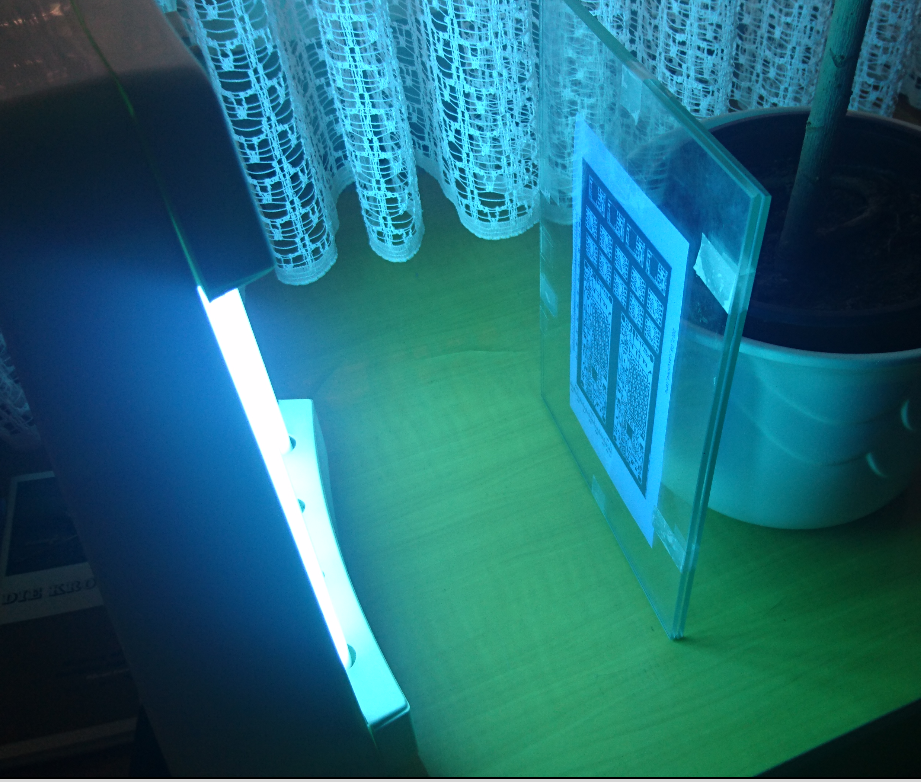

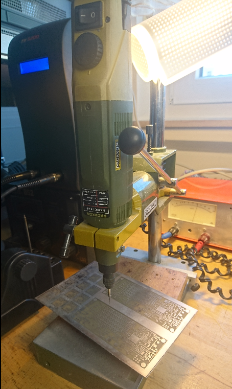

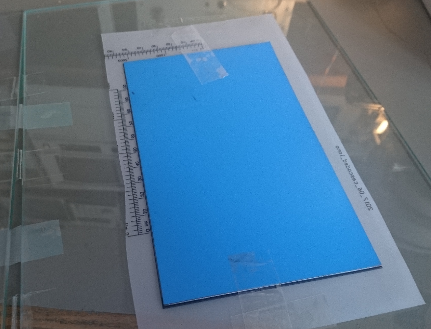

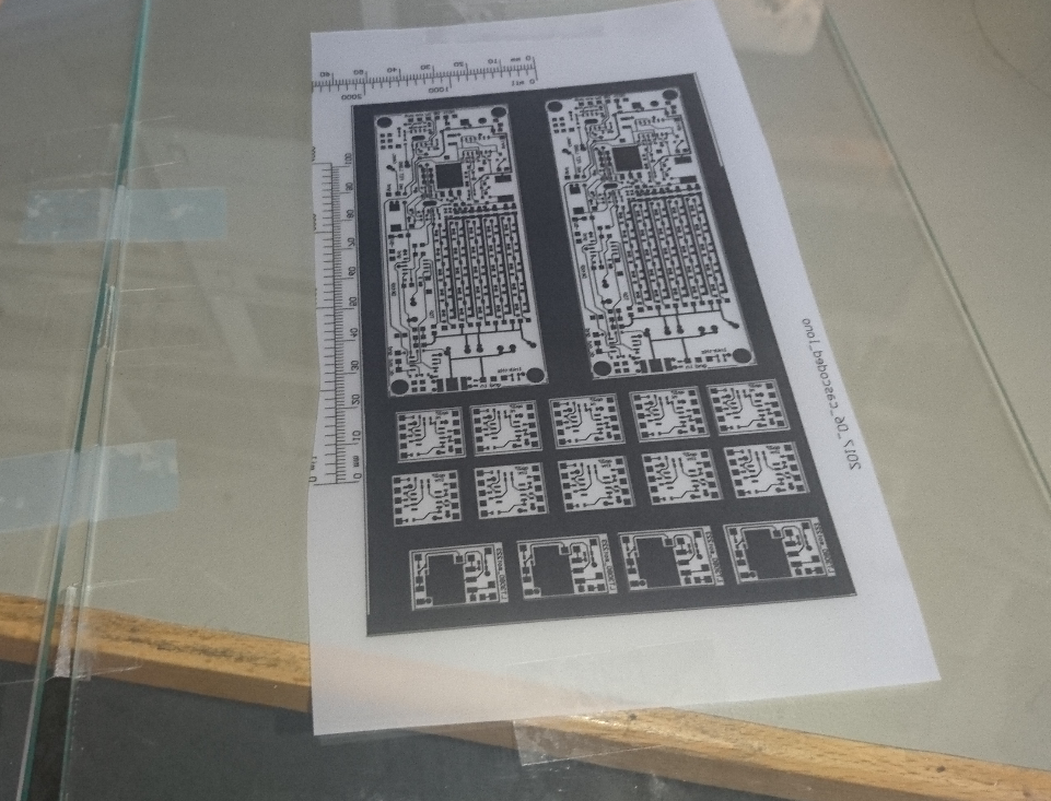

And since this is DIY, here are some pics "The Making Of"

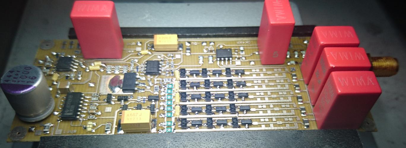

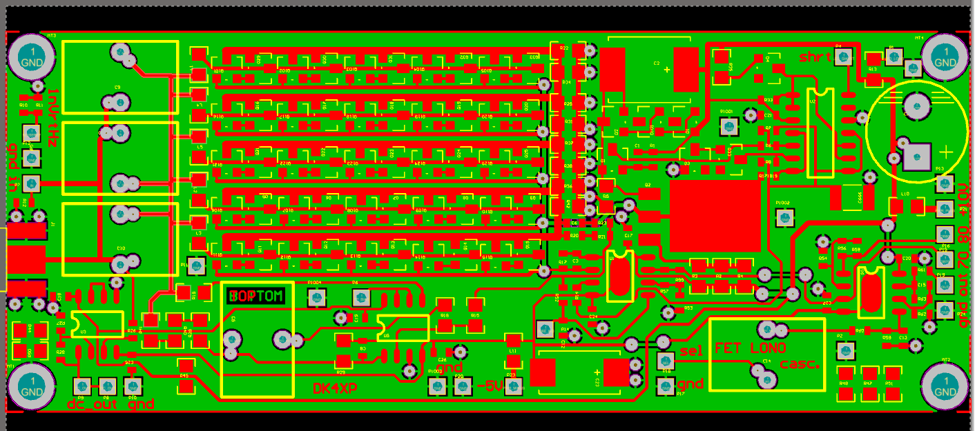

We had some bank holidays here, so i could spend some time on the Fet low noise amplifier. No matter what I do, it has somewhere negative input impedance and it
will oscillate with the right inductor across the input.
Circuit is nothing fancy: CS fet stage, cascode, TIA for loop gain, feedback 1000:1 or so
back to the source. The cascode is biased by a current source.
The usual remedy, a base stopper resistor defies the purpose of a low noise amplifier.
So far, I have made several versions: one with 2 pairs of IF3602 or many BF862 and
a bipolar cascode and a different one with upto 25 pcs. 2SK2394-6 or BF862 , each
with a MMBFJ310 cascode transistor of its own. That is easy because the 310 gate
can directly be attached to the 2SK2394 source without any ado about biasing.
I have used only 15 pairs because I didn't have enough MMBFJ310.
The IF3602 version was kinda hopeless already without any attempt at bootstrapping;
the 2394/310 pair has the bootstrapping for free and looks much friendlier.

I have also tried Würth 600 Ohm 0805 beads as gate stoppers; they don't damp
anything, they behave like pure inductors. One bead for all 15 transistors made
the input inductive at high frequency, the trajectory went clockwise to the upper half,
following the circle.
Somehow I feel it is wrong to call the input fet common source. The drain
looks into the low impedance of the cascode and the source follows the
input voltage by the action of the feedback. So the FET does not see 0.2 Ohm
to ground but a synthesized current source. From its point of view it could
be called source follower at any time.
Any ideas about how to tame such a thing?

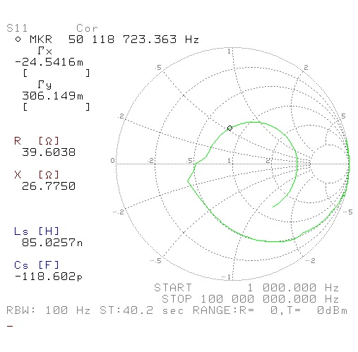

Attached is my measurements, 1Khz-100MHz S11.
8 x BF862 in parallel, bipolar cascoded, opamp is OPA132 (not 100% sure, didn't open the case to check), compensated as described with 100nF in series with 22ohm, gate inductors are 1.2uH 0.5ohm ESR, closed loop gain is 1000, phase correction cap is 100pF, noise 0.33nV/rtHz, corner frequency around 400Hz, completely different servo.
And yes, it does oscillate with inductors lower than 500nH or even with 2.2uH with very low ESR (under 0.2ohm).
As you see, absolutely no problem.
Nono, if it is not unconditionally stable, that's definitely a problem for
a measurement amplifier.
I could get the IF3602 amplifier into a state where I could measure its
noise, but when it oscillates under only slightly non-optimum conditions,
then it is part of the problem, not part of the solution.
