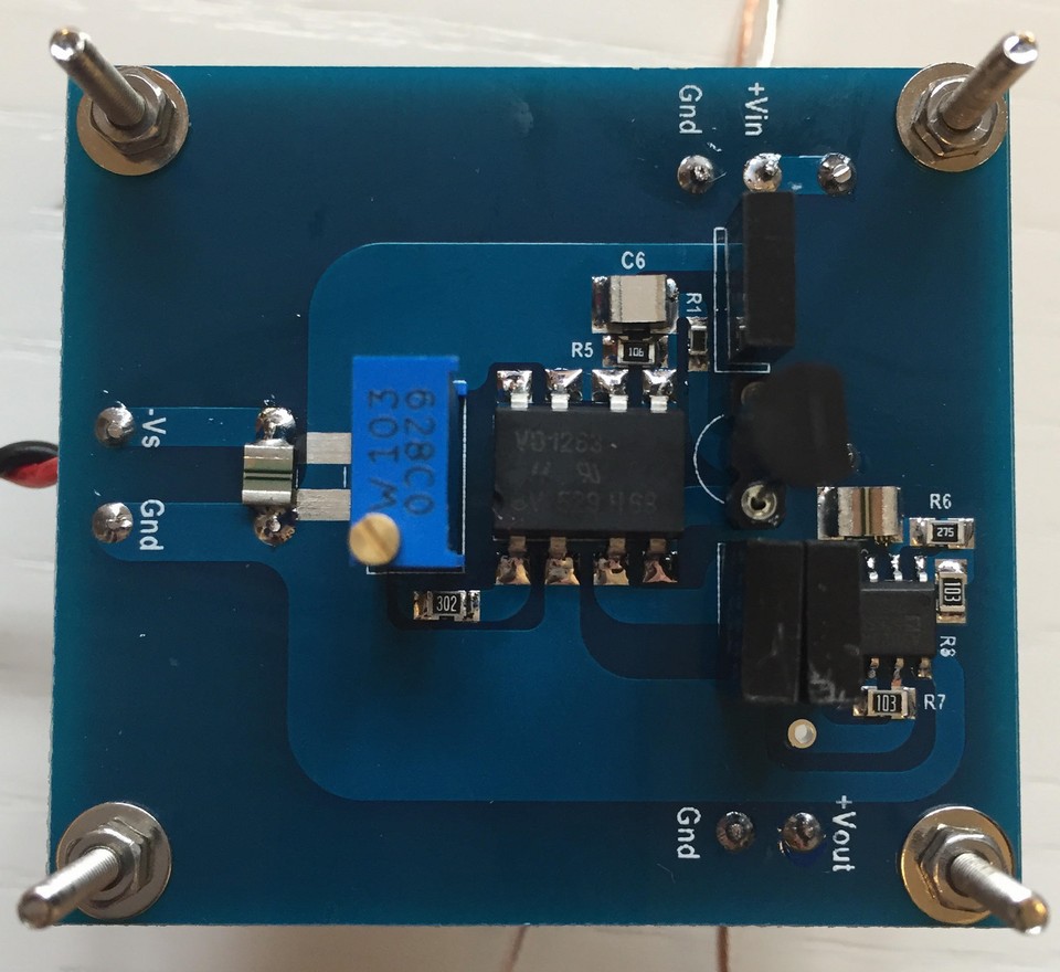

can the 3pin plug in be used to check the noise of BJT?
or does the Wurcer LNA only work for jFETs?
If you can find a way to supply the base current through the high-Z auto biasing circuit.

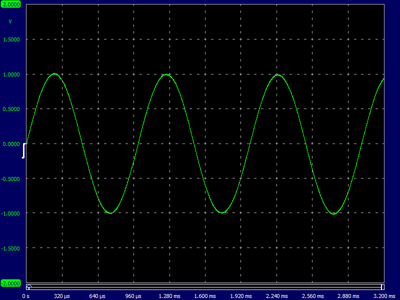

The Wurcer LNA for P-JFETs is working.
Nice work Patrick. You set a high standard.
Input signal was 1mV sine.
More tests to come (noise measurements, etc.)

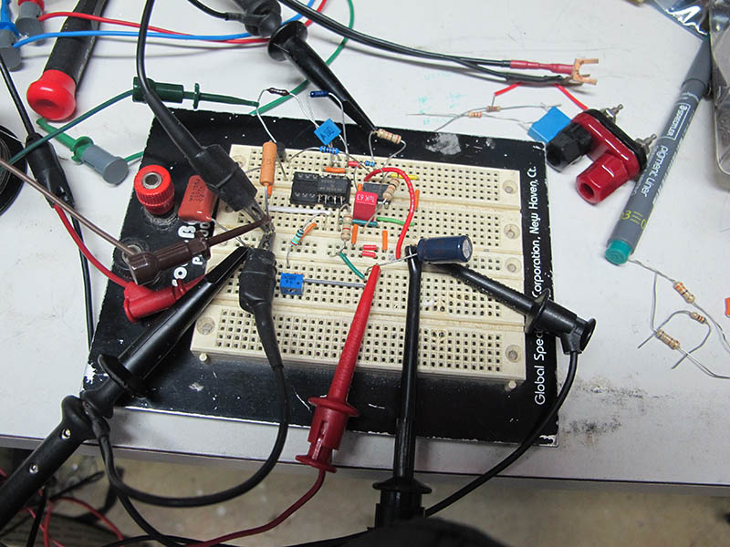

Not the neatest setup. Performance in this breadboarded version is flat from 50Hz to 200kHz @60dB, but rises to a peak of 61.5dB ~16Hz. Note the ultra precise probing technique:
Proto-board abuse 🙂 Everyone needs to learn how to design circuits that are immune to being made on these plug-in boards.
Ummmm... this could be "by design". I can't find the exact schematic, but the original Mr. Wurcer design in #1 appears to have 2 poles at LF, one is C2R6 the other is C5-whatever gives the optocoupler (no idea how the freq response and impedance looks like). If these two poles happen to be close in frequency, when you close the loop the LF response may overshoot. You need a zero to compensate the second pole, a resistor in series with C2 will do.
P.S. The closer the poles are, the higher the overshoot. 1.5dB as reported is not that bad, you can leave it as it is and happily live ever after.
