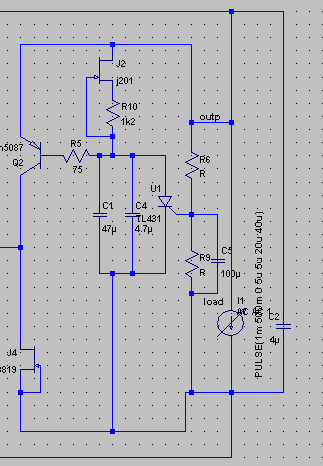

How about replacing R11 with a TL431 (or similar reference)?
Taking it a step further, the input of the TL431 could be fixed to the output, and coupled to Q2 with a low pass filter (rather, slow it down a whole lot because it would just dump indefinite current into the low pass) so that the TL431 manages the output voltage, and the regulator focuses on Zout. (TL431 for DC, Ikoshunt for AC)

kt, I'd worry about noise with the tl431. Would you not? Maybe the ts431 by Taiwan Semi would work here. In any case, it is a solution. For the low voltage version there are several very low noise voltage references that one could use, buried zener, etc.

I wanted to throw that idea in anyways. I would think most noise could be filtered out with RC filters, except at low frequencies (but I don't think that fits with the philosophy here).
What about turning Q2 into a NTP/Rush and feeding the other input with a reference?
you're right about filtering the noise. For instance when I was using a zener, I found that a 1000uF bypass cap got the noise very very low (visually on the scope). But there was still a bit of "grass" tips and was happier to use the jfet solution. Just a personal preference. I haven't tried a tl431 yet, though I got a bunch of them at home. I probably will, besides a few other ideas that I got in improving the regulator. At the moment I have more directions than time to pursue them.
I don't know kt, how does this fix the reference? I'm not dismissing your idea, but unless there is a significant benefit, I would be reluctant to add complexity.
