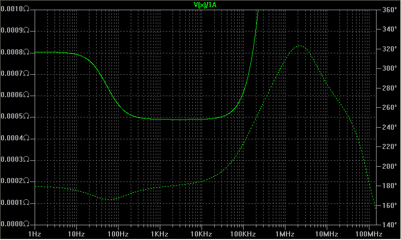

Not much, a really large cap only flattens the curve a few dB at the lower frequencies. With a smaller cap it looks more like a step.
Edit: 100uF cap, Zout plot
A 0.0003 analysis dif could be swamped in a real build very possibly. Was that with just the cap across, or RC with 100R? OTOH leds are for fixed Vout regs only.
