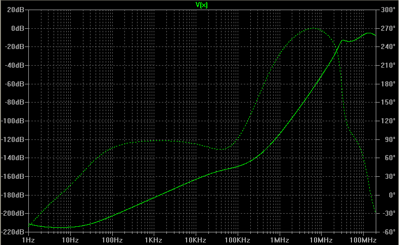

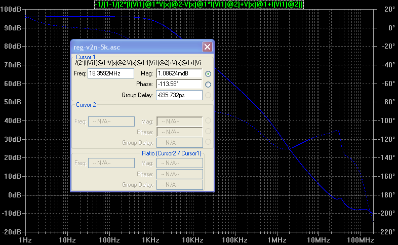

Here we go, another update.
I've been very busy running experiments after Salas let me know about his tests. One thing that got to bother me more was the drift of current/voltage with temperature. So I made a minor change to the CCS to make it more stable. While I was at it I also made a change to increase the phase margin to a value which in theory predicts unconditional stability. All this while maintaining good psrr and low output impedance.
As much as I didn't want to introduce another circuit, especially that I had designed the PCB already, I had to do it, so here it is, below, with some simulated curves. There are more things to say about the circuit, which I'll probably include in the how to document, or answer questions as they come. The output impedance plot changes at low frequency with the value of the Vref bypass capacitor, C2. It's not really practical to have a large value there (the plot shows a 1000uF Zout) because it takes a long time to charge it due to the lowish current that passes through J3. Note the J201 below Q3. One can use other jfets there, 2n3819, 2sk170, etc. It's not a fussy position, but the Idss current is important, so whatever you use to replace J201 make sure Q3 can dissipate the power (voltage across it times Idss). The mini-CCS now employs a J310 on top of the 2sk170, so people won't complain any longer about the proper way of doing it (meaning the top jfet should have higher pinch-off voltage and Idss than the lower mosfet, and the current through should be about 15-30% of Idss).
J4 should have Idss from 6 to 9mA.
Just like before, other mosfets can be used. For higher voltages somethings else should be used for Q3, perhaps a BC550 or equivalent. The way it's presented here should work fine up to 20 something volts out. As for the current limit, it's set via R1. R1 is rougly equal to the sum of the forward voltage of the LED plus the Vbe of Q4, divided by the current limit desired. For very high current loads the circuit needs to be changed a bit, and I'll post later the modifications.
NB: Q1 and Q2 are MPSH81, Q3 and Q4 are 2N5088, M1 and M2 are IRFBC40
I will re-design the PCB as soon as possible if people are still interested.
This circuit was tested in reality for stability and noise for the last few days. The only change is that I've used a 2sk170 for J5 but will test again tonight with a J201, which is easier to find.
Better ripple rejection than before, and increased CCS stability.
Sub-milliOhm output impedance in the audio range and a bit beyond.
Theoretically the phase margin is about 66 degrees, which should qualify the design as stable. Note that no compensation capacitors are used on the cascode bjts Q1 and Q2.
