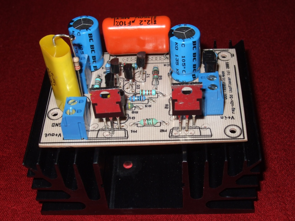

So I run a test on V2. That was a test on a simplistic 36V B+ phono. As far as I know, it it was not tested before for such Vout, the 2N5088 Q1 would not take it, and the 33k R11, R9 would have to change too. I used a BC550C (reversed for pins) for Q1, 68k for R9, R11. Two low Vf red leds also. The input voltage was 43.5V, again something narrow considering the recommendation for more around the mini CCS that biases the first Mosfet. I put an MKT cap for output with a 0.22R resistor in series for chemical cap like losses. I did not have a circa 4uF electrolytic.

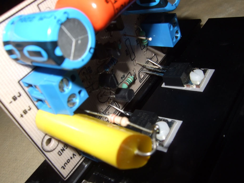

The proto board that I was sent is nice, things fit in place. I would change the proximity of the Mosfets nearer to its edge because it took enough careful manipulation with pliers so they get bended both for the way their legs go and to be in line with the board's edge. Also the input socket has both pins on Vin+, ground has to go to the other side, and I am afraid someone would short the PSU there if not have read some instructions. One connection must be left blank IMO.
I used a 1R in series with Vin to monitor the current draw in mA translated to mV across it. 1k5 5W for dummy load and another DVM on it to monitor Vout. A 4k7 trimmer on long pins initially installed in R2's place. Started it at 500R so to be sure it would start very low for CCS current.
It was a pig to set. I would prefer trimmers for R2,R10 on the final PCB. Around 1k ''R2'' I got 220mA, Vout took time to climb. Current was always drifting slowly for more after the Mosfets got warmer. R10 took some iterations to find with the particular IDSS of J2 and asked Vout. Used a small corrective additional to the main value. Due to the long time for Vout to climb, the input current was reaching an almost alarming value for a little while and drop down when Vout was near its most 3rd. When I took it down to 150mA by using 1k fixed R2 in parallel with 10k, it looked steadier for ICCS. I looked with the scope, did not see oscillation traces with my just 20Mhz scope. That was with or without a 10p NPO comp cap across Q3's C,B. After a while it was steady for heat and readings, I connected the real load. Was OK on it for a while. Went on connecting gear to run FFT. Saw excessive THD upon first run, quickly I checked B+. Had climbed to 40.5V. Shut it down. Next power up, just 5V, smoke, Mosfets went BBQ in a matter of half a second. Grief. It just committed suicide. Left it for next day...
Just 2 Mosfets left don't allow for more smoke luxury. My best guess was a possibly faulty J2. Changed the Mosfets and J2. This time C1 got down to 47uF and the 220uF went to Cout's place. That slow Vout rise must have been the 260uA J201's (J2) current trying to charge the large cap. Might have been faster and safer in 15V regs with 220uF that have been tested by now, but at 36V?
J201 must have had a good discharge on it at a point when with the 220uF... Also the more than likely drift in the CCS when set over 200mA seems it was I did not have enough Vin-Vout around the mini CCS cascode...It worked steady now. The Vout climbed much much faster with the 47uF and the current did not have a chance to shoot up and go down again. I kept it under 150mA and was good for drift. Good news is that the noise floor on FFTs with the phono was the same as with V1.
Listened enough with it. Very good resolution, very good focus, very good tempo. I miss a bit more body and limpness. Maybe its a system thing and its just neutral though. And of course I have to listen more.

You can not fit 2 side by side. Keep in mind that the Mosfets eye to eye distance is 2.8cm on that proto.

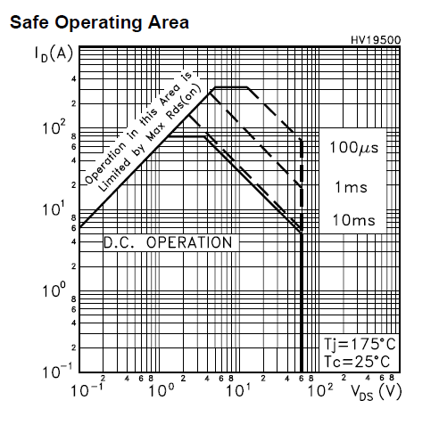

I was talking recently to another member about a high power (4A at 25V) version of the regulator. Perhaps it would be relevant here too.
Let's see, 4A at 25V output would mean the shunt mosfet sees the full 25V and has to be able to pass 4A to ground in case the load isn't drawing any power. That would mean the mosfet has to dissipate 100W. First, the mosfet has to be chosen accordingly. Looking at the mosfet description is not enough. For instance the IRFBC40 is rated at 6A and 600V, BUT NOT BOTH AT THE SAME TIME, AND NOT AT ALL TEMPERATURES!!! What we need is to look at the data sheet and find the safe operating area (SOA) graph. Let's make it easy and look at the STW80NF06 mosfet. At first sight you'd think this is overkill, at 60V and 80A rating. But have a look at the attached SOA graph, and follow the DC line. At 25V DC operation seems safe up to about 10A. But, this is at a case temperature of 25C. That's just not going to happen. This thing will get hotter.
So let's look at how to calculate the heat sink thermal resistance, which is what's needed when choosing a heat sink. The formula for calculating the thermal resistance between sink and air is:
theta_sa < (Tj - Ta)/P - (theta_jc + theta_cs)
Where:
* theta_sa = thermal resistance from heat sink to ambient (this is what we want to calculate)
* theta_jc =thermal resistance of mosfet junction to its case, given in the data sheet, for STW80NF06 = 0.5 C/W
* theta_cs = thermal resistance between mosfet case and heat sink, estimated = 0.09 C/W if thermal conductive paste is used and good contact is made
* P = power to dissipate, let's assume 120W
*Tj = max junction temperature for this mosfet = 175 C
*Ta = max ambient temperature, let's estimate = 70 C
If you plug these numbers in the formula you get theta_sa = 0.285 C/W. So the heat sink should have a thermal resistance that is smaller than 0.285 C/W.
How about the IRFBC40 in a to-220 package, with 17V drop at 200mA, or 3.4W dissipation? From the data sheet:
* Tj = 150 C
* theta_jc = 1 C/W
We'll assume the other numbers as before. Then
theta_sa < (150-70)/3.4 - (1 + 0.09) = 22.44 C/W
This means the heat sink that fff0 showed above, rated at 7 C/W, is adequate.
Hope this helps.

wow.. Salas, is it necssary to use such huge heatsink for 200ma?
Had in mind about 9W in total do dissipate (36Vout) and just had that sink. Its not that big, the board on it on the photo is quite small.
