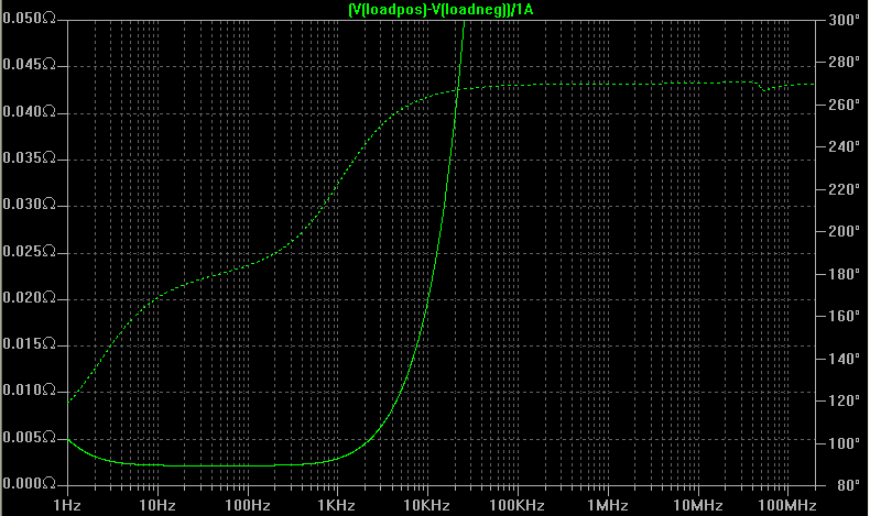

To illustrate what happens, here's an output impedance simulation of the circuit with 15cm long wires (1.5mm diameter) between the regulator and the load. The sense wires are connected with short traces on the pcb, rs- goes to ground, rs+ goes to Vout.
The output impedance looks like this. About 20 milliohm at 10 kHz and 40 milliohm at 20kHz. Gone is the promised sub milliohm output impedance.

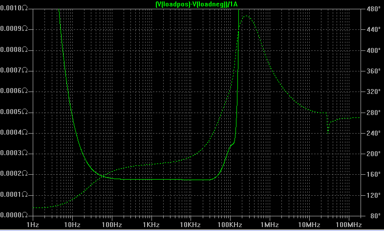

In contrast, connecting the remote sense wires (rs- and rs+) directly to the load, AND using a bit of compensation on those wires as well, which I'll talk about later.
