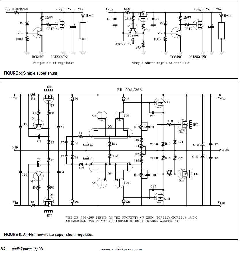

May I ask which which other regulator had monster bass?

"Monster Bass" reg was the simplistic reg I found in an old audioXpress article on the web (Figure 5, p. 32,). Attached. My initial plan was to build a borbely super shunt, which I am still working on- some parts seem very hard to find though. Especially, Toshibas dual P-channel jfets! The other much simpler circuits worked well but were noisy. The "better" bass performance might have simply been due different current settings, etc. I did not properly compare the two designs side by side.
Please disregard my "lacking bass" comment! I will need way more experimenting time to be able to really say anything about the ikoflexer reg.

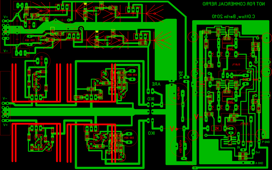

I have drawn a PCB layout containing IKO's and Are's regulators as well as my own simplified preamp design featuring two of my own discrete opamps (vertical mount SK99bv mod from the nice SK99b from Soundskultor), bootstrap, servos, etc.. Are' reg is top left, Iko's below, preamp is on the right.
If you have time, please check the regulator PCB designs for errors. Attached is a PNG, which might mot be good enough, there is also a link to the full size 600dpi bmp.
Link: http://www.christianottow.de/Shunt-Reg-Comparison/Shunt shoot out + VV9910 cottow.BMP
25MB size! Server Speed is ok though....
Also, since I am a beginner in all this, some suggestions for good layout would be awesome, too. 🙂
Thanks, best regards
Christian
I think you should mount the output capacitor at the very output of the regulator. You have very long traces for Vin and Vout. Since you took the effort to place the preamp on the same pcb as the regulator, you could take advantage of this and make it so that the distance from reg Vout to preamp Vin is not more than 1cm. Possible if you split the two pcbs, and mount the preamp below the regulator, sort of back to back. That's how I'd do it.

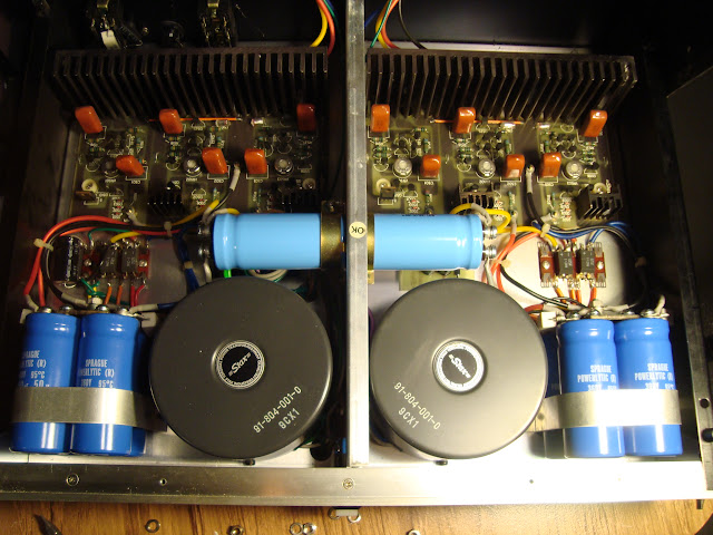

I know I'm a little late to the party here, but here are pics of the original Stax implementation of what they called "super shunt regulation" in my CA-X preamp, for those that are curious (but you're DIYers, of course you're curious!). Yes, that's just the power supply, which looks more suitable for a 100wpc amp. This unit was fixed last year by EchoWars with the help of some guys on here, and I am VERY happy it worked out as the sonics are to die for. Thanks!
Looks very nice! I'm assuming the shunt transistors are on the large heat sinks, what are they? 🙂
yeah, you can just barely see the profile of the three per channel in the middle picture. i will look at the schematics later and see if they specify the transistor. i couldn't get a better picture at the time, unfortunately. because of the way the top cover and upper chassis are designed, the quarters get very tight back there, and it's a major PITA to even access the power supply in the first place. i only opened it up to replace the large cans, and i have no plans of taking it apart again any time soon!
