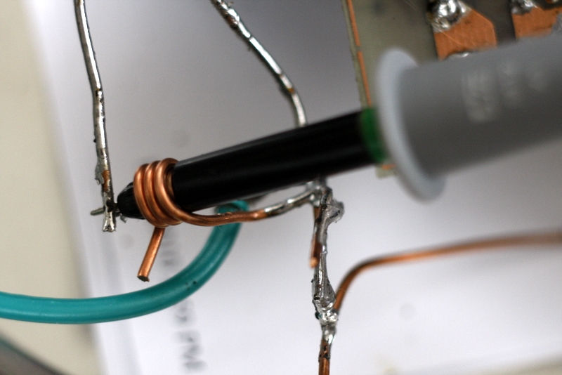

While on the subject of measuring, there's something I'd like to mention again. When measuring such low level signals, everything connected to the measuring point can introduce noise. This includes the scope or voltmeter probe. Attached is an image of how I connect the probe, with a GND wire as short as possible.
