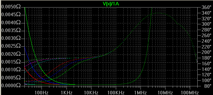

Bill, here the Vref bypass cap is stepped as follows: 1uF, 2.2uF, 4.7uF, 47uF, 100uF, 220uF, 330uF. The green solid line is 1uF, blue 2.2uF, red 4.7uF, ...
This low output impedance, again, has to be qualified. It is only in the perfect world of simulation.
Come on! :smash: I thought there was much to worry about but there is nothing. You are a perfectionist (like me :worship:). The impedance even with 1uF at 20Hz is a plenty lower than most other regulators. I think value above 4.7uF is for deminishing return, wire resistance starts to dominate. I would not put an electrolytic there at all. No wonder I can't find anything wrong with my 1.1uF.
Another three factors here too: 1) most circuits have a much higher PSSR at lower frequencies, only above 500Hz they start getting into trouble; 2) Human hearing is less sensitive outside the 1kHz - 8kHz region; 3) Below 150Hz the room and loudspeaker interaction dominates the distortions.
I will be happily live with my 1.1uF or 2 x 1.1uF :nod:
I am not sure but I don't think the phase shifts of the smaller caps would have any sonic effects. I also guess that the intension of getting the impedance flat down to 20Hz is that, ripples at 20Hz may affect the sonic at higher frequencies, because, ripples are, ripples. I don't have these issues with my active XO because frequency regions are all nicely divided up.
