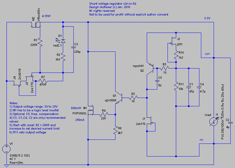

A month later, I built 5d with a newly improved layout. It sounded equally awesome but I saw from my scope that there might be a resonance near 1MHz between 500uV to 800uV peak to peak, which was the limit I could see from my scope so I was not sure. My scope is limited to 0.01V per grid, so even 500uV to 800uV peak to peak would only appear to be a thicker line. But a couple of weeks later I found out what had happened. The regulator did not resonate. It never did (with the limit I can observe from my scope). I had a dirty ground which affects measurements, and the scope is not a high-end one. Even when I turned off the preamp / 5d regulator, and put the probe and the ground wire to the preamp ground (earthed) at the same spot I saw exactly the same thing - a resonance near 1MHz between 500uV to 800uV peak to peak! Turning on or off the regulator makes no difference in the line I see in the scope, doesn’t this show that the regulator has no resonance, and if any, would be lower than 500uV that can’t be seen from my scope?
Of course, there is still a puzzle. Why didn’t I see the resonance of 500uV to 800uV peak to peak in my first round measurements while building 5a? Would my neighbor have recently installed some electrical devices that make my house electricity / ground dirtier? In whichever case, it probably has nothing to do with the regulator.

You can click on Ikoflexer's 5d link and see which C3 in the schematic. Oops, the value is now 220uF.

Although revision 5d works for voltages as low as 3V, the output impedance performance suffered as the voltage got below about eight volts. Here is the circuit which makes the performance for low output voltage as good as that for higher voltage.
This version works well 3V to 28V and can use the same PCB, but one must make sure the shunt mosfet can dissipate the heat. The shunt mosfet must be a logic level mosfet, meaning its threshold voltage V(th) should be small, typically between one and two volts. I tested it with a PHP3N20L but other mosfets should work, e.g. IRLU120. In the light of recent criticism that the design oscillates this time I decided to include C5, the frequency compensation capacitor. I hope a phase margin greater than 65 degrees will satisfy everyone.
Please do not take the capacitor values as set. Take them only as values in the ball park. These should work though, as shown, except for C2, the output cap whose value of 4uF should be taken as some ideal that we'd like to have, but a higher value would be more realistic. For instance my prototype used a 3.3uF film cap, and it worked fine. Those of you who don't have access to an oscilloscope to optimize this cap should use a higher value, 47uF, 100uF, etc.
There's probably something I forgot to mention, but I'll add some more comments later and answer questions if there are any.

this does sure look promising! Did you build it already? J2 is working at zero tempco, I guess? This is very low noise, but I had problems with drift with such a scheme despite a very careful adust procedure (with 2sk246).
I wonder as well how good the 'kelvin' connection for the voltage ref part will work. I had the impression, it was not as stiff as one would hope.

Yes, built, tested, and stable. J2 works near zero tempco. I think it's too much hassle for a hobbyist to try and find the zero tempco (by adjusting R10). It is indeed very low noise, much more so than a zener diode. It also drifts a bit with temperature changes (millivolts), which is something that I accepted. My thinking is that for most audio circuits a few millivolts deviation should not make a difference. I'd rather have this than the noise of the zener. One can easily modify the circuit to use an ultra-low noise voltage reference if no temperature drifting is required. If I was building an measurement instrument that needs to stay within calibration I'd definitely do that.

The sensing works. Tested in the real circuit, no oscillation if that is what you mean by "not stiff." Are you referring to something else?

Edit: I don't really get the intention of your message though. Should I delete the circuit and just point to the simplistic? The reason for posting it is because I was able to get the output impedance below 1mOhm at low voltage, which was not the case with 5d, even though 5d will have better performance at voltages above 10V.
Of course it is, because I started with the simplistic and made changes to achieve what I was looking for; some of the changes are in the topology of the error amp, some are not as significant. At some point even the little details will make or break a circuit. Some could complain that this is bad engineering. So be it, everyone's entitled to an opinion. Here's a summary of what happened after I came in contact with the excellent Simplistic of Salas.
For wider output impedance bandwidth I added the bjt buffer before the shunt mosfet. The output impedance was curving up beyond 10kHz before, but after adding the buffer it became flat in the audio frequency (better phase profile too) and beyond.
Then I changed the error amp to a cascode, to lower even more the output impedance.
But, as soon as you get low impedance even at high frequencies it's highly likely that the circuit will oscillate. Many people will quickly reach for one or more compensation capacitors. But this, in my opinion, is not the general best way of dealing with this problem. So in came the RF bjt.
And then there is remote sensing. That too came after lowering Zout.
Changed the CCS for several reasons: removed R1 from the signal path. At large currents I had trouble adjusting R1 because its value was becoming very low, order of hundreds milliohms, and a tiny change in R1 results in a large change in current. I'm not saying it is wrong to do it that way, just that I preferred to adjust the current the way I do it now, which is a bit more forgiving IMHO. Also, this way it was easier for me to use the CCS unchanged for the negative version as well.
Another change, re-did the whole circuit using n-channel mosfets, to make it more accessible to people. Again, it's just an opinion, that there are more n-channel mosfets to find around, since I'm a big fan of having options.
I also tried to get rid of using 2sk170 because it is harder to find, so I looked into other jfets that would ultimately have the same regulator performance.
Lastly, at the time I first came across the simplistic, publicly it was using a zener as Vref. I measured it and decided that it was noisy, so I decided to change it to the Vref using jfet+resistor. Did it, measured it, tested it. It turns out Salas was onto the jfet Vref for a while, but I did not know it, nor did I see it publicly used in the simplistic (or privately).
Now back to the low voltage version that I just posted. The cascode is in the way because it doesn't have enough head room. But removing one of the bjts from the cascode allows it to work well again with low voltage. I brought back the 2sk170 there, instead of the 2n3819 because it has a lower pinch off voltage which is what we want when we don't have much voltage to work with.

Iko, my remark re the voltage ref wasn't meant to criticise, just curiousity.
I have yet to find a simple enough reference as silent as a fet, and at last a bit more constant in temperature as this fet.
With 'stiff' I meant voltage drift.
I for myself took a different route, I simplified the shunt reg even more and still get around -90dB and an output impedance around 0.3R, flat until ~100kHz. They are intended as local regs.
Rüdiger
No worries, indeed I thought your comment was a remark. I guess I'm over-explaining my choices a bit too much.
I'm a big fan of simpler circuits actually. But I couldn't get below milliohm output impedance with a simple circuit. If your reg is good for what is intended, it's all that matters.
I too wish there was a better Vref option, if you come across one please give me a shout. 🙂
