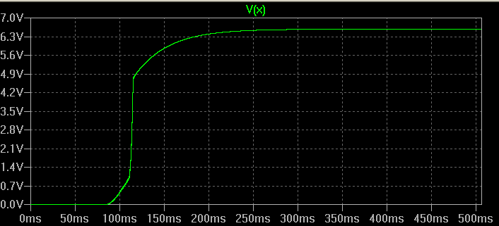

Back to this design. Stability is the first target, as you say, and I agree with you. Nothing else matters if the regulator is oscillating. In fact that's not a regulator any more 🙂 But always keep in mind the gap between simulation and reality. I can give you the ltspice file (I don't have multisim) and all necessary models if you'd like it.
Yes, stable under normal conditions. While salas v1 reg was stable unconditionally. I think the first is sufficient for me.
I guess I should add something about the tests I've done on the real circuit. First, I built it several times, using various makes capacitors. This allows for some build variation. Also, I built it a few time on a pcb, and a also as parts in the air, meaning each part soldered to parts near by. An air sculpture of sorts. On purpose I have been a bit careless about length of wires for sensing or output. I would not call these normal conditions, but I like to do that, so to see how the circuit behaves. Then, once powered up, I tested it for various input and output voltages (5V, 12V, 15V, 22V, 24V, 28V, etc.). With passive load (resistor) and active load (power mosfet) for various currents, 50mA, 200mA, 300mA, 500mA, 1A, 2A, 3A. The mosfet active load was set usually to some DC current and then I applied to its gate a square wave or a sine wave to get an AC current component on the output. With all these tests it did not oscillate. When all tests were passed, I felt confident that it would be stable. I cannot be 100% confident that under all imaginable conditions it will not oscillate. But 100% confidence isn't what I want anyway.
Now, this being said, I have revision 5f in the pipe line, with a phase margin of over 80 degrees. If that is not, in theory, unconditional stability, I don't know what is. But I haven't built it yet, and it will be some time before I can do all the tests and make it public.
For example, this is how my transient analysis looks like on revision 5d.
Voltage in: 40V
Voltage out: about 6.45V
Current Limit: about 300mA
Active load: PULSE(100m 125m 0 5u 5u 20u 40u)
which is a square wave jumping from 100mA to 125mA, rise and fall times 5uS

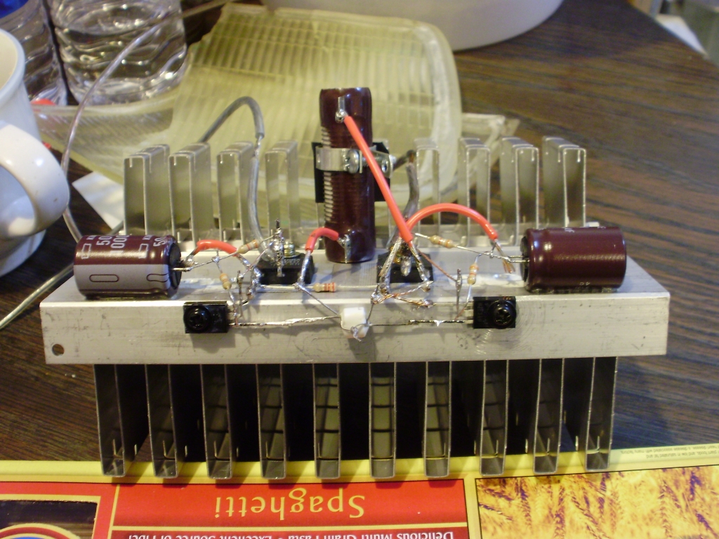

kt, how about I send it to you and you do whatever you can with it. I'd feel too bad about saying I send it and then retracting the offer. Even if you don't get to run the tests now you can use it for whatever later on.
Unfortunately I don't have the setup to run a proper output impedance measurement. It would have been nice to send it to someone who does and is willing run the test.
Couldn't you do some tests with a MOSFET CCS modulated by a signal generator? That's how I would do it. With 100uV sensitivity, I'm sure the test would still be meaningful, at higher frequencies (with 1A modulation, wouldn't that be 100uOhms for full deflection on a scope?). And if you can't measure it that far down, then many will argue there's not much use in measuring farther. (this is in fact how I planned on testing)
The butane iron is not that barbaric (maybe I should improve my communication skills), I can shut it off and solder while the head is still hot (good idea keantoken!). I don't think soldering skill will be a problem, maybe I don't know my own ability. See the sculpture below (I think I did this with lead-free solder, if memory serves).
So if you do send me the boards, I expect I'll be able to measure sooner than later.

That looks good, I think you'll do just fine. But I have only one full circuit left, and I'll send you it. R2, R9, and R11 are missing and you'll have to solder those with values that you want.
