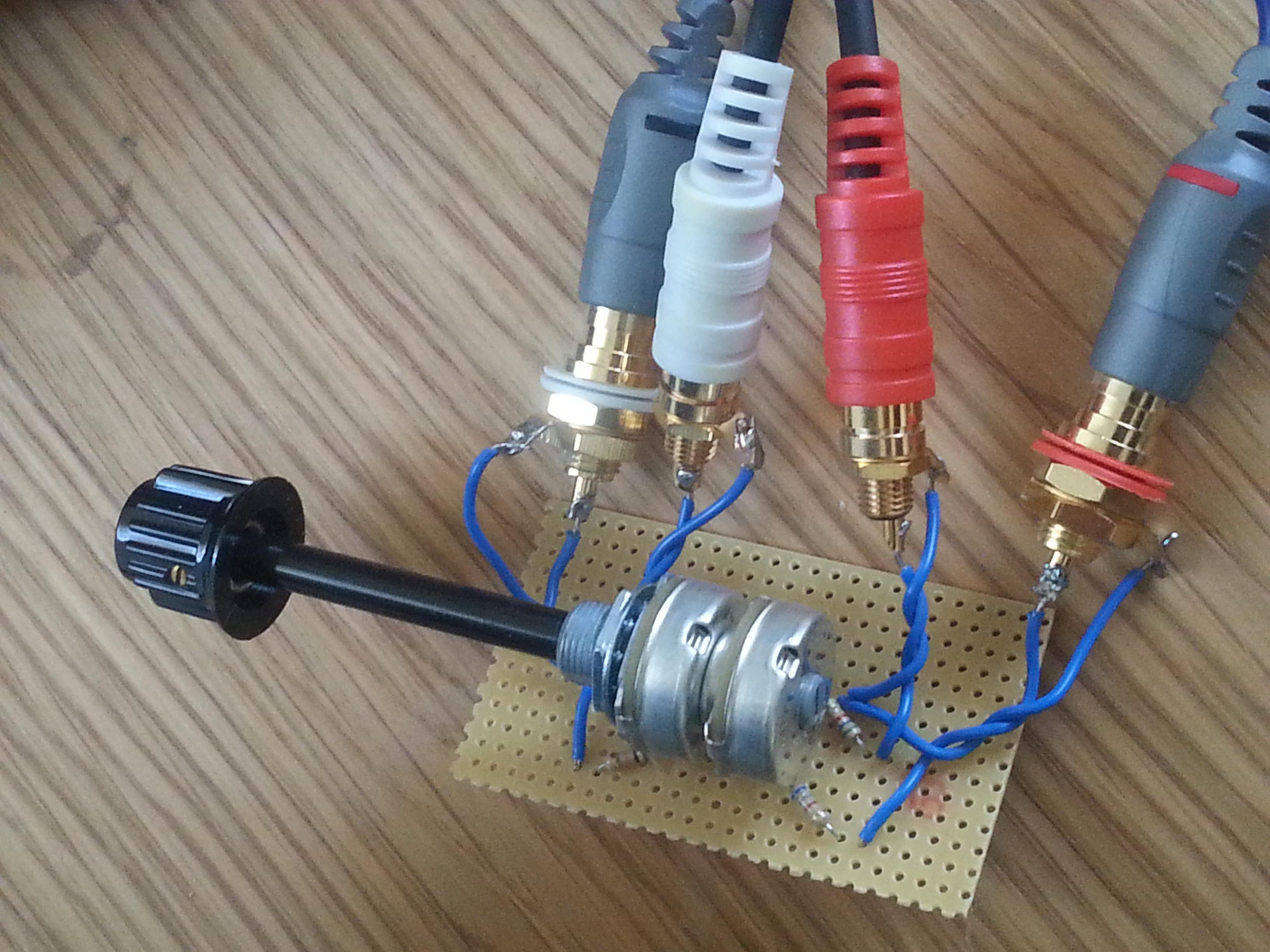

I have completed my first prototype passive preamp :drink:

Nah it's shocking.
The cheap Maplins stereo pot is so badly balanced that even after I trimmed it in the nominal position I get massive imbalance when I reduce volume.
I have an off the shelf Tisbury passive preamp in the post with stepped attenuators. Basic functions but exactly what I need.
You can't DIY for their price... even building a properly balanced attenuator is costly.
