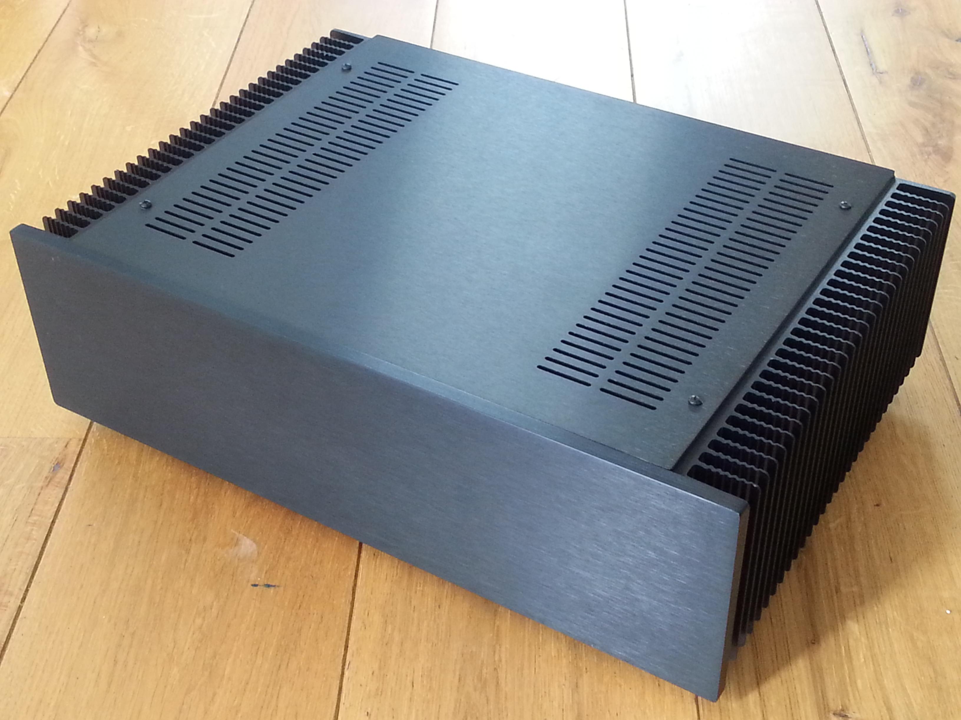

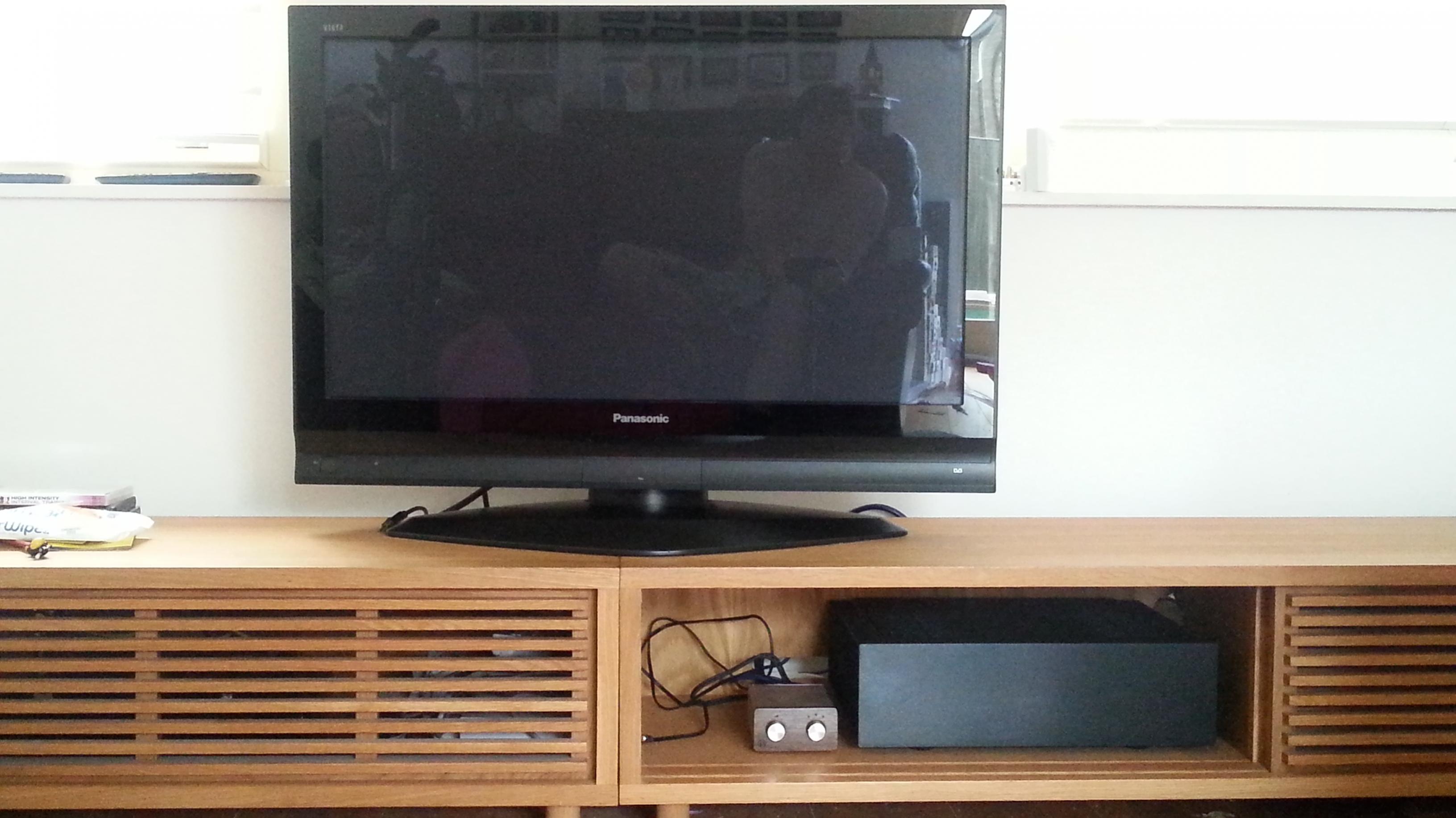

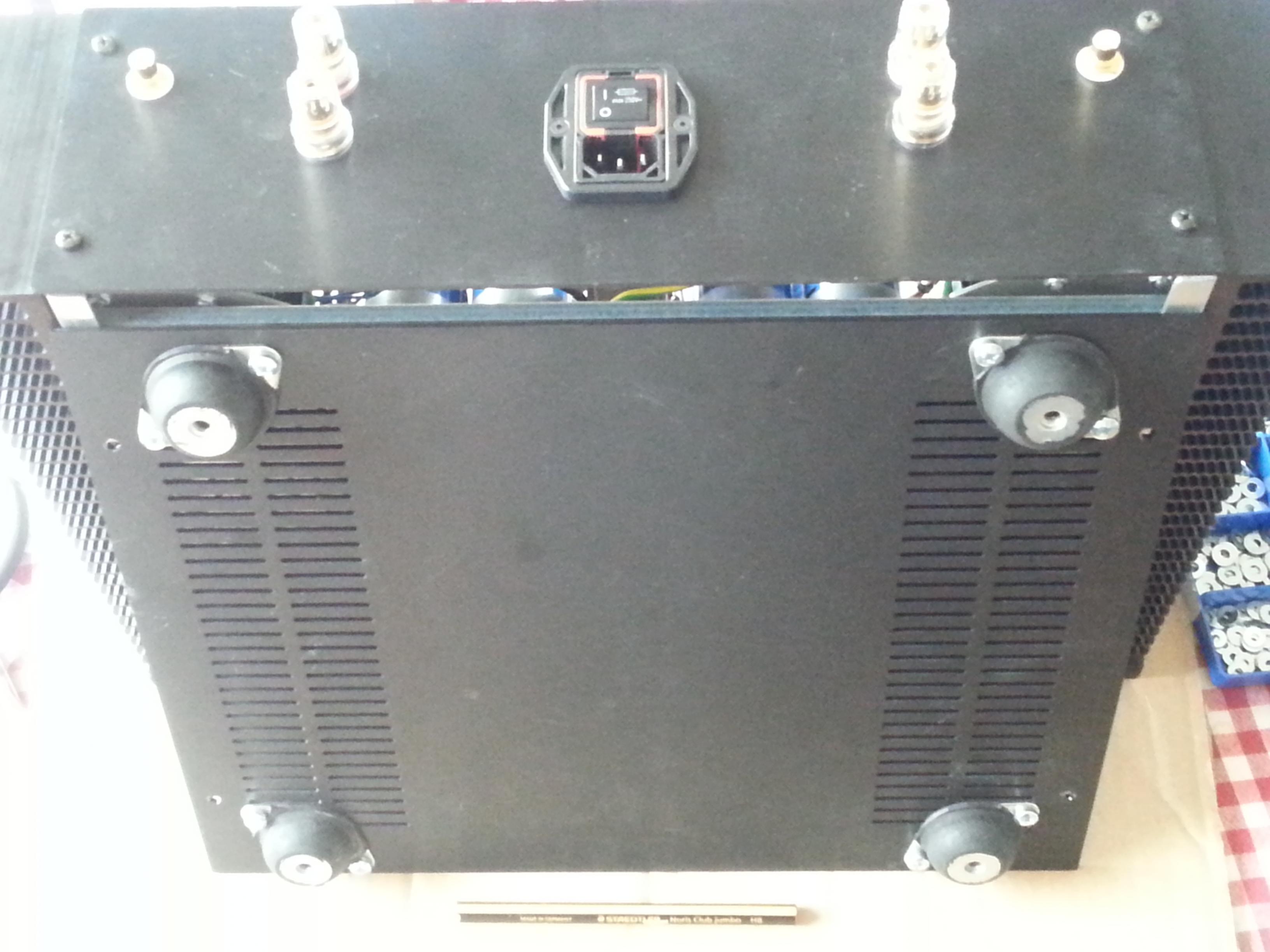

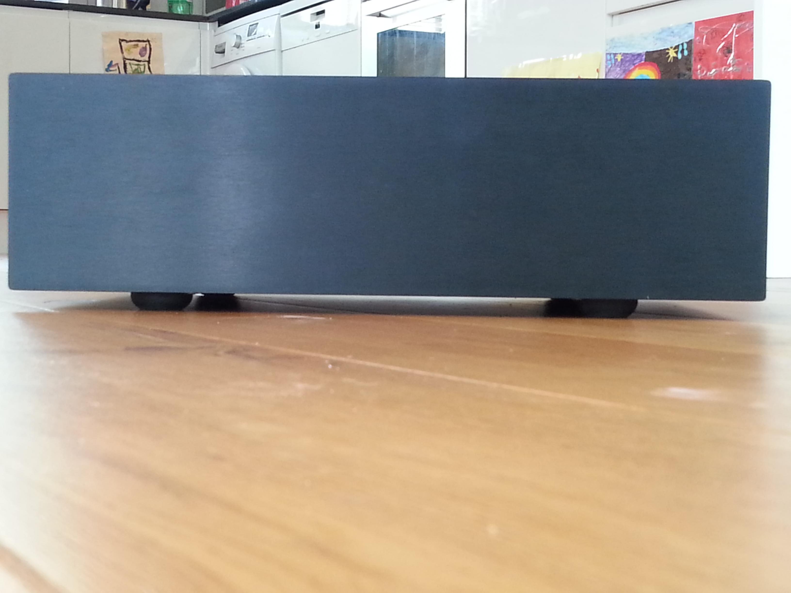

I found these AV mounts from RS, I prefer them to the HIFI2000 feet.
Available in 15kg (24mm high) or 10kg (20mm).
Pops.
Pops.
Looking nice Pops.
I was looking for feet the other day (for my SR-200 amplifier project) and found some radicules prized feet. One German distributor wants to charge 75 Euro for 4 aluminium feet...
They are very nice and would be a great match to my Cambridge preamp but way too expensive!
