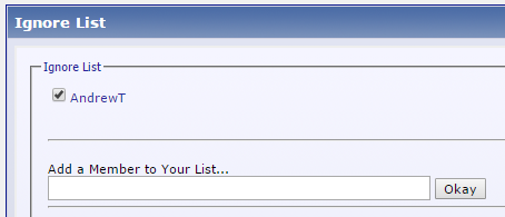

Hi Calpe, there is a great feature on this forum. It is called the Ignore List.
You find this in the User CP -> Settings & Options -> Edit Ignore List.
See the attached picture for the details.
Works like a charm and you don't have to waste your breath on those "smart people". 🙂
