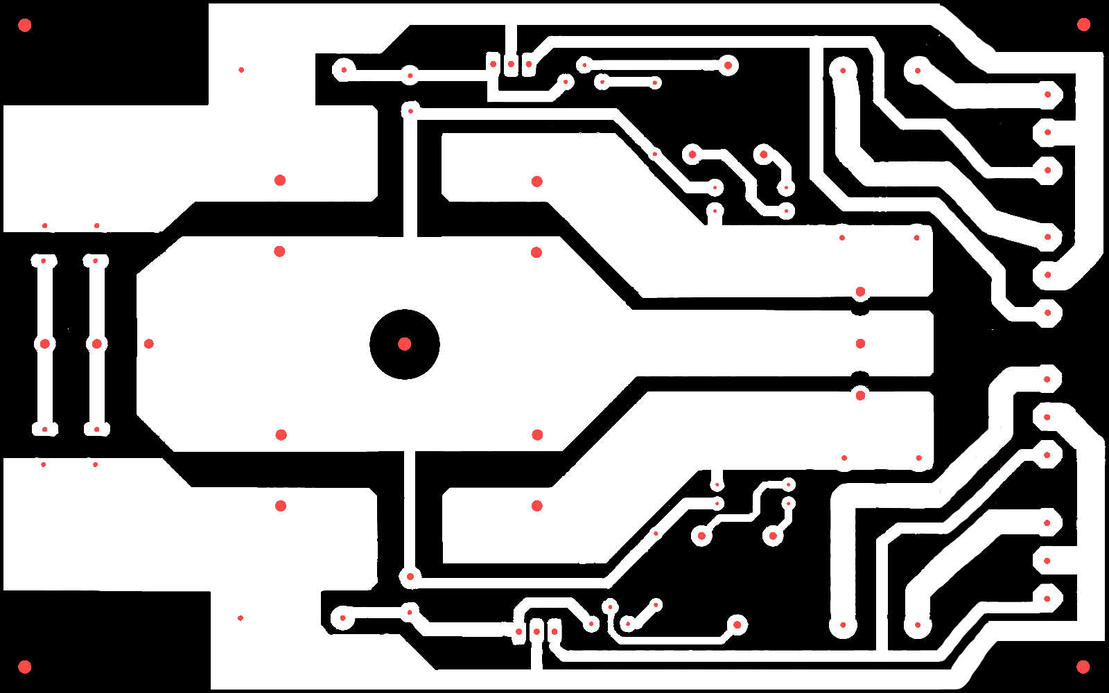

Does anybody know where I can get a PCB for the APEX regulated power supply without re - designing the PCB as many others have?
I have a trusty 625VA 35V transformer that might make a good AC source for a regulated 35-40V DC PS.

I've issued my design to the board house yesterday. My version does not include the large caps on the PCB (I don't trust that due to the weight of the caps). Instead, I use large off board caps with screws who connect to the PCB.
If you have a few weeks patience (probably 3 - 4 weeks) you can buy one or two boards from me. I don't know what the final price will be because customs are always a surprise...
The board measures about 65 x 124 mm and is intended to screw against the heatsink. The PCB includes fuses and bleeder resistors. The board has a fused and un fused output. I ordered 10 pcs since I will need a few more for other projects... 🙂 I attached a sample in the PDF.

Hi Delange - yes please to two boards. I don't mind mounting the caps on a baseplate. You know I did the same for the 8x 10mF caps in my Q-Watt.
What is the maximum load current (RMS) for the board? I'm thinking about powering 4x 60W channels (Rod Elliott P3A).
What size heatsink? PCB does look good. Thanks.

The max output current is 10A (with two pairs). Mister Mile designed it to power one SR-200. The output voltage can be adjusted from +/- 55 volts to +/- 90 volts. I noticed the P3A uses a +/- 35 volts supply; which is too low for the PSU-10.
Heatsink size, don't know. Mister Mile did not mention that but I suppose at near 10 A output, the transistors will get warm 🙂 Needs to be tested.
Also note that the size of your transformer increases by using the regulated PSU. There needs to be a voltage drop of 10 to 15 volts over the supply for stability.
Shame... I really do need only 35V regulated. I don't have time/space/money/aluminium extrusions for a 200W amp 🙂
I expected to supply 10-15V higher DC hence the 35V AC tranny, gives 49V DC.
I would like to use each regulated PS to power one stereo P3A board, needs about 6A @ 35V DC. I'll ask Mile if the design can be easily adapted or not.

A voltage regulator compares the output voltage to the voltage reference.
It does not care about voltage input, nor voltage drop.
If you want 35Vdc as an output you select a voltage reference that gives this output.
Then select a transformer that when heavily loaded does not cause the regulator to drop out, even when mains voltage goes to lowest allowed within the supplier's tolerance.
But if you run 10A continuous output, then all heatsinks will run hot.
You don't design a ClassAB amplifier to operate with a continuous 10A supply.
The supply current varies from near zero milli-amps to peak output current into the speaker load.

But does the voltage drop (and load current) determine the power dissipated? A decent voltage drop is good for stability and >15V seems like excessive waste?
Then select a transformer that when heavily loaded does not cause the regulator to drop out, even when mains voltage goes to lowest allowed within the supplier's tolerance..
Yep, got it.
Ok understood. The reason for 35V is to power 60W Class AB, chosen partly because peak current is lower. I want to use a smaller case/heatsink.
