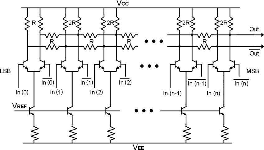

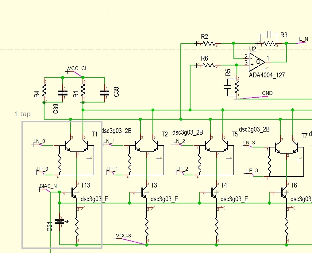

Settling time of that R2R dac would have to be impeccable to actually get decent resolution out of it, at those speeds.
R1 and R4 serve as common resistors for all transistor collectors, so all taps/transistor collectors share the same R1 and R4.
By a (one) tap you mean a balanced pair of npn transistors with their current source, right?
So right now all positive phase transistors (collectors) all share R1, the negative phase (collectors) all share R4, so all collectors of similar phase are connected to eachother.
I can imagine this causing problems.
Thank you for the clarification. I understood what you meant. I agree with you that one resistor for many transistors is one of the reasons for the oscillation. I know 24taps is more unstable than 12taps. But many transistors sharing one resistor is the essential know-how in analog FIR architecture. The attached pic is FFT of 1tap; SN=88.3dB at -32.56dBFS. If you have 36taps, you have 31.1dB gain, which results in -32.56+31.1=-1.46dBFS, while the noise floor is almost the same value as 1tap. So, your SN with 36taps means 88.3+31.1=119.4dB, ideally. It's impossible to have ideal value on the real PCB. What I need to do is to make real PCB ideal as possible as I can. The real value I can have now is almost 117dB. It's not bad but not ideal.

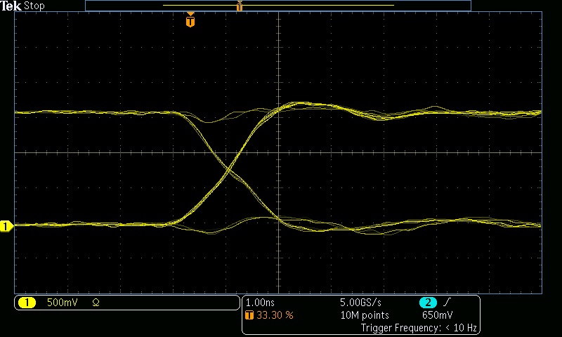

The 2nd pic is the base of the positive transistor and negative transistor. The propagation delay between low to high and high to low usually isn't the same, including rise and fall time. This is precisely an adjusted one because 100ps accuracy is mandatory for more than 110dB SN in my experience. Clock jitter must be as small as possible. As long as I have experienced on the real PCB, gate logic(I/O buffer with FF in FPGA) is more dominating than the clock itself. 30ps is my rough estimation of gate logic jitter. I don't think discrete logic on the real PCB driven by 100MHz clock with many fanouts can have better value than this, though I know it's controversial.
As to RTZ, fast discrete logic has considerable over and undershoot. You can't have a clean waveform like the 2nd pic.RTZ has more toggling than NRZ. If you can have an accurate pulse duration between low and high, The advantage of RTZ disappears. The disadvantage remains; less SN because of less signal amplitude. That's the reason I don't want to employ RTZ. Precise pulse adjustment is better than RTZ, IMHO.

Not sure about what can be achieved on the real pcb regarding signal quality. 30 pS is a low figure with fpga, but you'd have to be really precise about impedance controll and trace length to stay in that region on pcb level. It's a great feature that with fpga you can controll timings this precise, it gives room to adjust which gives it an edge over just hoping pcb traces will work out. What steps/resolution can the fpga provide?

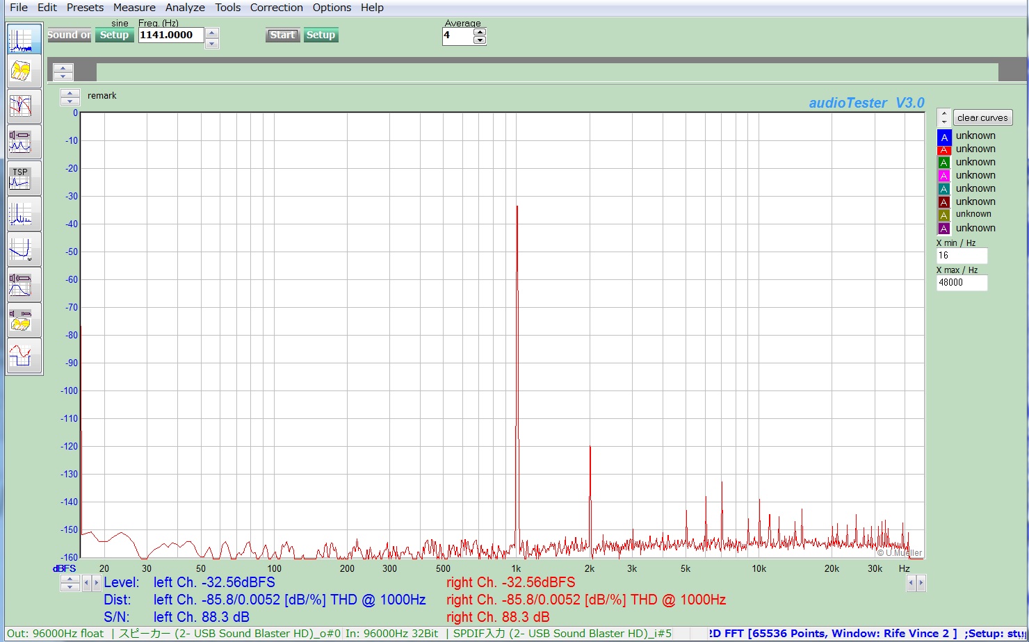

The numbers(94dB THD and 94dB SNR) are almost the same as I have experienced before in Signalyst topology. I'm sure the point is 0dB PSRR. I highly appreciate it if you share the measurement result on your no DAC. It's very surprising and exciting for me if Signalyst topology(0dB PSRR) has more than 100dB SNR.
The "Signalyst topology" can never achieve high technical performance for many reasons, but the first is the lack or RTZ encoding, there will always be a systematic linearity error - just as any DAC array that does not insure each pulse's "energy" contribution is discrete and independent from the proceeding and next pulse.

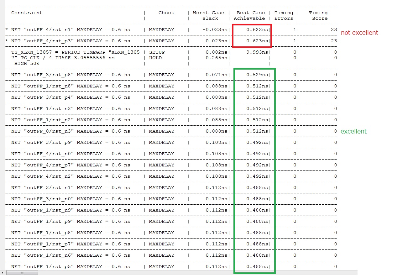

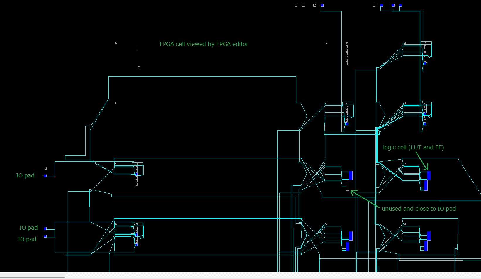

The autorouter, which is a default setting in large scale FPGA, isn't suitable to have accurate phase relation because they are not optimized for such purpose. You need to do manual routing for better matching, which is out of date technology in 21 century. I used to do manual routing in the early '90s when I began to design a digital circuit with FPGA. Nobody uses manual routing these days, including me. But old forgotten technology is necessary to adjust phase relation between taps. The attached pic is the FPGA editor to do manual routing and LUT assignment. I have understood the principle why some IO pad can have less than 0.5ns delay, while some can't. Unfortunately, my IO pad assignment was incorrect. I can fix the problem when I design the next PCB because the FPGA editor guides me to have the correct IO pad assignment for 48 taps. Ancient tech is sometimes useful.🙂
