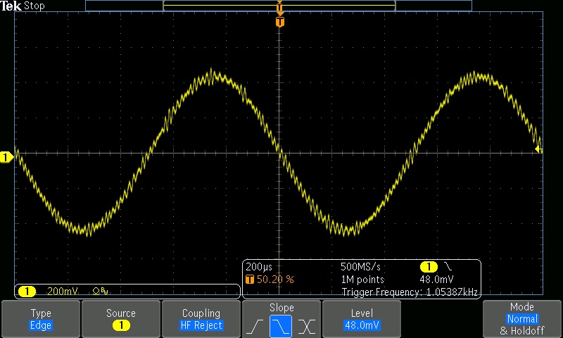

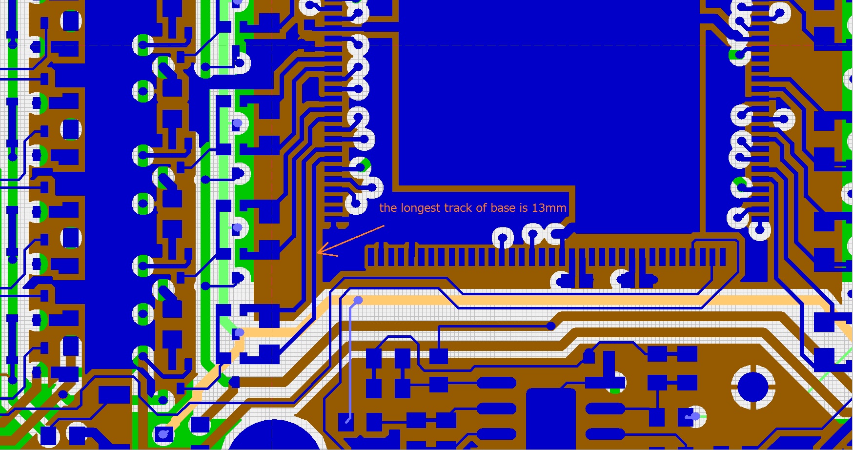

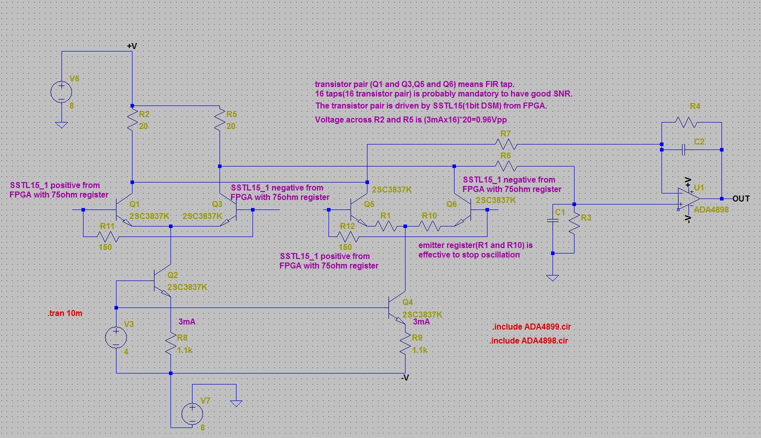

xx3stksm, about the oscillations: could those be parasitic Colpitts-oscillations due to the lack of base stopper resistors? You mainly have them with long FIRDACs, presumably these also have the longest wires to the differential pair bases.

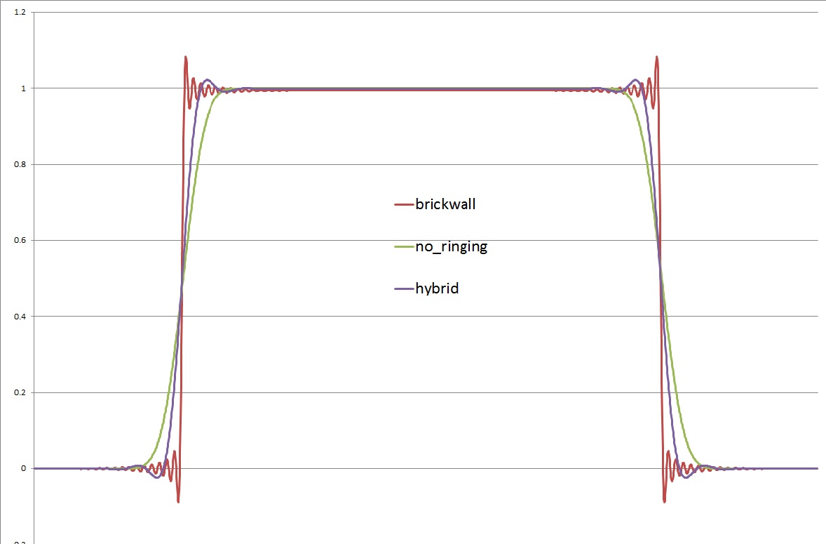

Another question altogether: what kind of interpolation filter did you use?
Thank you for your advice. I also tried a base stopper resistor, though FPGA I/O has already internal 75-ohm resistor. Additional 100-ohm had almost no effect to stop the oscillation. Parasitic capacitance between the collector and the ground is minimal because of ground plane void. The longest track from FPGA to the base of transistor is 13mm(the 1st pic). The best solution to the problem is an emitter resistor like Q5 and Q6(the 2nd pic), which is still a temporary one.

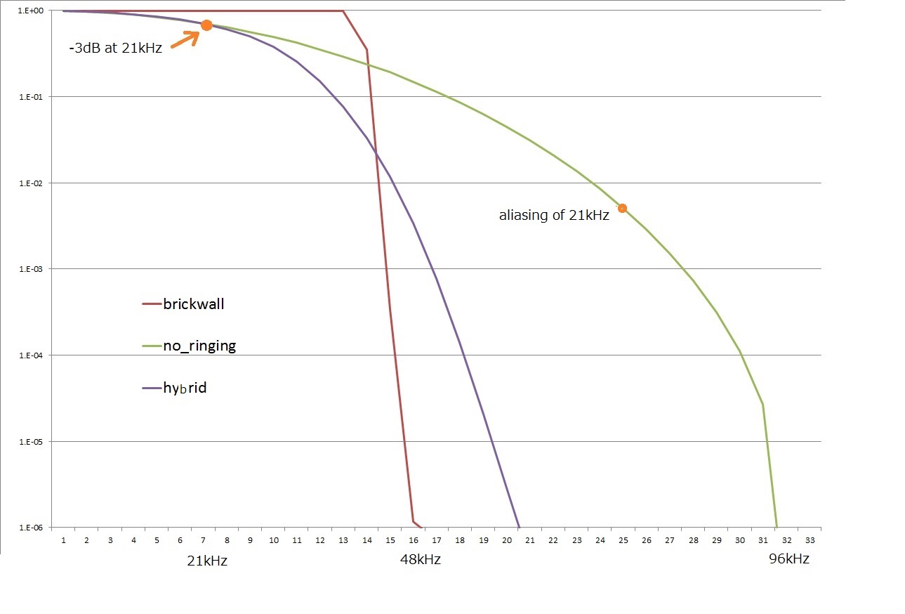

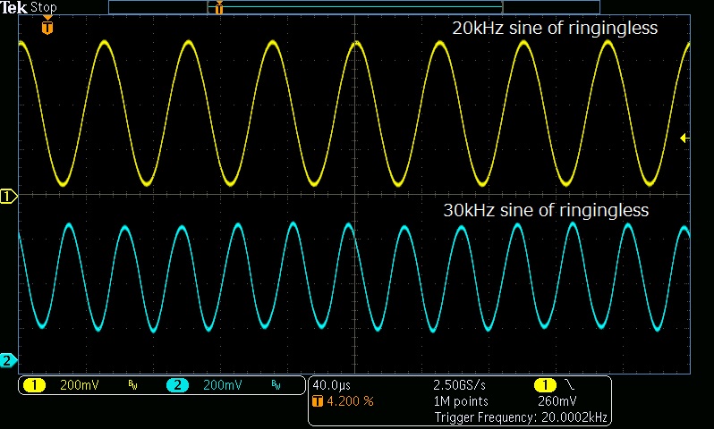

I have three interpolation filters to do oversampling up to x64 or x128: brick-wall, no ringing, and hybrid. Brick-wall has well-known ringing, which is usually regarded as a fault but has no technical background about the guilty. It becomes wrong only if the ringing results in overflow like the 3rd pic. More than 1 ends up overflow and causes audible degradation in SQ. Some attenuation(3dB) quickly eliminates a chance of overflow, and you have automatic prevention if your DAC is 1bit DSM because it must have at least 6dB attenuation.
Another way to be free from overflow is done by ringing less filter, which never has overflow because ringing less one always has the max amplitude at DC. Whatever waveform the input is, no overflow exists. The advantage is a trade-off between frequency response. Ringing less family can't have steep attenuation, which is possible only by brick-wall. If your sampling frequency is 48kHz, I don't think ringing less is practical because of large aliasing. I recommend 96kHz sampling even if your target is 20kHz bandwidth. The 5th pic is the reason. Aliasing of no_ringing can be acceptable since the max aliasing of 21kHz caused by 96kHz (96-21=75kHz) has 46dB attenuation(the 5th pic).
The 6th pic is real waveform of ringing less filter, where you have almost the same one as the original. Even if you have 3dB attenuation, the max amplitude of brick-wall without overflow must be smaller than ringing less. From such a viewpoint, ringing less with some droop at HF has meaning. Many of us already have aging droop. Hybrid is in-between, neither steep nor ringing free but moderate one is sometimes useful.

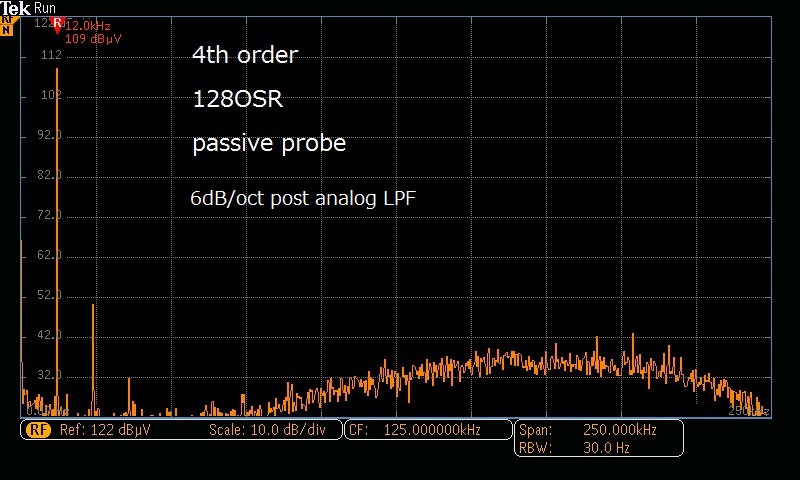

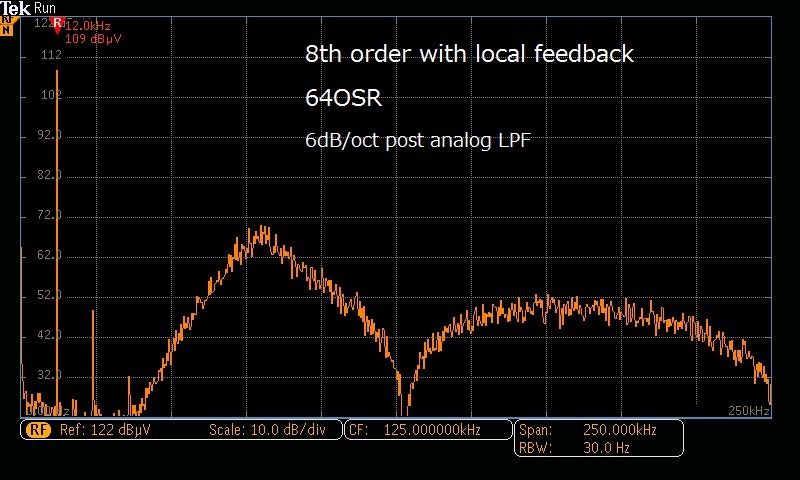

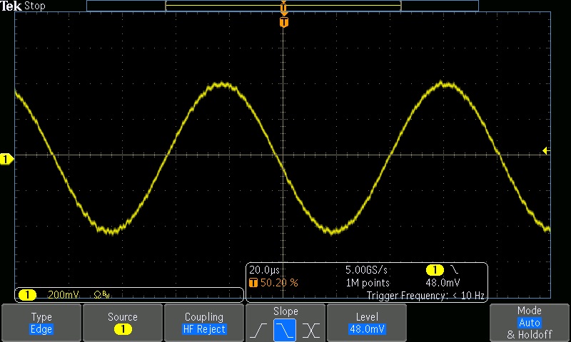

Hi,mterbekke. I'm still on the way to the goal(120dB N and 120dB THD)🙂. I have just received my 2nd version PCB yesterday, which has both 36-taps analog FIR and 48-taps. If the PCB is free from oscillation, I can be a winner who has more than 117dB THD+N with 1bitDSM. Win or fail is probably 50% from my experience.
Digital domain(DS modulator) has almost fixed. The best solution for my hardware is a little bit different from normal 1bitDSM, where large OSR(256 or 512) and high order DSM(7th or 8th) are usually used. My optimum setup is 128OSR and 4th order DSM(1st pic and 2nd). The reason is that you can't utilize low quantization noise which is brought by high order DSM with 64OSR, because residual noise caused by DA conversion is the dominating factor in the analog domain. Quantization noise by high order DSM is far below analog one. The lower doesn't mean a better result. Small quantization noise in the in-band ends up large quantization one in the out of band(3rd pic and 4th). I don't like high order analog post-LPF (24dB/oct or more) used in SACD, though you can ignore out of band noise. My analog post-LPF is usually 6dB/oct. 128OSR with 4th order DSM can bring you small quantization noise both in the in-band and out of band.

Hi xx3stksm,
120dB thd+N is not an easy goal. Imho the thd is the easiest part, the noise a lot harder.
Great to see you push forward!
Are the design choices you make based on listening preferences solely or partly or not at all?
I might need to clarify.
My experience on one hand has been that the lower order DSM's always sound a bit "fuller", but also a bit sloppy.
On the other hand, a high order DSM might make the sound too thin, as if too much micro details pop up and make the whole thing sound artificial.
Experience has also been that used architecture, type of hardware (cmos, cml etc) play a big role and can result in being hardly able to hear these traits of the DSM order or to be just plainly annoyed by hearing them all the time.
If I remember correctly you said you didn't listen to help decide in some of the design choices that one needs to make (correct me if I'm wrong), how do you decide on what's acceptable performance if you don't, or if you did listen: how did you get convinced about using this DSM order etc?
Btw I always enjoy the intermodulation distortion tests with a 1 bit dac, those really stand out and make many multi bit dac's look state of the old-art;-)
