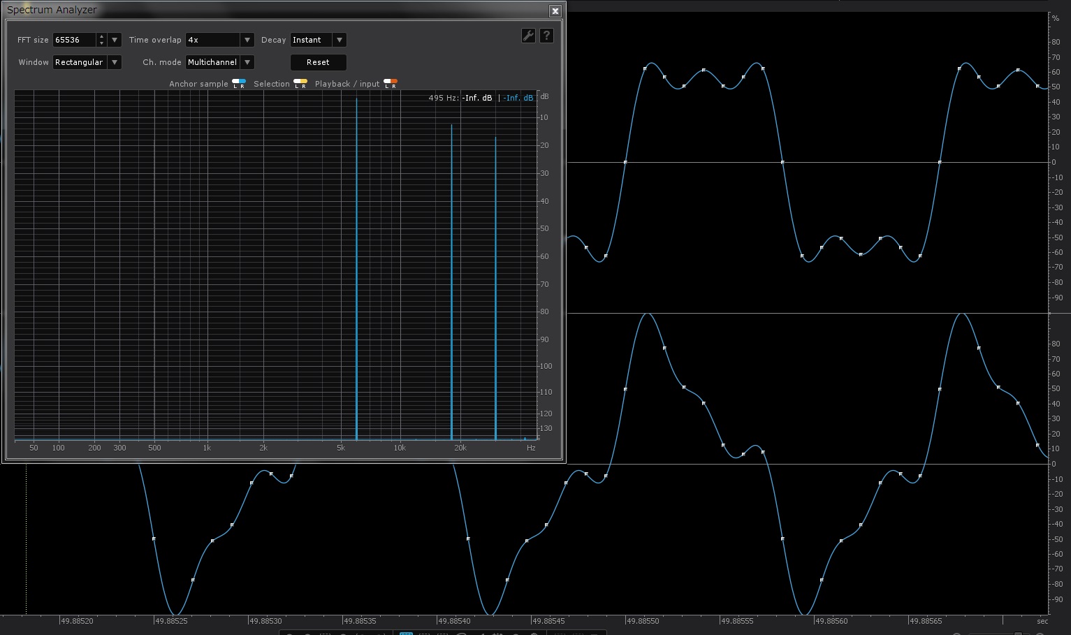

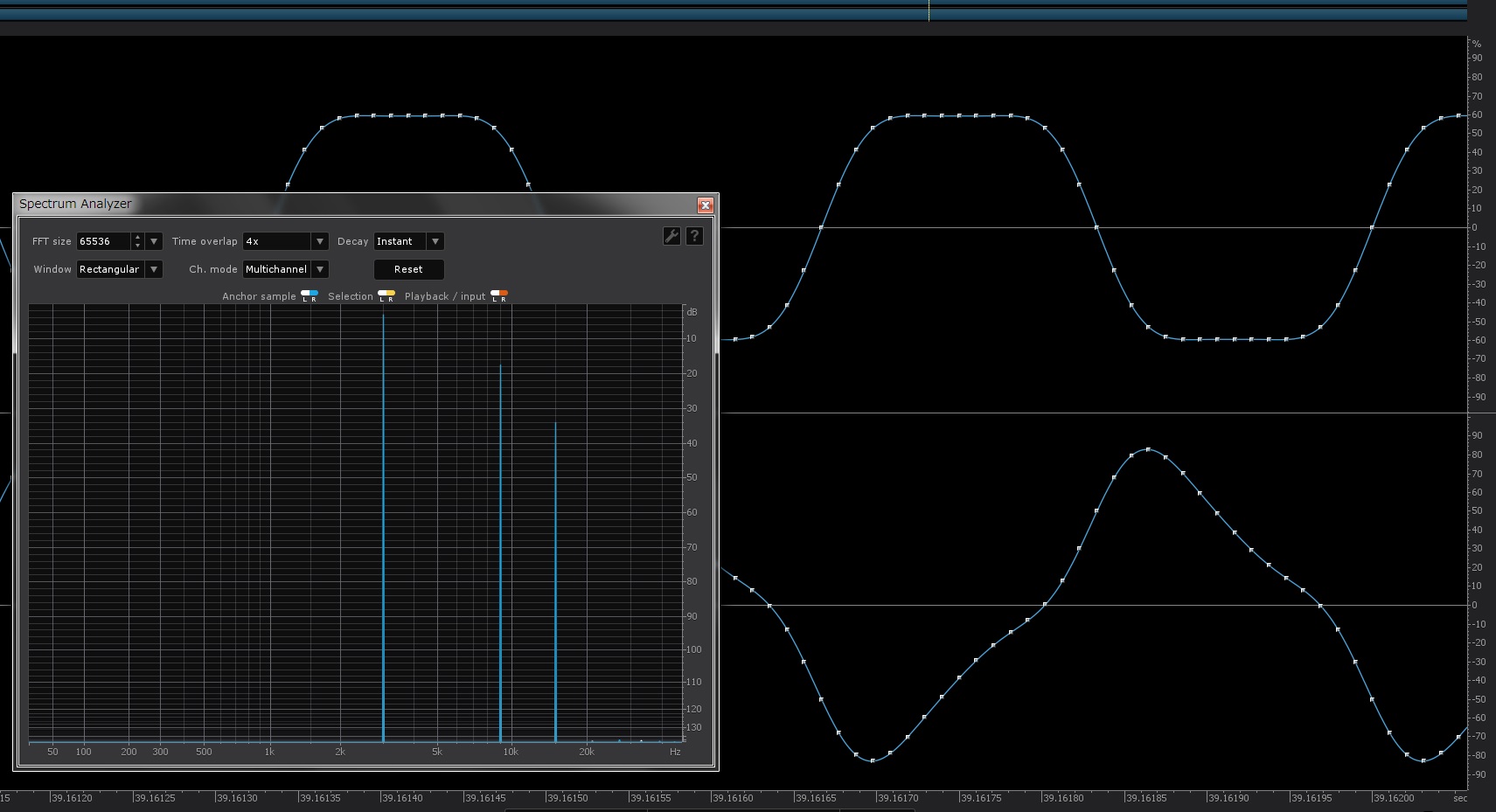

My off-topic.🙂 I'm basically against time-domain analysis because there are many chances to misunderstand, and human ears are based on frequency domain. The 1st pic has the same sound at least for my ears. The upper is in phase, and the lower has the fundamental with a 45-degree phase shift. Both have the same FFT plot. I ignore time-domain difference since I can't hear the difference between them.
The 2nd pic is another example. The upper is so-called ringing. The lower has some phase shift. The former is ringing and the latter is distortive? Both are the same FFT, too. I regard them as a waveform with three spectrums, where phase information can be ignorable if your target is a human ear. Ringing or echo is a little bit subjective. I like more objective definition like three spectrums.
