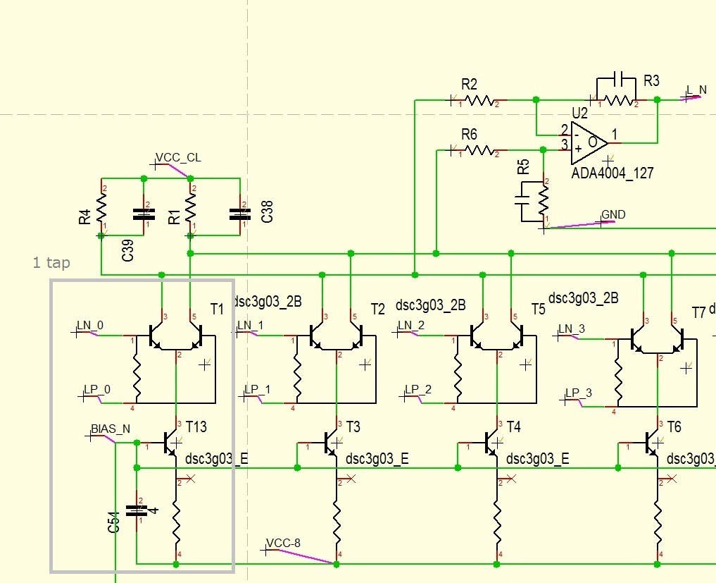

why could omultiple taps share one resister ?Hi, Zoran. I'm afraid I misunderstand what you mean. But I think your schematic requires accurate resister matching. The advantage of 1bit DSM is no need to care about resister matching. The attached pic has one resister for transistors; R4 for negative ones and R1 for positive ones. One resister is the essential point of 1bitDSM. Each tap doesn't have the same current(almost 0.1% accuracy). But the imperfectness results in a slight frequency response error, doesn't mean distortion.
The circuit diagrams of a 16-bit R2R DAC and a 1-bit DAC with 16 taps are similar, but the characteristics of the former depend on the precision of the resistors, whereas the latter does not. Additionally, the 1-bit DAC requires only a single resistor. In circuits that can output both, when operating as a 1-bit DAC, it should function with just one resistor.

theoretically,1-bit DAC need only one taps ,why do 1-bit DAC need 16 taps?The circuit diagrams of a 16-bit R2R DAC and a 1-bit DAC with 16 taps are similar, but the characteristics of the former depend on the precision of the resistors, whereas the latter does not. Additionally, the 1-bit DAC requires only a single resistor. In circuits that can output both, when operating as a 1-bit DAC, it should function with just one resistor.
You can make a FIRDAC when you use more than one tap. The taps then get delayed input signals and their output signals are added, turning the whole thing into a mixed-signal FIR filter. It reduces the sensitivity to far-off phase noise and spurious tones on the clock and it does a part of the reconstruction filtering.
The characteristics of a 1-tap 1-bit DSM are not excellent. To address this, when adding a 16-tap(each has one clock delay) in the analog domain, it provides the same functionality as a 16-tap moving average digital filter. Although not possible in the digital domain, such addition can be accomplished in the analog domain. If analog switching is flawless, this operation would result in a 16 = 2*2*2*2 = 4*6dB = 24dB improvement in SNR.
Achieving similar effects can be done by parallelizing the DAC outputs, but in that case, the improvement would be 12dB instead of 24dB. The same goes for ADCs, resulting in a 12dB enhancement. Such analog-domain moving average filters work quite efficiently, almost like magic. THD is significantly improved as well because individual distortions are averaged out. This improvement depends on the order of taps. When implementing the digital side in an FPGA, you can set up internal registers for rearrangement and adjust them to achieve the optimal state. With perfect switching and optimal tap arrangement, you can achieve SNR exceeding 120dB and THD below -120dB.

One shared register is the same load of each tap to construct an FIR filter in the analog domain.why do multiple taps share one resistor?

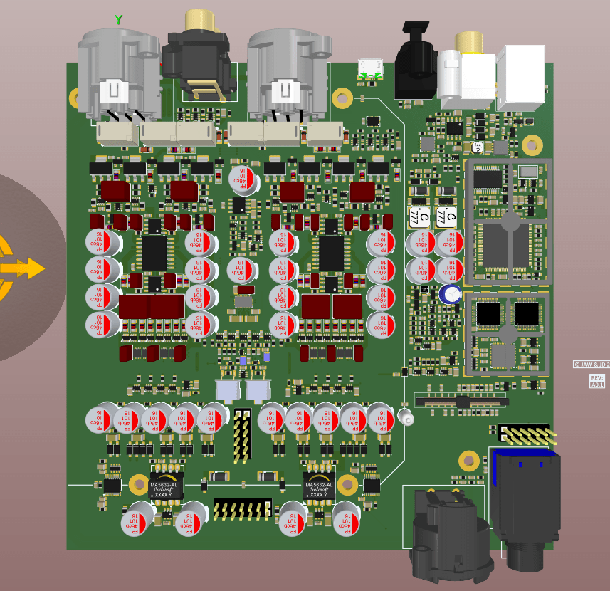

I can't download Discrete DAC Stg6.png,please upload it to this thread,thank you!So we are do things rather different, using CMOS logic as it has lower Phase Noise, and higher voltage swings.
In the attached image you can see a development PCB we are currently working on with a simple SDM discrete DAC array and FPGA modulator (Digital filtering is performed by the large XMOS which also supports MQA unfold, USB and System control etc).
This design has a galvanically isolated analogue stage, not because it helps measurements, but because in practical use isolating the USB Host ground from the Analogue system saves a whole bag of hurt with hum loops etc..
The Discrete clock stage is located between the discrete DAC arrays for shortest signal path, the SDM signals from the FPGA are resynchronized to this MASTER clock, before being fed into the DAC array.
The clock is isolated and fed back to the Digital section / FPGA / XMOS etc.
The clock circuit has an ultra low noise semi discrete regulator. Due to space constants, the DAC arrays are powered via an ES9311 Low noise regulator. If space allowed we would have preferred to use a semi discrete regulator design as used for the Master clock - but the ES9311 is not that bad, importantly in can be designed to provide "active" regulation across the whole audio B/W which is very important to avoid "capacitor sound"...
The resynchronization stages have there own regulators and LC networks to help isolation between stages.
The two transformers provided very low noise isolated supply to each channel - these are synchronized to the Audio master clock (the low Phase noise provides a low noise DC output) to prevent unwanted noise products folding back into the audio band, and despite there size they can provide 1.5A each! - infact all switching supplies in the digital section are also synchronized to the audio master clock.
The DAC array supports SDM to x512, so native DSD can be routed to the DAC array without re-modulation.
