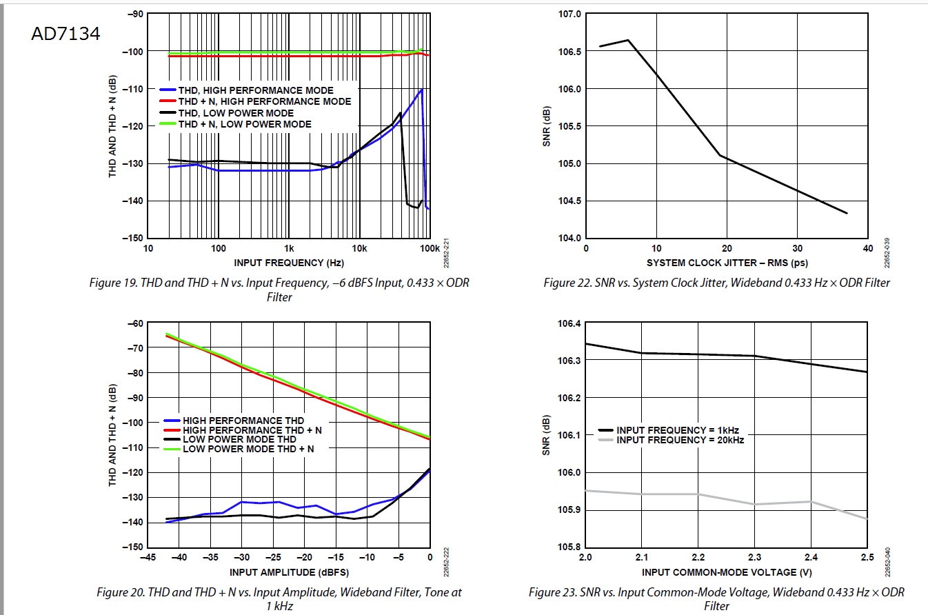

Thanks for your interesting feedback. Honestly speaking, I used to be a big fan of SAR ADC rather than DSM one. SAR inherently doesn't have quantization noise increase at HF and was superior to DSM on SNR. My previous ADC was the AD7960(SAR 5MHz sampling). The disadvantage I have experienced with SAR is THD. It doesn't mean SAR is inherently not good at THD. I guess my ADC driver isn't excellent enough to achieve the values on the datasheet. I couldn't get rid of some grass at HF. My DAC also wasn't good enough to complain to them.
The LTC2378-20 has excellent performance. But I have no confidence to have such numbers. My previous one (AD7960) was behind it. My current one(AD7768 DSM) is pretty good. How much performance you can get depends on an ADC driver, including front-end LPF, IMO. The wrong selection often ends up poor THD. It's very tricky to find out the best front-end circuit because the input is usually capacitive load. So, I can't stop trying the AD7134, which has a resistive load. The dependency on the front-end must be less. Furthermore, it is almost aliasing free. Only continuous-time one can have such ability. The attached is the AD7134 THD.
Hi again & thank you also for your feedback ;-) ... It seems though that we have somewhat different experiences wrt. SAR ADCs - so a couple of comments:

I agree with you the LTC2380-24 has excellent performance. I guess the problem with the LTC2380-24 is a bit tricky interface if your target is audio purpose. It doesn't have a standard output like IIS; you need some glue logic. Another inherent nature is the price. It costs about $60. I think it's worth investing in, but if you want more than 120dB SNR, paralleling The LTC2380-24 isn't an optimum solution. The LTC2380-24 and recent DSM ADC(AD7768 or AD7134) have almost the same SNR(115dB at 20kHz BW). It's easy to parallel DSM ADC because they are intended to do so. The most inexpensive one is the AD7768($45 with 8 ADCs). IMO, If your target is high SNR with less than 192ksps, DSM is better. If more than 192ksps is mandatory, SAR is better.
@xx3stksm: Thanks again for your comments above.
I had the opportunity to read into the AD7134 datasheet yesterday and I still find it interesting, however, from a sound recording point of view I think it may have some "challenges".
The main one is the ODR (output data rate) functionality which is indeed very flexible but for audio sampling data rates depends on a PLL which - as I have read about it - is pretty hard to design so that it has low phase noise at close-in frequencies (which, as I understand it, is quite key in relation to obtaining very good perceived sound quality).
The second is the INL values which - if I read this correctly - are about three times higher than the similar values for the LTC2380-24. I am not sure if this may in practice correlate with specific sound quality observations but I would imagine that it could affect "non-linear" low-level noise/distortion.
On the other hand I do follow your thoughts - and the AD7134 datasheet's comments - about the simplified input circuitry which would really be a gift ... I have performed measurements on the LTC2380-24's input and IMO/IME it is noisy and depends on appropriate filtering.
Hmmm... Again from a sound recording perspective: I notice in the AD7134 datasheet that the phase matching between channels is of a magnitude of a couple of nanoseconds. And between ICs just about 10 ns. Just thinking here that normally in audio one is trying to achieve picosecond or femtosecond timings ... (please note that I do not yet have any opinion about the feasibility of this as I have not practical experience with the sound-wise implications of such very low timing (in)differences).

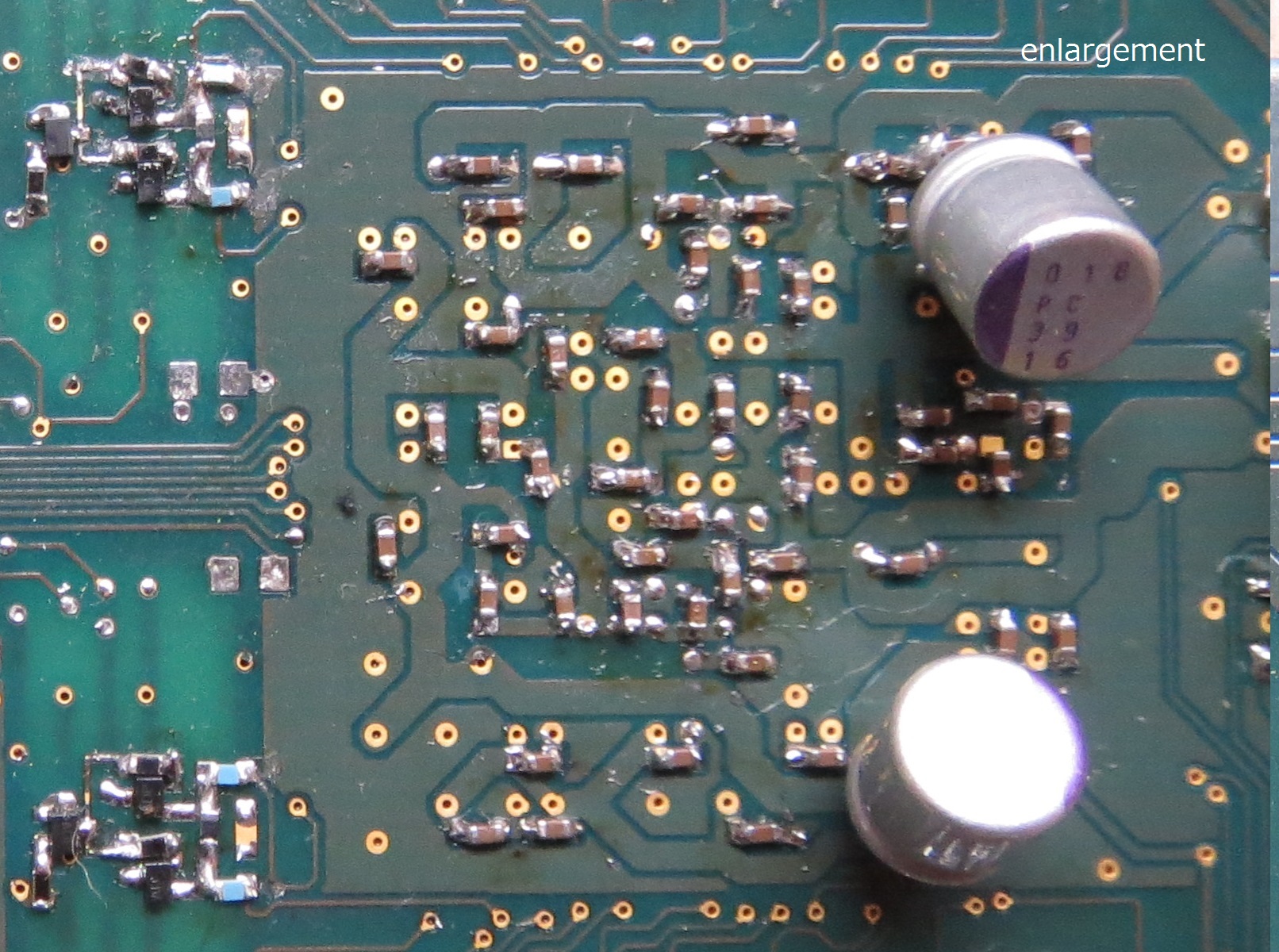

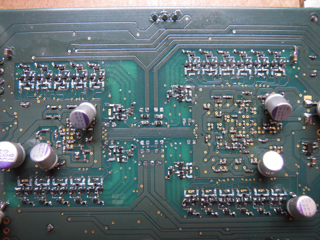

hi xx3stksm,
I went thru your interesting project rapidly.
I didn't find peculiar stuff to take care about the PS (power supply) of the FPGA.
You use linear regs ? one in front of each Vin of the FPGA ?
At the back of the PCB, I see some caps. Did you use high capacity X-type MLCC ? like 100µF or 220µF in 1210 form factor... based on photo I think not.
As PS of FPGA is critical (next to FPGA Vins, not miles away), high capacitance MLCC X-type is a no-alternative to the curent transcient response linked to FPGA activity.

Thanks for feedback.
Rgds
I guess the photo you saw was not my DAC but my ADC. The attached pics are the bottom side of my 1bit DSM DAC. As you said, bypassing the FPGA power supply is essential. I usually assign bypass caps(0.1uF,0402) on the bottom side to be as close to power pins as possible(GND is a solid inner plane). Track length of power is almost 1mm. Only the bottom side can achieve such an ideal condition. Without bypass caps, you can find some degradation on SNR. The drawback is too many vias. They are an obstacle to route inner BGA pads. That's the reason I can't use less than 0.8mm BGA.

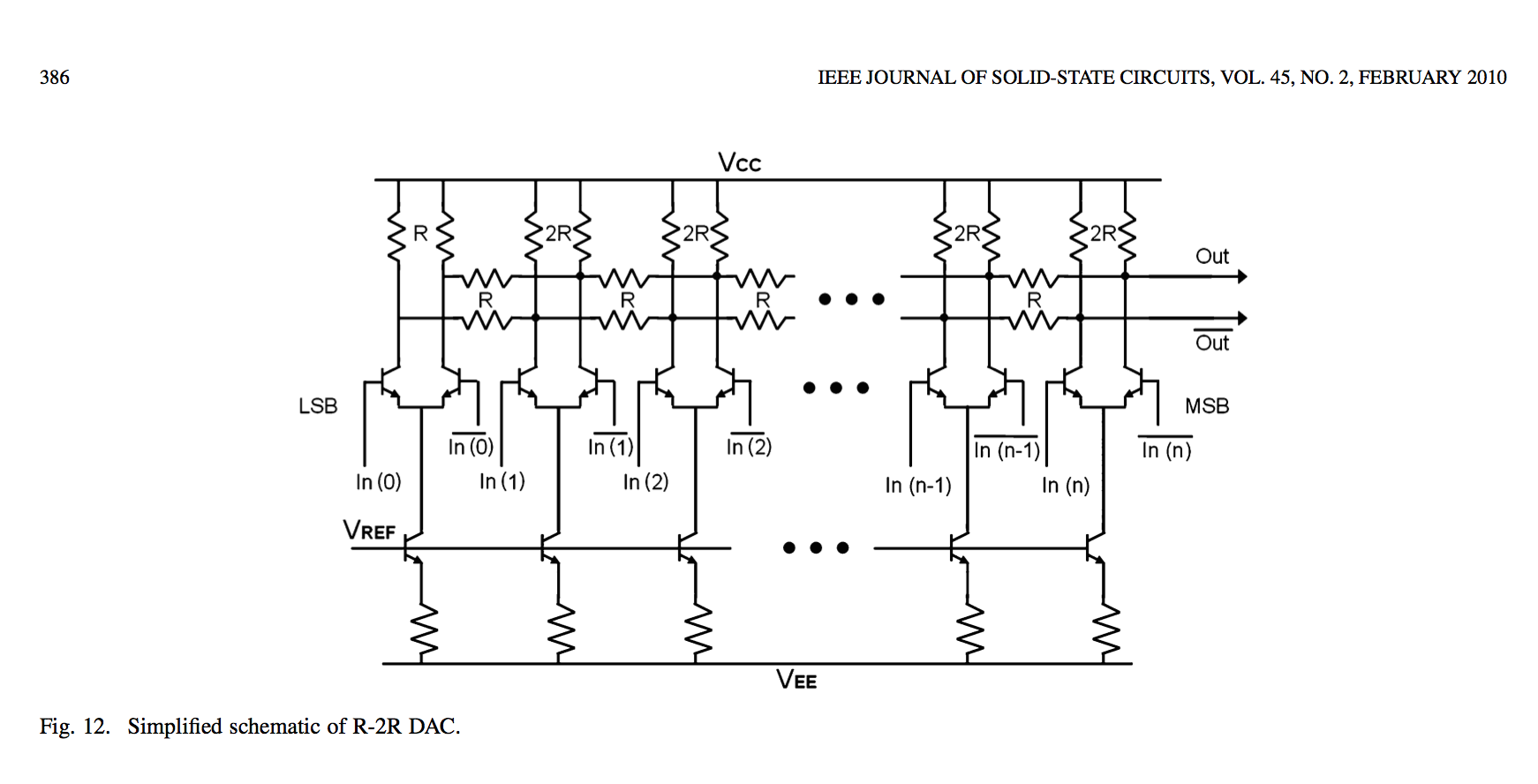

Hi xx3
Can I ask what is You opinion on sound (and other) when acomplish switching with Transistor stages. And when "switch" with logic complementary mosfet gates (in digital ICs)
IF You have some experiance I would be aperaciate to hear please...Because You are using dikrate BJT stages at the output of Your device.
I am asking because i somehow not satisfied with driving R2R nets direct from digital IC gates...
And probably I wiould like to try something like this:
Your attached pic is probably R2R(PCM) ladder DAC architecture. It's possible to drive R2R both with a discrete logic(HC590) and with a differential amplifier(your pic). But 1bitDSM with a differential amplifier is a bit different from the R2R ladder. One tap of 1bitDSM is independent of others: one is already complete DAC. Paralleling taps means averaging to achieve better performance. A discrete device(HC590) is also configured as 1bitDSM. All the more reason to avoid a discrete one for me is noise performance. You can't get rid of noise from the power rail because no PSRR exists as long as you use discrete logic. If you use a differential amplifier instead of discrete logic, you have some PSRR because it acts as a current switch. I don't know why some 1bitDSM can have excellent SNR despite discrete logic. I guess it's their secret.
As to the sound quality, I haven't finished soldering eight DACs which is necessary for my system. What I can say is if you are a classical music listener, poor SNR is fatal. That's the reason why I design 1bitDSM with a differential amp. I have some experience with poor SNR 1bitDSM. It's terribly bad for music with pianissimo.🙁

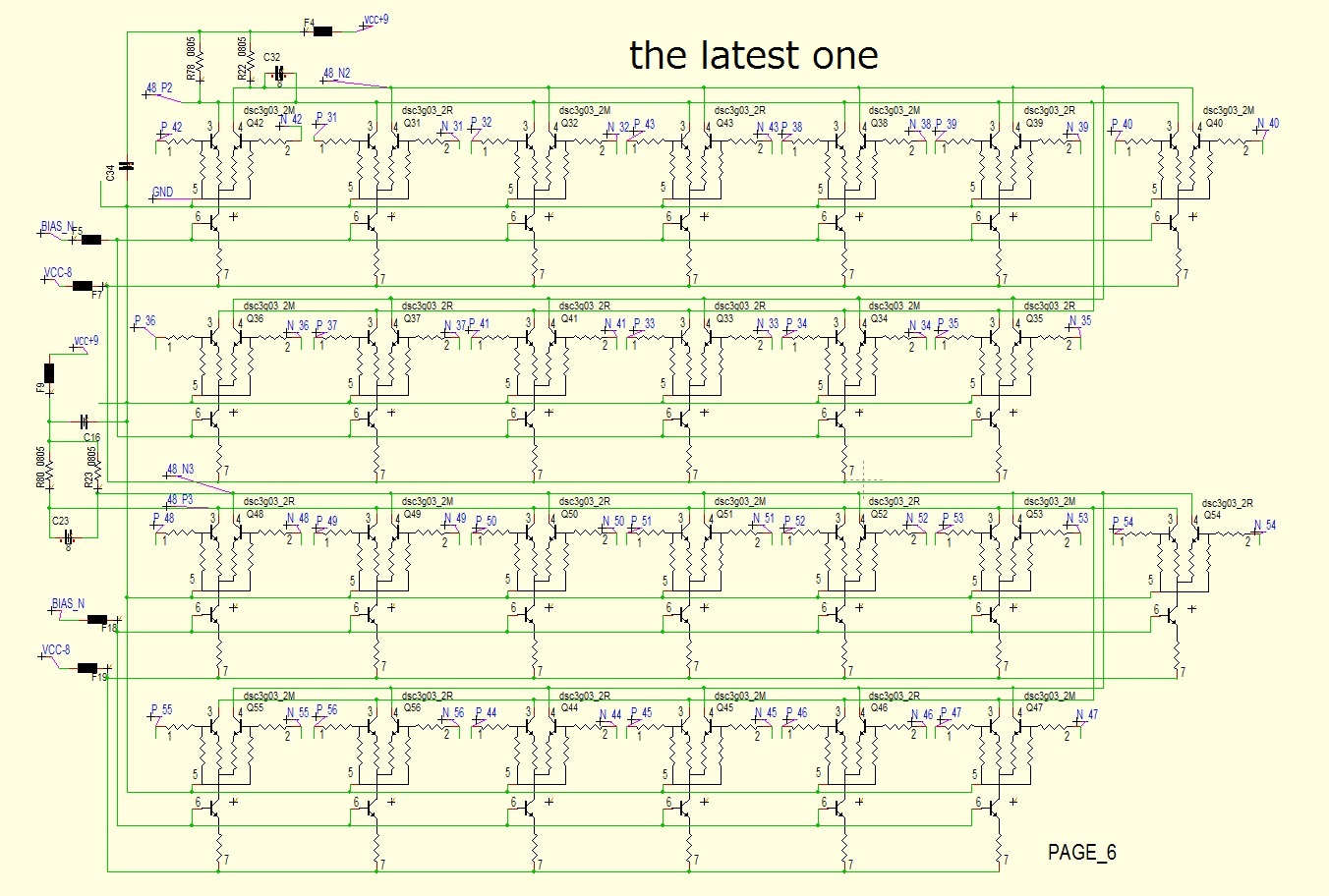

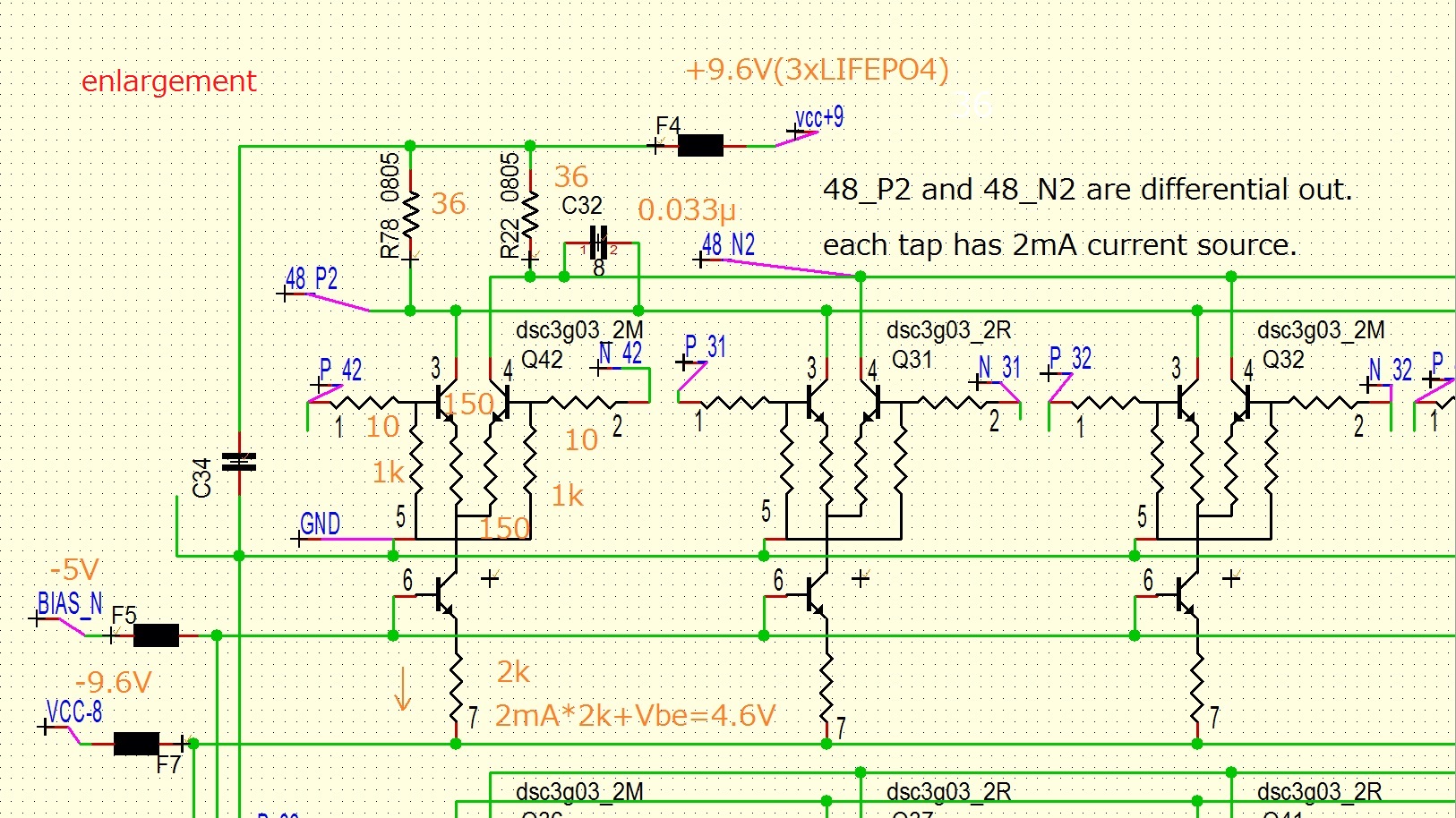

Could you elaborate a bit more on the pecl output stage of yours, maybe show a little more of the schematic. What I'd be interested to learn is (references are to the schematic of the original post on page one):
- what's the bias signal for? do have transistors have to be matched closely when fed from a shared bias signal?
- are r2/r3 half the value of r5/r6 to avoid imbalances in the loading of the output currents?
- what are the voltage values on vcc-8 and vcc_cl?
- what are r1/r4 for? do they provide a basic current path and you shunt away parts of it with the transistors?
maybe you could enlighten us all. What I find very interesting is that this scheme seems to avoid most of the fluctuations of the current draw on the reference voltage line as it's basically always the same except during the switching transistions. I'd image that relaxes the requirements for the analog voltage supply quite a bit compared to multibit output stages like the ess chips have for example (with zero psrr and current draw following the modulator/audio signal).
The latest analog section(pic.1 and pic.2) is slightly different from post #1. No specific bias is required because FPGA I/O swings from zero to 1.3V. I have measured several hundred transistors' Vbe and found no significant difference; no need to select. Beta is ignorable if Vbe is the same in a differential stage by a transistor.
The converted signal across R78 and R22 has only a simple op-amp buffer; no op-amp differential stage now. If you use a discrete device(HC590) instead of transistors, it's very tricky to have excellent SNR. I tried it several times but failed and gave up such architecture. Replacing HC590 with transistors also failed. Many trials and errors couldn't bring me a successful result: the zero PSRR trap.🙁 That's the reason I have reached transistor-based differential amp.

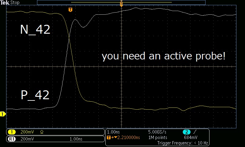

P_42 and N_42 are differential pairs driven by FPGA I/O. Three transistors differential amp is non-saturation switching architecture, where no current fluctuation exists except transition time: the shorter transition, the better. FPGA I/O has many options, slew rate, drive power, and swing voltage. Pic.3 is probably the best scenario. Less than one nano sec transition time with slight ringing is very challenging. I'm sure only FPGA I/O can complete the job because it has enough VCC and GND pads to output a stable pulse.
Furthermore, an internal PLL can adjust the skew between positive and negative output by 0.1 nano sec. Such preciseness implies better jitter performance; probably 30 pico at max. The skew is entirely a critical factor to have perfect conversion. Fast and ringing less switching with fine adjustment is the point to have excellent performance.
