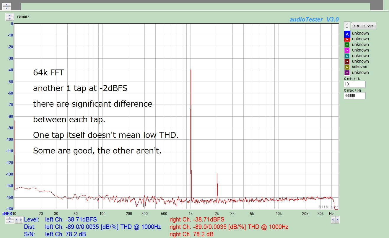

Interesting my THD is 0.0001% same as yours - but you have lower harmonics so I don't understand...
Also, my 20KHz noise floor is trending downwards, this is a result of the noise floor of the Array PSU and Opamp noise, I really need a lower noise input stage - the noise of Quad pairs of paralleled BC846's is just not low enough..
probably opposite phase
I guess low THD comes from the fortunate opposite phase between taps because each tap doesn't have excellent performance: some are good; some aren't. The attached pics are 1 tap, another 1 tap, 4taps, 12taps, 24taps, and 48taps at -2dBFS(8Vpp); tap change is controlled by the registers in the FPGA, no HW change exists. The 1st one is almost no THD, but the 2nd has some. 4 taps and 12 taps are still ordinary performance. You can have significant improvement at 24taps(the 1st booster🙂): more than 12dB improvement. You have an additional bonus at 48taps: another more than 10dB increase(the 2nd one😀).
Only one possibility is the answer, IMHO. Each tap has a lucky coincidence; their harmonics(mainly 2nd and 3rd) fade away due to the opposite phase. I guess a small number(less than 12) can't make the best of the opposite phase(not enough taps to average harmonics). If you have more than 24taps, averaging effect results in low THD, like SNR improvement with paralleling. Discrete implementation isn't so stable. Even a FET probe(1 pf) can change THD value; monolithic is better. But you have a repeatable number after 10-minute warming up as long as FPGA data and PCB are the same.
I don't know the reason why each tap can totally have the opposite phase. What I know is the fast phase shift with subtle switching pulse difference. Each tap can't have an exact switching pulse phase. There can be a lucky area where fast harmonics phase change without degradation occur. I guess you can control the harmonics phase change if you are in a monolithic world. Discrete depends on lucky coincidence, one FPGA routing out of five trials. 🙂

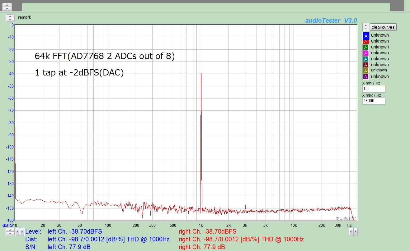

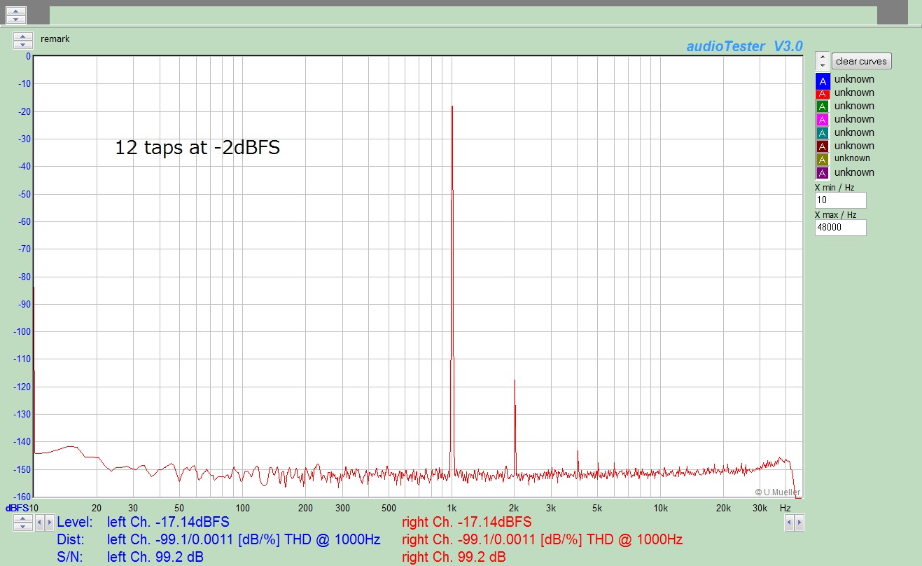

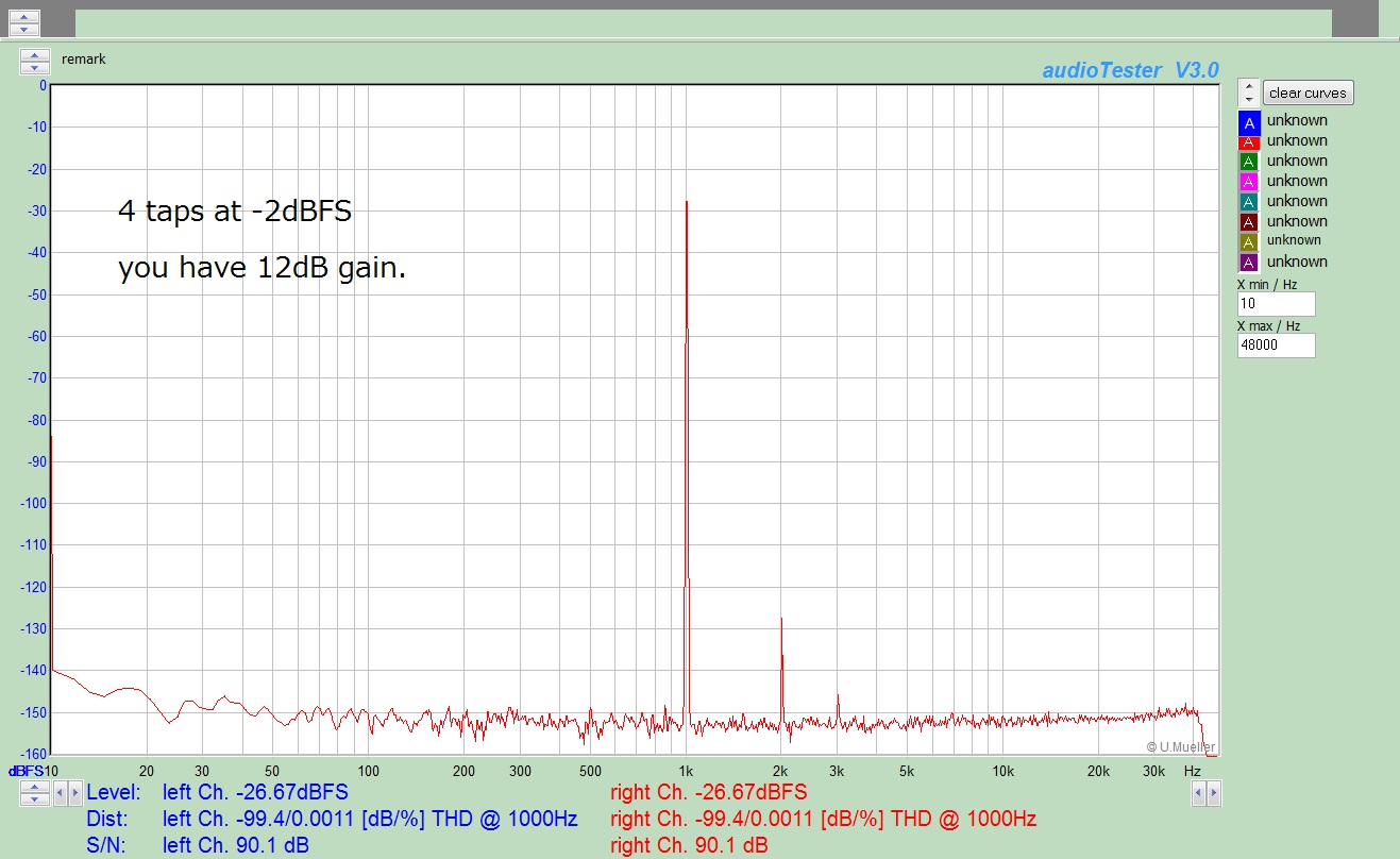

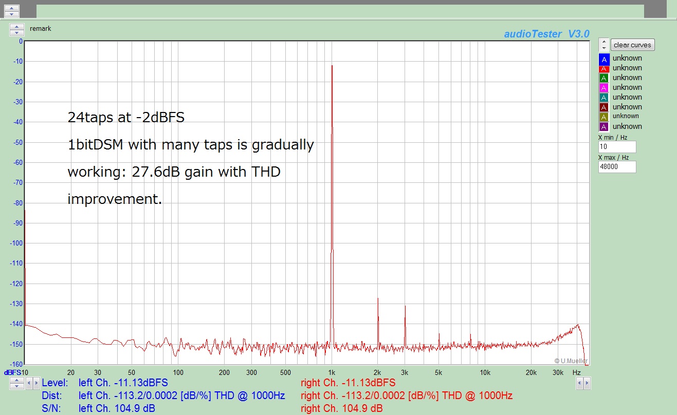

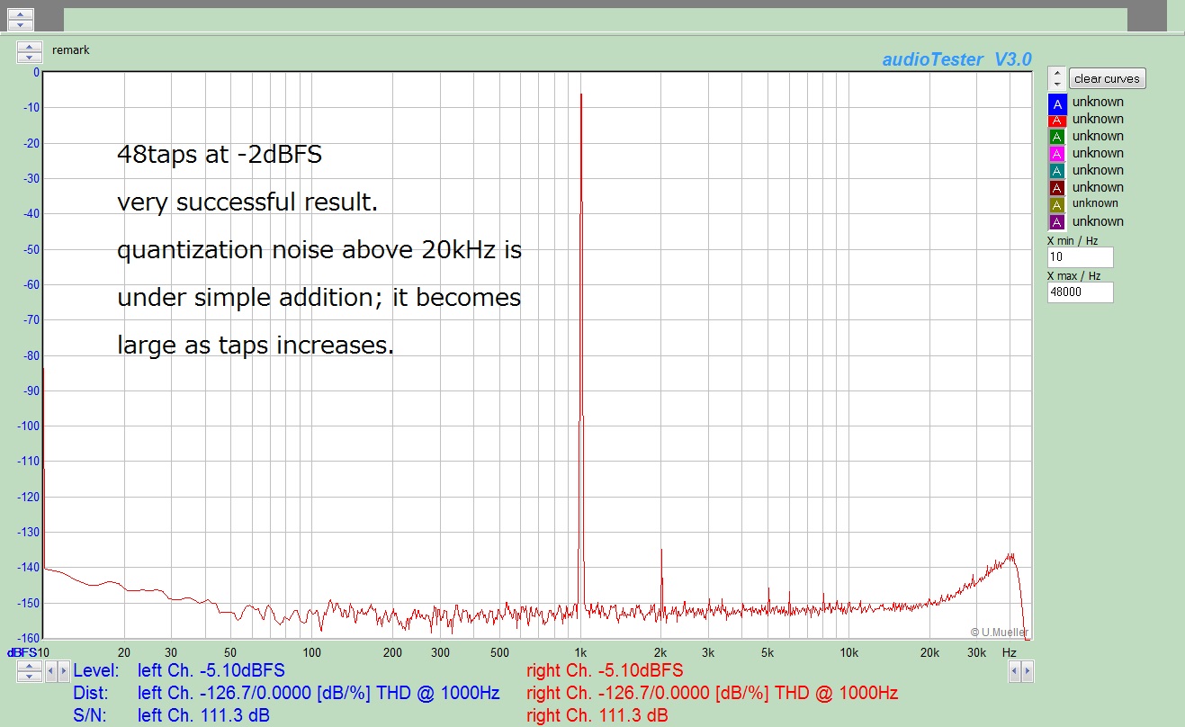

The 6th pic(48 taps) at #243 has almost -135dBFS 2nd harmonic while the 5th(24 taps) has -126dBFS. So, the other 24 taps must be -129dBFS with the opposite phase to have -135dBFS; the addition of two 24 taps is equal to 48 taps. I'm sure it's the only answer to have -135dBFS in 48 taps. The 3rd harmonic of the other 24 taps is almost the same amplitude with the opposite phase to achieve -150dBFS.

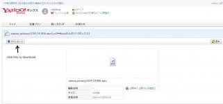

Yes, I made a 32-tone file with Wave Gen. It's incredible it has a very fine resolution, 99.609375Hz,999.0234375Hz, and 20000.9765625Hz. If you want more than eight sinewaves(32-tone), you need to have four groups: 4*(8-tone). You can add them together with editing SW, like RX7.
Mine is here. You can download it. See the attached pic.
Yahoo!ボックス - 大切な思い出をずっと大事にお預かりします
You are correct as to the meaning of one tap. The taps have some variations because of track length, switching pulse phase, temperature, and resistor tolerance. Their diversity sometimes for you or against you. I need to have some FPGA routing trials to achieve a good result. Once you have found the excellent routing, it can be partially used for the next routing: accumulation is possible.

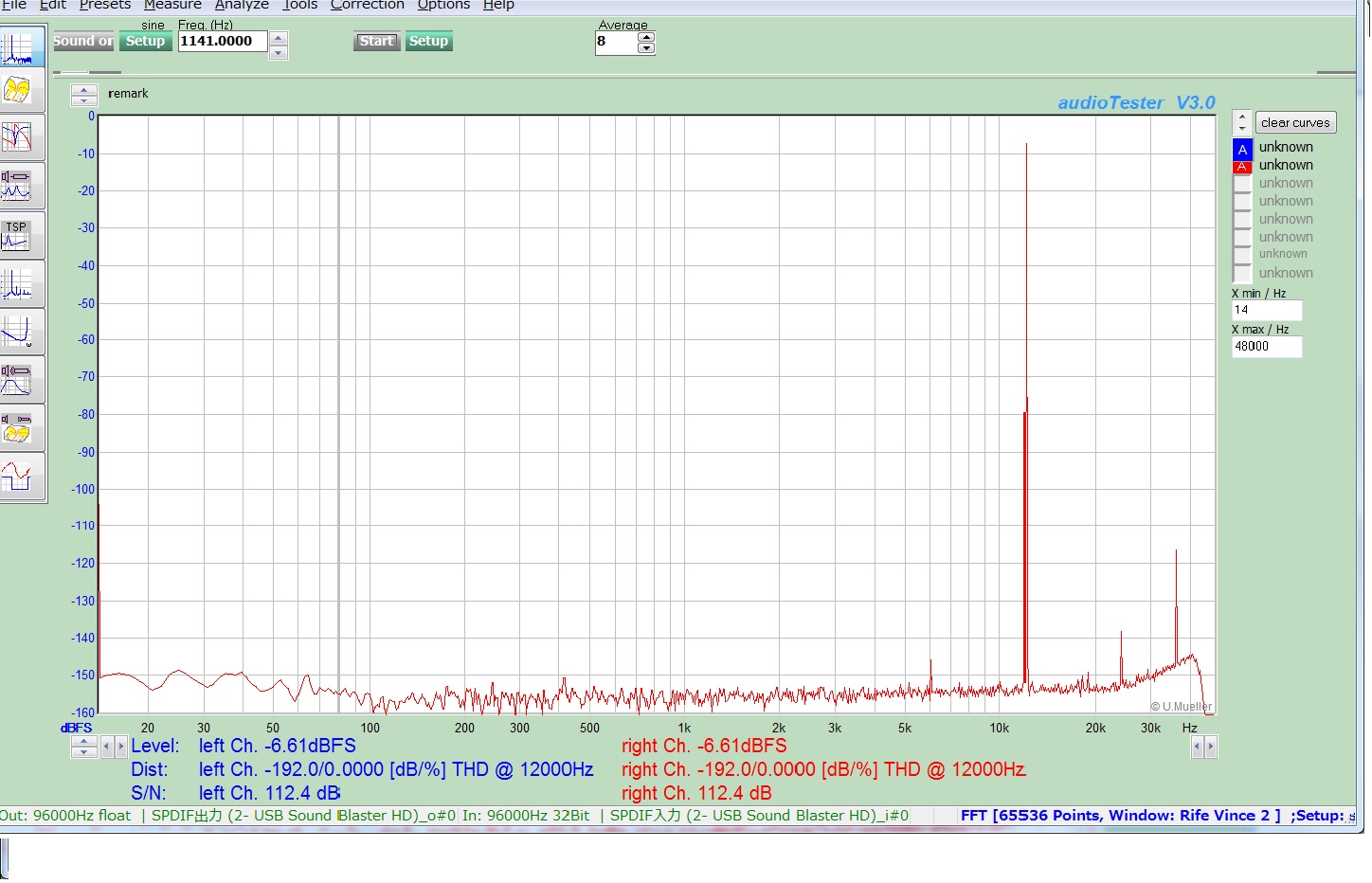

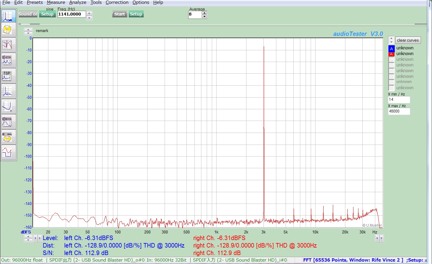

Hi ... just a brief update to my #248 comment about measuring my DAC with the sine waves xx3stksm kindly provided (I prefer to follow-up on things I say even if it may be of less importance here): I won't have time for it right now but will do so when time becomes available ... ...
Jesper
Jesper

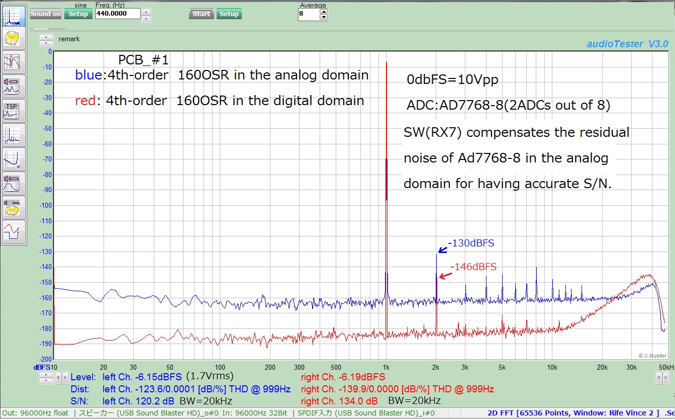

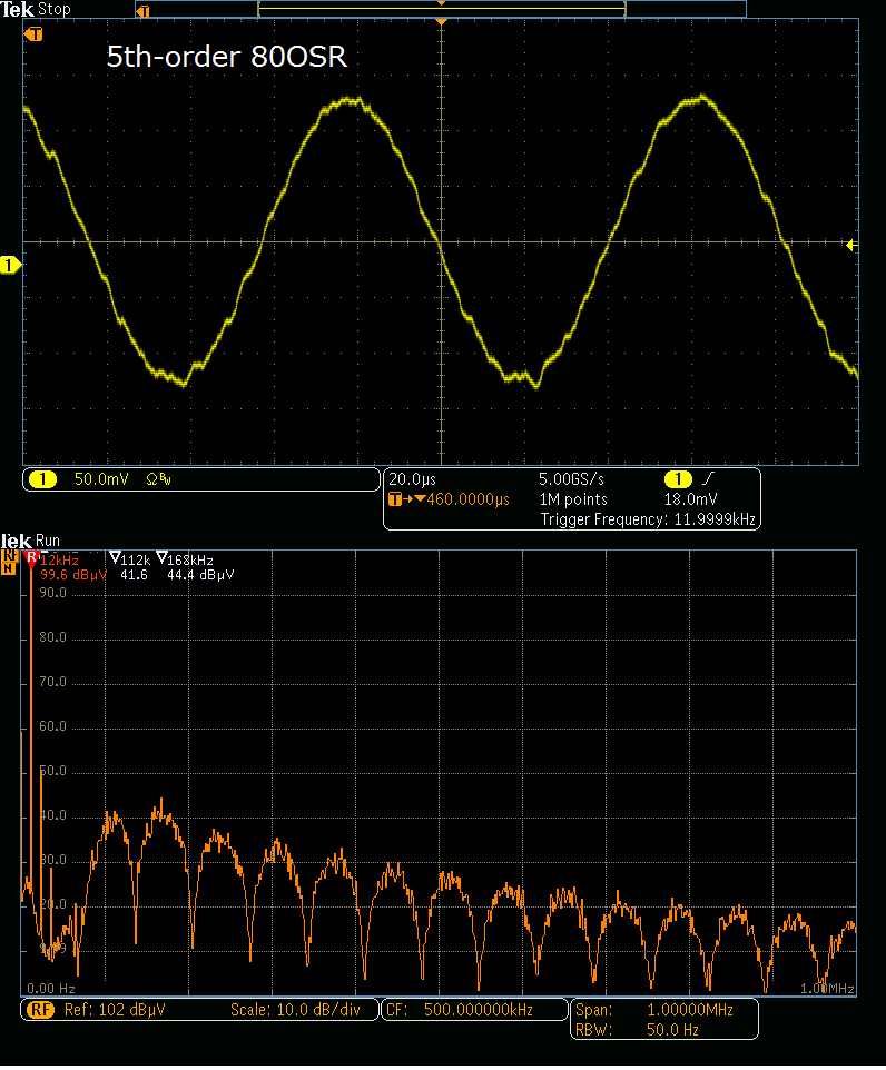

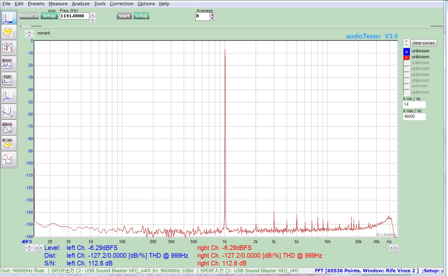

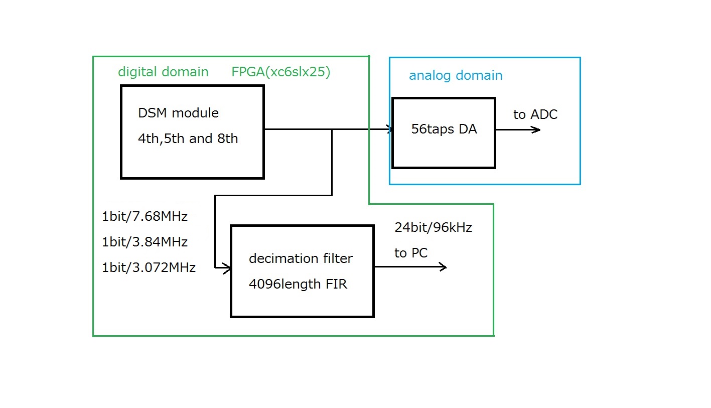

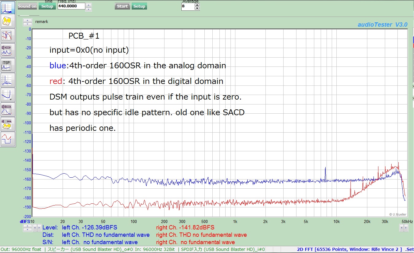

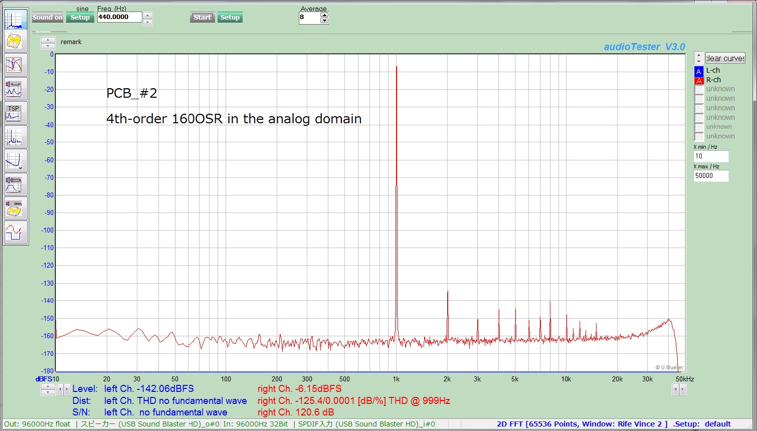

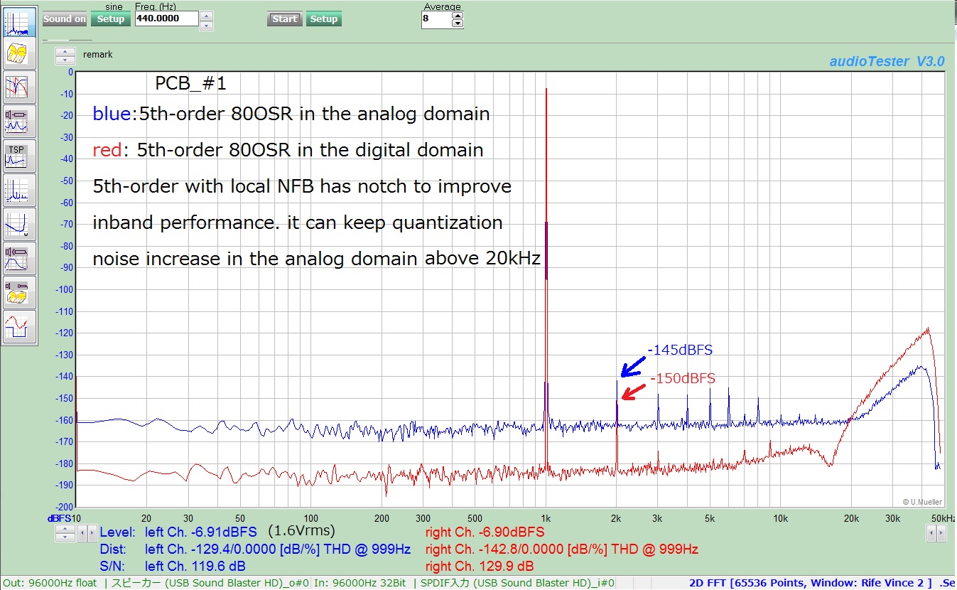

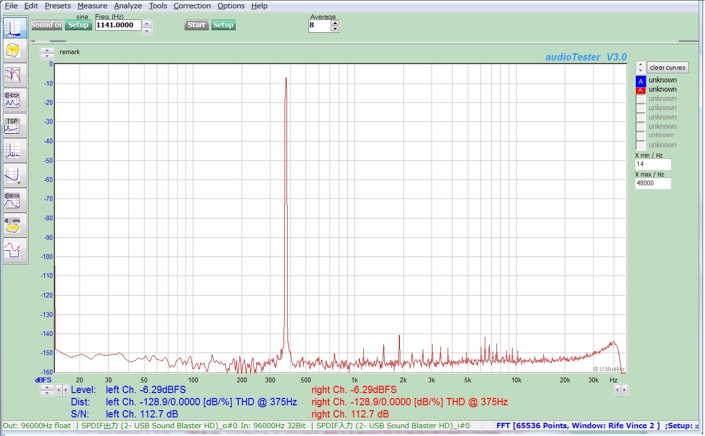

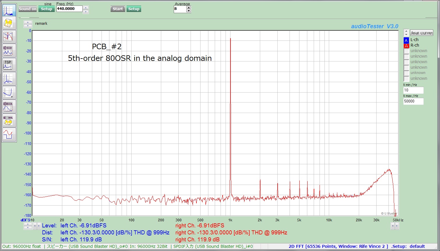

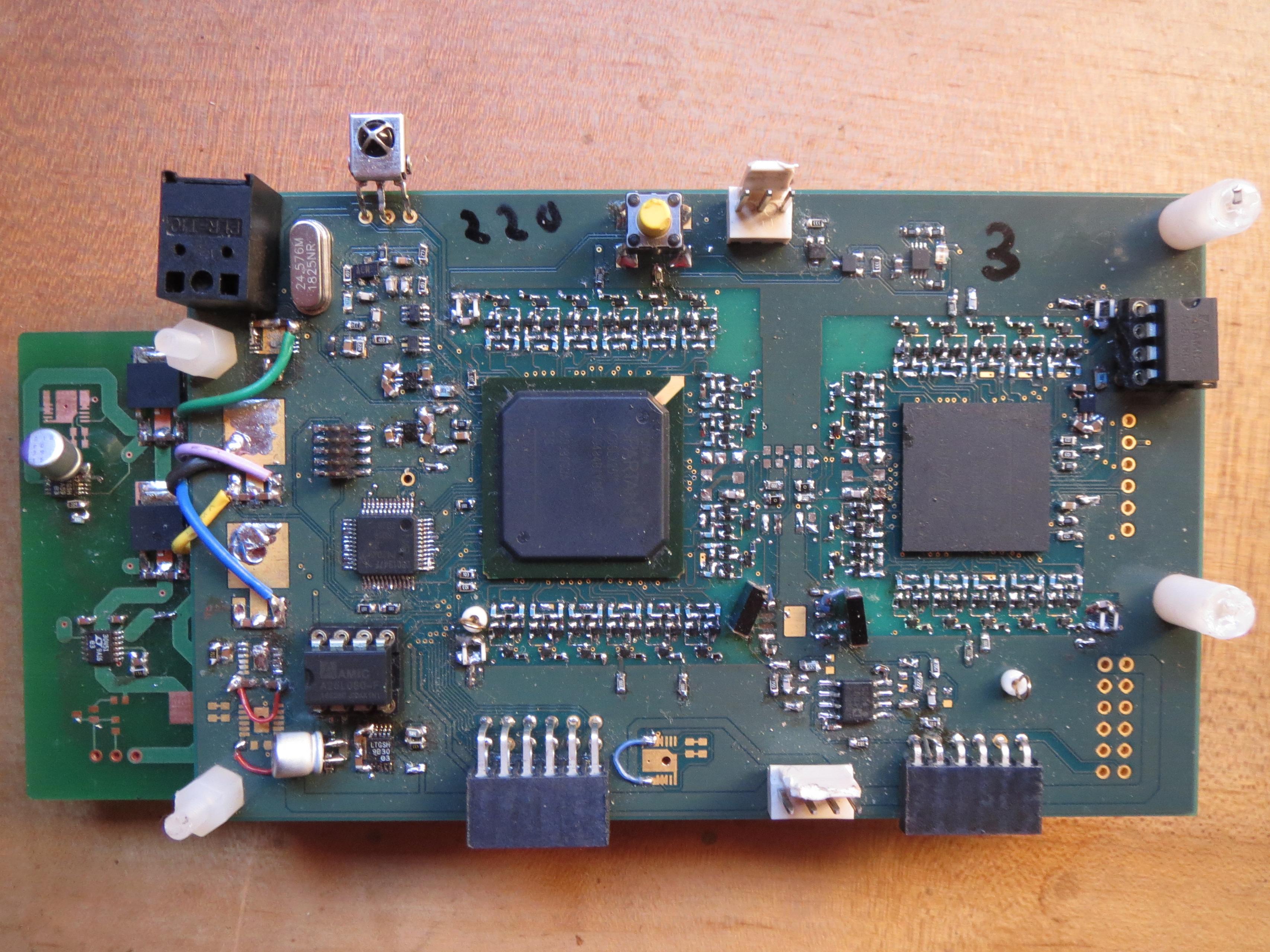

It has been a long time since the last update. 🙂I revised PCB(4th edition) last September to fix some remaining problems, repeatability, out-of-band noise, and power consumption. Pic.1 is the final version, which has 2 FPGAs(xc6slx25 and xc6slx9). A small PCB on the left side is due to heat problem. If regulators are on the main PCB, the left side becomes a bit warmer than the rest, which leads to unequal temperature conditions. xc6slx25 includes over-sampling filters, DSM, and 30taps, while xc6slx9 has 26taps only, without a complicated circuit. xc6slx25 physically can have 56taps but ends up less SNR. xc6slx9 for shift resisters only is the point to have excellent repeatability. BGA is also better than QFP if you want high SNR because it has more power and GND pins than QFP though it's impossible to do hand soldering.
Pic.2 is FFT, where blue is the performance in the analog domain and red is in the digital. The digital domain's performance is the decimation filter's output (4096taps), converting 1bitDSM into 24bit/96kHz(pic. 3 and pic. 4). It's convenient to estimate DAC quality if you have digital domain FFT. The difference between the analog and the digital means how much your 1bitDSM DAC is off from the ideal DAC.

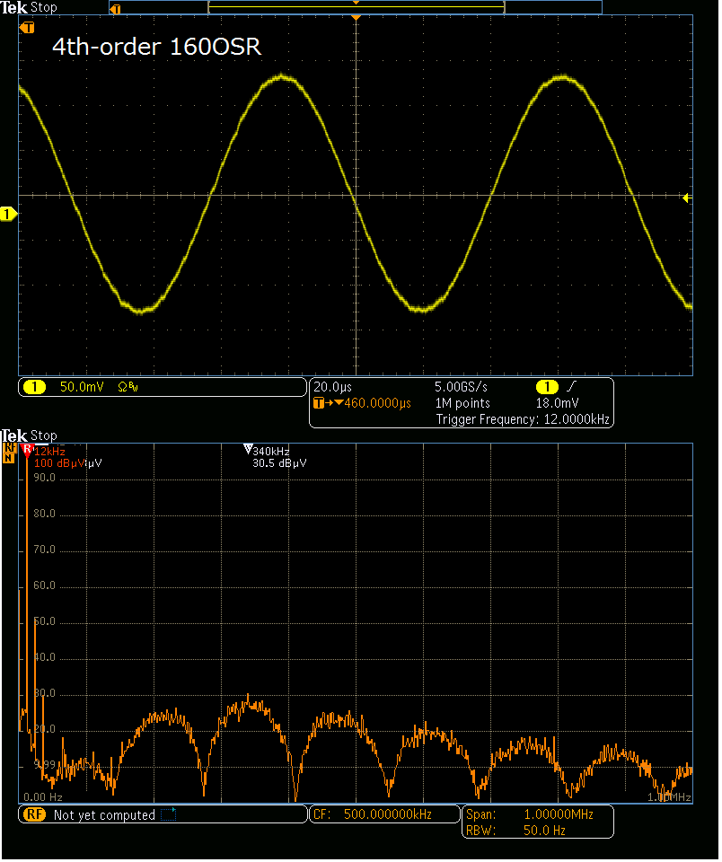

Pic.5 is the small amplitude(0.1Vrms) waveform and out-of-band FFT(up to 1MHz). I employ 4th-order in 160OSR instead of 256OSR. High OSR can have good noise-shaping performance while it tends to end up with low SNR. I'm sure 160OSR is the best point for my HW(48000x160=7.68MHz). Pic.6 is idling pattern. When the input is zero, old DSM sometimes outputs unexpected noise pattern. 😕The recent one gets rid of the specific idle pattern with an almost flat FFT.
Another improvement with the 4th PCB is to make the best of 5th-order in 80OSR.🙂 Generally speaking, the lower OSR, the better THD because low OSR means less toggling. If you use 80OSR, 6th-order is enough but a little bit overkill. 5th-order in 80OSR usually can't have excellent SNR due to poor noise-shaping performance. I have successfully tweaked 5th-order DSM so that SNR degradation is acceptable while maintaining high THD(Pic. 7 and pic.8). Out-of-band noise is a bit larger than 4th-order.
I have already soldered and adjusted 4 PCBs. They are almost the same performance as pic.2. In other words, they can be the same. What I need to do is to find an optimum combination to achieve the goal. The combination doesn't mean analog adjustment like resistor matching but digital ones that are to be stored into registers. Pic.9 and pic.10 are another PCB, which is probably the best in 4PCBs. High repeatability guarantees such excellent performance after five minutes of warming up. Five minutes is necessary to average transistors' temperature. It takes about two years before I have almost finished designing and implementing 1bit DSM for my personal use. Neither short nor long.🙂

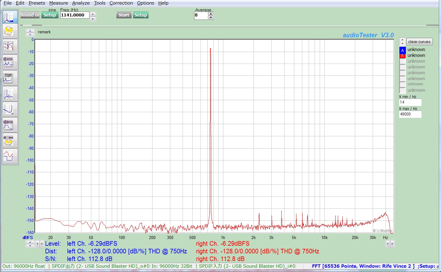

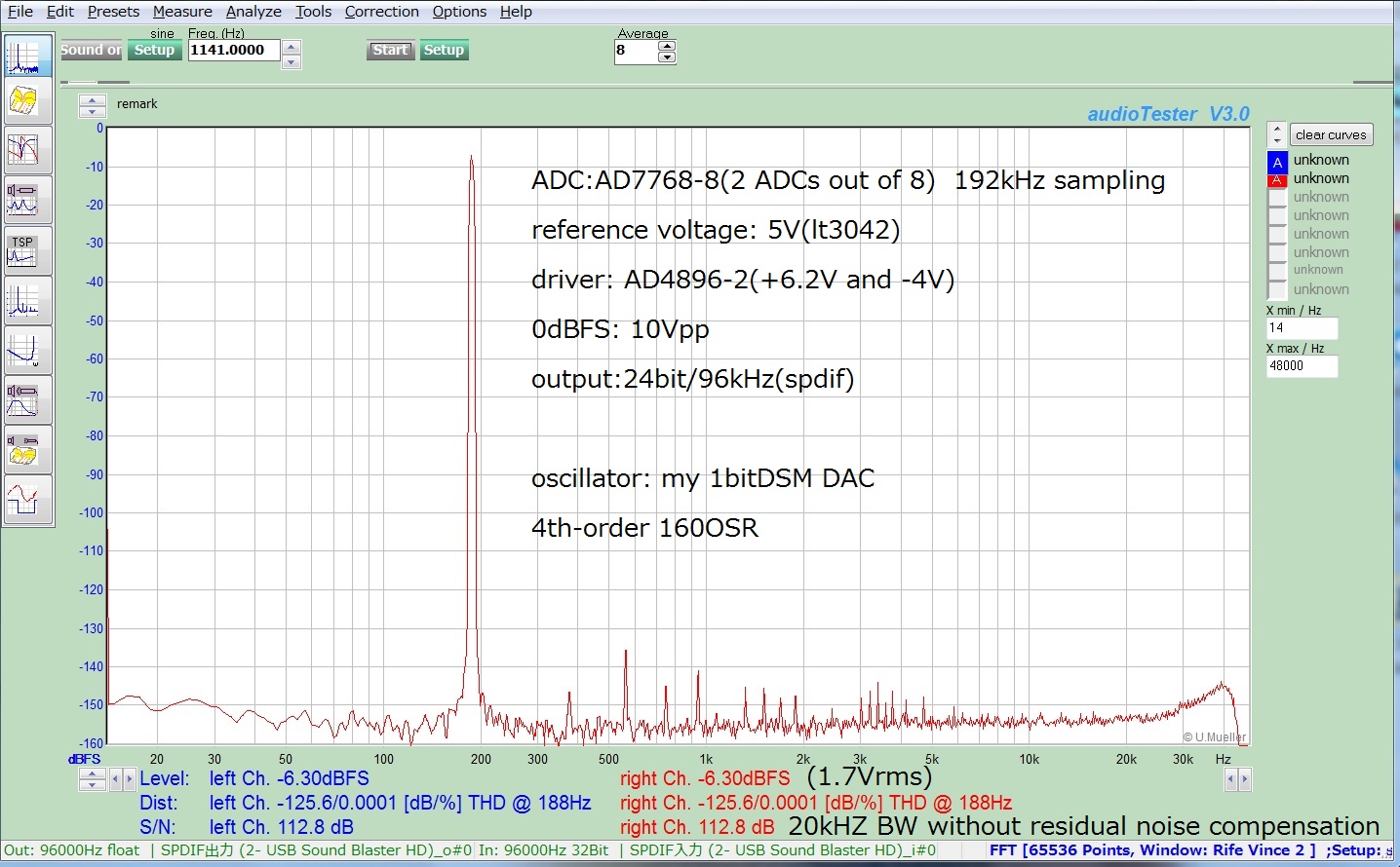

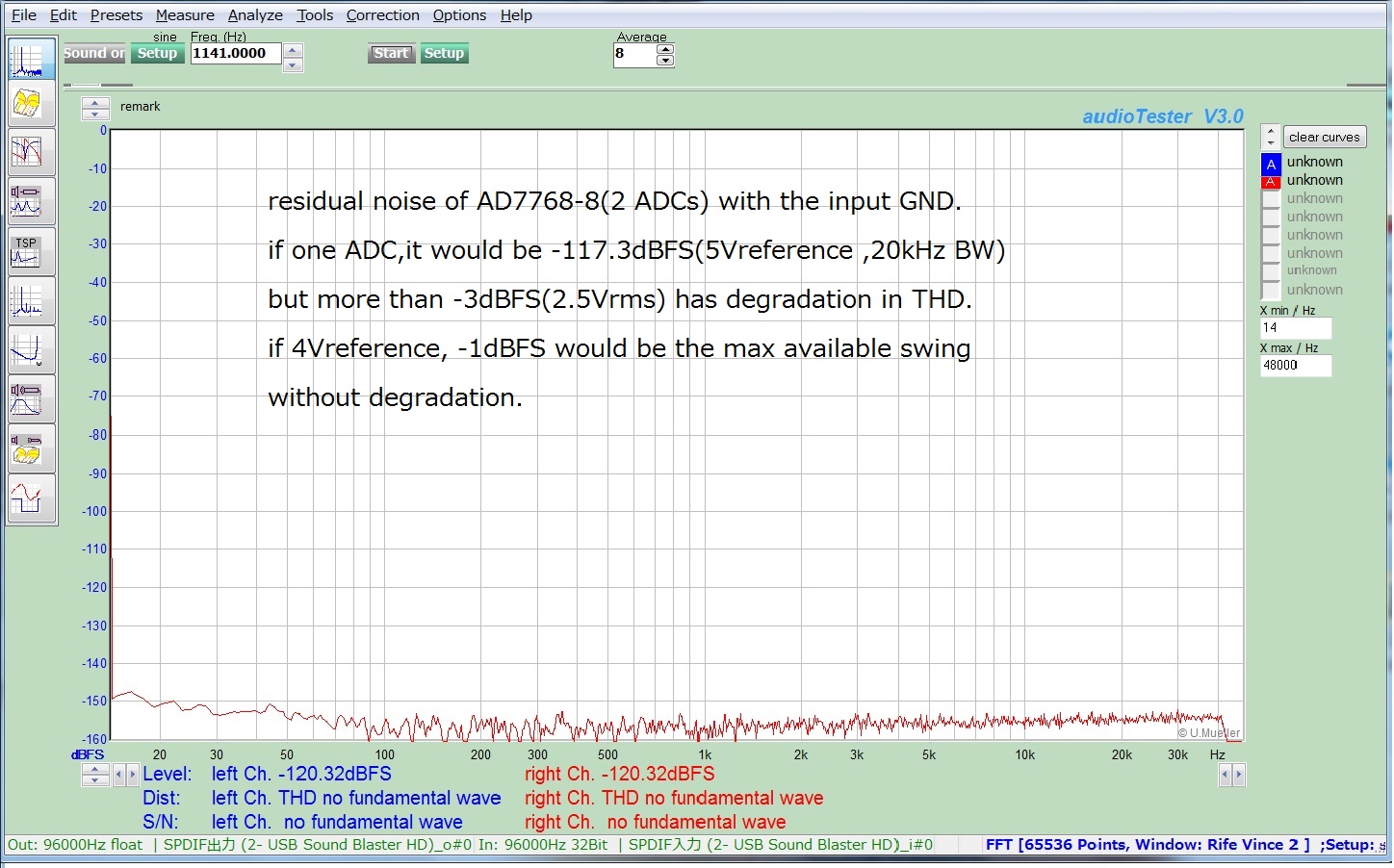

It's challenging to have an ADC with high THD performance and low noise floor. My current ADC chip is AD7768-8, which can have -130dB THD.
https://www.analog.com/media/en/technical-documentation/application-notes/AN-1384.pdf
Residual noise depends on the numbers of ADC(up to 8) and a reference voltage. The larger a reference voltage(up to 6V), the lower the noise floor. I'm sure you need to have two setups; one for THD and the other for SNR. An ADC for THD can't have an excellent noise floor because a reference voltage is 4V at max for accurate THD. A practical solution is software simulation. An ADC for SNR(paralleling 8 ADCs) measures the noise floor of DUT. Then you compensate the noise floor of an ADC for THD with SW. There may be a 1dB error in absolute value but enough for a DIYer. THD is probably correct.

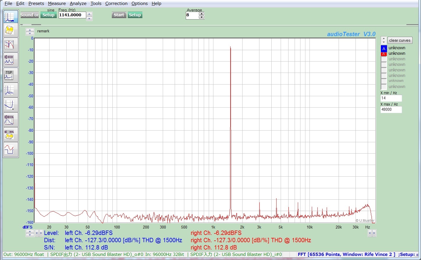

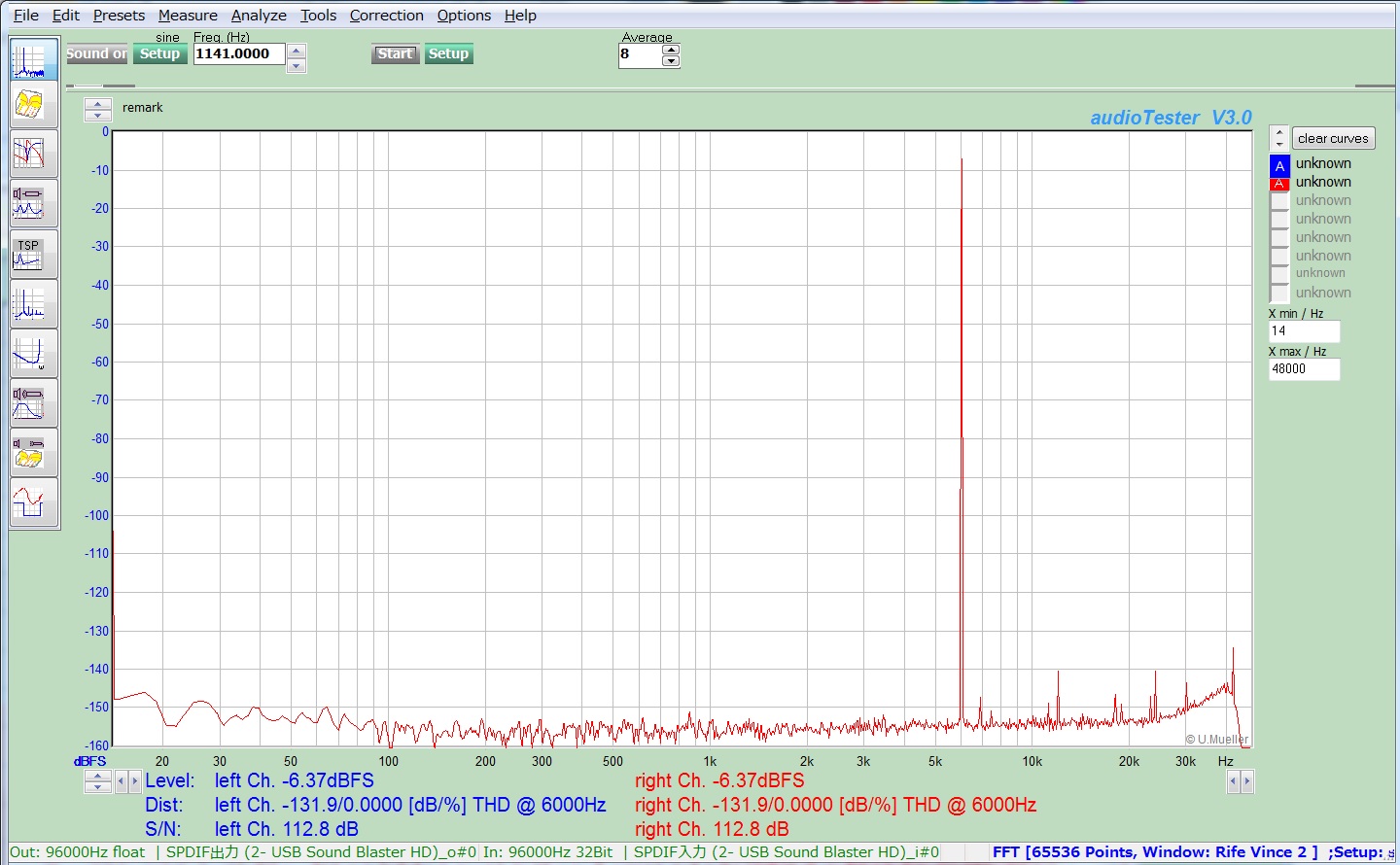

Do you happen to have a measurement of the ADC's THD performance over frequency? And at what input level do you use the ADC (dbFS)? Sorry for littering the thread, if preferred we could switch to PM...
No problem, my motto is "no ADC, no DAC.🙂 " it's not easy to have an AP product for a DIYer. But DAC performance is in proportion to ADC, especially if THD is beyond -120dB. AD7768-8 is probably reliable because each of them(8 ADCs) has almost the same THD performance. THD measured by one ADC and by two ADCs have no difference. THD over frequency is a bit tricky because my DAC accepts an optimized optical signal fed by transport or ADC. Both only have limited frequencies for practical use. They are 187Hz,375Hz,750Hz,999Hz,1.5kHz,3kHz,6kHz and 12kHz(999Hz=(96000/32768)*341) from pic.1 to pic8. The max swing is 10Vpp(differential) but -3dBFS(7Vpp) is practically max amplitude. If your DAC has more than 7Vpp, you need to have a resistor divider.
The noise floor of them isn't compensated. You can compensate the value with the residual noise of two ADCs(-120.3dBFS, pic.9) though there may be some error. If you use 8 ADCs, you can have -127dBFS residual noise, where more accurate than 2 ADCs.

@xx3stksm: IMHO very impressive results you have reached with your DAC ... I am thinking that it would indeed have been interesting to listen to it (if possible, of course) but, well, Japan is somewhat distant not least in these covid-19 times ...
