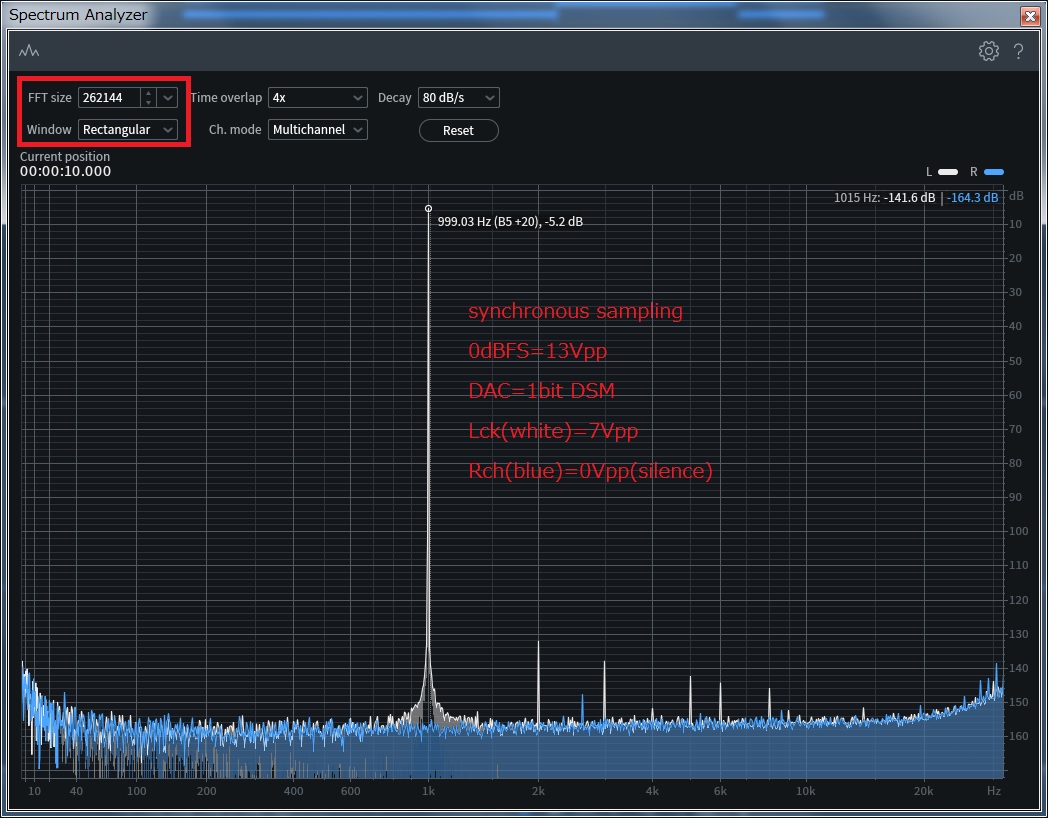

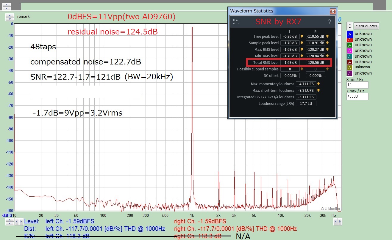

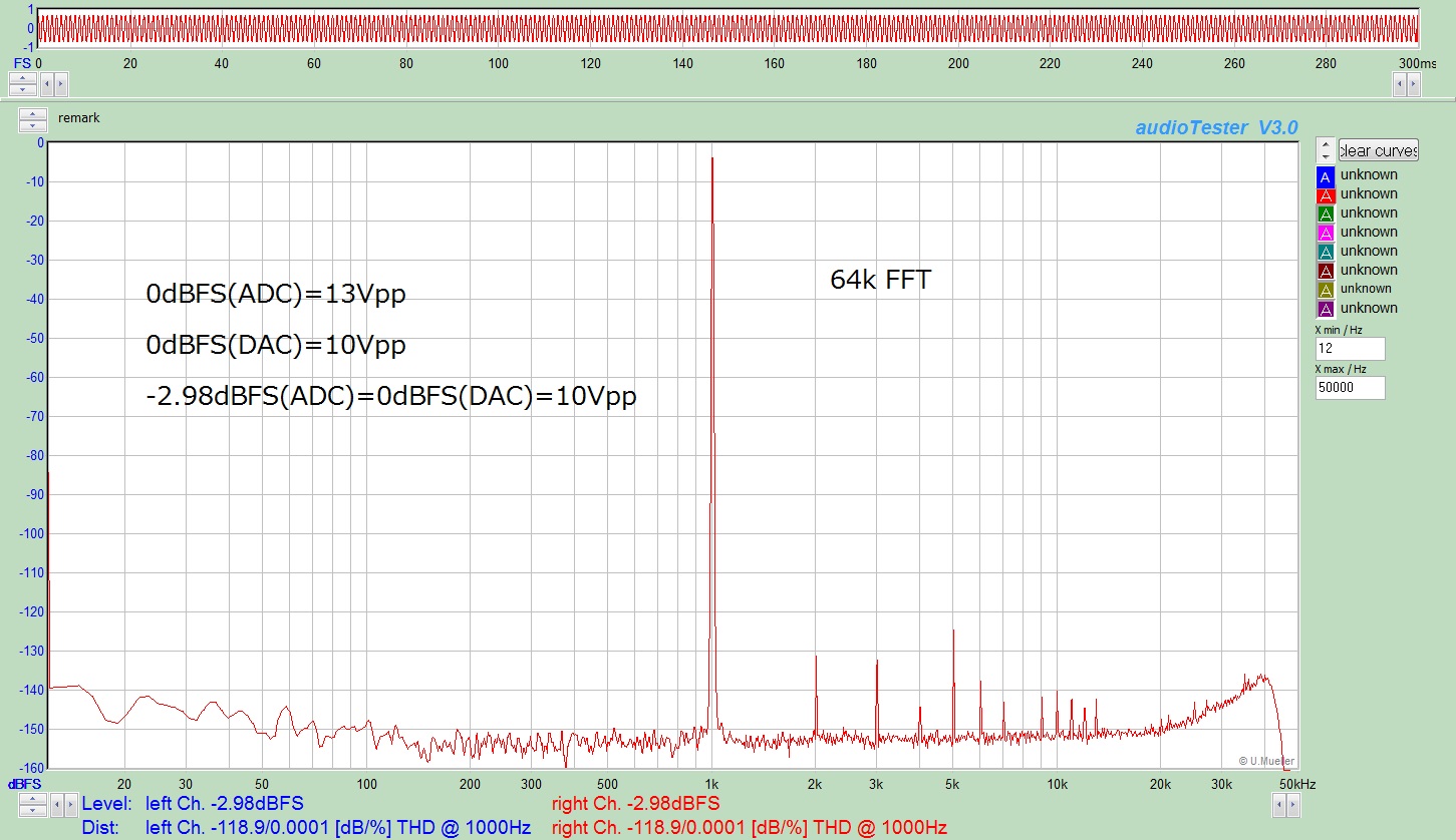

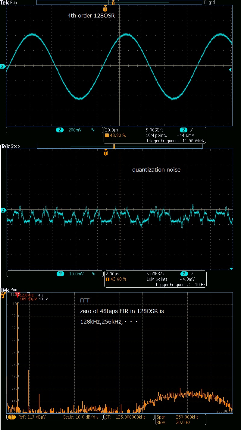

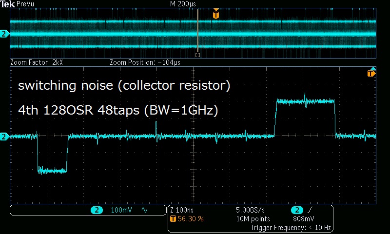

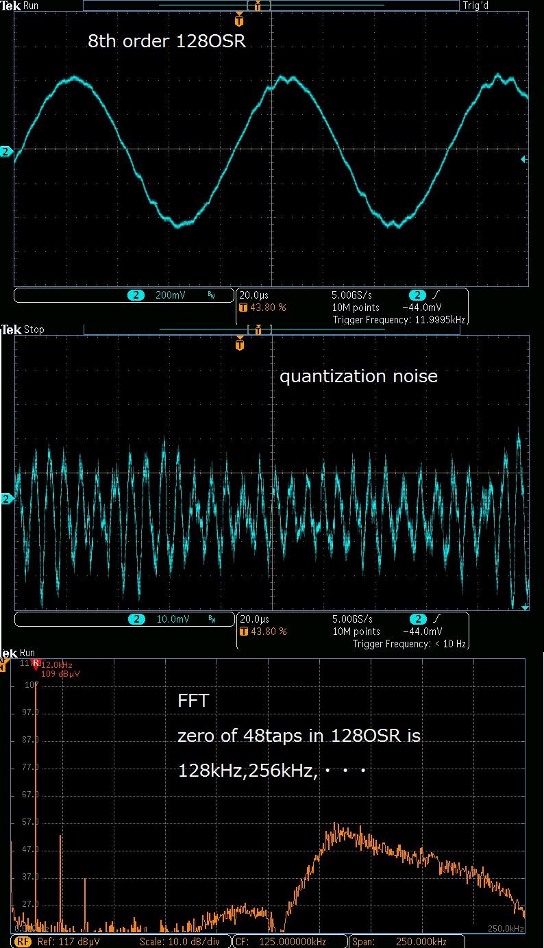

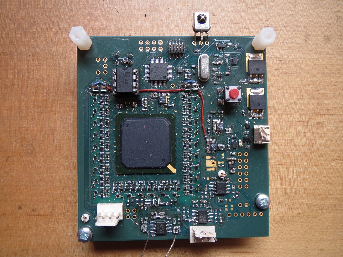

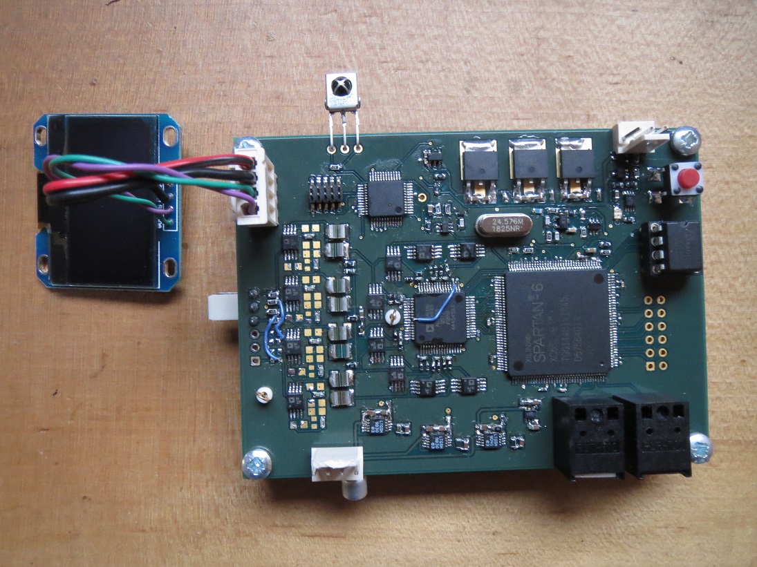

I have successfully fixed my 3rd version 1bitDSM PCB.🙂 The destination,120dB SNR, is probably achieved with some modification, which means additional LT3042 to decrease power dissipation. This is for thermal isolation between the switching section(a differential amp) and LT3042. The switching performance of transistors strongly depends on Vbe voltage. The transistors on the right side are much polluted than the left side by heat from LT3042. The PCB layout wasn't proper. Two LT3042(one is on the solder side) is one solution to decrease the unbalance temperature rise. The acceptable difference is almost 10mV for fast switching between 48 taps; the 3rd version has 48 taps.
FPGA to drive 48 taps is xc6slx25_BGA484, which has two banks with the capability of high speed and controllable propagation delay I/O. Xc6slx25 has four banks, but only two are available for fast switching: I leaned the limitation of xc6slx25 with 2nd version. The 1st pic is PCB, which is mono for thermal isolation between L and R. The 2nd is switching performance. As long as your playground is discrete, this is almost maximum. Each tap has a common collector, which means long trace(more than 10cm), results in switching delay even if FPGA outputs a perfect drive pulse. I'm sure if you want glitchless switching, the only answer is a monolithic implementation: beyond a DIYer design. Excellent switching automatically brings you high SNR and THD, especially in 1bitDSM architecture, where both have almost the same meaning.

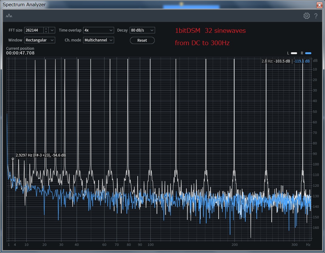

The 3rd pic is 1kHz measurement. SNR must be adjusted if your target is more than 115dB because the residual noise of ADC can degrade the value. Audio Tester also can't output an accurate number. RX7 is the alternate tool to have precise SNR: removing the fundamental and harmonics by a notch filter. Notch depth and bandwidth can make some errors, but almost reliable. More than 120dB without A filter is achievable. The 4th is quantization noise above the audio band in 4th DSM(x128OSR); analog LPF is gentle 6dB/oct. The inherent nature(advantage) of analog FIR is low out of band noise. Fouty-eight taps(x128OSR) mean moving average LPF starting at 128kHz. The 4th is better than 8th DSM(the 5th pic) because 8th has theoretically large out of band noise(the audio band noise in the digital domain is small), though the 5th pic has less noise than SACD(probably 7th order). 😉

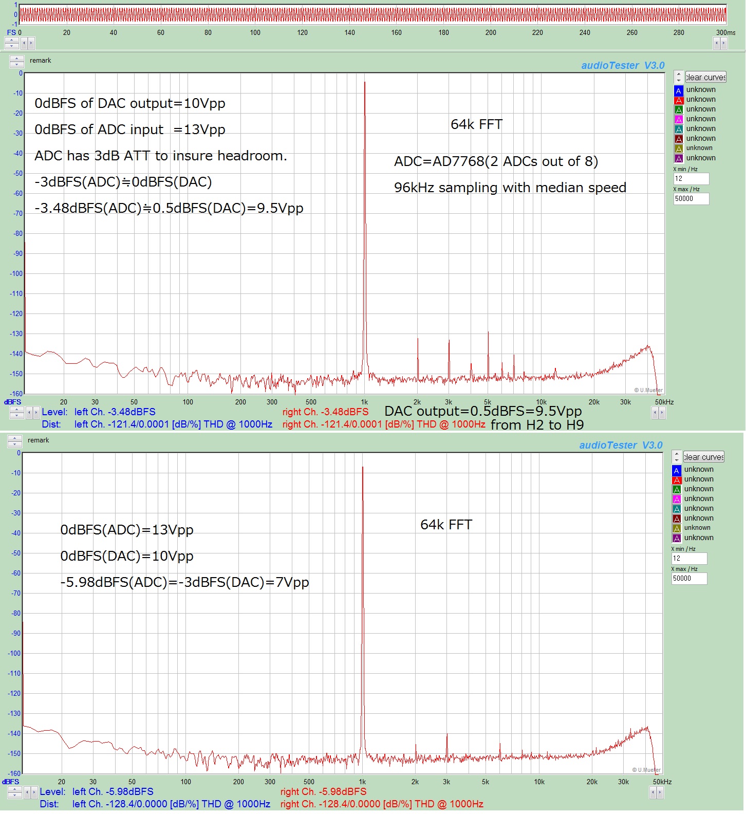

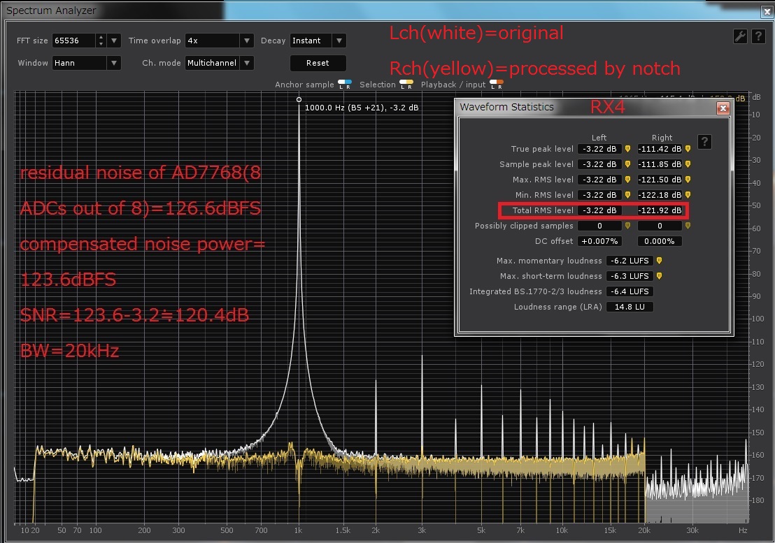

Then, I needed to swing by DSM ADC for better THD measurement. My ADC is SAR(AD7960), which has an internal C2C ladder for conversion. I guess C2C also has linearity error like standard R2R ladder DAC. The 3rd pic has a little bit strange grass at HF(more than 10kHz). So, I designed the AD7768 PCB for THD(the 6th pic). The AD7768 has eight DSM ADCs up to 256kHz sampling. Each one has 130dB THD and 118dB SNR with 256kHz sampling and 5V reference. It's a little bit inconvenient to have 256kHz sampling to be compatible with standard audio software. Xc6slx9 is the solution for SSRC from 256kHz to 96kHz, SPI to I2S conversion(AD7768 outputs SPI, not I2S), Ir interface, and spdif interface.
It took one month to fix the ADC. It can populate a notch filter. But with a notch and without a notch, had no difference if your target is less than -3dBFS. The performance of AD7768 is excellent. The 7th pic is measured data by AD7768. You can no longer find grass at HF. The upper is -0.5dBFS(DAC 9.5Vpp). the lower is -3dBFS(DAC 7Vpp). A little bit small amplitude(-3dBFS) can have better THD, So is other DAC topology. THD at -3dBFS is a very extreme number(128dB). The most surprising is repeatability. You need ten-minute warming up for thermal stability before measurement. Once Vbe has reached a stable temperature, You can always have 128dBTHD: the very inherent advantage of 1bitDSM. You can modify the AD7688 for SNR measurement. Eight ADCs are mandatory for the low noise floor(126.6dB), though it's better to have 3dB ATT to ensure the headroom. The 8th pic is SNR measured by the AD7768. The Ad7768 and the AD7960 have almost the same value. The difference is probably due to notch performance.
1bitDSM has high potential as I imagined one year ago. The 4th PCB can be the final one. I have to modify PCB for the fixed version. It takes two or three months. My journey to 1bitDSM is going to cut the goal tape at the end of this year.🙂

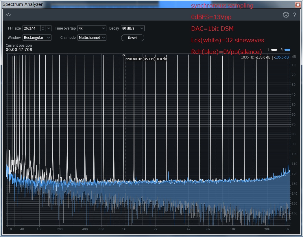

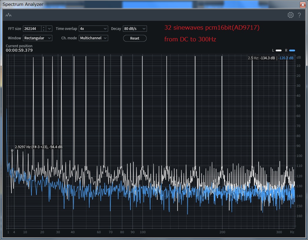

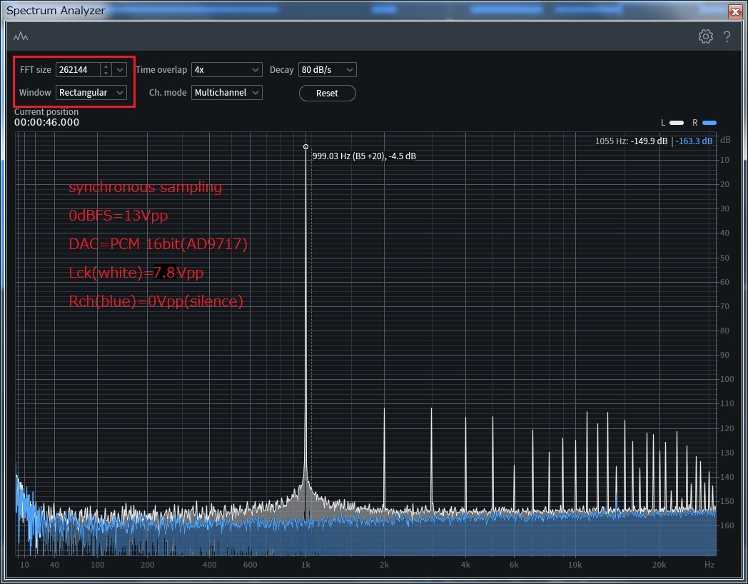

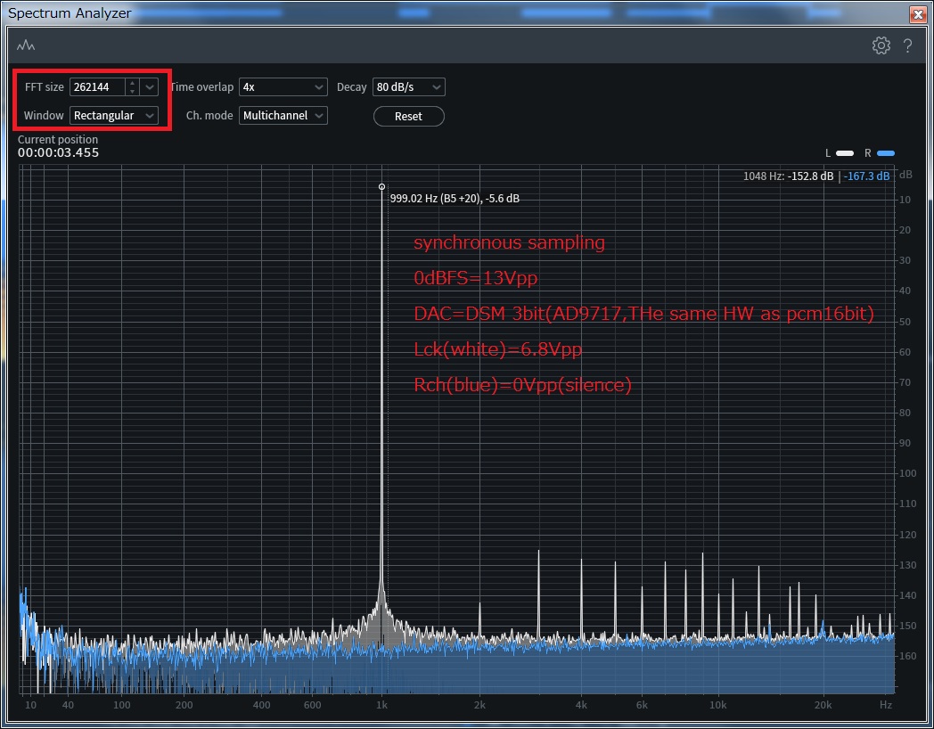

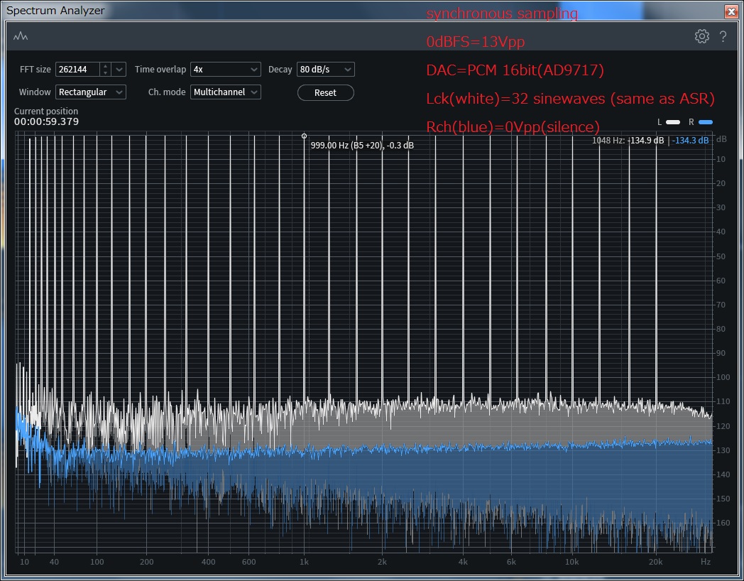

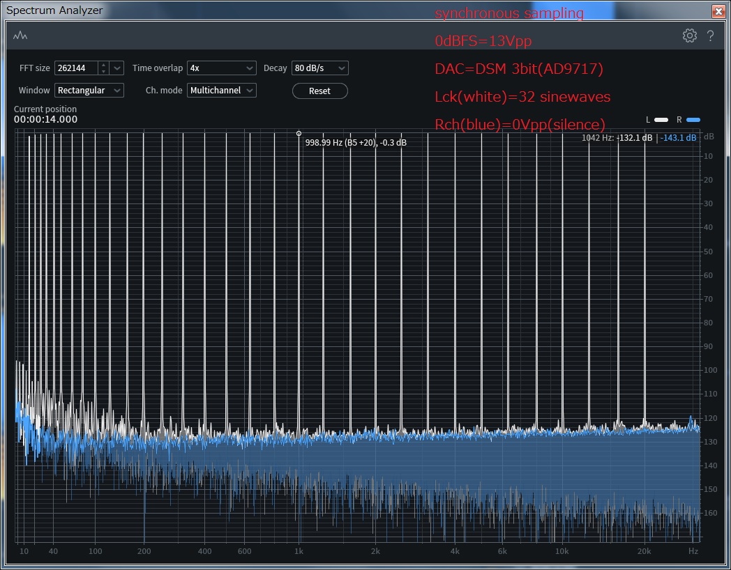

comparison between silence and tutti
I measured the difference between no input and a large amplitude. Standard 1kHz doesn't have a distinct difference. The 1st pic is 16bit PCM, which was the replacement for pcm1704: I was satisfied with it. The 2nd is 3bitDSM, which is the same hardware as the 1st pic. The 3rd is 1bitDSM. I preferred pcm1704 to pcm1792. So, I wanted to figure out if the difference comes from the architecture(PCM or DSM). The same HW with different modulations can be the answer.
Static measurement like 1kHz doesn't tell you the truth. The difference is little variation in THD. But the listening test had an audible one. DSM was better than PCM for me. Thirty-two sinewaves(the 4th pic) used in ASR measurement is more effective than 1kHz. The test must have synchronous sampling to utilize the correct bin; the rectangular window is mandatory.

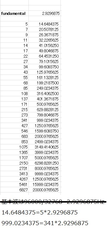

Another problem to do 32 sinewaves is ADC quality. It's not easy to guarantee excellent quality as AP has. I don't know which side is to blame for noise increase at LF, DAC, or ADC. The 5th (16bit PCM), the 6th (3bit DSM), and 7th (1bit DSM) are my results. The 8th and the 9th are magnification.
There are measurements done by AP. They also have a noise increase at LF. The test signal is the same as my measurement, but the FFT length is probably 256k. The results are normalized to have 0dBFS(each 32-tone), which means 32bit floating because the max level(total of 32-tone) is far beyond 0dBFS. So are my plots.

I guess a large noise increase like 16bitPCM is the worst. It's better to have large noise at silence rather than low noise at silence. If no fluctuation between silence and tutti, the human ear can't notice an audible difference, IMHO. An old school DAC probably has large noise at silence, where you can't notice a noise increase at tutti: good impression.
CD-quality noise floor (-90dBFS) is often recognized as a warm and organic sound. I sometimes inject such noise into a noiseless digital recording file. Recent noiseless one is cold and not a humanlike sound for me. Noise injection is one solution to make them live.

xx3stksm,
Very good results 🙂
Do you have THD FFT at 0dB?
With my simple discrete "Dual tap" DAC I see the highest harmonic at about -120dB @ 0dB - with the 3rd harmonic being the highest....
The Mola Mola DAC has -130dB apparently, but with far more taps... with just 2 taps (DAC elements) I have to balance DNR verses THD...
Very good results 🙂
