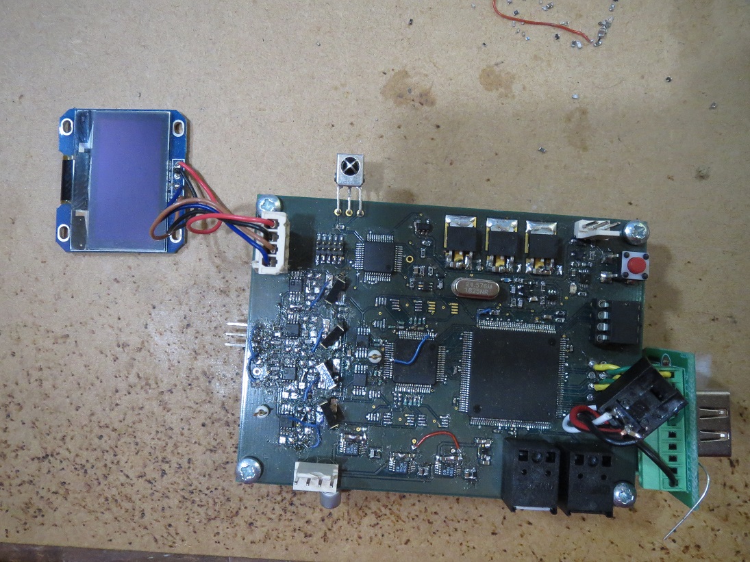

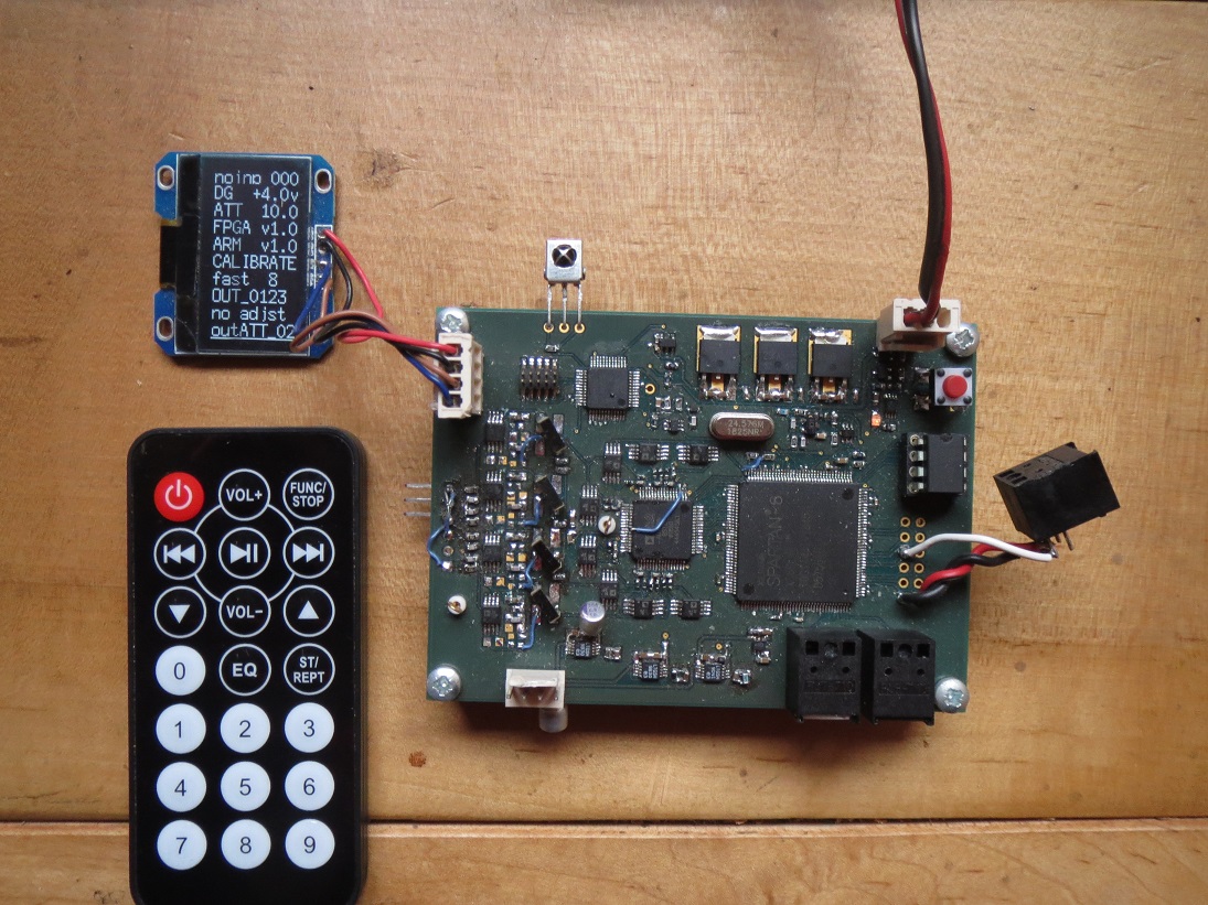

My ADC board(the attached pic) has a footprint of a notch filter. But I haven't had a good result on SNR. It's not preferable to use more than a 500ohm resistor if your target is more than 120dB SNR. Fortunately, AD7768 and TI's precise ADCs don't force you to eliminate the fundamental even if DUT has less than -130dB THD. So, I gave up a notch filter.
The pic is 1st version, where I had some mistakes and found some functions to add(HDMI-IIS and an optical output for DAC to do synchronous sampling). The 2nd one is now under construction to fix bugs and improve a digital process, which means a bit large FPGA(now xc6slx9) is necessary.

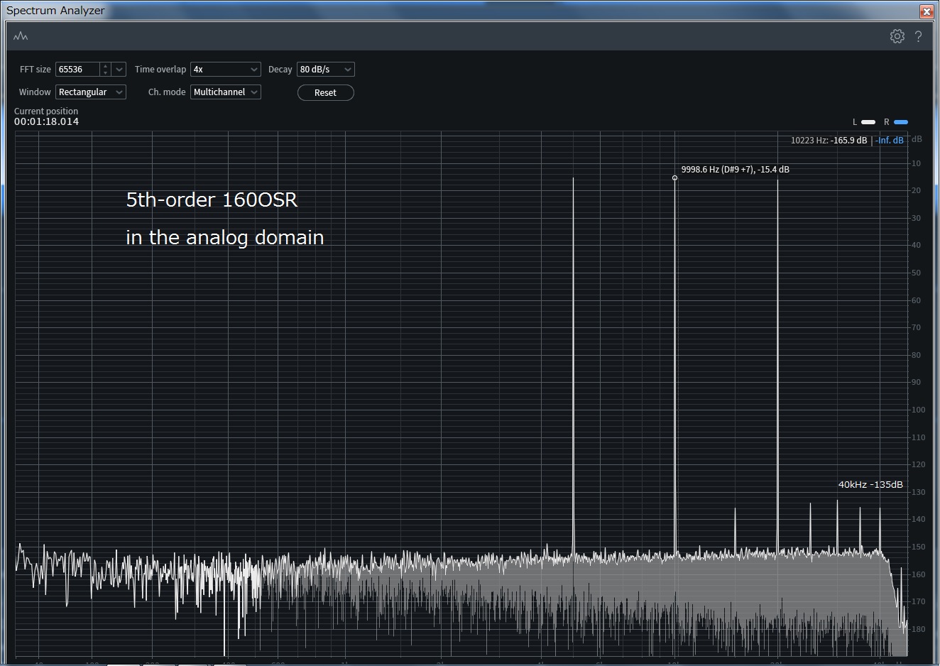

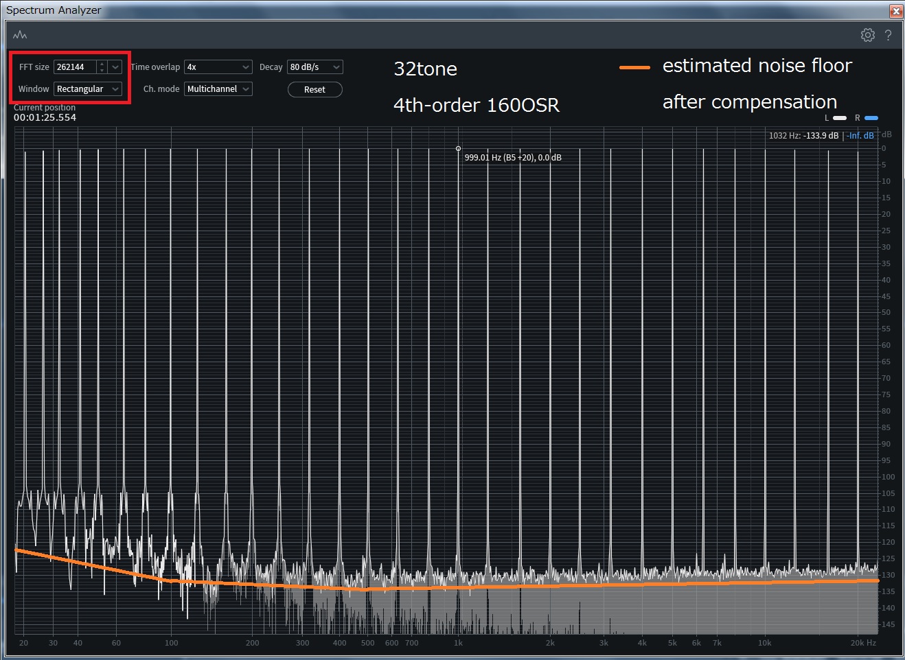

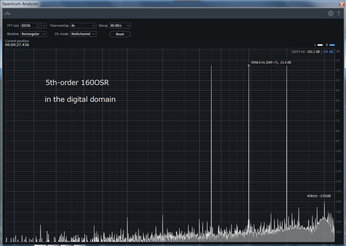

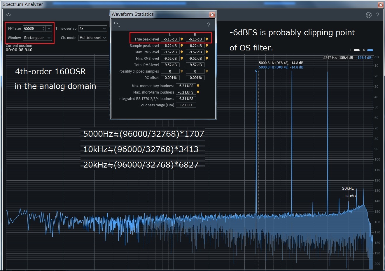

Have you done a three tone test with (combined) levels close to clipping? If you pass that you are good to go. Nice project!!!
Pic.1(analog domain) and pic.2(digital domain) are three tones close to the clipping level. Distortions more than 35kHz are a bit larger than lower frequencies. I guess this is caused by less noise-shaping because the digital domain already has large ones. If you use 5th-order 160OSR(pic. 3), which has better noise-shaping, more than 35kHz are almost the same as low frequencies. Pic4(digital domain) suggests that noise-shaping is effective at 40kHz. The difference is THD loss by DA process.
Pic.5 is 32tone, the same one ASR is employing.

I guess their FFT size is 256k, but I don't know what windowing they use. 1bitDSM has less periodicity than a multi-bit one theoretically. Less periodicity ends up the degradation of the noise floor. It would be the disadvantage of 1bitDSM, though I don't think it's audible.

ADC output(quasi 192kHz SPI) goes to FPGA(xc6slx9), then FPGA outputs spdif(24bit/96kHz), HDMI-IIS(up to 32bit/192kHz) and optical interface(phase modulation). The LPC1347(cortex-M3) controls FPGA registers and OLED via IR. If you want to control the ADC from Linux, some interface like IIC is simple. Another option is HAT. Rpi can directly accept IIS, though I have not experienced IIS output. Rpi has IIC.
I'm now designing the next version of my ADC. Some modification is possible to be compatible with your needs. But it's not easy for a DIYer to solder 1005 chips as close to power and GND pins as possible. You could have a short-circuit. I can share PCB data(Garber) and FPGA data(MCS) but can't provide a populated PCB.

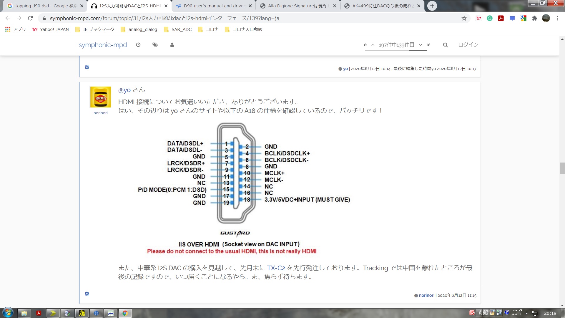

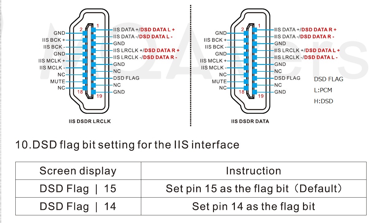

If your motherboard can output MCLK and LRCK via HDMI-IIS(LVDS), it's straightforward to use them to do synchronous sampling. Then my ADC board outputs DATA to your motherboard. My FPGA configuration will use HDMI-IIS as outputs(MCLK, BCK, LRCK, and DATA). For your configuration, HDMI-IIS acts as two inputs(MCLK and LRCK from your motherboard, BCK is don't care) and one output(DATA). PCB layout needs no change. Only configuration data(MCS) is different.How about controlling FPGA registers, which can change ADC's sampling frequency and power dissipation? It's possible to use IIC of HDMI-IIS. FPGA has enough I/Os to be configured as LVDS.
One concerning thing via HDMI-IIS is the voltage difference on signal GND between them if both are powered by the main(optical is completely safe). Even 5V is dangerous enough to fry FPGA. HDMI cable is usually "GND first." As long as the first contact is GND, no problem occurs. As to 1005, it means 0402.
I was planing to just use 3.3V I²C over the hdmi cable for the DACs. So it would make sense to use that to control the ADC, too. That all sounds very good to me.

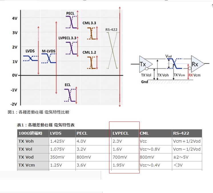

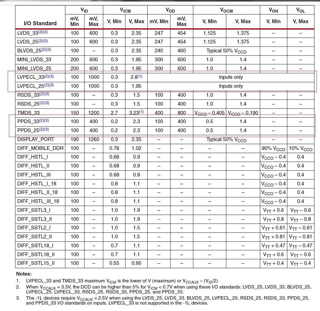

I am planning to use LVPECL as drive level to our DACs with a termination resistor of 100 ohms at the receiving side. Do we need to adjust levels for your ADC board to LVDS then?

Unfortunately, FPGA doesn't support LVPECL output(input only). If the ADC board outputs LVPECL (data to your motherboard), PPDS with AC coupling is a candidate to ensure a 0.7V swing required by LVPECL. I think it's not impossible to use PPDS output instead of LVPECL. If LVPECL isn't mandatory, LVDS is easier than LVPECL.
