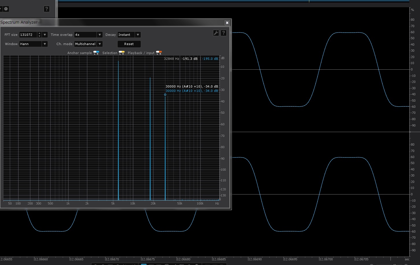

You can find a slight footprint of mains hum at the 3rd pic. of post #1, which is the plot of made in china board(ES9038) powered by mains. 50Hz and 150Hz are visible in the blue plot. My DIYed PCBs are powered by batteries, where almost no mains hum exists.
I'm impressed with no viable mains hum on a FFT noise floor of -160dB 🙂

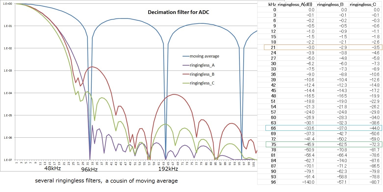

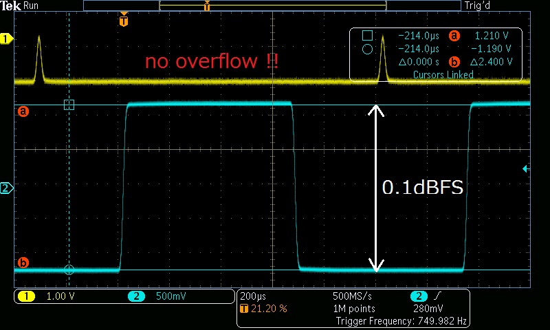

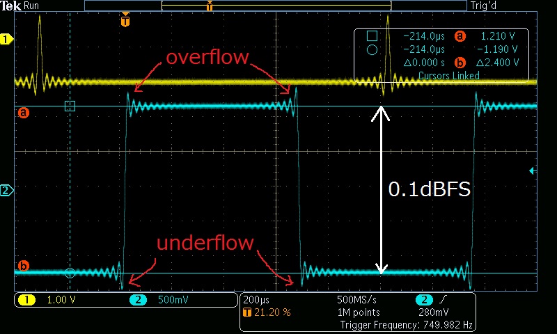

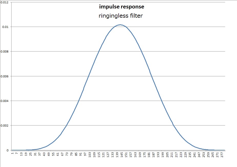

I'm sure the brick wall filter isn't a culprit because the digital system is ultimately band-limited one. The brick-wall inevitably outputs ringing to do their job if the input has out of band spectrum. If the input square wave is properly band-limited, the brick-wall never outputs ringing. The 1st pic is the evidence. The upper waveform is the "legal" squarewave, which has three spectrums 6kHz,18kHz, and 30kHz in 96kHz sampling. The lower one is the output of the brick-wall with 40kHz cutoff. The three spectrums are in the passband, where neither amplitude nor phase is changed. The lower is the same as the upper. The real culprit of ringing is the out-of-band spectrum, not the brick wall.
But I guess recent loudness war files make the brick wall faulty. The 2nd pic is 0.1dBFS squarewave. Loudness war files have almost the same effect. If you don't have 3dB headroom, nearly every recent CD has Inter Sample Overs. Overflows and underflows cause fatal degradation in SQ. If your reconstruction filter is ringingless like the 3rd pic, no overflow exists even if you don't have 3dB headroom. The disadvantage of ringing less filter is slight droop.
I'm sure -3db droop at 20kHz(typical performance of ringingless filter) is far more acceptable than overflow. I guess that's the reason why ringingless or slow one has a popularity.
