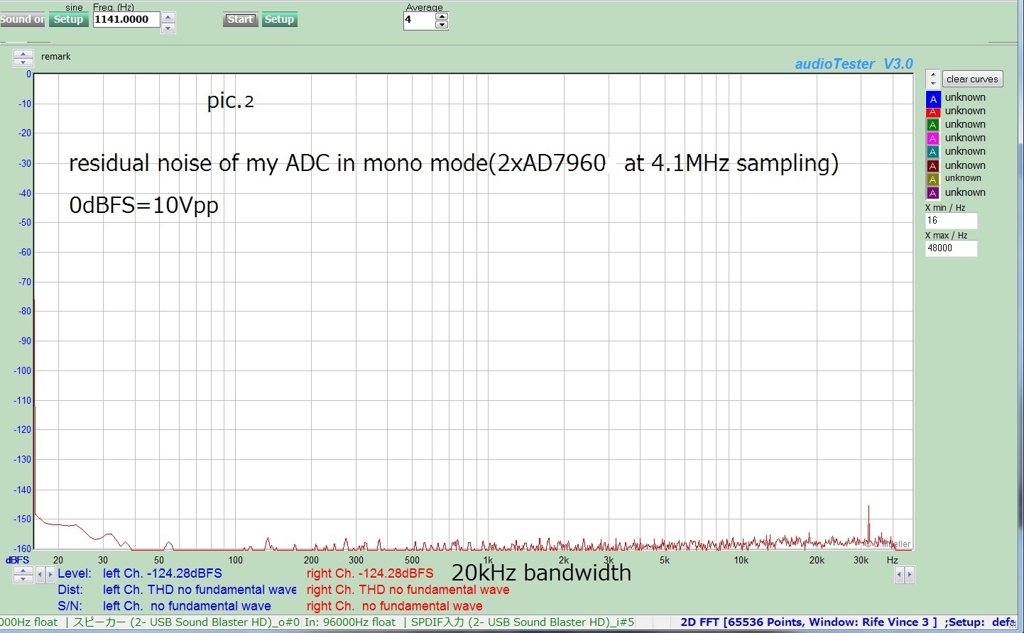

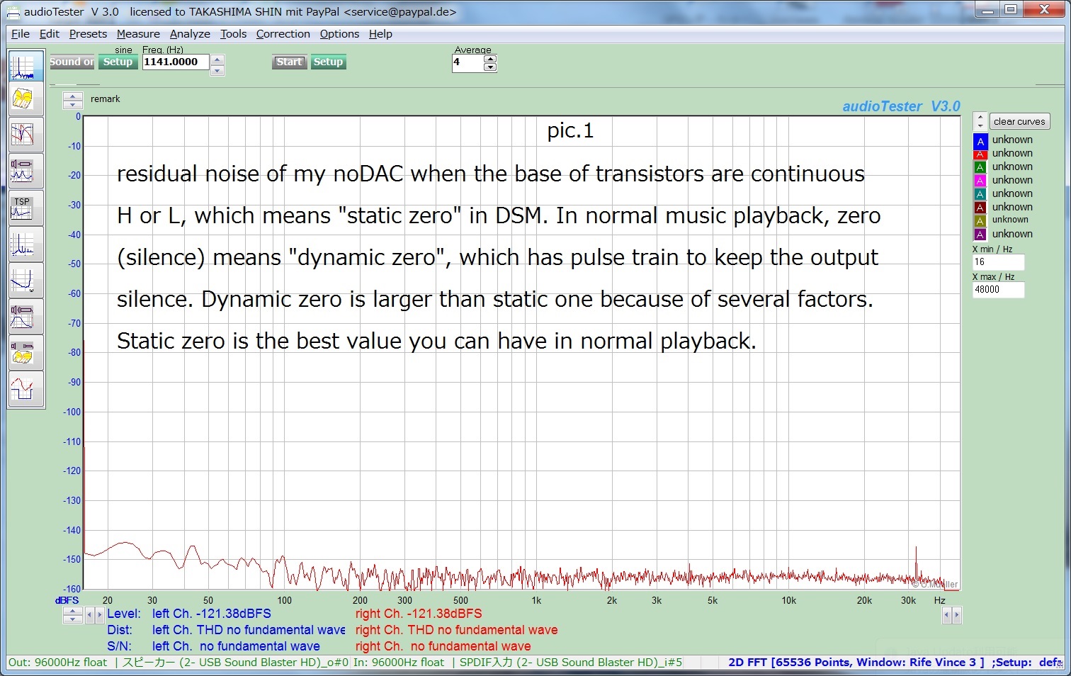

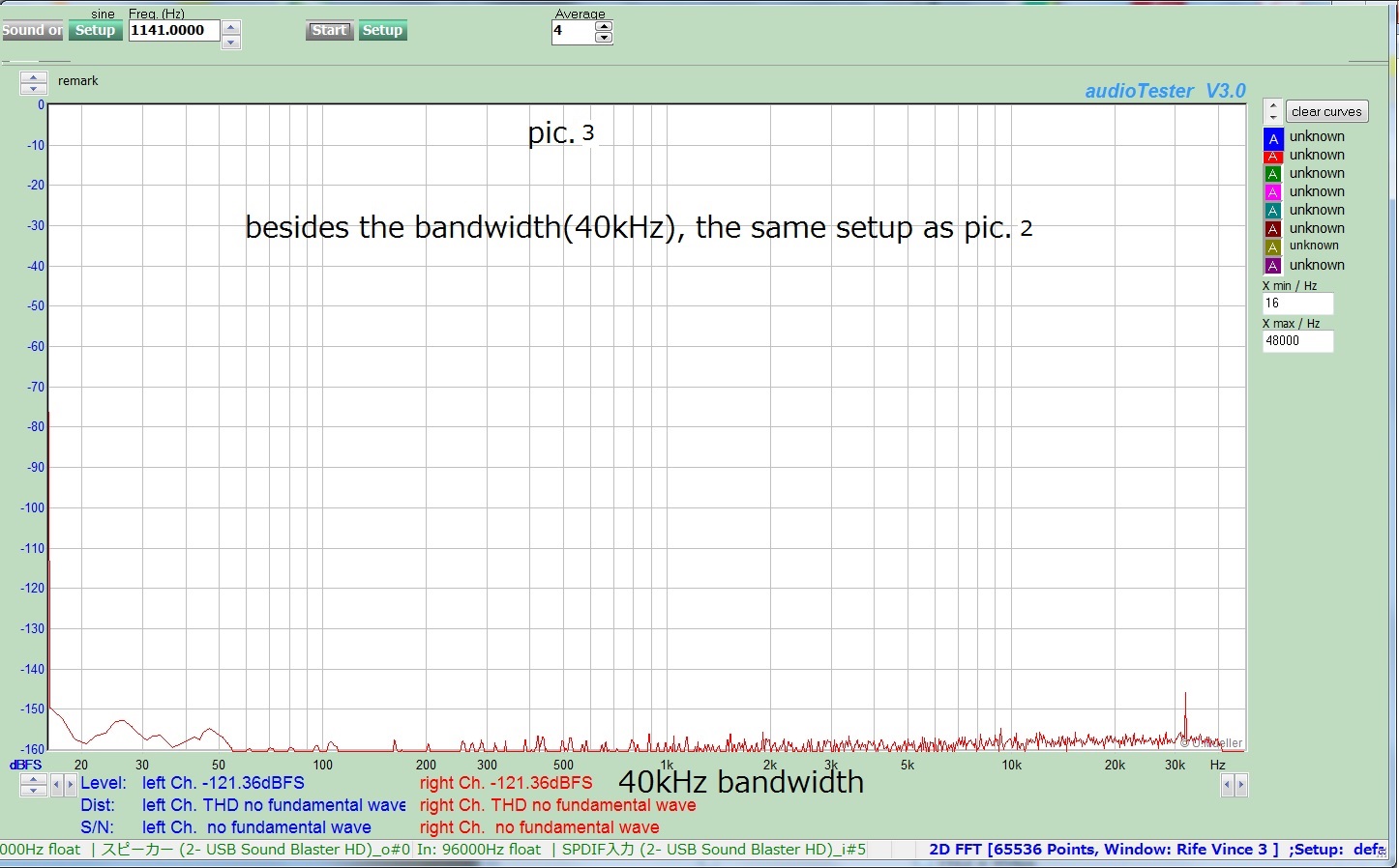

Thanks a lot for your pic. It's exciting to me. My impression is that you have fewer components than I imagined. It's probably because of different DAC topology you employ. Do you use RTZ? I also tried RTZ but failed. Analog FIR can't coexist with RTZ. My conclusion is NRZ is more friendly with analog FIR than RTZ at least. Next PCB I'm planning has at least 32taps, which results in many discrete components. One tap consists of three transistors and five registers. 32taps analog FIR equals to 96transistors and 160registers with 4mAx32=128mA !!! :eek:I must investigate the exact reason for the oscillation before going to next step.
BTW, I employed a differential amplifier to isolate digital noise. It was a successful result more than I expected. If I force output drivers for transistors to stay H or L, which is defined as "static zero," residual noise of DAC includes those of analog circuit but has no DSM related noise. Pic. 1(-121.3dBFS) is the best scenario I could have in my DAC topology while I actually have(dynamic zero) is -116.3dBFS. In other words, I have still 5dB headroom for improvement.
Furthermore, you must adjust the values because the residual noise of my ADC degrades the values. From pic.2, real performance in static zero is probably -124dBFS and dynamic zero is -117dBFS. So, the headroom is 7dB. It's astonishing to me. I would say digital isolation was luckily ideal.

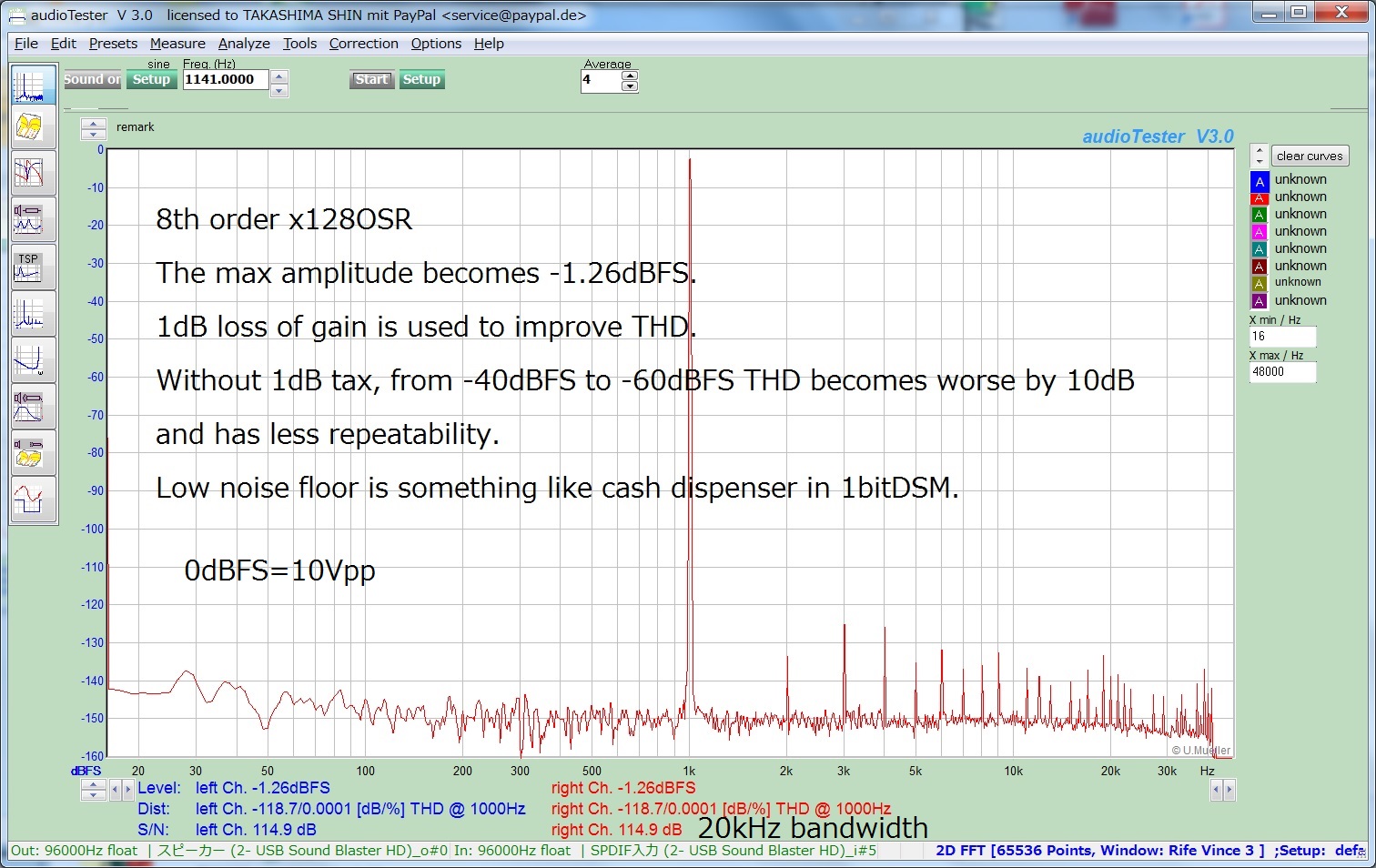

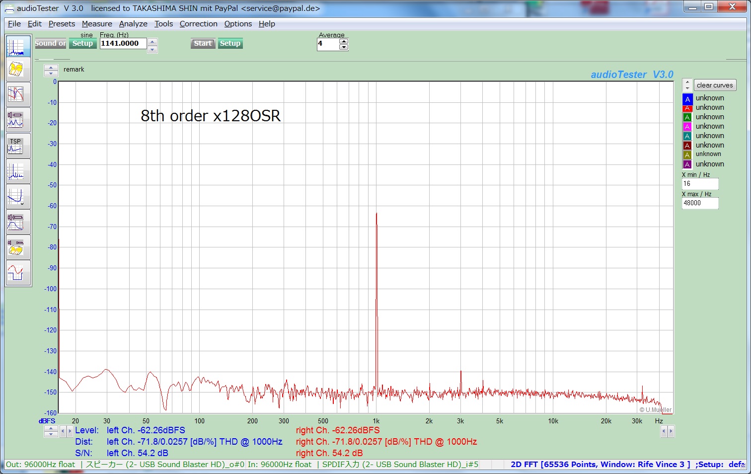

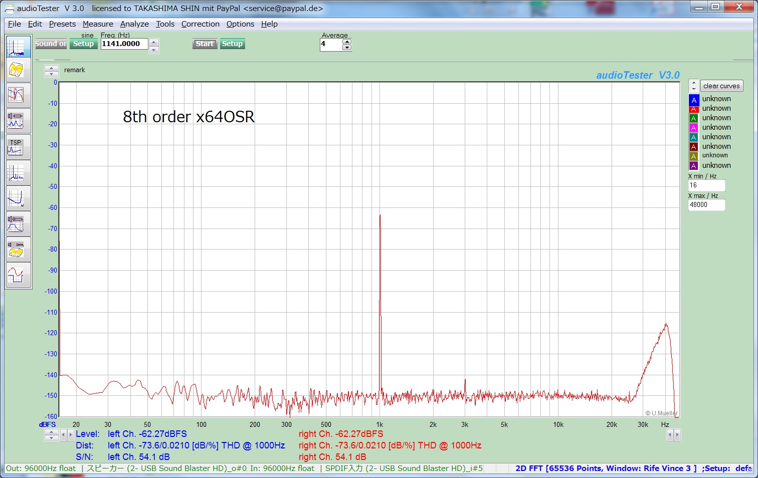

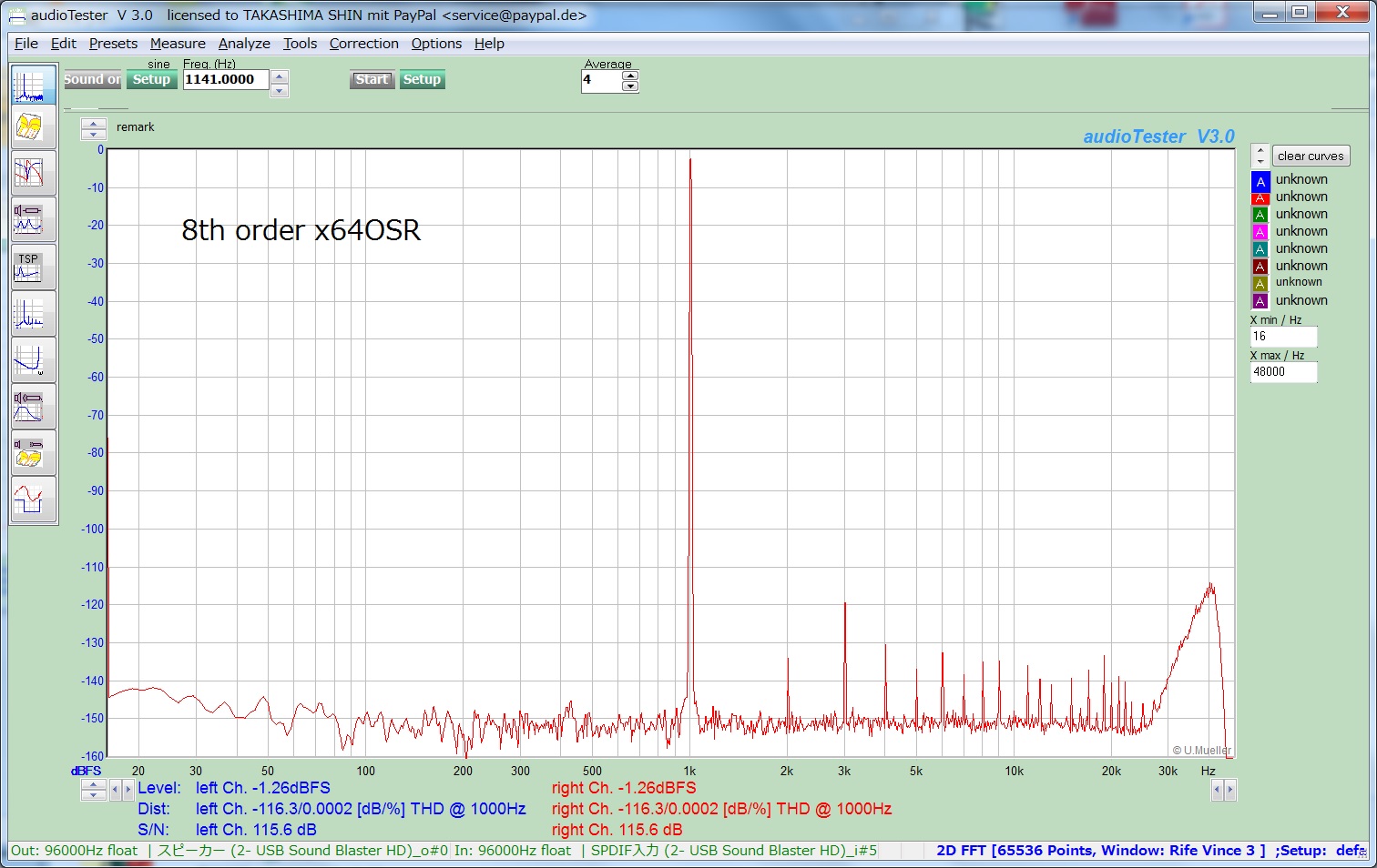

Joined 2017

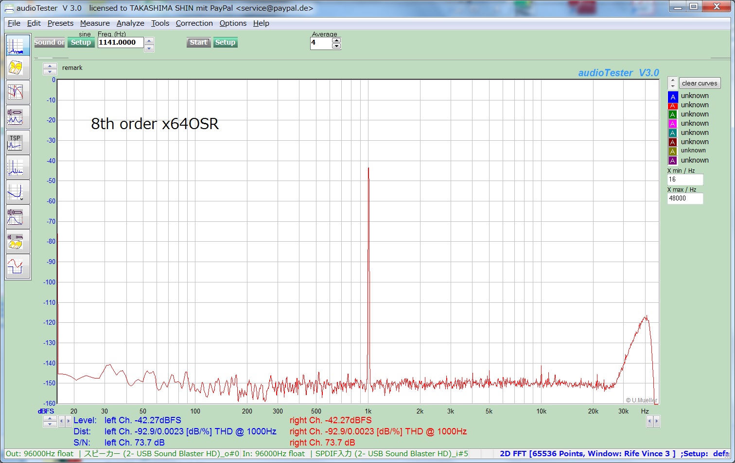

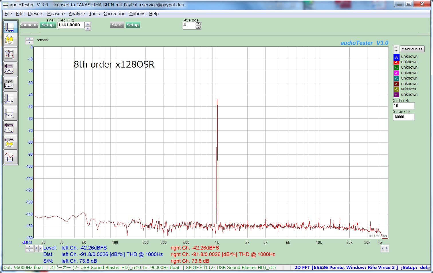

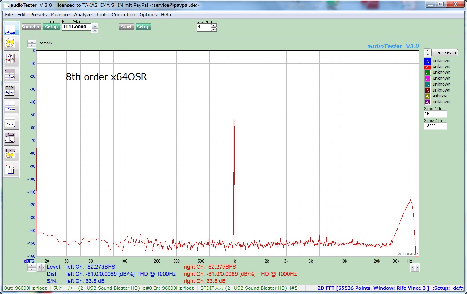

I did measurement of THD from -40dBFS to -60dBFS. I know that such amplitude in 1bitDSM has relatively poor numbers than 0dBFS. It locates at the 2nd or 3rd position in my to-do list, not the 1st one because the problem exists in the digital domain, which isn't fatal to revise a PCB. The top priority is an analog problem like oscillation, which must be fixed before designing a new PCB.
Attached pics are after temporary compensation. 1dB loss of the max gain luckily got a good result with moderate repeatability. Pic.1 to pic.4 is 128OSR. Pic.5 to pic.8 is 64OSR.

Joined 2017
Btw, with your fpga: isn't it really easy to program some form of rtz encoding as well as have the pll generate the necessary clocks for that?
DSM topology (mine is 8th order CRFB with local feedback)in the digital domain and analog FIR in the analog domain must shake hands tightly for better performance. From such a viewpoint, I don't use external modulators like Rpi or windows PC. Pinpoint tweaking between them is mandatory. PC base modulators are far off from actual 1bitDAC array(analog FIR in my case). FPGA is the glue and absorber between them.
I can't say NRZ encoding or clock generation is easy or not. It strongly depends on your analog section. I'm an old school person who still uses only schematic entry for FPGA design. If you use high-level synthesis, some primitive functions may not be accessible. That's why easiness is relevant to your design circumstance.
Dynamic range is good and thd is excellent as well so no worries. I have seen worse with nrz;-)
