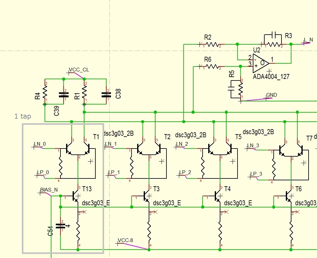

Is your oscillation problem maybe partly because all collectors see eachother directly and could this be made less an issue when you'd lead all output currents to the opamp by a series resistor?
Kind of defeats the purpose, using resistors, but low ohmic (10 tot 50) might be enough already.

I can't understand what you mean. Can I have a pic that clarifies your intention?
R1 and R4 serve as common resistors for all transistor collectors, so all taps/transistor collectors share the same R1 and R4.
By a (one) tap you mean a balanced pair of npn transistors with their current source, right?
So right now all positive phase transistors (collectors) all share R1, the negative phase (collectors) all share R4, so all collectors of similar phase are connected to eachother.
I can imagine this causing problems.
It might get less problematic when the collectors won't be connected so directly together. A way of doing this is by having 1 transistor having their own, unique collector resistor. So 1 phase/collector, 1 resistor.
This way you get as many collector resistors as there are collectors.
Getting that voltage out could, for instance, be done by using a serial resistor from the collector to the output. Add as many taps with this structure as you want to that same output point (all with a serial resistor).
Sorry, I'm not at home so can't draw something decent, if it's still not clear I can draw something tomorrow evening (in about 24 hours)
