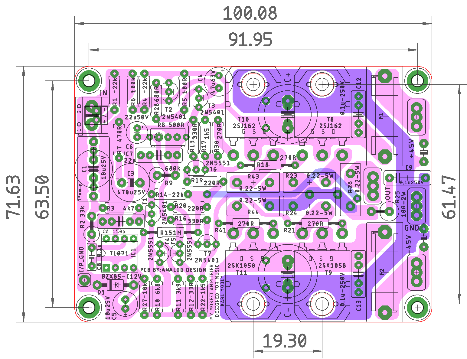

I cant remember if I posted them, here they are.
regards
Prasi

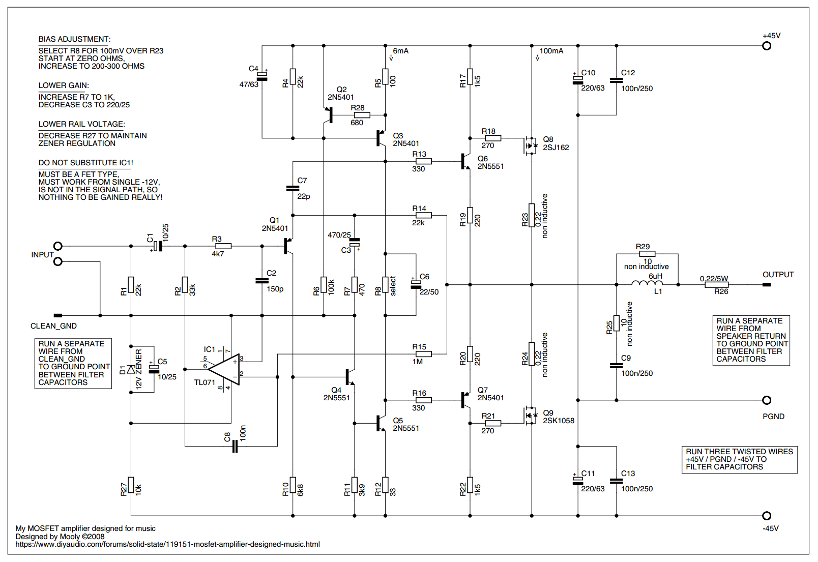

Hi Mooly,
I just noticed a little thing in your schematic on post #1. If I'm not mistaken, the pin numbering for the MOSFETs is wrong. Gate is correctly numbered with 1, but Drain and Source are numbered reverse from what the datasheets mention (Source should be pin 2, not 3, and Drain be pin 3, not 2). Seems like nobody stumbled upon that yet, but while I created some Devices for the EAGLE layout editor I had to double-check to get it right.
Anyhow, here's the schematic so far. I tried to make it a little 'neat' and easily printable as a PDF.
The layout will follow, but I have not yet decided on whether it will be something along the line of Alex's work of art, or more like a tidy stuffing guide for a perfboard. Maybe I'll do both...
Hello Mooly
greetings i want to make your mosfet amplifier is this layout
from post#904 correct so i can proceed
warm regards
ANDREW🙂
Yes correct.
Hi Mooly,
The reason is (and its not an excuse 😉)... is that when I posted all those years back that drawing was one of my first attempts at using a PC to do such things (it looks like I used Diptrace for that one) and it was just an attempt to get something neater than the hand drawn original. I must have used the standard library images for the common IRF types.
I also never imagined at the time there would be so much interest over the years and so post #1 is unrecognizable now as to how it was way back then, when looking at the dates I was actually a newbie here 😉

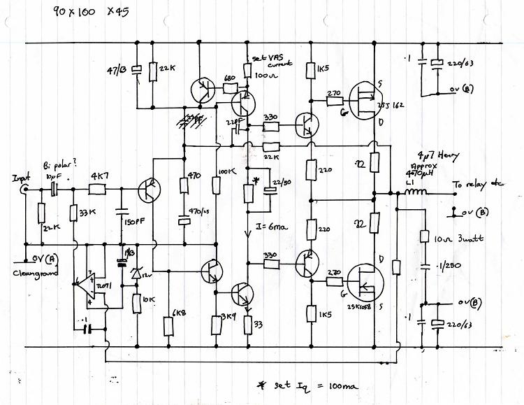

This is the original 🙂
Not too bad actually
