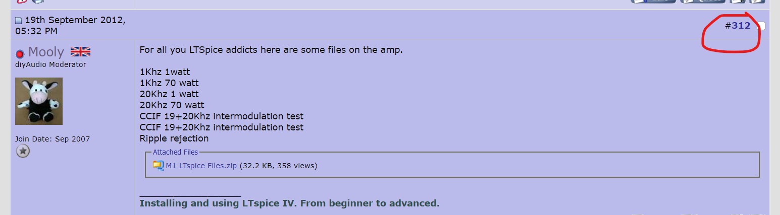

Hello Karl,
where to find the LT SPICE file for this amp. Post #316, as sown in the overview isn't correct.
BR
Günni
BR
Günni
for me, when click on the link, i end in page 16, starting with post#151. Nevertheless i finally got it for debugging my pcb's
thanks
Günni
