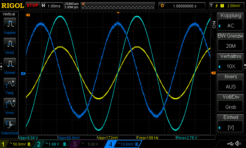

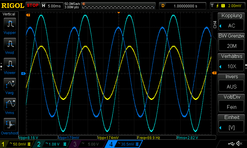

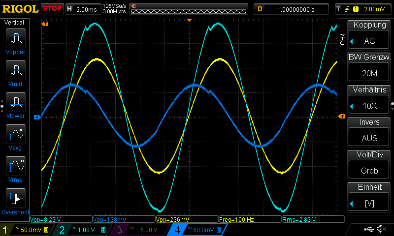

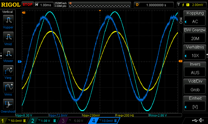

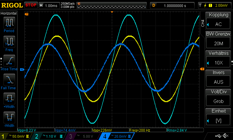

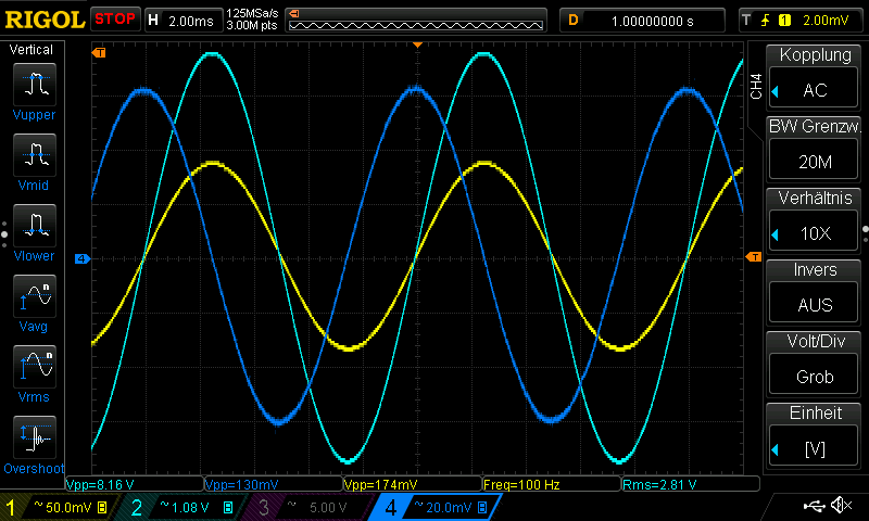

last check before l channel goes back into the amp.

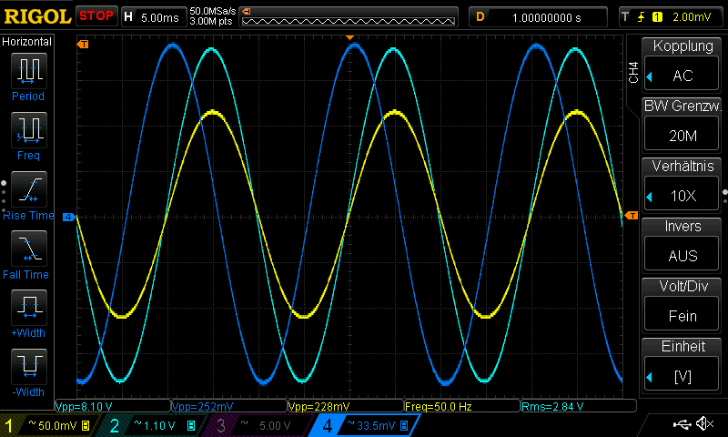

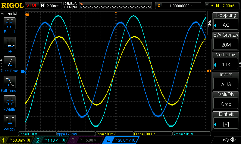

setup is 2,86Vrms without load and check the pin6 pov output to be sure everything is fine.
from 200Hz down
yellow ch1 is input
light blue ch2 output scope probe directly at the amp out
drak blue ch4 is the pin6 opv output
looks okay -its more then preamp-Lasse- suggested -

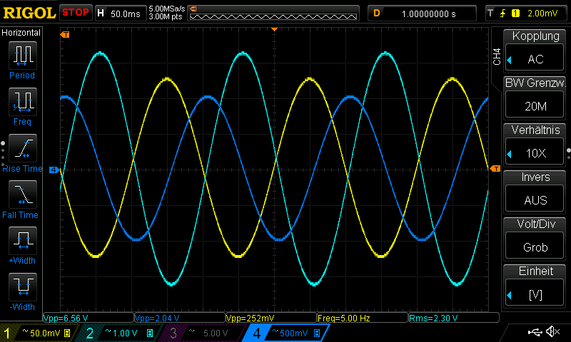

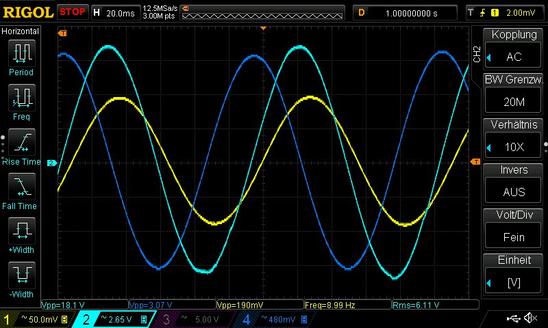

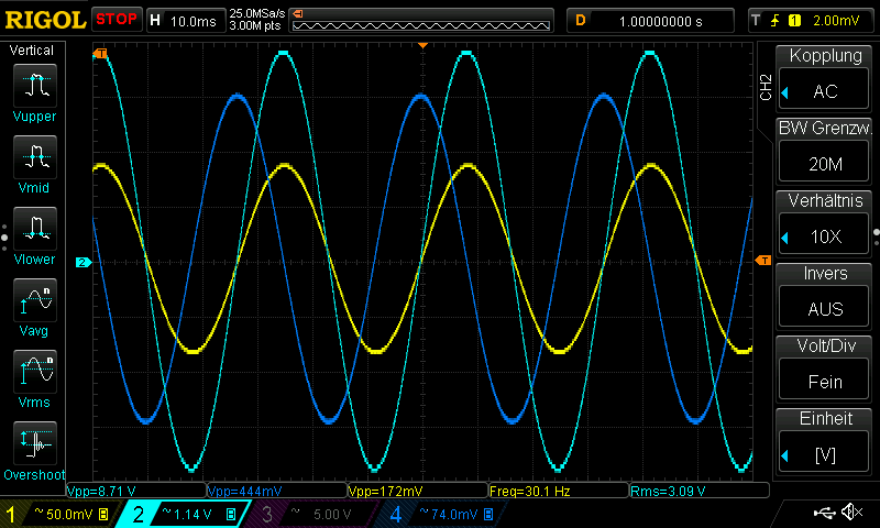

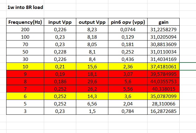

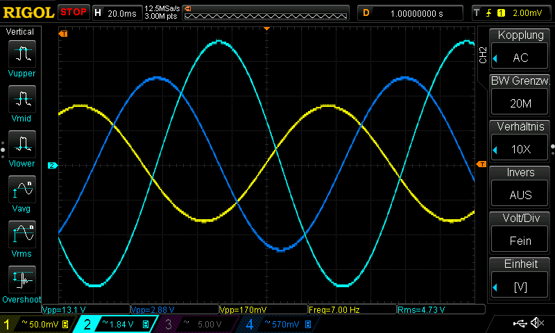

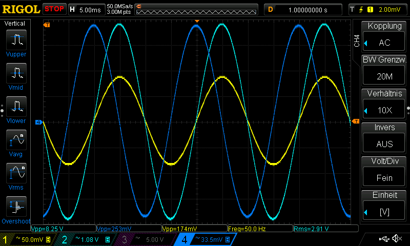

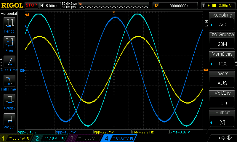

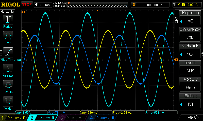

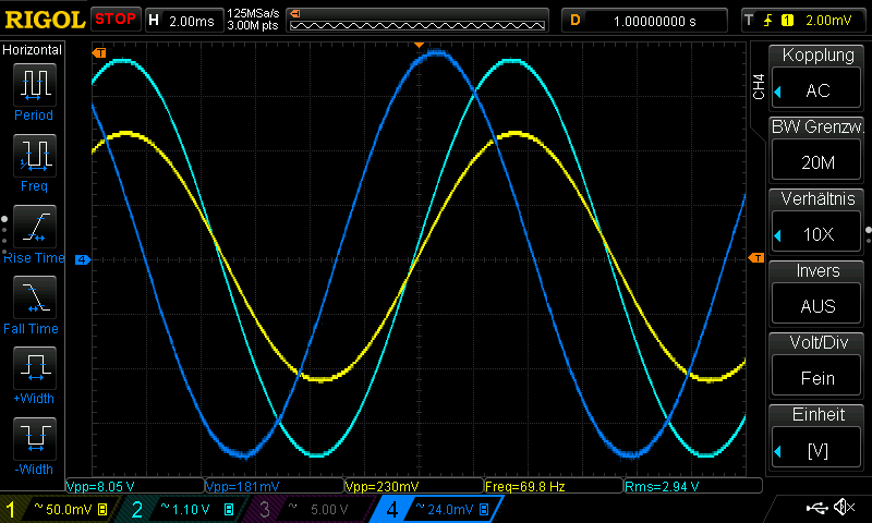

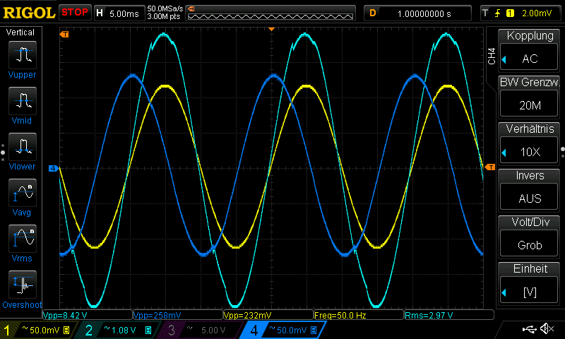

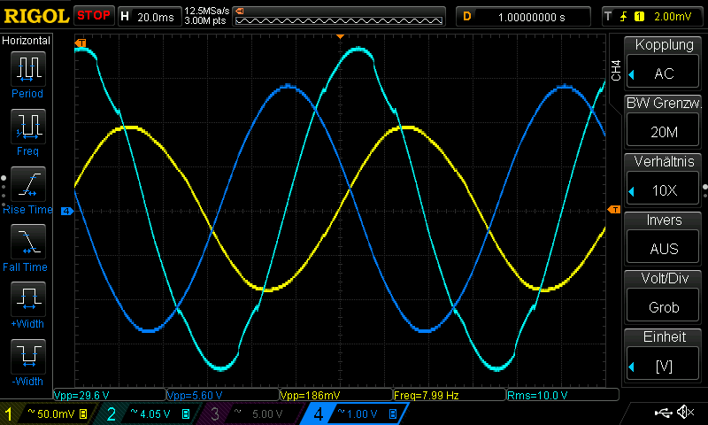

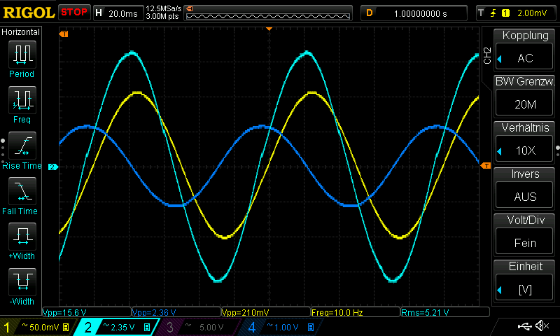

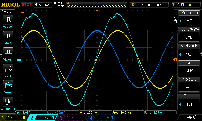

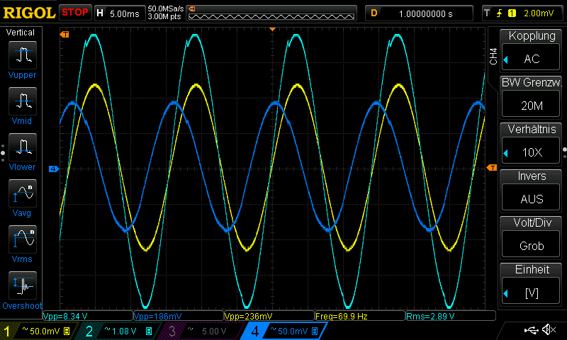

now it is with 8R load after the coil
setup is 2,86Vrms with load and check the pin6 pov output
from 200Hz down
i got a spike!
at lower frequency it doesn help to set the current up of my psu ..its toggling around...
yellow ch1 is input
okay????
from 200Hz down
i got a spike!
yellow ch1 is input
okay????

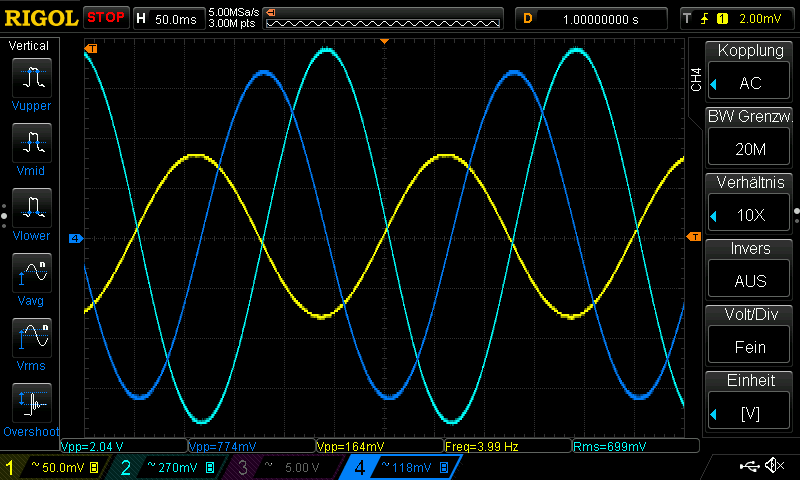

See if the glitch appears on the rails. If the PSU is doing strange things then that will reflect in the behaviour of the amp.
The output of the amp and the output of the opamp should be clean under sinewave testing under all conditions and loading. It sounds like you have either PSU issue or the grounding is incorrectly configured.
psu is clean..rigol 832..or not?

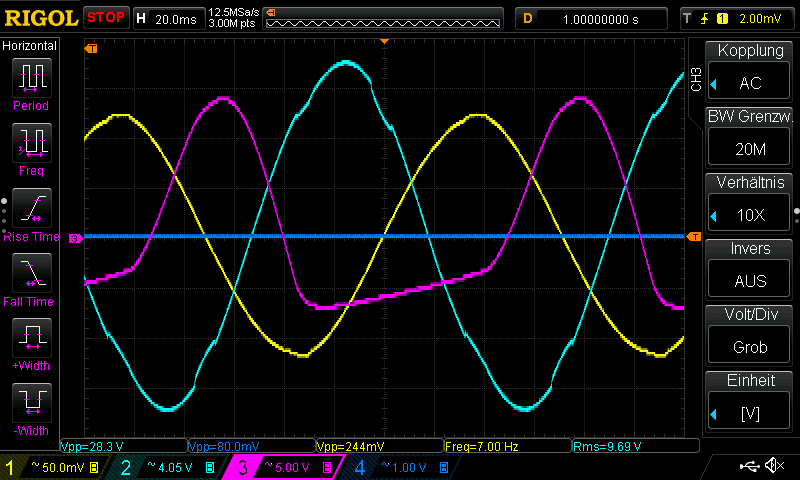

yes its getting better after i changed/repair completely the GND cables at my psu.

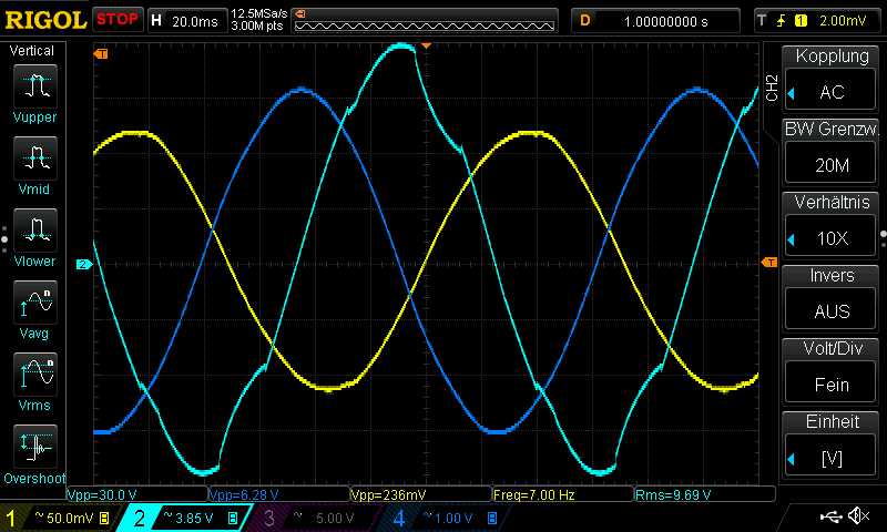

but stil between 10-7Hz strange

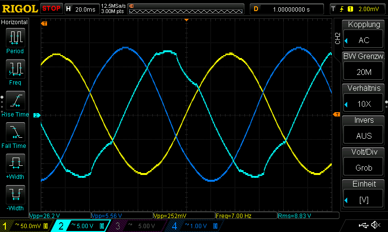

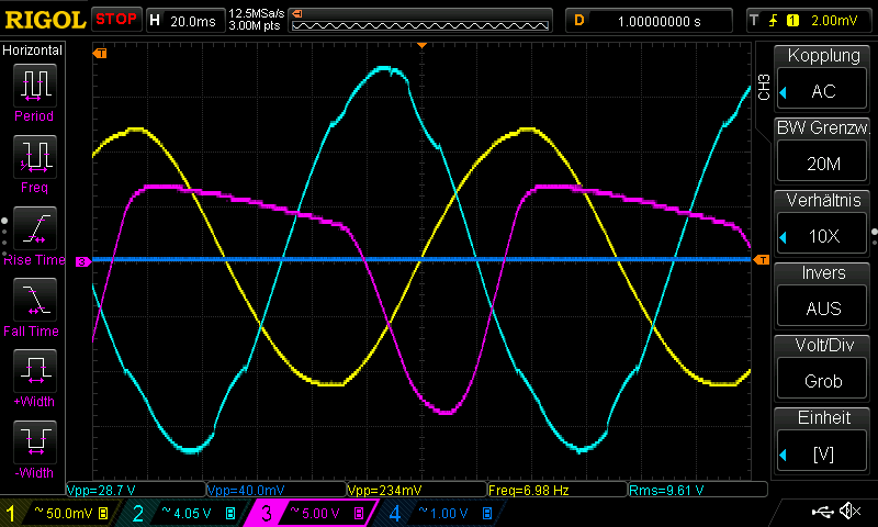

at 7Hz i use the ch3 pink to look at the negatie rail and positive rail.
i guess that the PSU is struggling with this load...still no constant voltage and current is up to 1A.
3,5,6Hz is gone
3,5,6Hz is gone

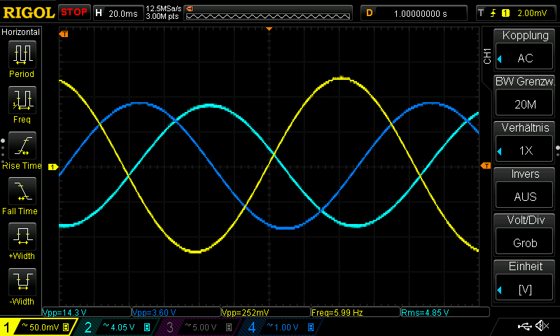

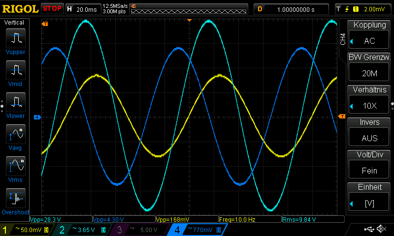

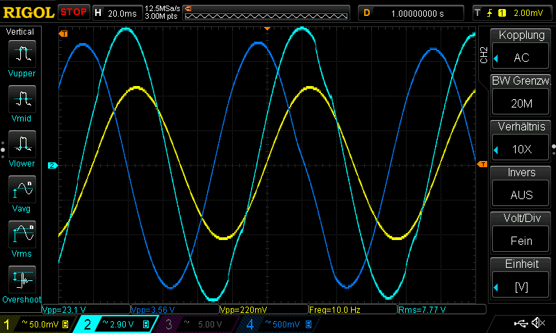

8R load_1W_7Hz_neg rail_input ch1_output ch2_pin6opv ch4_2.png51.9 KB · Views: 46
8R load_1W_7Hz_pos rail_input ch1_output ch2_pin6opv ch4_2.png51.1 KB · Views: 43
The PSU rail should clean. It looks like the supply is perhaps going into some current limit situation. That isn't possible to easily diagnose at a distance beyond saying the PSU should not do that.at 7Hz i use the ch3 pink to look at the negatie rail and positive rail.
What PSU are you using?
Hi mooly
thx for your support.
yes it stoogling but just at this frequencies....
it is a Rigol DP832 not the A version. channel 1+2 can handle 32V and 3A. channel 3 5V/3A.

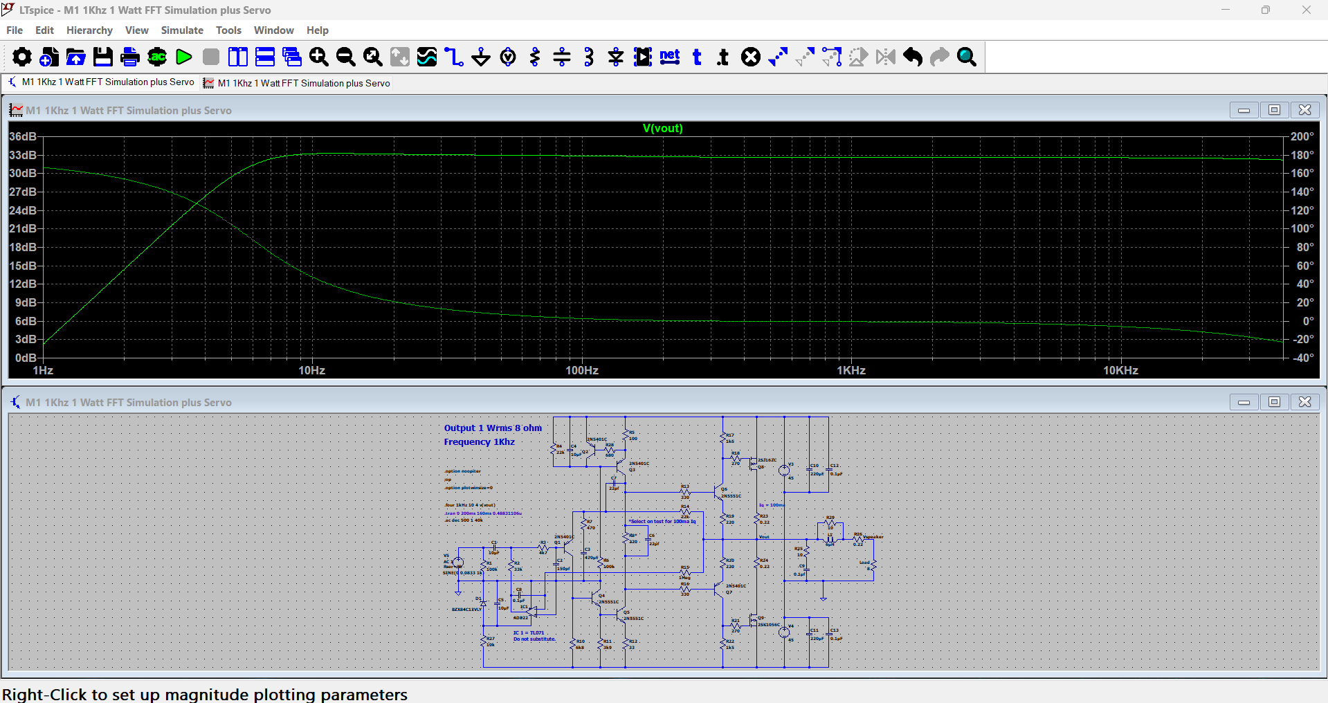

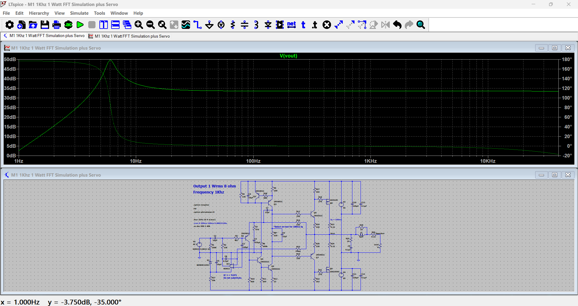

The rise in gain below around 2Hz is something that has been commented on earlier in thread and its a normal function of the opamp R/C time constants interacting with the amp input. If the source impedance is a few k then the issue is much less pronounced as shown here.
And with 3k source impedance:
Your measurements agree pretty well with the simulation, that build is working fine!
No need to get hung up on those low-frequency measurements, as you should not encounter anything serious below 20Hz anyway. Otherwise you may have a look at the modifications that I did on my build, to take away some of the governance from the servo and tame that LF-peak.
The observed distortions are most probably caused by the PSU, like Mooly already suggested. Hook up a proper transformer and test again.
