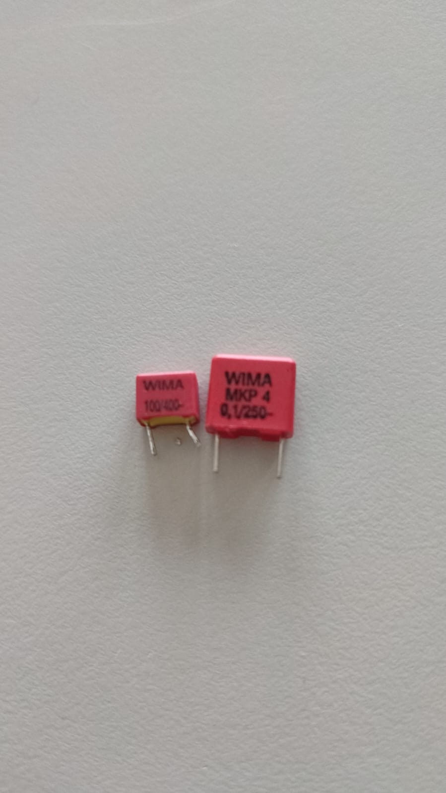

left wrong...100 --> 10*10^0= 1nF
right correct cap
sorry guys...i am so sorry for that ...i feel shame..

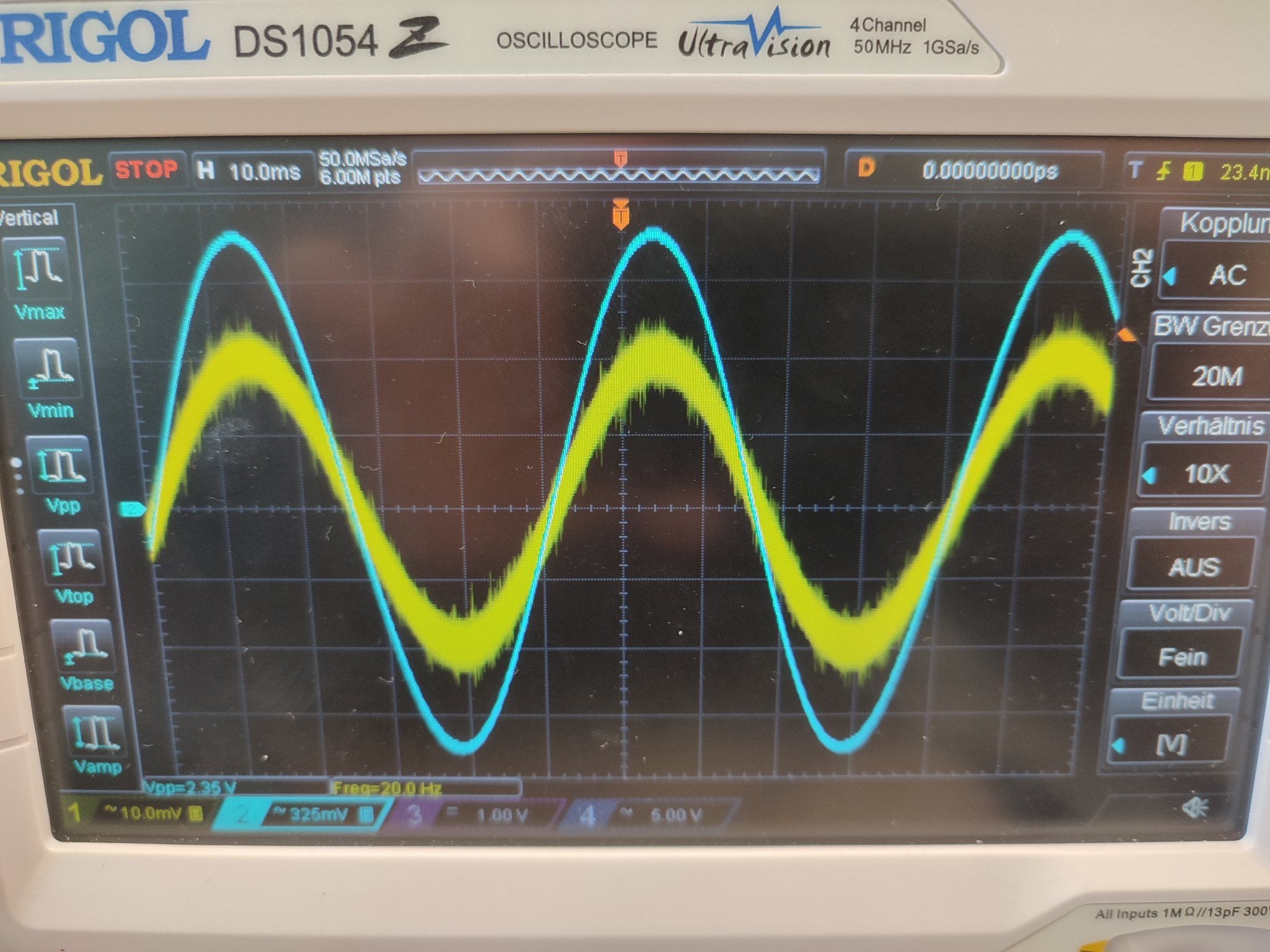

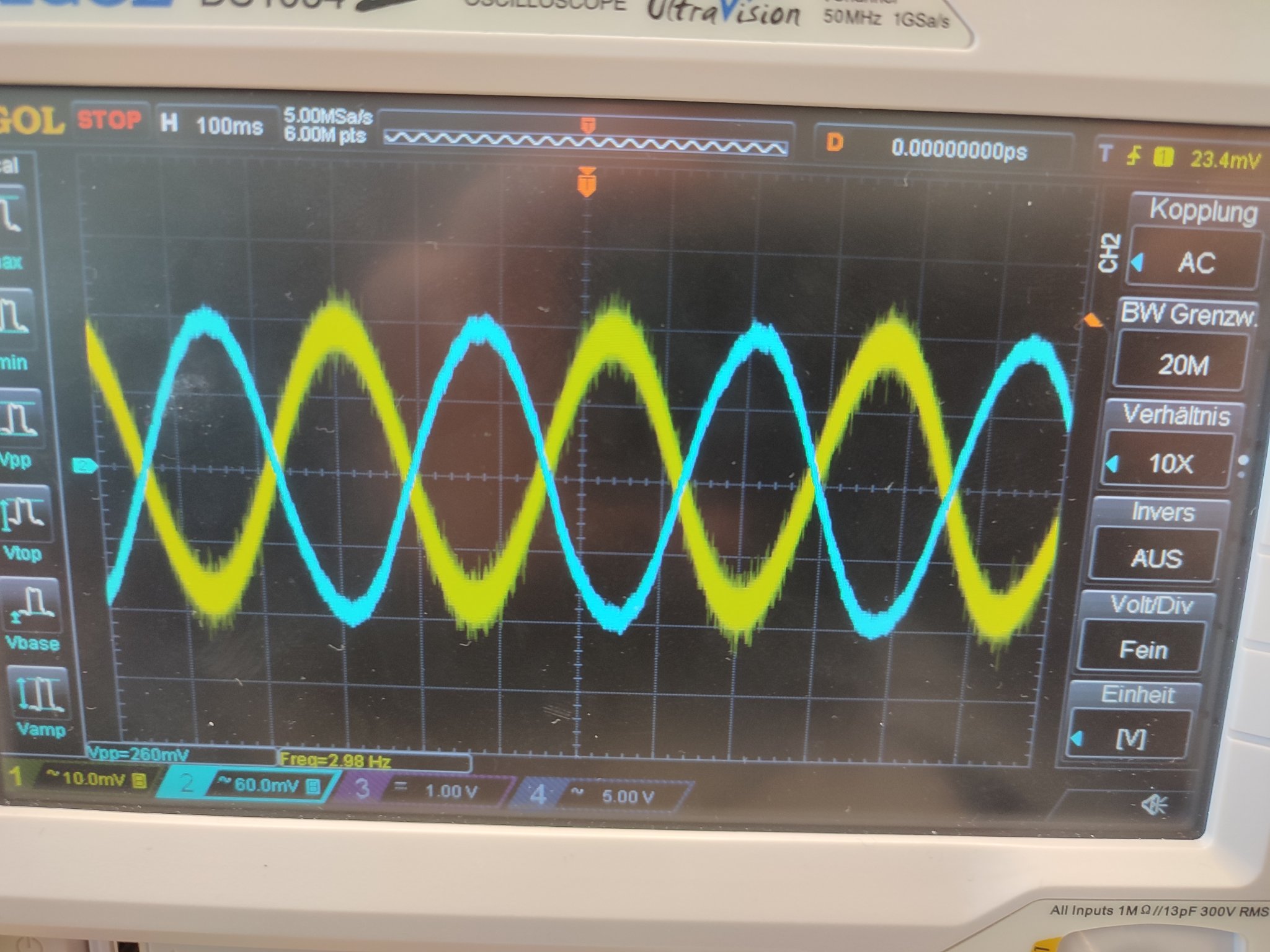

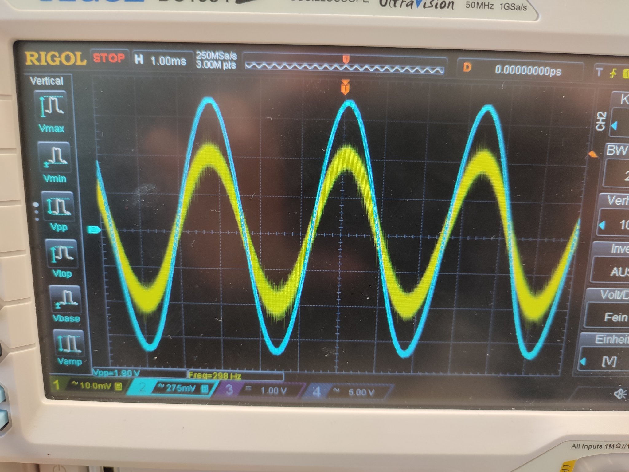

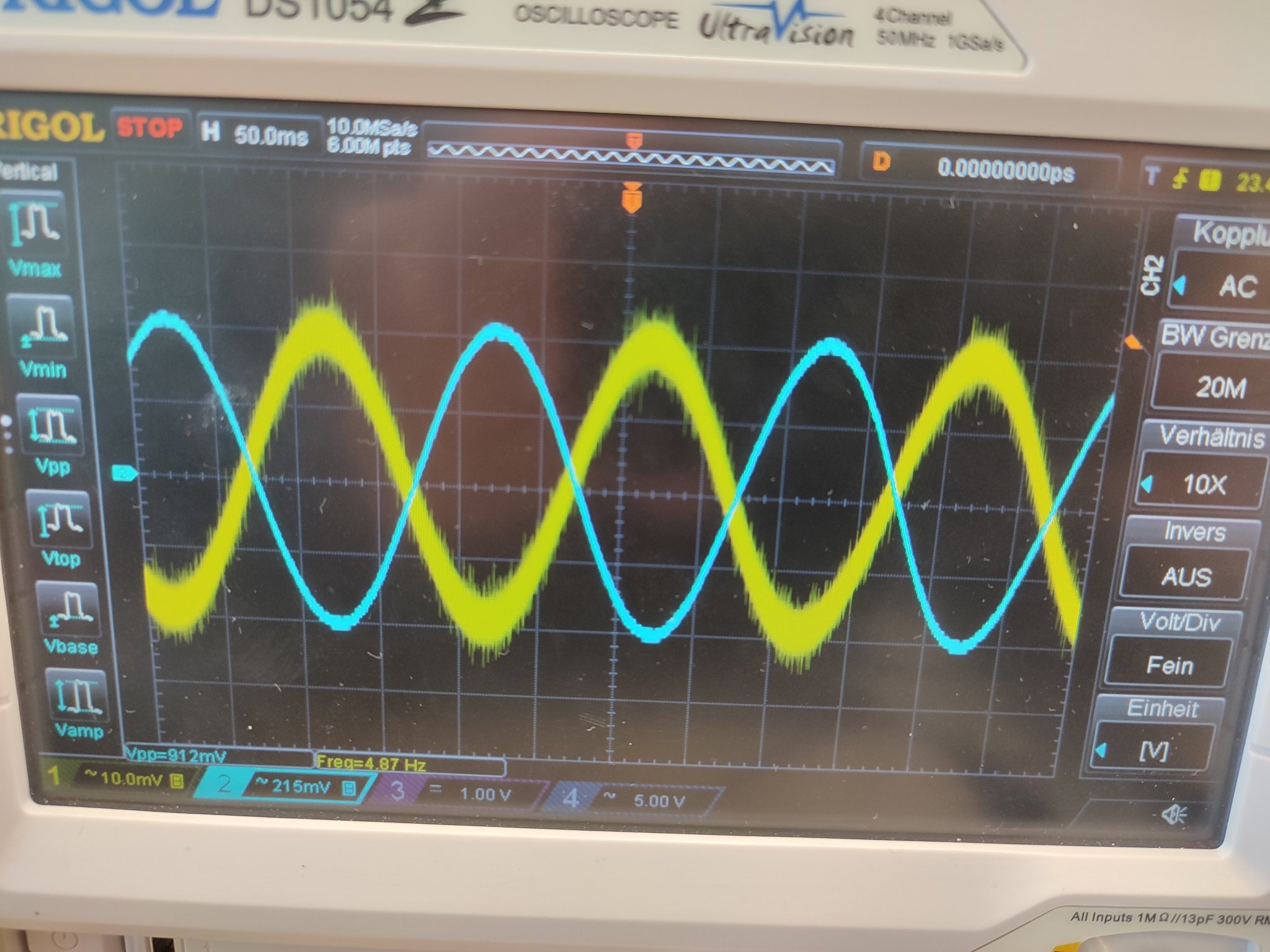

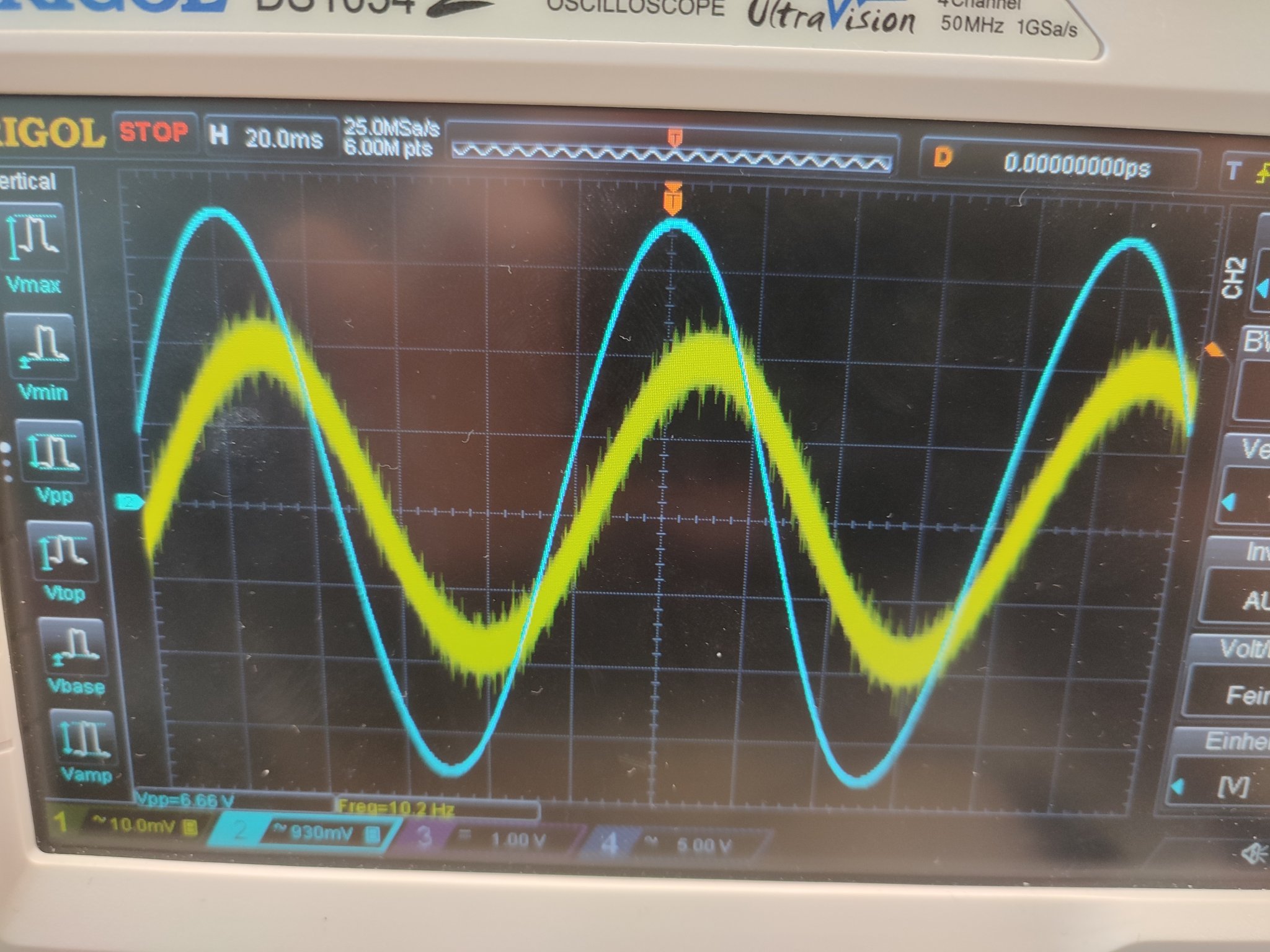

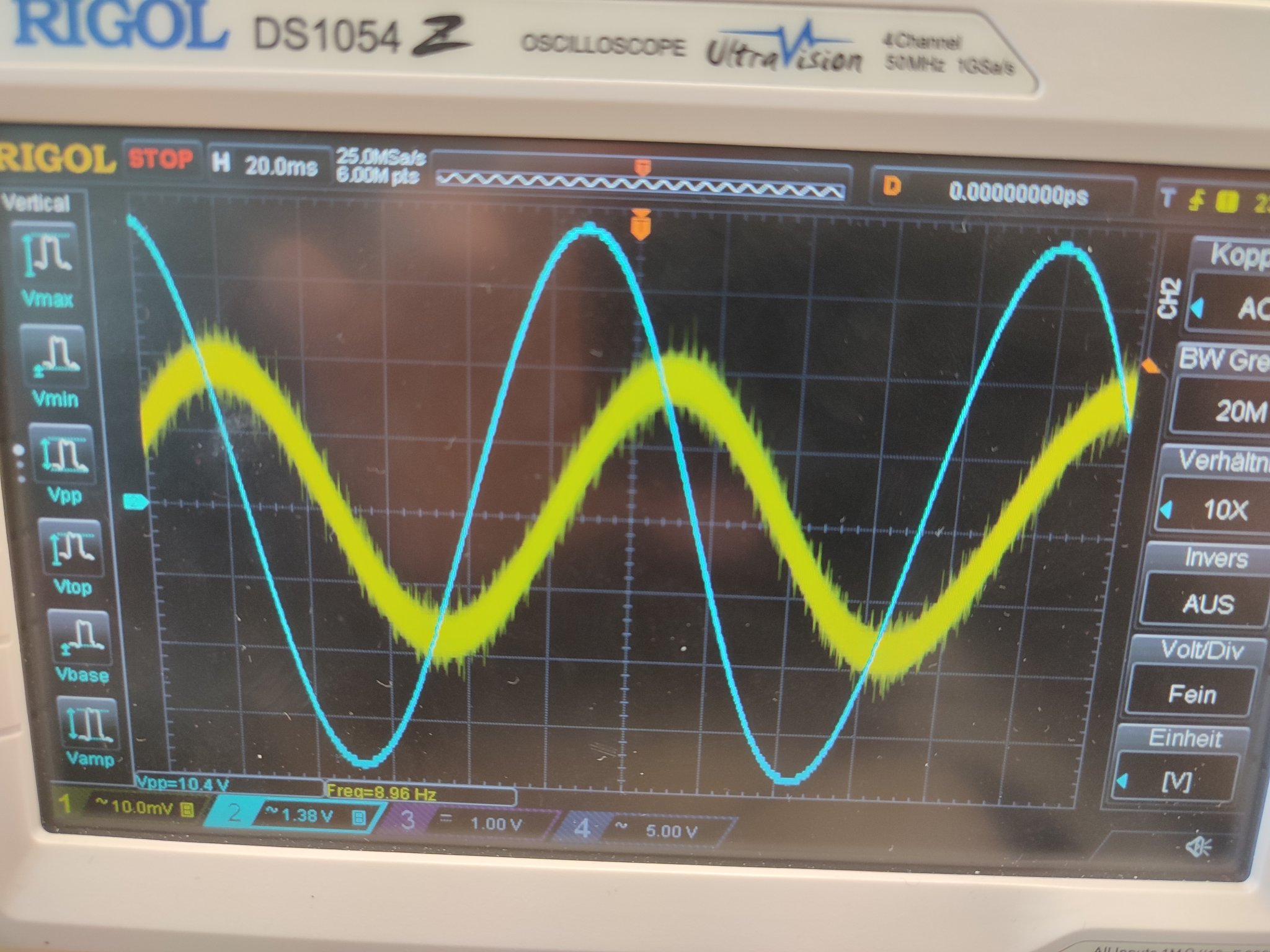

here are the measurements with the correct 0,1µF cap
please comment these.
thx

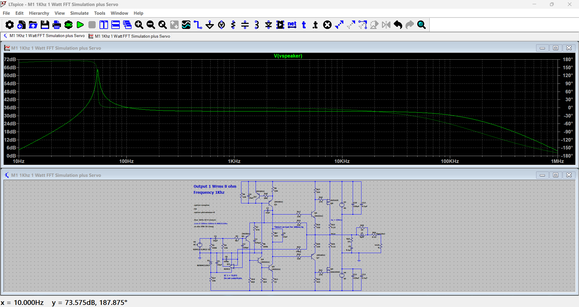

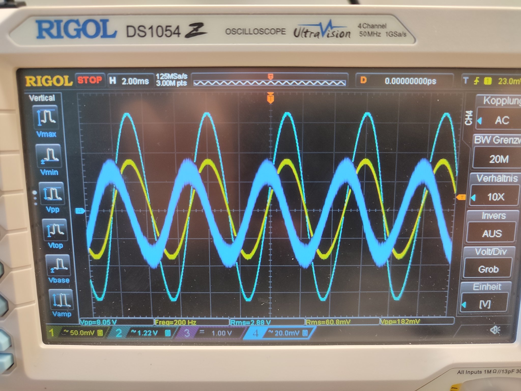

I'm sure they will be fine. Its hard to decipher from pictures.
If you want to compare to the simulation then set the output for 4 volts peak (8 volt peak to peak) at 200 Hz. The output of the opamp should be around 15 millivolts peak (30 millivolts peak to peak).
It doesn't need a load for that.
Reactions: chermann

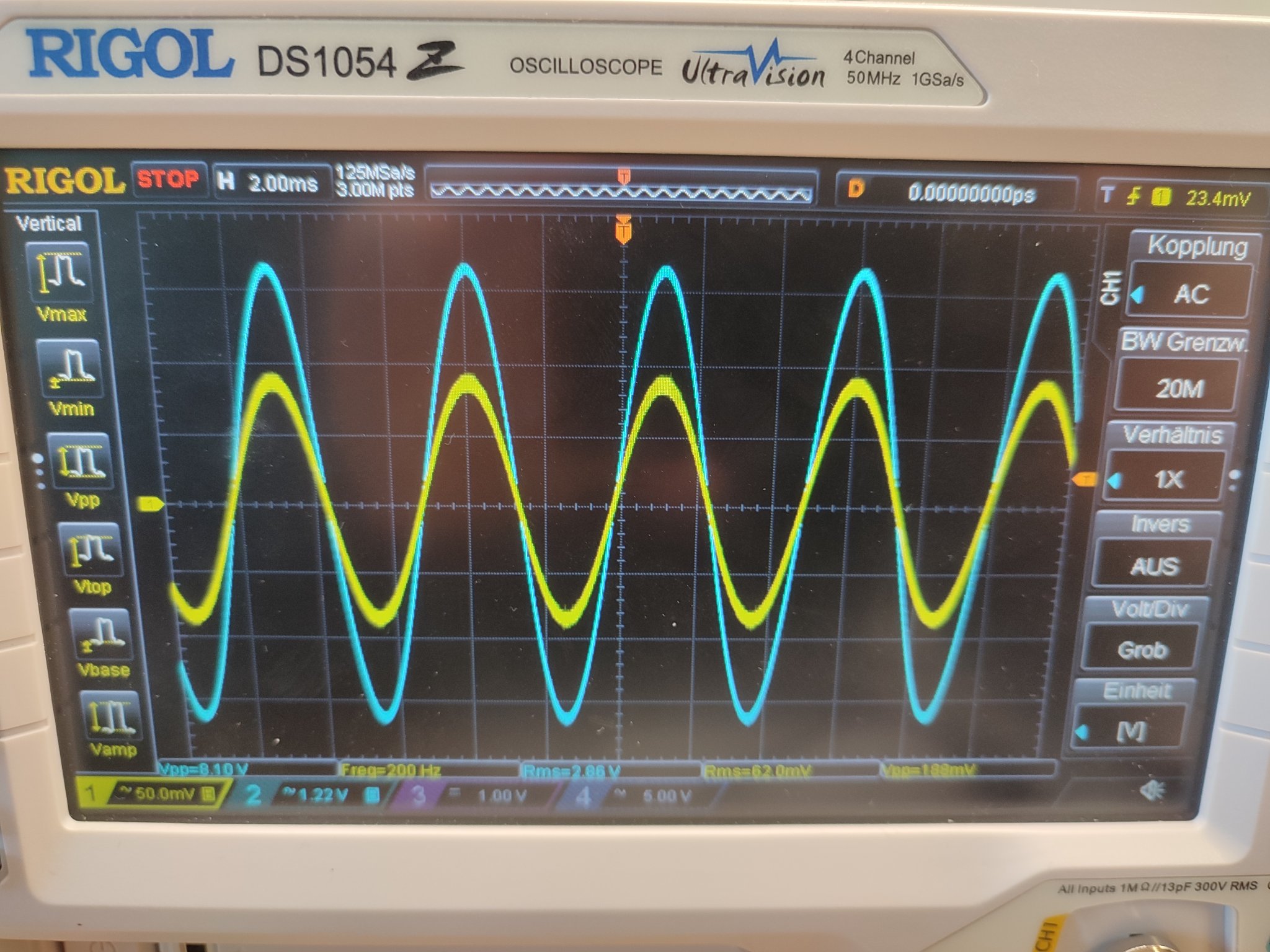

not okay.
no load
yelow input
light blue ouput (no coil)
dark blue is the PIN 6 looks not okay.
it is more then 30mVpp
(the light in my "office" are horrible...)
