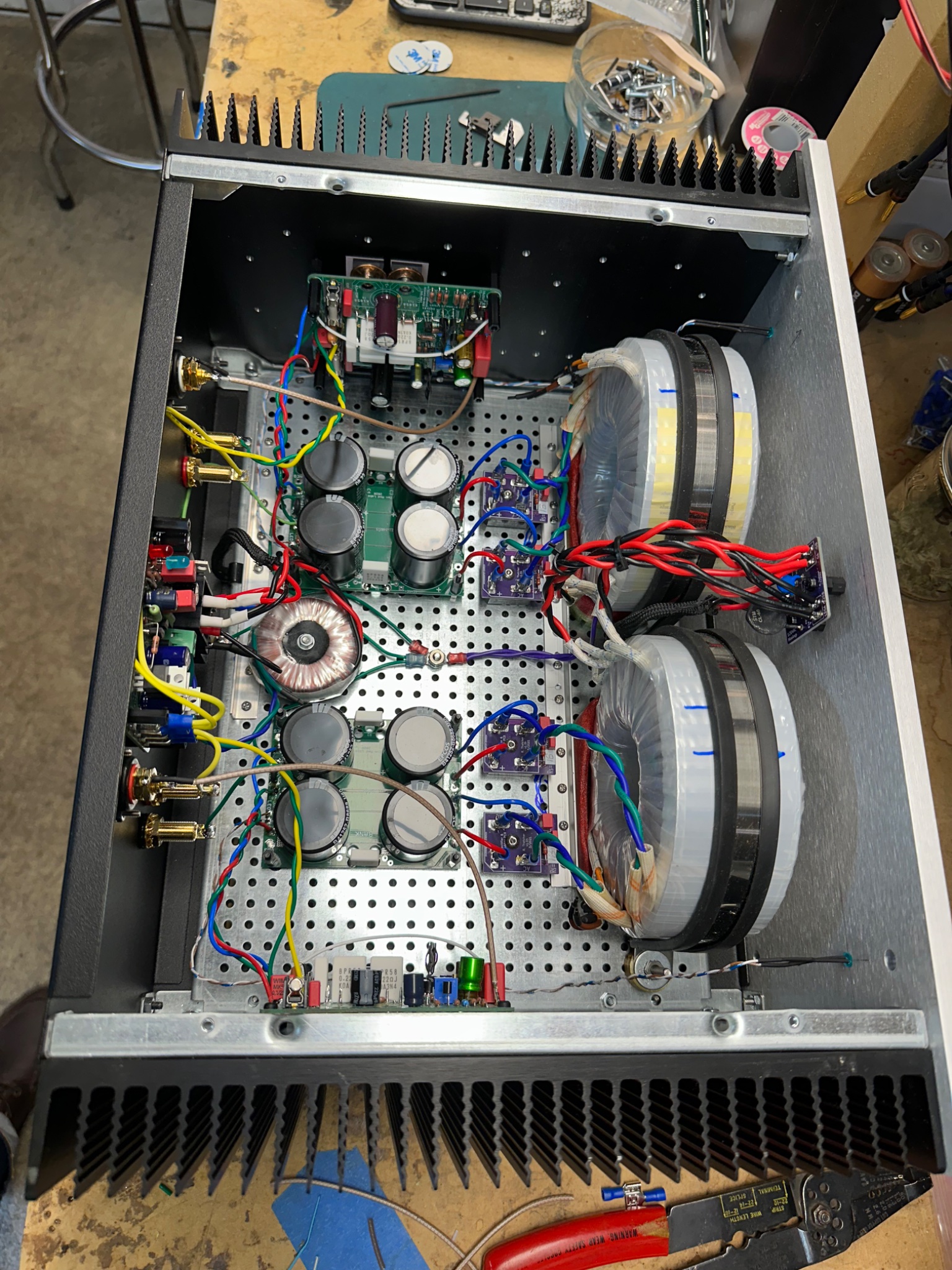

Closing in on time to apply power…:xfingers:
Thank you Mr Mooly for this wonderful sounding amplifier….and thank you Mr Prasi for the excellent PCB’s!
I tried to blow it up last night but I failed…(my bad) thank goodness…very rugged design indeed.
Biased right up after correct drain to drain connection…..
Getting less than 2mv dc on output…takes a few to settle but no issues. Will experiment with output coil/resistor but without sounds really sweet.

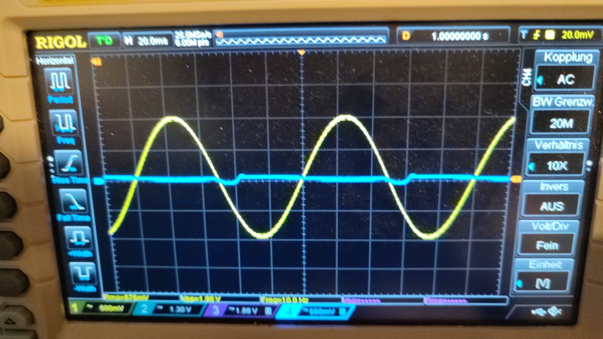

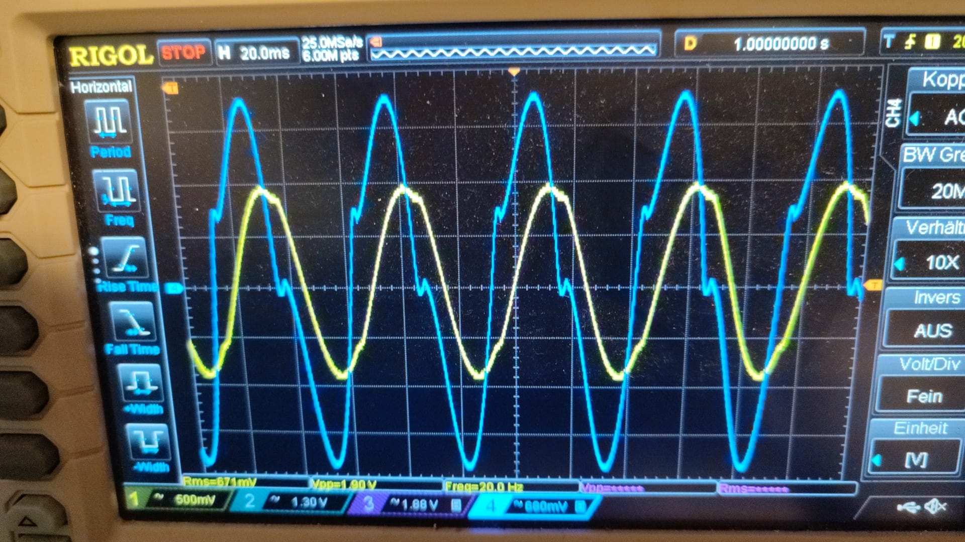

i checked with scope and there is some frequency dependency! - look at the pics
yellow is the input and if i change the frequency lower 1kHz my input signal of the FG will change?!
20 hz is visible and horrible
at 10hz the amp is diong nothing at the output -yellow input is clear
it looks like a frequency dependend behaviour with load the source hard at lower frequencies?!?!
over 2kHz the sine is perfect and this goes up to 130kHz without problems

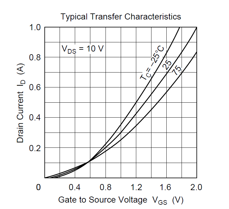

The 1k5''s should have around 0.4 volts across them with no signal. The 4 volts you measure now would put the FET's into very hard conduction and they would be very hot and the bias current very high. This graph stops at 2 volts G/S voltage and is plotted at just 10 volts 'supply' across the device.
That possibly points to something amiss in the basic wiring and grounding. Given it was all working normally before (last month) and now there are problems after transporting it again points to something intermittent or something not insulated/isolated and touching something it shouldn't.
