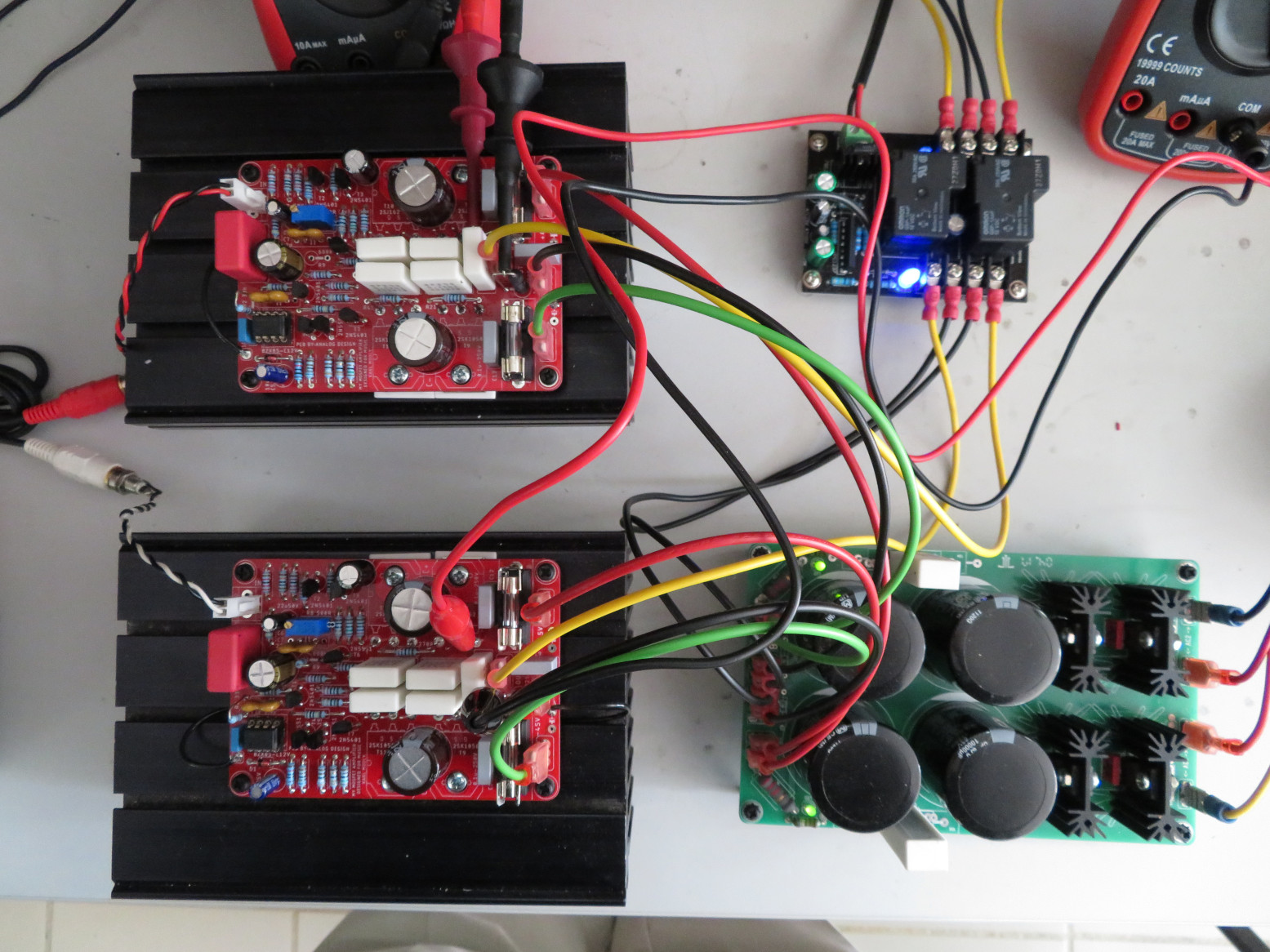

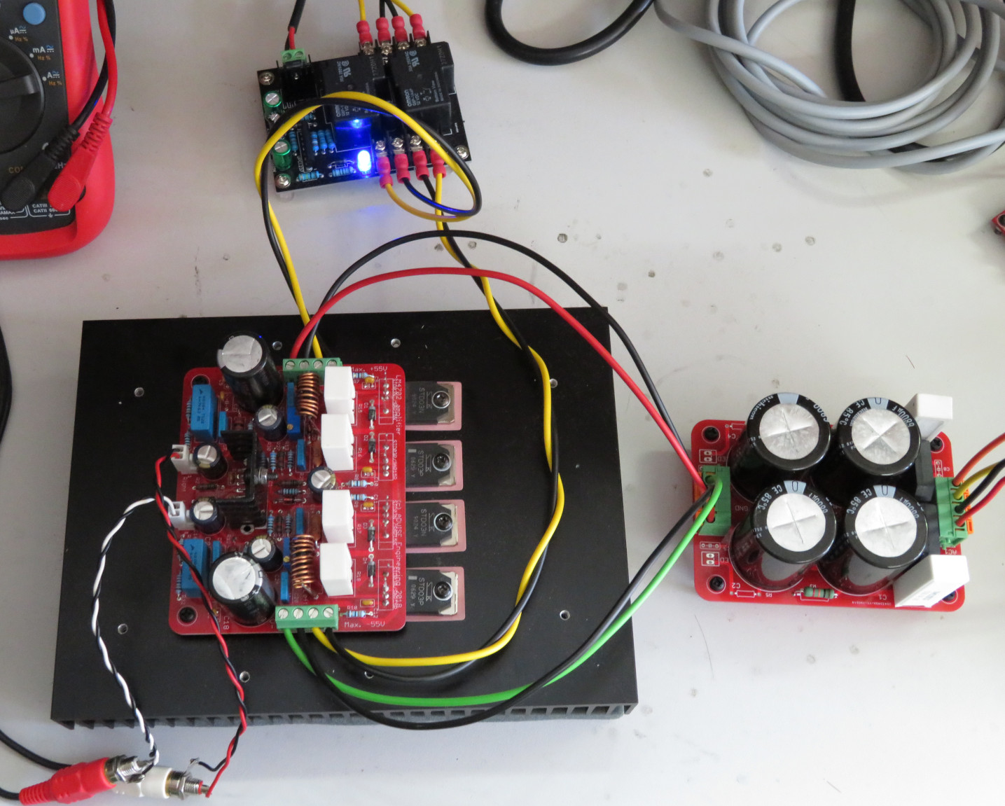

My MOSFET amplifier designed for music
After several test made with some friends with the amplifier using a single pair on one channel we didn't find a difference between both channels :confused:
For a simple listening at home on 8 ohms speaker I would recommend to use only a single pair for the output, the dual pair could be useful if you are using 4 ohms speaker and play music at very high level !
To finish my amplifier I added the second pair anyway to have a symmetric design... It is now playing since two weeks with 42 V DC power supply and did not become too hot, except for the driver T7, may be it could have been interesting to use a 2SA1381 for the VAS like in the Quasi ?
I am very impressed by the quality of these two small and simple amplifiers and I want to thanks Mooly and Ranchu32 for their nice design ;) I am currently building the very successful RMI-FC100 from Roender, thank to Harry (Cambe) who send me the PCB, and It is much more complicated, if it sound better that will be terrible, I may need to buy new speakers :D
After that, and the hybrid that I am building with the help of Hugh, I will be going back to a tube amplifier with the Quad KT120 that I have waiting for one year already :(
Rgds,
Marc

:up: nice work.
Really pleased you have got these up and running and are liking the results.

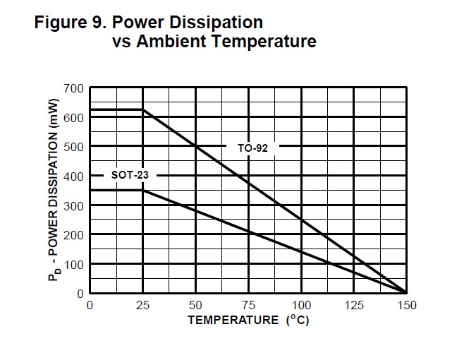

The driver transistor and its PNP current source do get hot but in practice are only dissipating around 300mw each in quiescent state and so should be well within maximum ratings.
Excellent :)

Thanks for your feedback :)
Zia,
1) I have used 30 V DC for the first test, and 35 V later. Since one week all test were done with 42 V DC with both version 1 or 2 pairs.
2) The amplifier was tested with basic Yamaha bookshelf speaker at the beginning and with Alon "Petites" for serious listening later : Acarian Alon Petite loudspeaker & PW-1 woofer system | Stereophile.com (see previous post)...
3) The sound is very good, it is very similar to the Quasi, it is "tube like" but if it is driving the speaker with more control in the bass than tubes, it did not have the tube sweetness of the Baby Huey in the mid :cool:
A very good amplifier :violin:
Marc

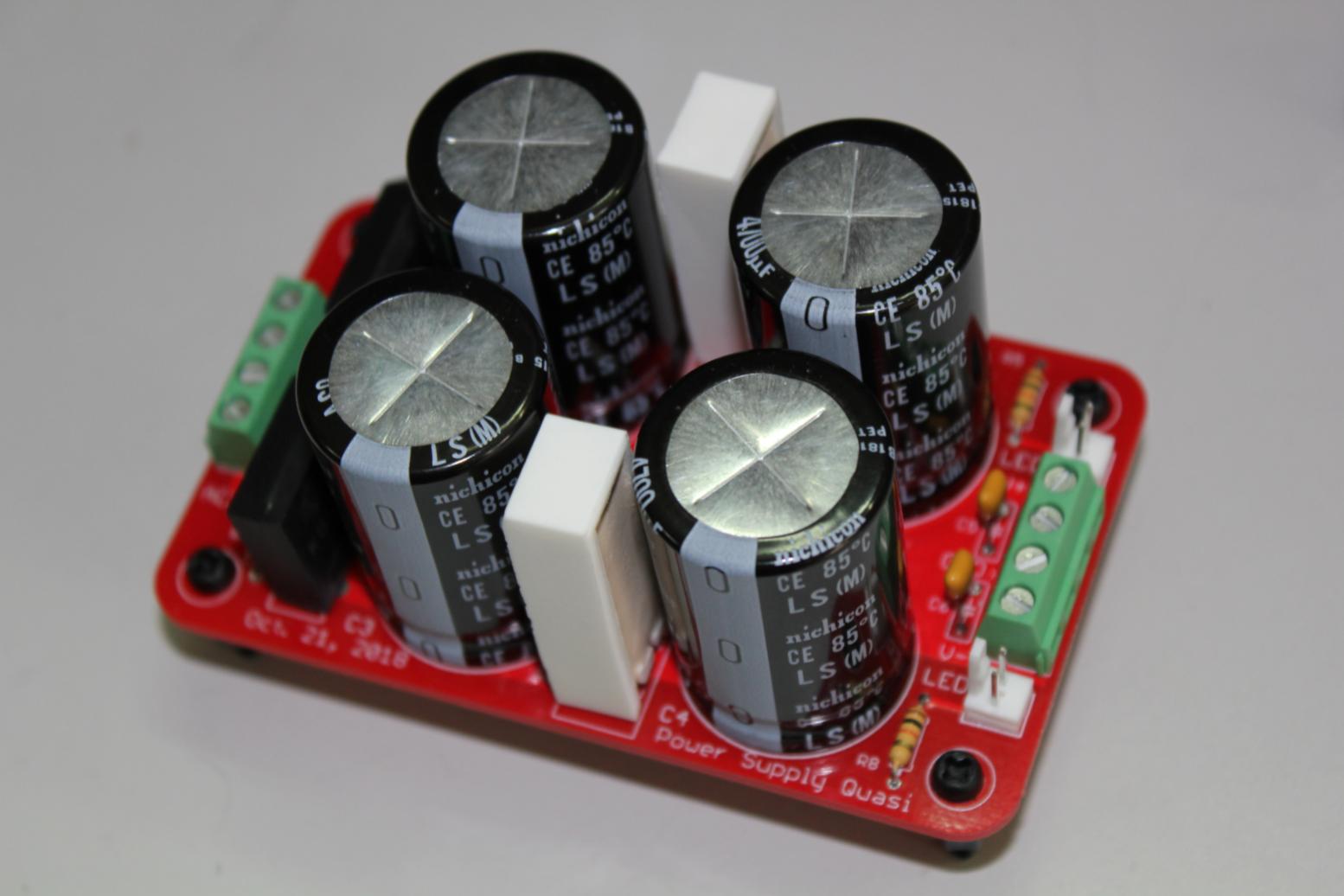

I am still listening the amplifier while I am building the two C-R-C modules (the same that I have made for the Quasi, see photo) that will be used with the amplifier in this enclosure : DIY Case Amplifier 100% Aluminium 271x240x90mm - Audiophonics ...

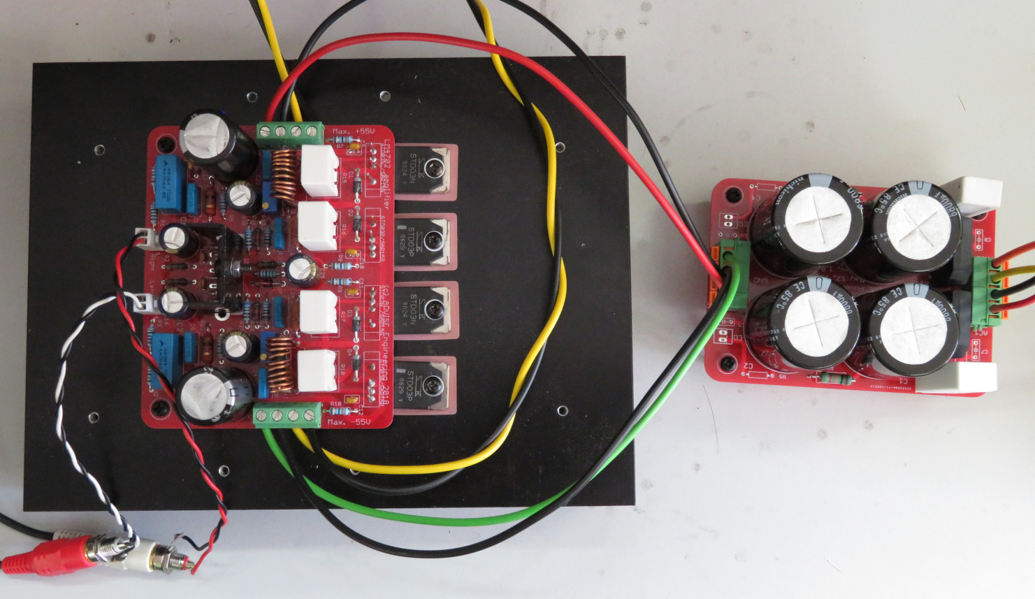

My MOSFET amplifier made for music designed by Mooly is at Philippe home for the final integration in the enclosure, he is living not very far from me, also in the south of France, close to the little town of Bandol well known for the wine produced here :drink: I am lucky that Philippe is very smart in mechanical job because I am very bad for that :mad: Before I meet him (thanks to Internet Audio forums...) I had plenty of electronic boards assembled and working but not packaged !

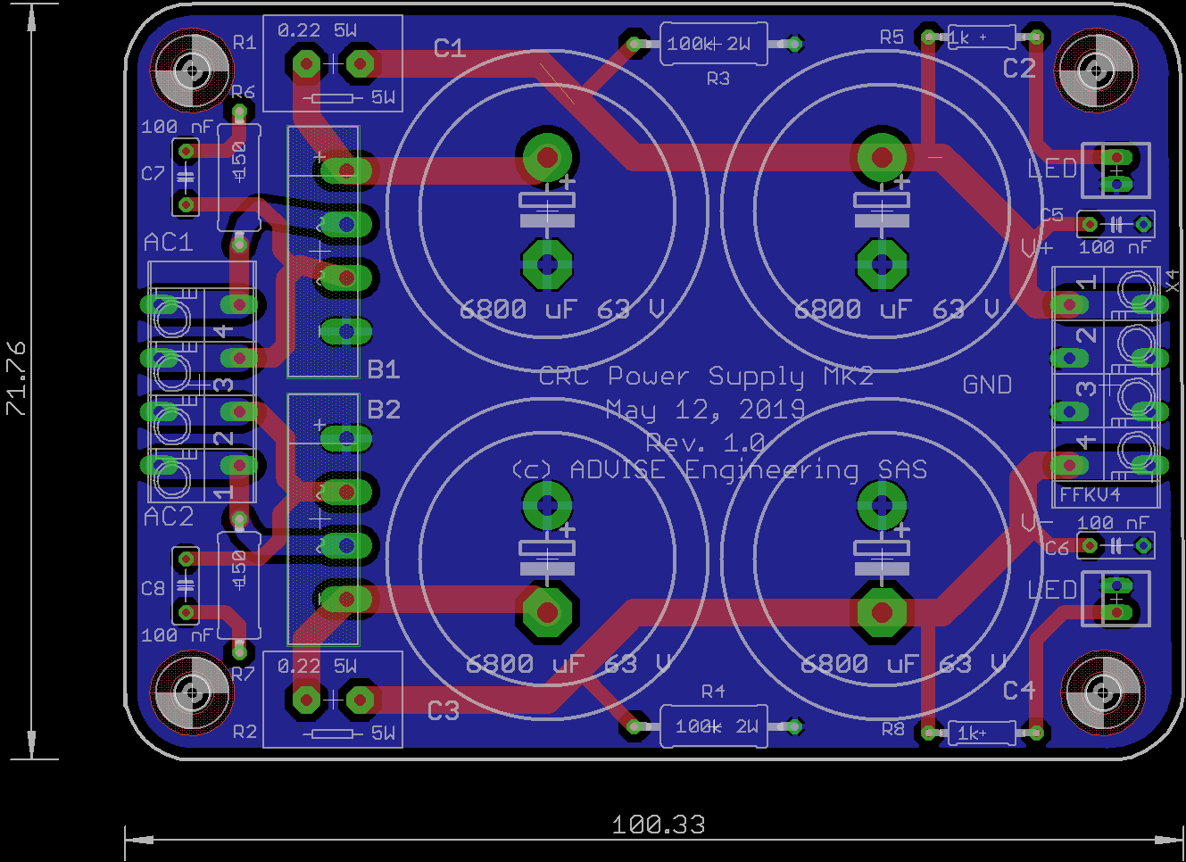

Finally Philippe who has also made the final integration for my Quasi will keep the two small CRC power supply modules for his own Quasi project, therefor I had the opportunity to redesign a slightly larger CRC board for the Mooly amplifier since it use a bigger enclosure (see previous post). The new board will have the same height than the Mooly amplifier board designed by Prasi and will fit nicely close to it on the heatsink. With the bigger PCB I was able to put 30 mm diameter capacitor instead of 25 mm, it is possible to use 10'000 uF 50 V or 6'800 uF 63 V (what I am using now) which should be enough for most amplifiers...

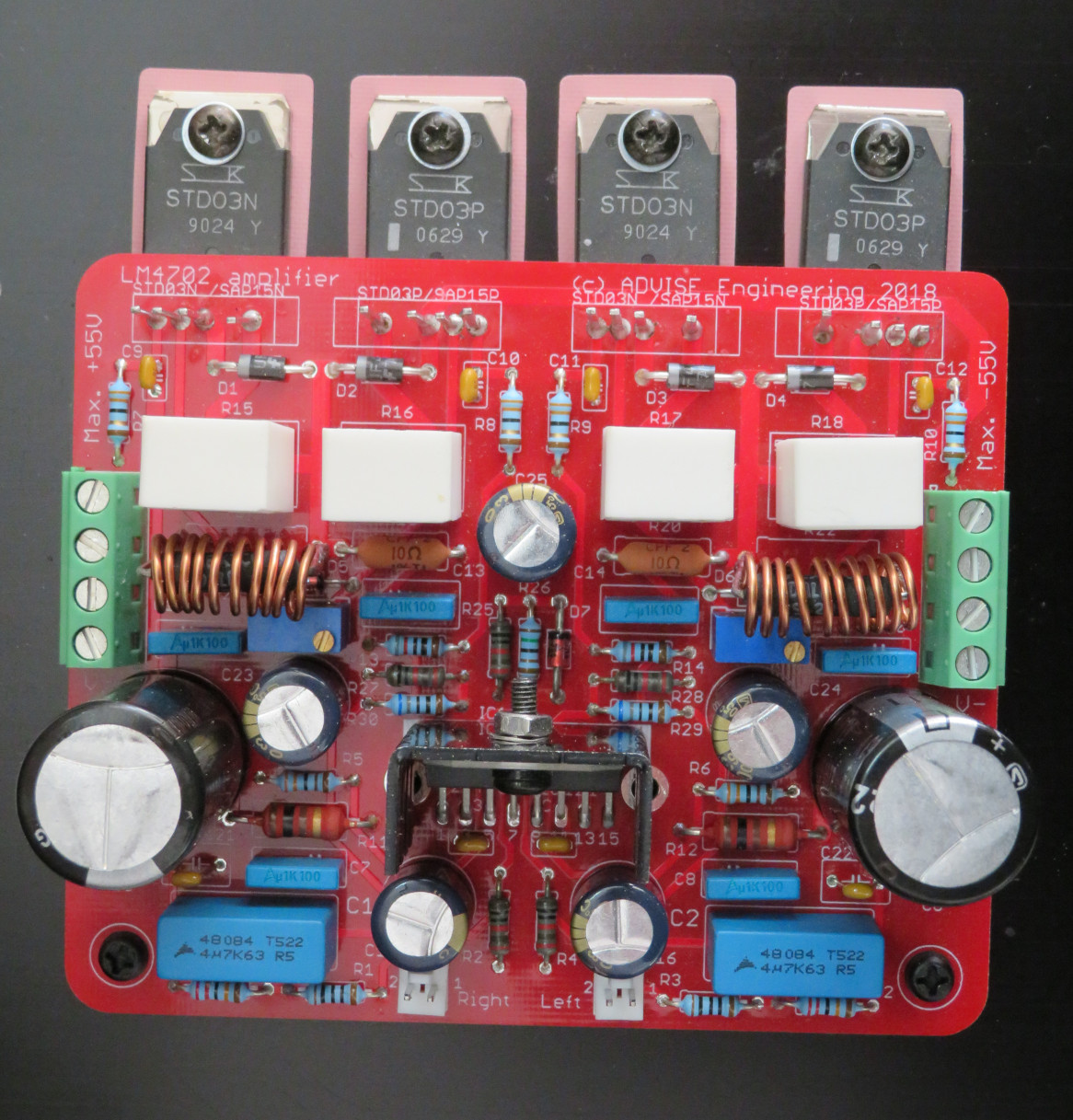

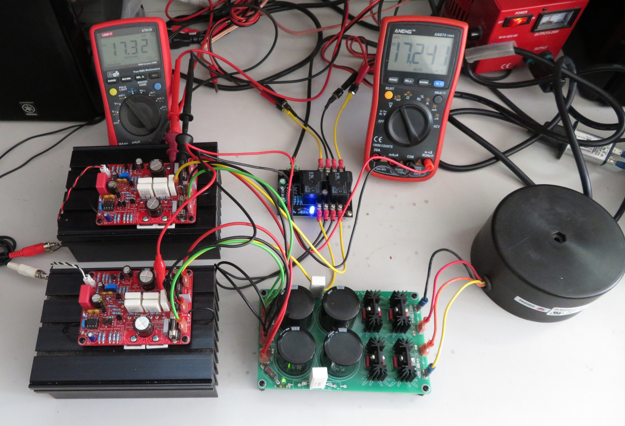

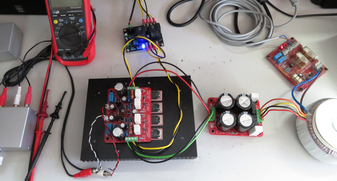

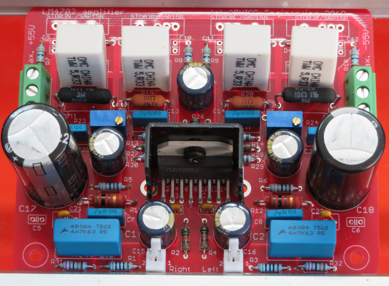

Since the Mooly amplifier is no more here, I tested the power supply with an other small amplifier that I have designed to use some LM4702 (now obsolete) and Sanken STD03 that I had in stock. I have designed a first version 10 years ago but I made several mistakes and the ground was not well routed and I had some noise :(
This version is much better, I have no noise at all and the sound is very good, may be not as transparent and clear as the Quasi or the Mooly but it is a very simple and very compact amplifier to build (it is a stereo board !). If someone is interested and have some LM4702 in stock, it is possible to get the board from PCBWay because I share the design : LM4702 sanken amplifier - Share Project - PCBWay
When the Mooly amplifier will be finished, I will put the photos here :) For information I have just ordered 12 Renesas 2SJ162 and 12 2SK1058 from Reichelt because these Lateral MOSFET are still available from them :D
