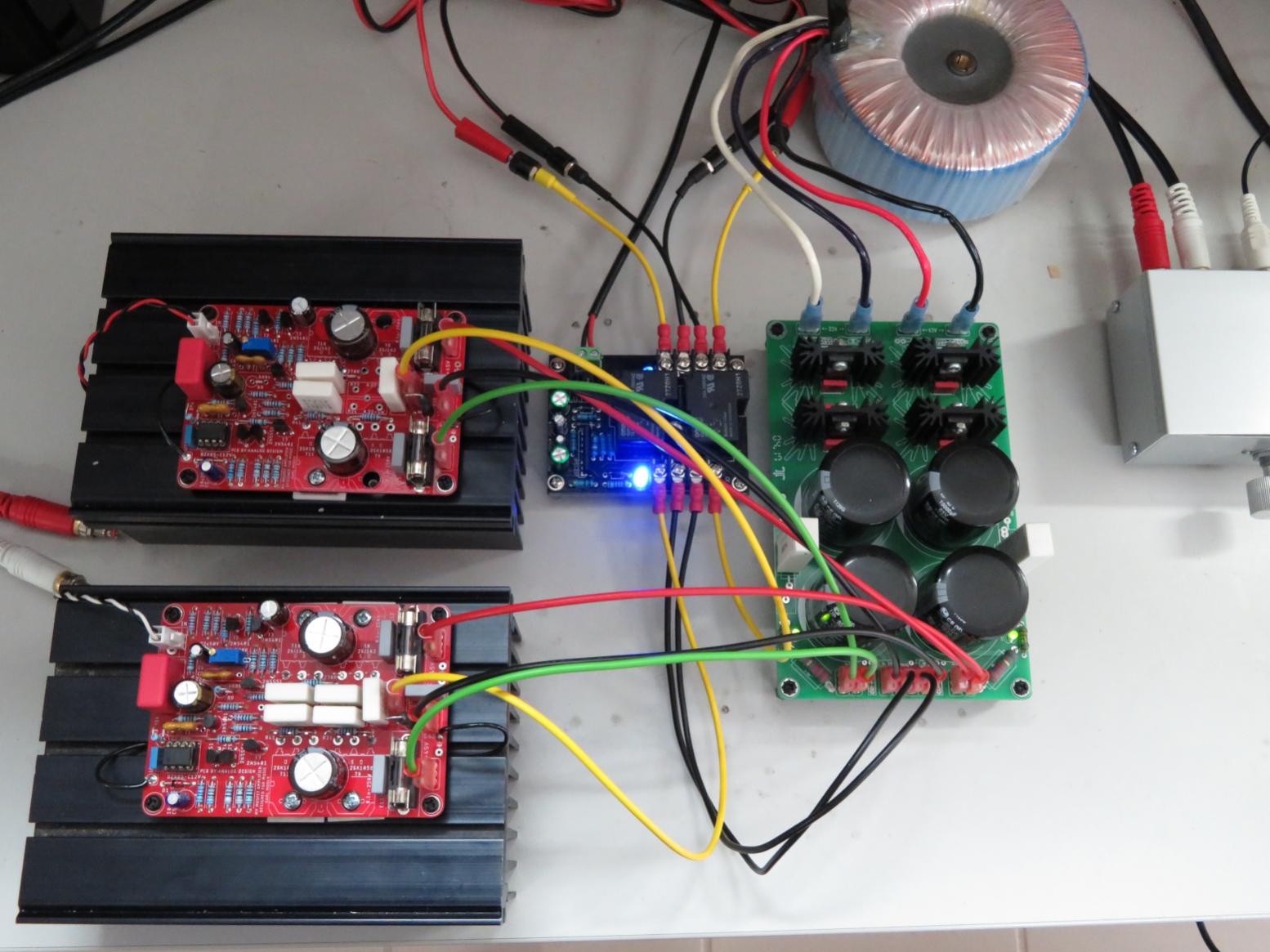

Every things is connected, I am using a 100 W 8 ohms power resistor as a load and I have a 2 x 22 V AC toroidal power transformer connected through a Variac to control power voltage !
I have used 5 A fuses (they are not specified on the BOM, but I see that value on a PCB serigraph ?) and I made a short circuit on the input...
I still have some questions :
- Can I run the amplifier from 0 V to 30 V or should I start immediately with the Variac a the main level that will give about 30 V DC ?
- How should I adjust the bias trimmer at the power up ? And if I read correctly in the thread I should adjust it until I have 23 mV on one of the 0,22 ohms output emitter resistor 😕
I hope I get your recommendation before I destroy this nice amplifier 🙄
Thanks,
Marc
1. 5A fuse is ok.
2. 100mA bias is ok for lateral mosfet. bias measured across drain to drain voltage drop of 45mV (I=45mV/0.44ohms=100mA)
3. inline Rail resistors of 10- 22ohms (2-3watts) could be useful here and voltage drop across them would convey the correctness of build as you bring up the variac voltage. the circuit shouldnt consume more that ~200mA , this translates to 2V drop across the 10ohm inline resistor.
regards
Prasi

That was the problem, when I powered the amplifier with the trimmer on 500 ohm the bias was far too high and I didn't see it because my ANENG multimeter didn't work properly 🙁
Now I tested again starting with the trimmer at 0 ohm and the resistors didn't became hot but I could not adjust the bias and I found the multimeter problem therefor I take an other one and I could adjust the bias at 22mV on one 0.22 ohms resistor 🙂
I also checked the offset correction and found -4.895 V DC and 0 mV on speaker output ! Now I am running the amplifier with +/- 28 V DC power supply
Next step : I will increase the power supply and test the amplifier with a better speaker before to build the second channel...
I cannot comment on the sound yet because it is a very basic old speaker without cabinet used for my initial tests in case of dramatic failure 😉
I am still a little bit suspicious about the MOSFET because they look so new for obsolete product ?

I am back on the amplifier after a (too) long lunch break 🙂 As I planned, I have removed the Variac and connected the amplifier directly to the main voltage (about 240 V here) and I have now +/- 31.2 V DC on the amplifier, I have a 300 VA 2 x 22 V AC transformer !
I can use an other one 300 VA 2 x 35 V AC but it will give nearly 50 V DC, is it acceptable ?
Currently the Vbias measured on R23 is stable at 23 mV and Voffset at pin 6 of the TL071 is -4.82 V and I also measured Vgs = 0.81 V as suggested by fab, this and the comments of gaborbela give me more confidence in Reichelt parts 🙂
I have some background noise but it is probably due to the very bad wiring of the ground lines, I had also this problem at the beginning with the quasi but after a good assembly it was dead silent !
Marc

The second channel is playing music
Now i can listen the music in stereo
I have built the second channel with only one pair of output transistors and I cannot hear a difference with the left channel which use two pairs 😕
I didn't mount the 680k resistor and I found that the sound is clearer without it, in a certain way it is less tube like 😀 If I compare with the Quasi, I found that both are very close, but I was very surprised by the sound of the Quasi because it was a new experience for me and now as I become more knowledgeable with transistor amplifier I am always expecting more
I am now listening on small bookshelves Yamaha speaker and I like the result but I will try with my Alon "Petites" to have a better feeling of the amplifier qualities...
Now I will start to build the Hybrid amplifier, I will make a new thread in the tubes forum 😉
Marc

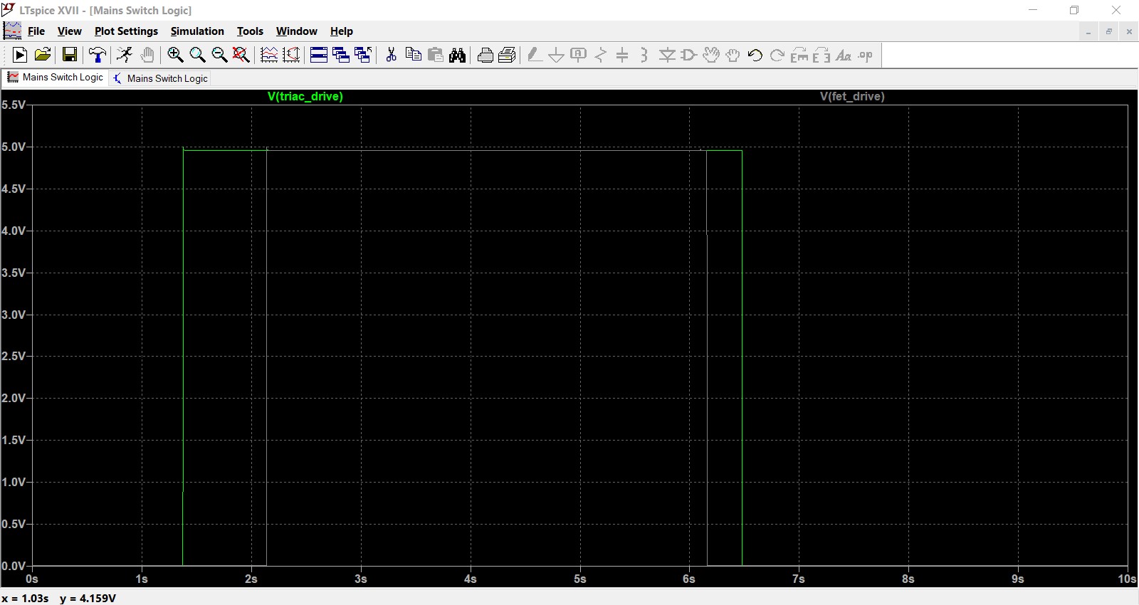

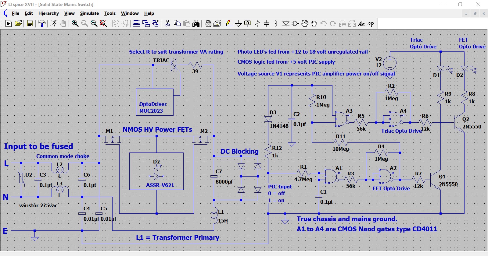

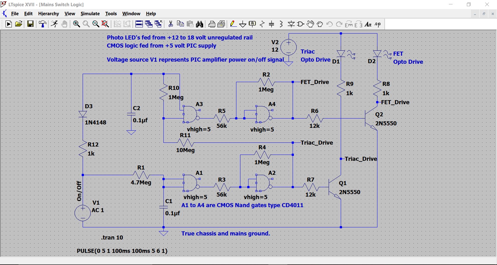

Non of the amps I've built (and none of the commercial ones I've owned) have had a soft start circuit.
Thats not to say they are not a good idea in some cases, but they do seem to have become a bit of a 'must have' accessory in recent years.
My favoured soft start method is a triac for the initial power on inrush that then gets bypassed with a very low resistance FET power switch. The FET turns on after the triac has operated and off before the triac is turned off.
