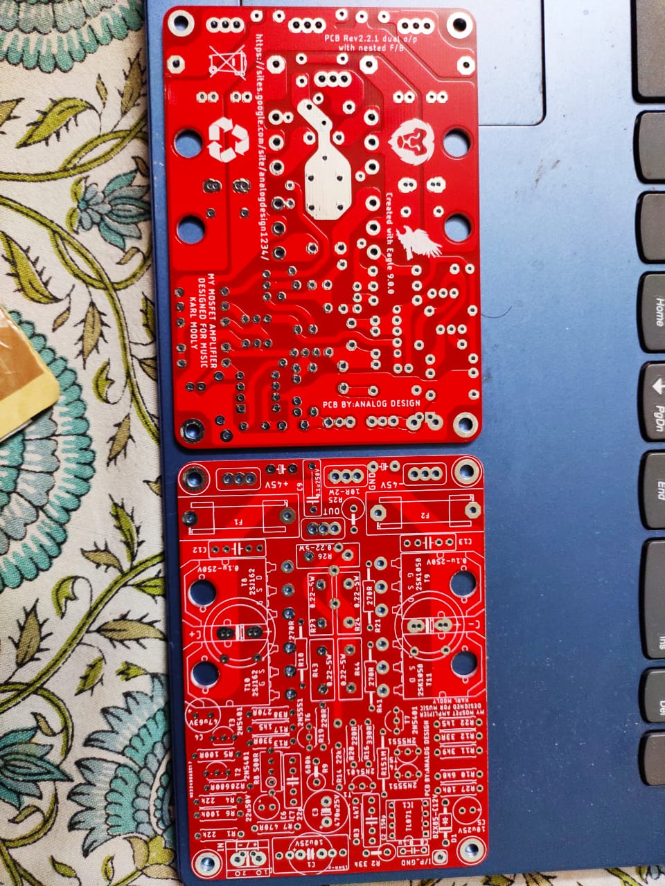

I cant remember if I posted them, here they are.
regards
Prasi

Hello Mooly
greetings i would like to try your amplifier as i have all parts
and orignal mosfets i would like to etch the pcb at home is this the
correct pcb layout please can you confirm
warm regards
Andrew😕

I suspect you’ll need to be more specific. There are several pcb layouts presented in this thread. Which post are you referencing?
oh nooo I was about to order a few PCB's is there actually an errata on the layout?
PCB layout is incorrect somehow.
I never actually produced any boards for this amp (not for the forum anyway) as the amp was designed and built before I got into using a PC for circuit design and layouts.

AFAIK the boards offered by Prasi are fine and several members have built the amp with no issues. AMPMAN has also built two of these amps with no issues as far as we know as he says.
Extract:
...............I have built two amps and I'm very pleased with the sound..................
Exactly. The design is proven and as far as I know, so are the boards produced by Prasi.

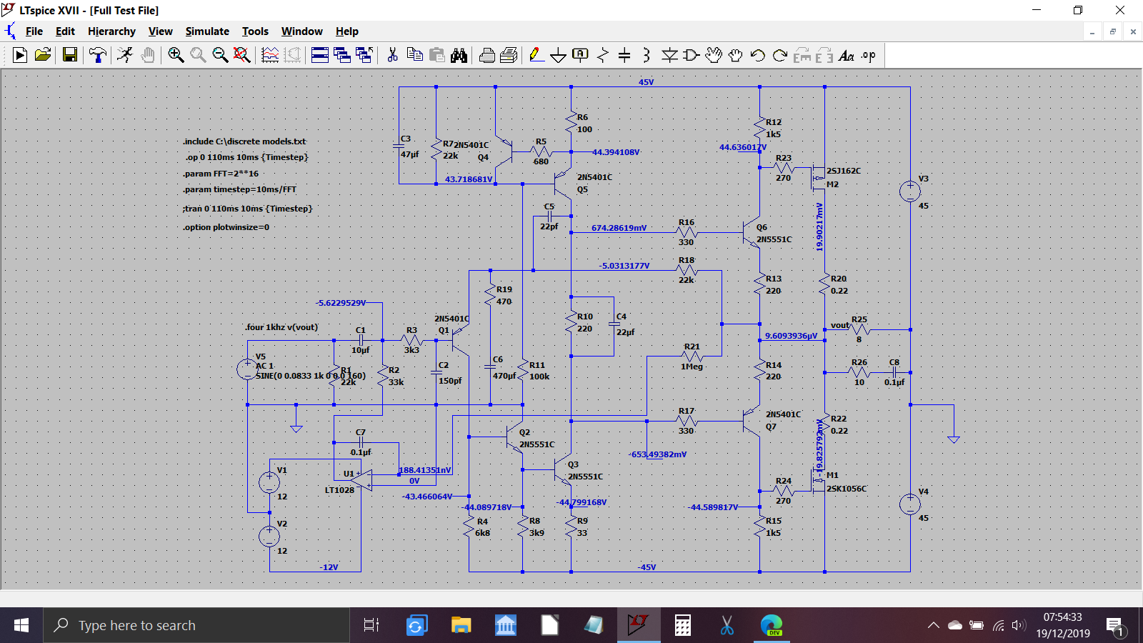

Hello Ampman,
You could run the spice file posted by Mooly and see the various voltages in your build and compare.
That will give you an idea. or post the diagram showing your voltages, that will be of help to designer to identify the problem.
This shows typical voltages at key points in the circuit.
(This is an old file and the component reference numbers probably don't match your PCB... so work from the circuit itself. Remember that voltages that are referenced to a rail will vary, however you are looking for the correct voltage difference such as 0.6 volts across the 100 ohm)
I've just replaced the image above for 'technical reasons' 😉 with LTspice.
I snipped a voltage source after running the sim and it changed the voltages already tagged... that's obviously an LT thing as I hadn't run the sim again.
The real amp has NO positive supply to the opamp, whereas the sim needs one.
Actually I just designed the PCB and posted the gerbers🙂, bandol83 (Marc) + some others got them produced.
Marc has kindly donated a couple of PCBs to me😎. I am keeping them for my build at leisure.😛
