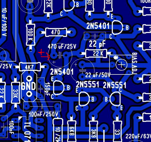

The board layout here is correct. You will find the emitter of the transistor that the cap goes to is at around minus 5.5 volts or so with respect to ground. The cap plus end then goes to the 470 ohm that goes to ground.
Its obviously correct as you have it or the amp just would not work. If your cap markings don't agree... 😱 I'd be looking at the cap and making sure its a genuine part.

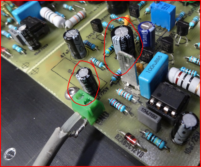

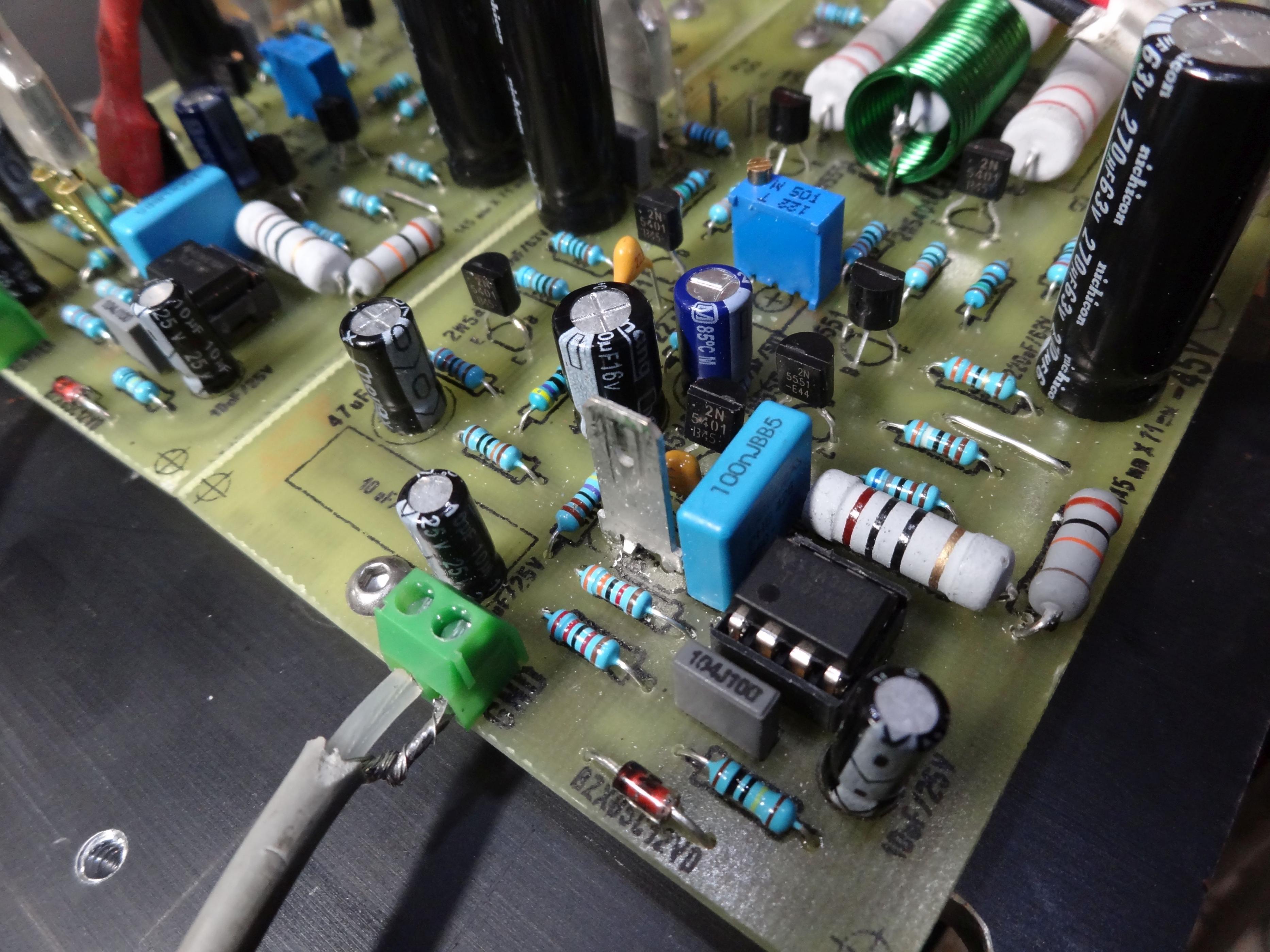

You are correct. That is the way the cap is marked on the board. That is how I initially had it and it would not work, Huge offset. I now have the cap the opposite of what is shown in your picture and the amp works flawlessly.
Here's a picture of the working board.
Terry... you need to scrutinise those caps, there is something odd with them such as the sleeve being 180 degrees wrong.
If you measure the voltage across the cap then I think you will find the voltage doesn't agree with the cap markings. That is to say, with your red meter lead on cap plus and the black lead on cap minus then I think you are going to read minus 6 volts.
Another check on cap polarity is to measure the DC voltage across the 470 ohm. It should be 0.0000 volts with a good cap correctly fitted.
Please change those caps and fit new replacements as marked on the board.

The emitter of the first transistor should be around negative 6 volts give or take with respect to ground. That is why the negative end of the cap connects there, and the positive end to ground. The voltages on the simulation I showed yesterday are in the correct ball park.

Mooly is not suggesting to change the cap back to how it was, he is suggesting the sleeve of the cap has been fitted the wrong way round by the manufacturer. This does appear to be true going by your measurement. Where did you buy the cap from?
For peace of mind, swap the cap out for another totally different cap, but with polarity as marked on the PCB. The value is not critical as it is just a steady state test. It should produce a stable result.
Terry, everything is pointing to those caps being marked with reverse polarity on their sleeve. As Richie says, the value isn't critical to prove this, even a 47uf or 100 uf would be OK.
Please just swap one and fit the replacement as marked on the board.
Changing the input cap fixed it. All is well.
