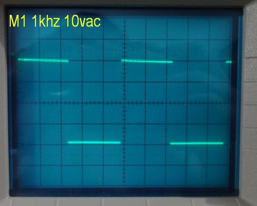

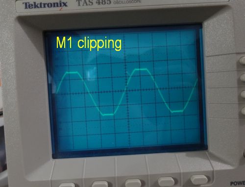

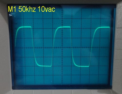

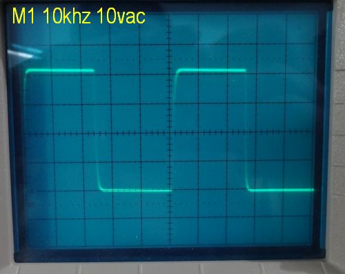

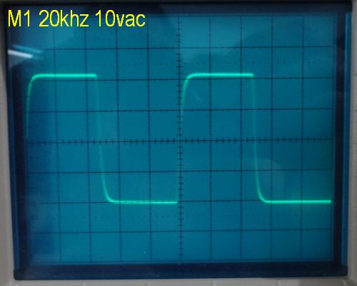

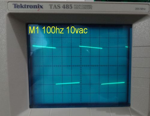

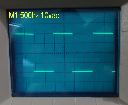

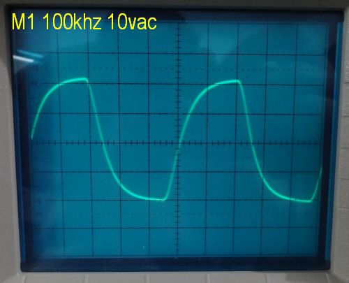

Here are some scope shots for those who like this sort of thing.
Blessings, Terry

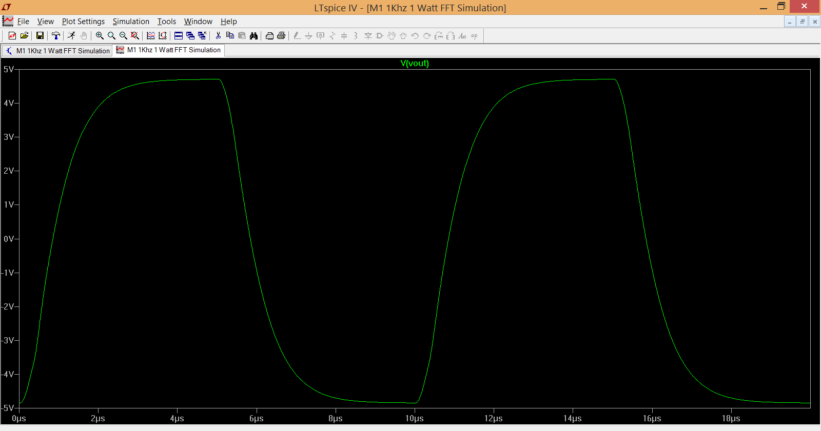

Interesting to compare the simulation result against your real version. Edit the input filter (4k7 and 150pf) is the main reason for the HF roll off. Its deliberate as I'm not a fan of leaving the input open to wideband noise and hash.
100kHz.
I don't pay too much attention to anything above 10khz. It is only there to give an idea of how well the circuit is running. I can't hear past 10khz.
