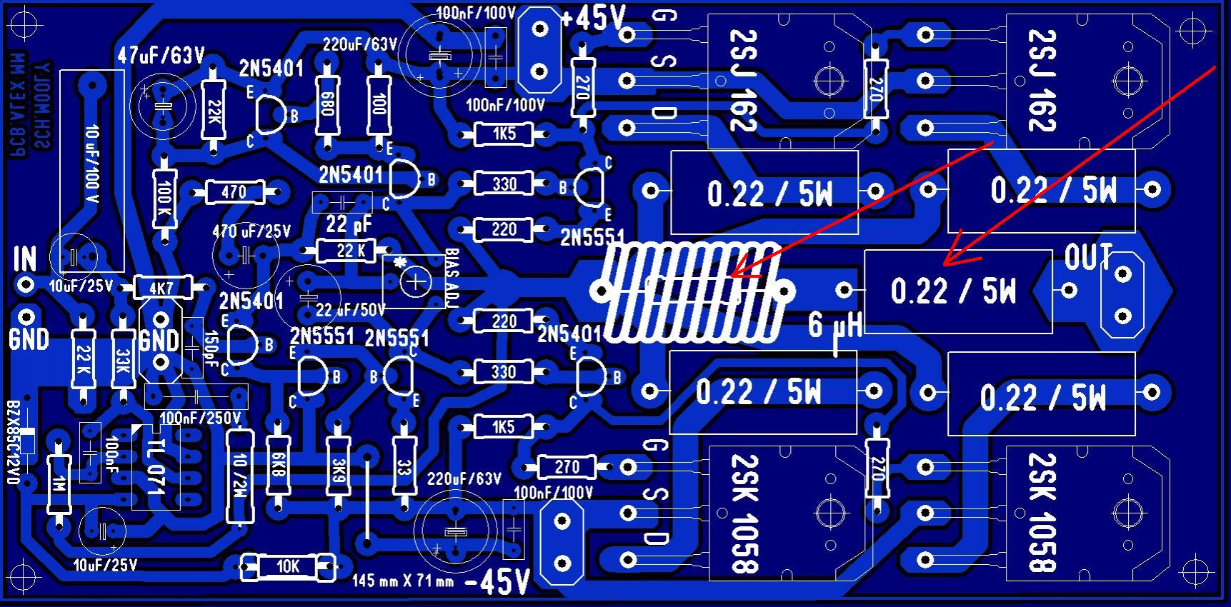

The reason I asked because Alex did not include at his second layout the coil which is the most important on the output...
Instead 0.22 ohm I use the coil may be the damping resistor
If is OK to ad the 0.22 ohm on the speakers terminal. I have no room on the PC board for the coil and the resistor..

Yes, its perfectly acceptable to add the coil at the speaker terminal of the amp, or you could swap the resistor for the coil on Alex's pcb and add the resistor at the speaker terminal... that's probably the neatest way actually.
56 vdc is too high unless you realise the limitations and are prepared to change the design slightly. The VAS stage and current sink would need TO126 or T0220 style devices to reliably cope with the heat. It may only be 0.5 watt or so but that's above what the 2N5551/5401 can take (unless you can keep them cool... T092 heatsinks are available though). Also, unless you are designing an amp for high voltage output, using unnecessarily high voltage rails simply increases dissipation and actually limits the ability of the amp to drive lower impedance loads safely simply because the outputs are dropping so much voltage. You cross the bounds of the safe operating area of the outputs (SOAR) that much sooner. That applies to any fixed rail design.

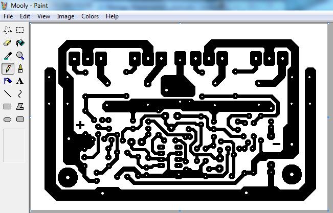

Here is the final layout based on the Alex second design, Thank you Alex! I did mode it by me to feet my heatsink
I will start to collect the parts to the amplifier
Greetings

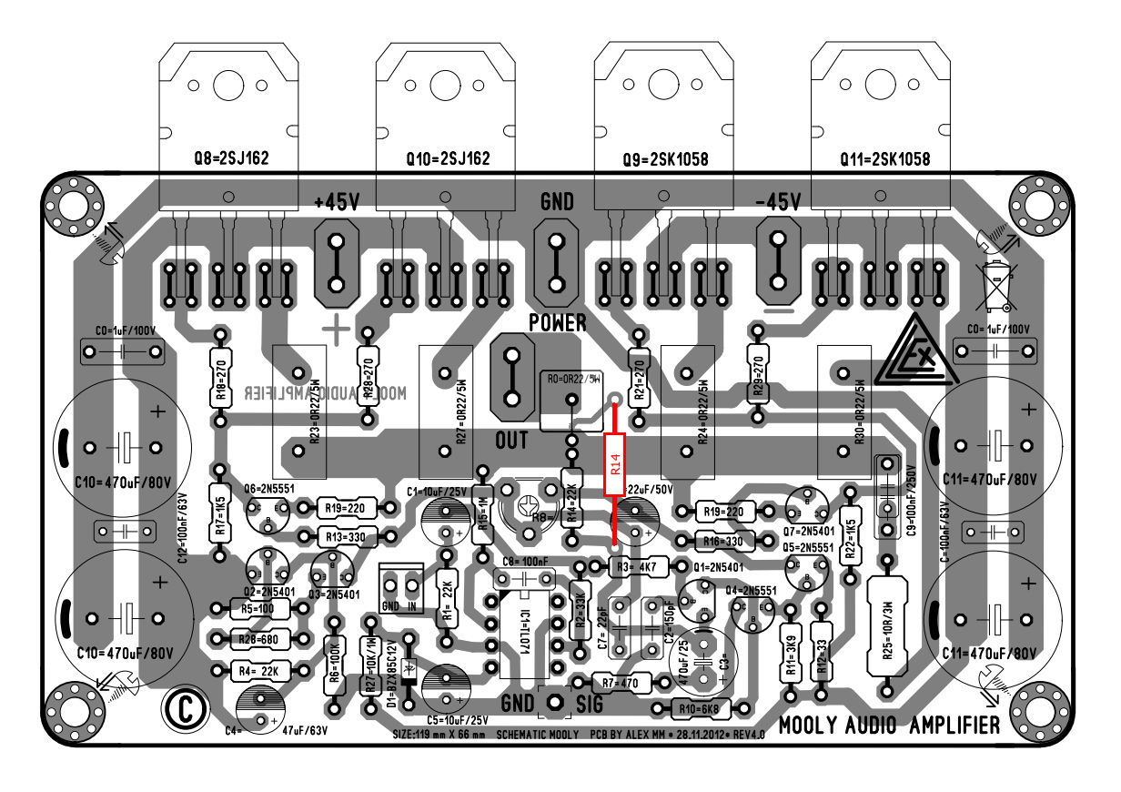

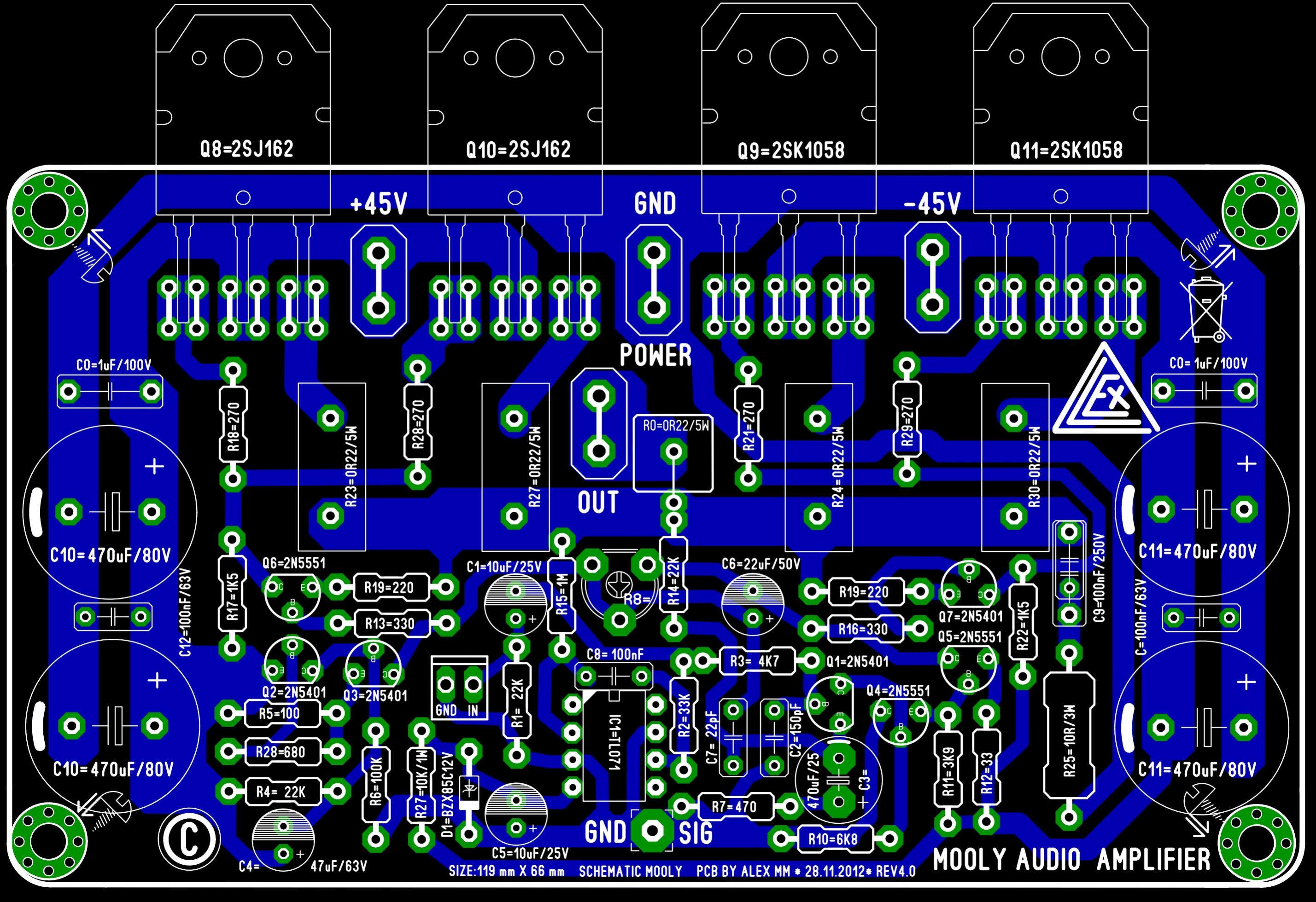

In post 531 the layout of the pcb for the amplifier of Mooly is attached. Thanks. it would be helpful to add the dimensions (preferably in mm), so it can be printed on the right scale. Did I miss a post on this? If not, can someone please add the right dimensions?
When someone is planning to make pcb's, or have them made,I would be interested in a pair.

Hello
That layout based on Alex design. I only mod it to feet my heat sink an my ideas. Also to make it more iron transfer friendly.
I use paint program on my computer to draw or rework layouts.
The PC board size same wide how Alex made it, I did not touched that dimension.
Usually I try to make my layout a bit larger because I use PRP exotic resistors 9 or 10mm size and caps to. 125-130mm wide will give you the right size. You can scaled it to the right size..
I use pain from Windows XP for that to. Some printer also aloud to scale it to the right size..
Only one part has to be close to feet the chip. The other components lead can be adjusted.
I always draw my layout these way, I own Sprint 6 but so many years I'm doing these way to me now easier than to learn how to use Sprint program. I do not plan to do much layout so I'm sure I do not learn that.
I cant not provide silk screen but you can use Alex artwork or parts location to make your life easier if you choose these layout. Some small change only..
These is the final layout! I hope it helps, I do not want to create confusion. You can always use the Alex design, he did awesome job and has two different type... Just in case if you afraid to use mine.. Also I'm willing to help in case,

Stop!. Beware... this version of PCB has an error that was never corrected. Its regarding R10 connected to gnd. it should be to -ve rail as pointed by some gentleman...

I will go over and check for errors... Thank you for the warning, I thought that was a proven built PC board or layout.
It will take some time but I will correct the error.
