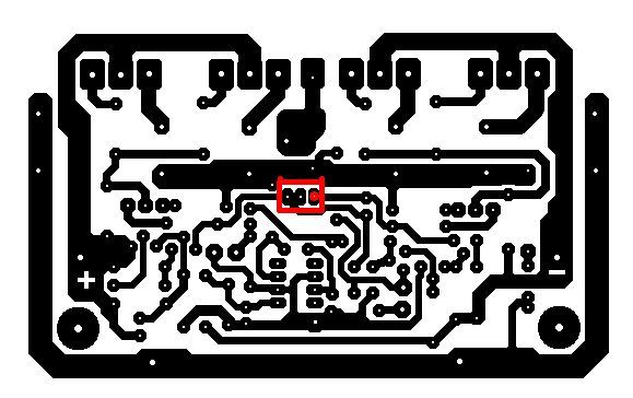

Mr. Karl,
Here are the pdf files for anyone trying at home etchings. I think the design has come out very well, thanks to your guidance, alexmm and motivation by AKSA. all credit here to these guys!.
Pl do moderation for following if you feel so. or tell me where i can post this.
**I am planning to order some pcbs for myself and if any body wants the same please PM me which will be easier for me to decide additional quantities. PCB is single sided FR4 35 uCu with soldermask and with silk screen. I am yet to get a quotations, but i think it will be 4.5$ to 6$ per PCB+ship.**
there will be no talk of this on this thread hence forth. If response is there i will start new thread.
all the best and wish me luck for my builds.

Hi
Mooly what do you think for VAS transistor at 50V rail voltage if I use 2SA1360 & 2SC3423 from Toshiba.
I do have some at home, if it would be good candidate I will mode the layout to feet that transistor
I attach the data so you can easily take a look

These are both excellent VAS transistors for SS amps. Their base/collector capacitance is less than 2.5pF, collector current around 100mA, and they are rated to 200MHz plus. I use the C3423 for rails less than 65V.

The dimensions of the board are 119*66 mm. Can you consider bringing them down to just below 4in*4in. That will bring down the price of the PCBs.

Hello,
Thank you for your interest. I have marked your interest in my sheet.
119mm to 100 mm would require quite a lot of rework, which I am not sure would result in a good layout that it currently is (optimal output device spacings, grounding scheme for i/p section, etc).

Just finished my layout using the mentioned Toshiba transistor for VAS.
I post my layout but size vise the will be a bit larger PC board
Because of GB started and I want to respect 🙂 other peoples work and desire I can not afford any support if you chose my layout which will be home made and iron transferred.
I only chose to do it these way these will feet my heatsink well.

Very nice layout indeed and doing it in paint really requires tonnage of patience and carefulness. Congratulations!.
There is no problem if people want to use my layout (or your layout) for iron transfer, thats why I posted bottom and silk and grey.
I want most people to give it a try because, as informed by AKSA music is not defined by very very low THD or ultra high slewrate alone.

pl connect the trimmer on your layout like this after assembling.
